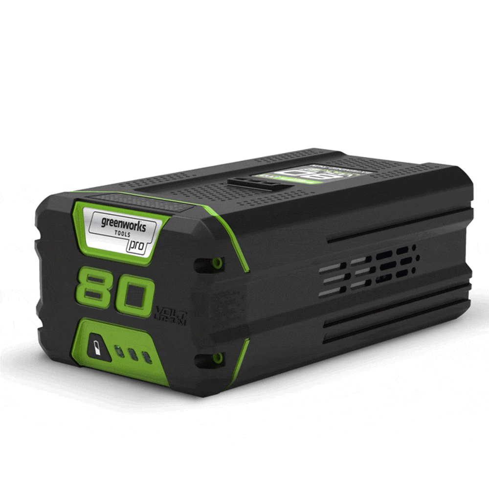

                                  some are greenworks brand 80v others are copies . 18650 cells inside Click image for larger version

                                    Do you have a picture of the insides of these battery packs
                                    If these battery packs are like the ones that I have taken apart before the best way to do this is to remove the the BMS board first and then take the tabbing off with a small side cutters then you can then do your battery testing I would suggest that you at this point that carefully test the battery cells and then group the battery cells that have the same or nearly the same charge/discharge curves and then test the BMS board with the battery single voltage monitor module that I referred to earlier and see if the individual battery cells track very closely together or not and for this I would make a battery BMS board jig and use an empty battery pack enclosure and wire the BMS board to individual battery cell holders so can match the battery cells closer together you will get better results
                                    This something that I going to build for the Milwaukee and Ryobi battery pack testing jig like I discuss above I just have to make time to do this and stop procrastinating and just do it because I have battery pack that need to be worked on
                                    Your comment about any monkey could do it you are right however if you do not go through with the testing and matching battery cells together you will get very poor results with running time and performance will suffer from not doing these steps which this can not be done by any monkey

                                      the packs are same as these . https://forum.toolsinaction.com/topi...attery-repair/
                                        • Jul 2011
                                        • 6070
                                        From what on this website is that these battery packs BMS boards shit and who knows what company made the battery packs what real shit these are quality controls they have
                                        The 40 volt Ryobi battery packs are not any better with there quality either they have a lot of issues with the BMS boards and battery cells are low end Samsung battery cells so I not surprised by this because several times I have had get replaced battery packs under warranty from Home Depot
                                        This where I would highly recommend doing what I suggest earlier about making a jig and testing BMS boards before putting know battery cells that you have tested
                                        I would use tw 40 volt battery pack BMS charger and battery packs that have a better reliability and quality to match the battery cells unless you can find a known BMS board that works correctly for the 80 volt battery packs that would be the option that I would do for testing the matching of the testing the battery cells
