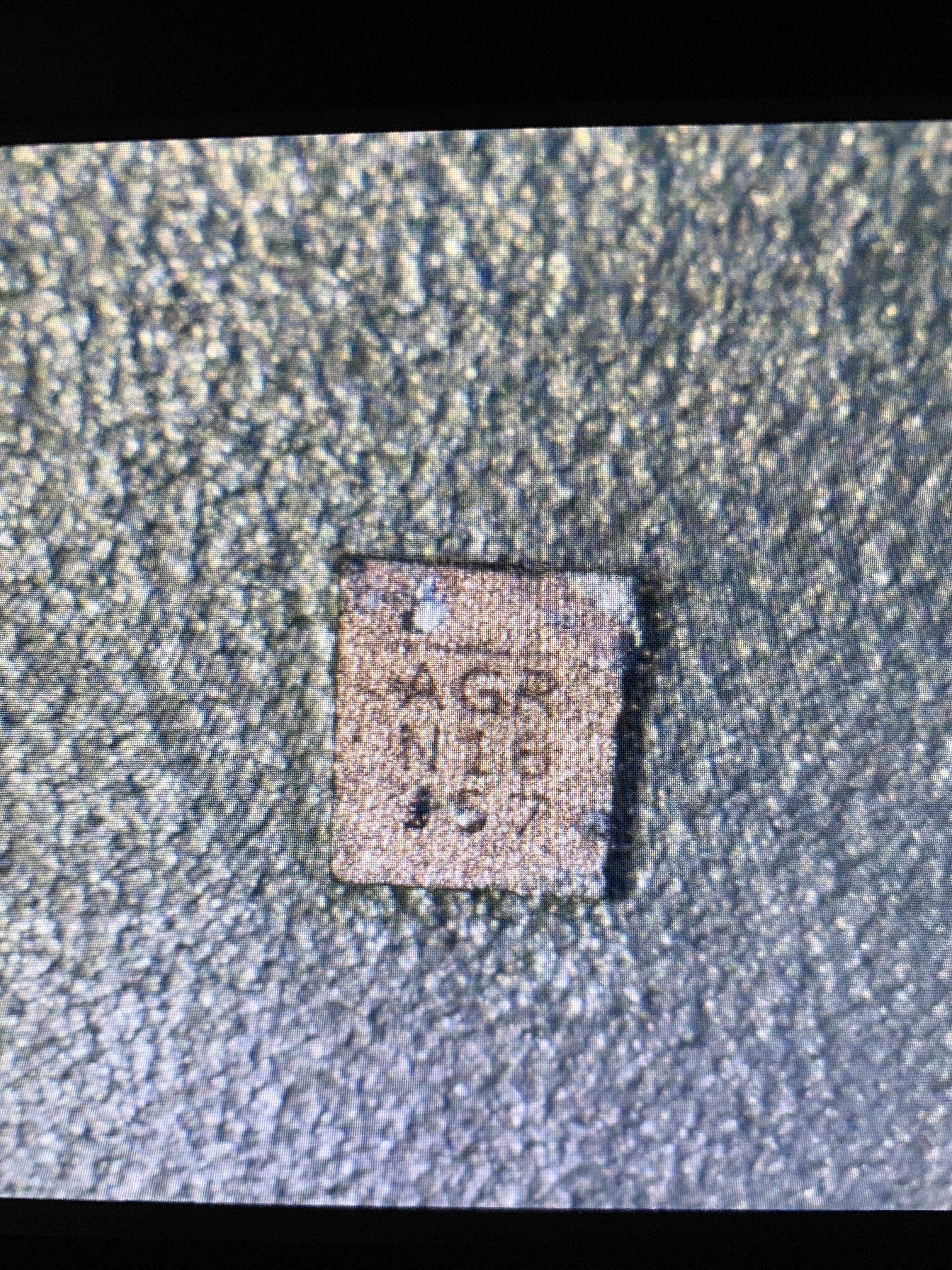

Can anyone identify this ic marked AGR
04-18-2024, 01:07 PM
As the title says. Can anyone please help identify this ic.
Kind regards.AGRN16957

04-18-2024, 01:21 PM
Originally posted by
bigboots
View Post
Kind regards.
It could be a Monolithic power MPM3805GQB
Datasheet
https://www.monolithicpower.com/en/d...0Lx2Z9-M-o9izb
All donations to badcaps are welcome,
click on this link to donate.
Thanks to all supporters
Post
Cancel
bigboots
Join Date:
Mar 2019
Posts:
43
Country:
uk
04-18-2024, 01:41 PM
SMDFlea
View Post
Datasheet
Yes it looks the same pinout as that. Just been to check to see if I got the numbers correct. it's hard to see on the ic. it is AGRN16957.

04-18-2024, 06:24 PM
AGRxxxx - MPM3805GQB–Z

04-18-2024, 06:44 PM
https://fr.aliexpress.com/item/1005005416510660.html
(photo)
http://markingcodes.com/search/c/agr
