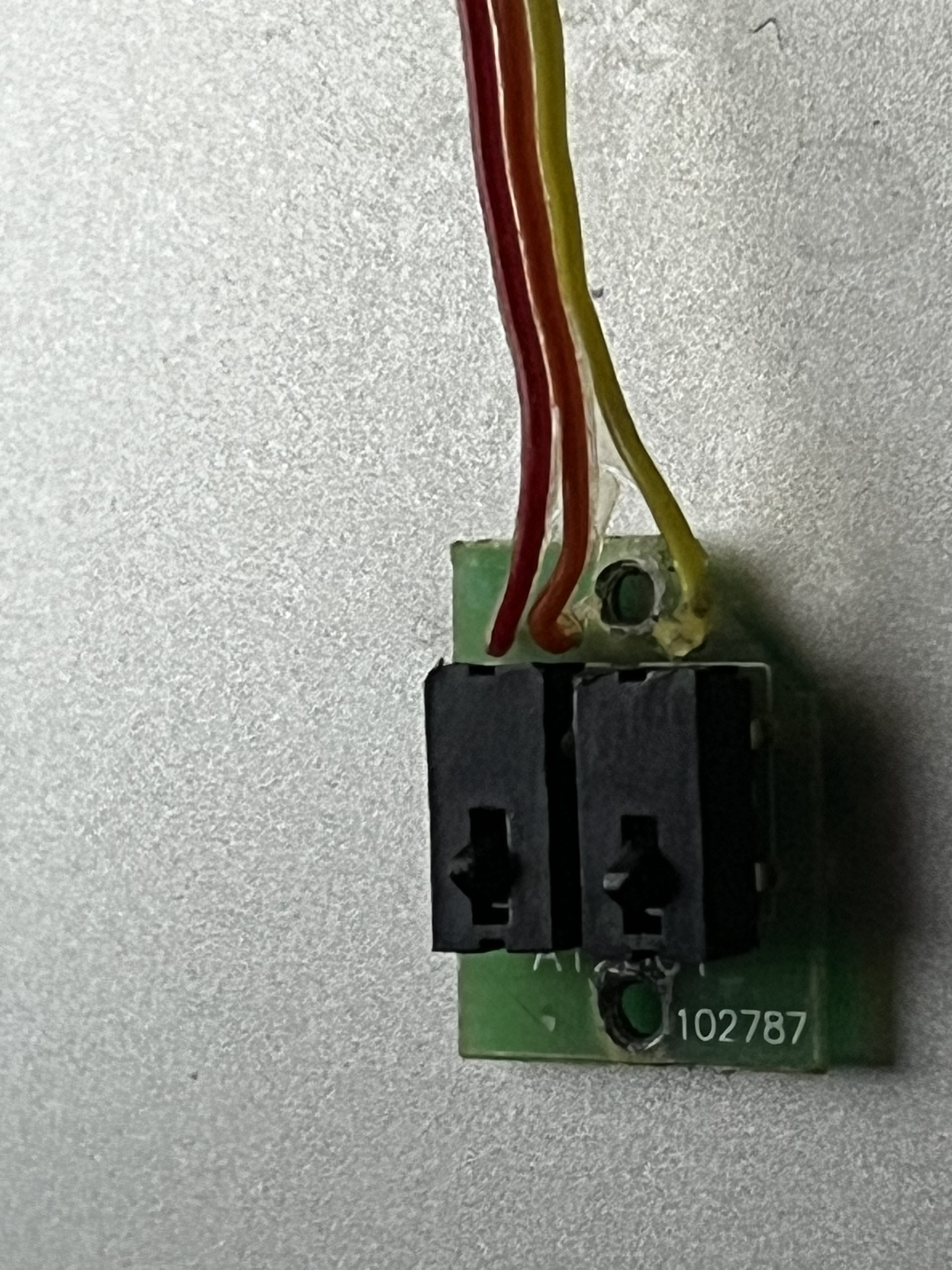

    These switches are bad and I need a replacement.
    The dimension are:
    L: 10mm
    W: 5mm
    H: 4.5mm
    Pins are 5mm center to center both length wise and width wise.
    Any help would be appreciated.
    • 31094
    from a floppy drive?
    • kasfamily
      • Aug 2014
      • 772
      • Russia
      Hello, you need to unsolder it from the board, carefully disassemble it, clean it and it will work like new...
      • lotas
        • Jan 2016
        • 4668
        • Russia
        No need to disassemble it, buy a can of contact cleaner spray and spray it inside and press several times and contact will be restored.​
