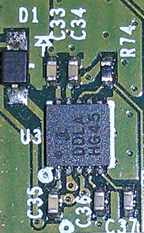

    Please help me identify this part.
    The symbol looks like intersil...
    Thanks in advance.

    Might help if you say what it off - make/ model/ board number

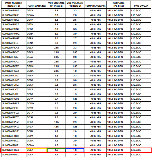

      Re: Help identify this part
      ISL9000A
      http://pdf1.alldatasheet.com/datashe...000AIRBCZ.html
      • ben7
        Capaholic
        • Jan 2011
        • 4059
        Yep, it is an ISL9000A.
        The marking sugguests it is a 1.5V and 1.8V regulator (two internal regulators)

          Perhaps still mention what it is off - may help others in the future
          marking is DDLA
