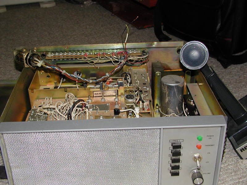

    She's a beauty! Now I need a manual.
    After some scrounging around the dump I came up with this:
    It's an RCA series 700 Type CSCL4AJA 25W base station!
    I have worked with cb's before but this is the real deal. By the looks of it it has been modded (see the relay resting on the left side of the box?).
    Right now it needs a new power lamp and I need to reinstall two wires that fell of the massive rear connection bus.
    But that's my problem.
    I am having a real fun time finding the manual for the system. So far I found a mod so the unit can support a data modem but as for a manual I can't find anything. Do you know where one is? Schematics at the least?

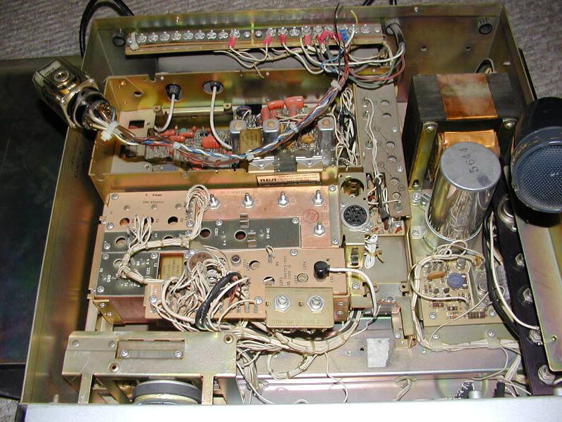

      By the looks of it, all they did was replace a realy and it's socket. That data modem mod shows part of the origional schematics and clearly shows that a relay is present.
      A few bolts and nuts and it is once again fitted to it's origional screw holes.
      The two loose wires connect to two contacts on one half of the module (there's two relays in one module).

                        Okay, here is the radio:
                        http://i11.photobucket.com/albums/a1...ted/system.jpg

                        The inside of the case:
                        http://i11.photobucket.com/albums/a1...elated/top.jpg
                        The two unknown relay wires:
                        http://i11.photobucket.com/albums/a1...ated/wires.jpg
                        Now for what I did....
                        I replaced the burned out bulb (it's not yet fully installed in the pic:
                        http://i11.photobucket.com/albums/a1...lated/bulb.jpg
                        I secured the relay socket down to a spare screw hole and routed the cables a far away from the RF section as the wire allowed:
                        http://i11.photobucket.com/albums/a1...ated/relay.jpg
                        I also installed a plug on the mic cable so I don't yank the cord out of the bof if something bad happens:
                        http://i11.photobucket.com/albums/a1...lated/plug.jpg
                        Finally, to clairify, is this copper plated or solid copper?:
                        http://i11.photobucket.com/albums/a1...ted/copper.jpg

                          its likely vhf hi (136-174mhz)
                          if you get your ham ticket you can change the rocks and put it on 2m fm.
                          if nothing else the shure 444 mic is good for ham use.
                          it would not hurt to approach a few local hams if you have interests.many will help you get your ticket.
