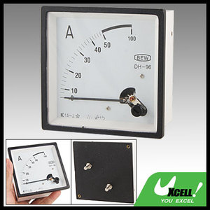

    Shunt Resistor feels cheap
    I want to install an ammeter onto a 240v 40A branch circuit so I bought this and it recommended for a shunt resistor I install this in series on one side of the phase (Remember, this is Canada so were split phase = +120/-120v) but it looks REALLY freaking cheap for something that needs to push a hell of a lot of juice through.
    Mind you, I work with DC a lot so I'm used to heavy guage cable and connectors. AC wiring always throws me off because all the things you can get away with in code. IS this actually what I'm supposed to do, or is this just overrated crap from the land beyond the sea?

          Don't use a series-shunt ammeter with your electrical service! A few reasons:
          The meter and shunt resistor are not properly isolated nor safety rated for the voltage, neither is CSA/UL approved. Even then, both must be housed in a proper metal cabinet. If you are trying to loop in and out of your electrical breaker panel, that would not meet Building Code on the 240V service side.
          You would instead attach a current-transformer (split-core type) onto the wire of interest (right inside the panel) then run the CT leads out to your panel meter. The CT provides safety and insulation from the panel voltages. Then you need to calculate the "burden resistor"/shunt to match the CT to your panel meter.
          Recommendation: don't connect anything from China to your electrical utility. There have been some house fires from the unapproved components. There's too much juice there- if anything cracks or fails it's a big boom.
          Popular is to use decent (approved) CT's with a low-cost energy monitor. There still is a danger with the voltage-monitoring aspect, as line voltage goes to the monitor.
          Note a panel meter will not read correctly with inductive loads (motors), as it does not compensate for power factor.
              The idea was to enclose the shunt and ammeter circuitry in its own dedicated steel box with proper electrical conduit connecting everything together. My parents wouldn't allow it if it was all just screwed to the wall, especially my engineer father.

                I realized your panel meter SCALE is 0-50A AC (linear) which means it is DC movement and designed to connect to a power-measuring unit, and act as a readout only. Probably 50mV or 1mA DC for full-scale.
                Panel meters have permanent magnets and need DC to move the pointer. For AC applications, like VU meters and AC ammeters, you need a rectifier somewhere. This diode bridge voltage drop makes the scale non-linear on the low end, see pic. That's the give away if a meter has internal diodes.
                Test the meter, put a resistor (a few kohm) in series with a DC power supply or 9V battery and see how much current makes it read full-scale. Flip polarity and see if the needle goes -ve. It shouldn't if it has internal diodes, which I doubt...

                  I was wonderring about this - there have been AC meters for a long time. It's possible to make a meter without permanent magnets - like they do for AC motors.
                  If someone wants to try the 9V, start with at least a 100Kohm to 1Mohm resistor and work your way down. Some meters are just that sensitive.

                    I've seen one person who had a setup where a DC ammeter was the only option. He had used a bridge rectifier in series with one of the AC lines, to pass the AC current. With the DC + and - shorted out by the shunt, he could use a DC meter to measure an AC current. I have done this too before

                      Oddly, I've never seen a bonafide AC panel meter- they must be expensive or huge if they exist. You have to generate torque for at least 90 degrees of movement, and panel meters are moving coil, so no brushes allowed to flip the field.
                      Using a bridge rectifier, you loose 600-1200mV which is huge with a 50mV shunt!

                        Looking at google they do exist but probably expensive only because of economies of scale. Basically a spring is used as the "magnet" and low hysteresis ferromagnetic metals are used (I'm not sure what would happen if you run DC through it, it may magnetize and "destroy" the meter until you run DC in the other direction for the exact same amount of time until it demagnetizes.)
                        Definitely cannot use diodes with currents through the shunt we're talking about here... Even with schottkys the losses through an appropriate shunt would be huge...
