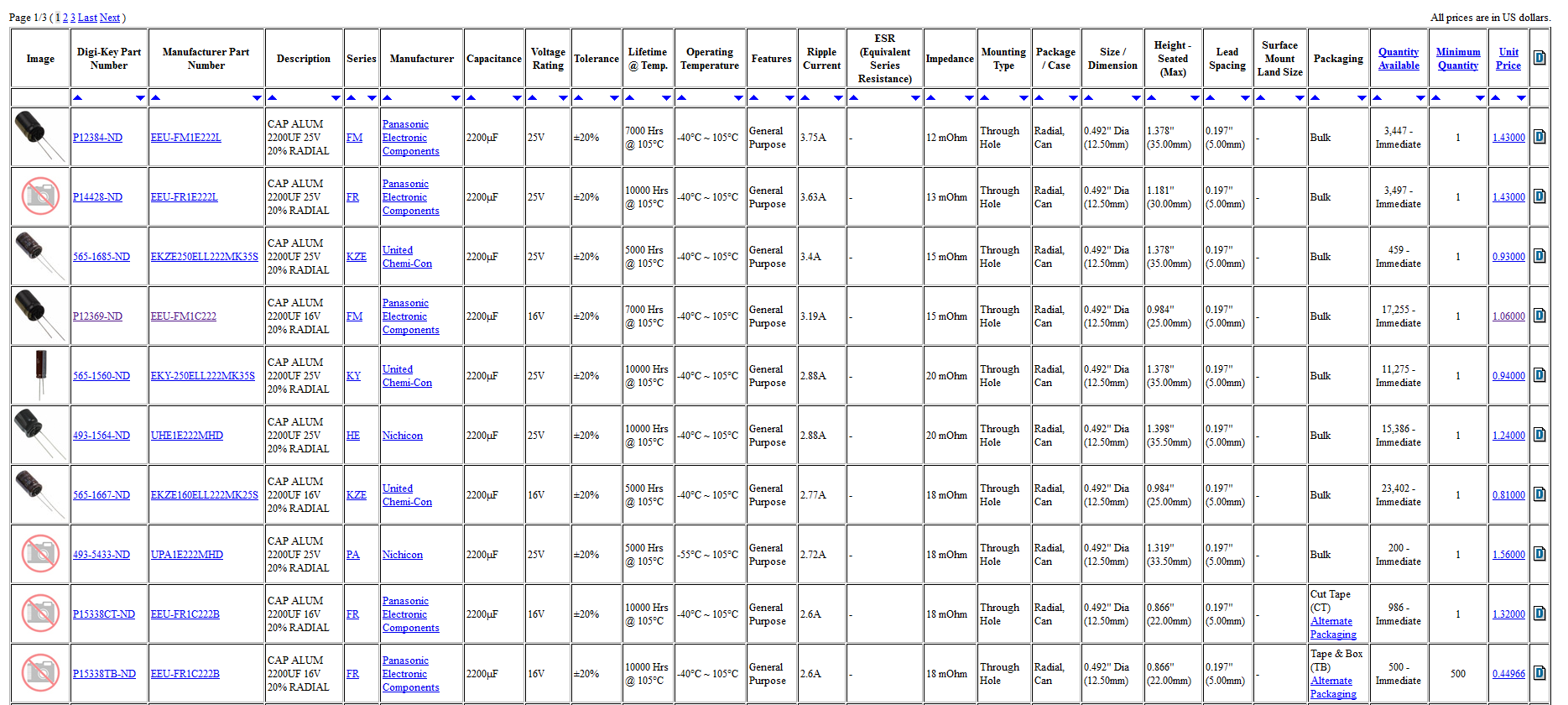

                  So for 2200uF 16v I would go:
                  in stock, through hole, up to 14mm diameter (your old cap is 13.5, i assume there is room for 14mm) , 16 and 25v, 2200uF
                  sort by ripple
                  and I'd get a page like this:
                  The original specs for this 2200uF 16v are: 2200uF 16v : 13x25 (diameter x height) , 2750mA ripple , 0.022 ohm impedance
                  You can see by the last record in the picture, my ripple value is already below the 2750mA value.
                  Now of course, surely the circuit wasn't design so that the capacitor would be subjected to the maximum ripple all the time, so going as low as 2500mA would probably be fine if you really have no choice, but in this case I have a choice.
                  The first two records look great, much higher ripple value than required, but the impedance may be just a bit too low, compared to 0.022 ohm. If I had little choice, I'd pick these first two, but I have capacitors with slightly more esr below to pick from.
                  So the third record is still 25v rated capacitor (UCC KZE), but being another series it has 0.015 ohm ripple... which is still much lower but in my mind, within acceptable limits to 0.022
                  Panasonic FM 16v is still 0.015 ohm esr, just like KZE, but has less height at 25mm... Your original capacitor had 25mm height but if KZE was cheaper (it is, 0.7$ for 10pcs while for FM you get discount only at 50pcs) and you have 35mm height to work with (no heatsinks above your capacitor), there's no reason you would reject the KZE capacitor.
                  But going down, you start to get almost identical specs, like the KY 25v or Nichicon HE which have 2880mA and 0.020 Ohm
                  Even the KZE 16v below it has closer specs.
                  And even though at ripple it's a bit lower than 2750mA, I would have no problems choosing the Panasonic FR 16v that has 2600mA ripple. It's close enough to be comfortable with the decision, i'm sure the capacitor won't really see that much ripple in its life.
                  See, it was easy.
