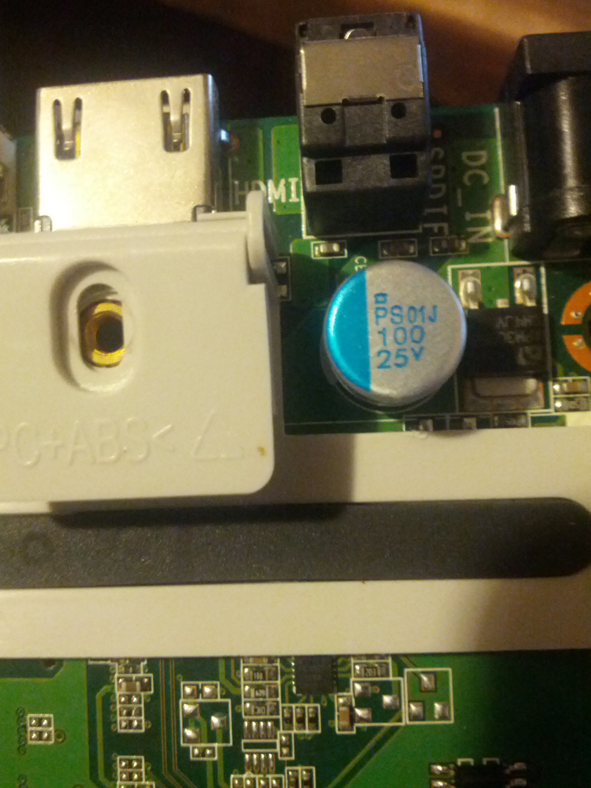

    I need help identifying the blue striped silver capacitor in the attached image.
    It is located near the power connector on a motherboard, the voltage rating for the motherboard is 19V.
    The capacitor was damaged during a hard drive removal, it was bent enough to damage it as the motherboard no longer passes POST and simply power cycles on and off.
    I am guessing that its 25V. Does the 100 mean 100uF? Is it aluminum electrolytic?
    Thank You

    United Chemi Con NPCAP PS :
    Polymer, through hole, 100uF , 25v , 3320 mA ripple, 24mOhm impedance/esr

      I managed to find a site selling the cap in a qty less than 1000.
      I am hoping this will fix the problem.
