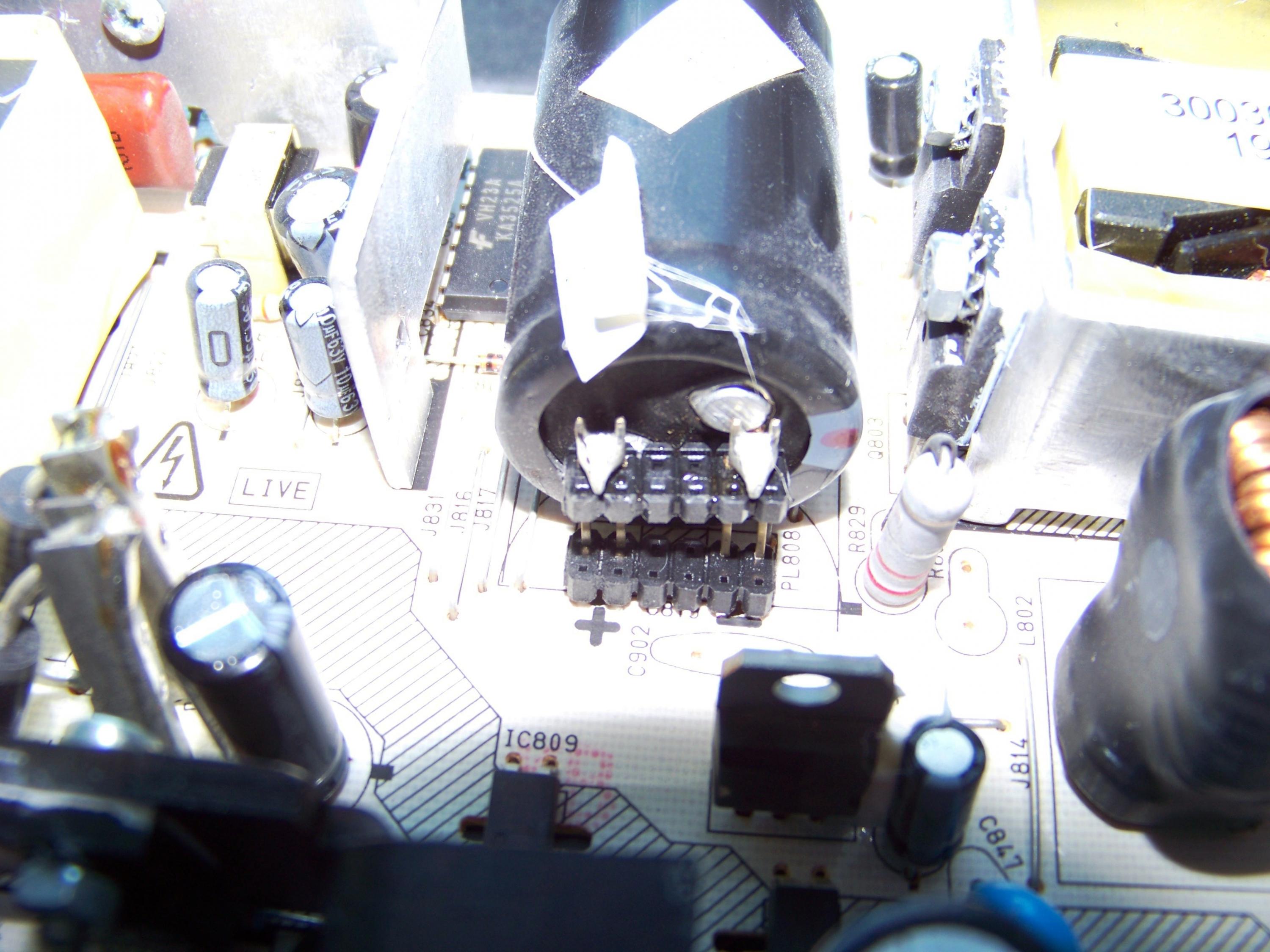

              can you just put short legs on the snapin - I have a ps im working on and that is how the manufacturer did it - course it is a VesTel!!!!
              Post a picture of the area it has to fit and we might be able to come up with ideas

                  Re: Extending capacitor leads?
                  This is what they did to mine!!!
                    LOL!
                    But yeah, I dont think a few cm (or inches) will hurt, if you want to be sure, use nice thick wire. Thin wire will have lots of inductance, and it will have a smaller current capability.
                      Ah yes, 17PW15/20... what a mess of a PSU!! That is only one of my complaints about it.
