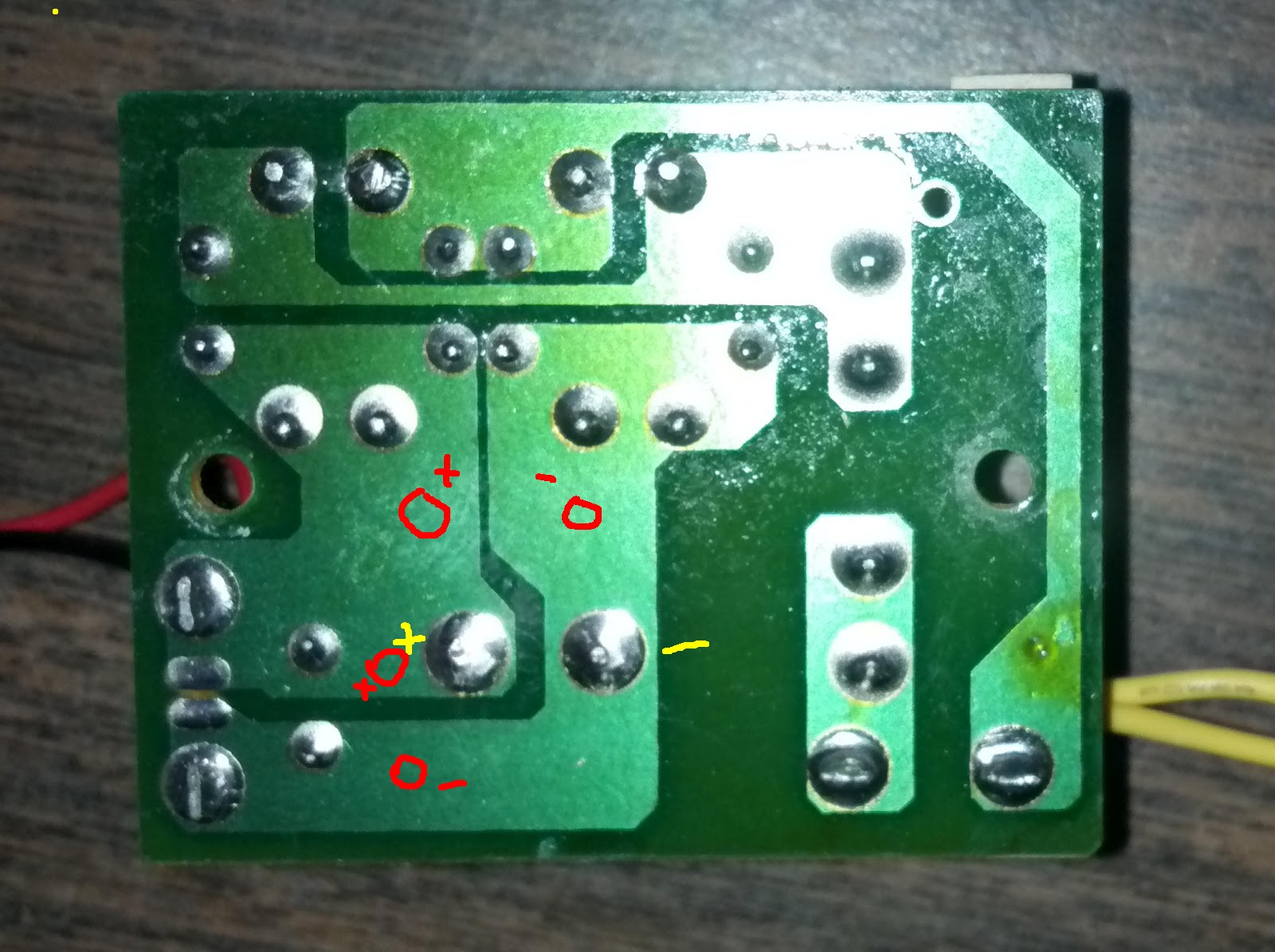

                  Re: Capacitor substitution
                  picture is worth a thousand words.
                  Yellow is input AC voltage from transformer. Red and Black DC output.
                  Any idea what the little ceramic disk caps are for in the rectifier circuit? Couldn't find a similar circuit on line.
                  Oh and should I add a bleeder resistor after the large cap? if so what specs? This thing holds a charge when power and load are removed.
                    A capacitor of this size should leak by itself within about 5-10 minutes.
                    Also, since we're talking of a 16v power supply, you'll only have 16-18v on that capacitor so it's unlikely to give a shock, unless you lick the terminals - the skin has a bit of a resistance.
                    You can desolder that capacitor and solder two 1000uF instead... if you can route both wires of the capacitors through the holes if they're large enough and mount the capacitors horizontally on the board.
                    Or, better... carefully drill the pcb and scratch away the insulation from the copper pads and solder the capacitor wires on the copper....
                    Two capacitors in parallel will have double the capacity so you can just solder additional caps:
                    Click picture to zoom it...
                    PS. This board is not actually the power supply, just to be clear. The AC voltage from the transformer (not 115v AC, around 12-15v AC) comes through the yellow wires, goes through the fuse and then goes through the four diodes at the top. Next, the rectified voltage goes through the two capacitors at the bottom.
                    The capacitors near the diodes I assume they're used to attenuate the effect of the voltage drop on the diodes (0.4-0.7v) and that very short moment the diodes commute their state.

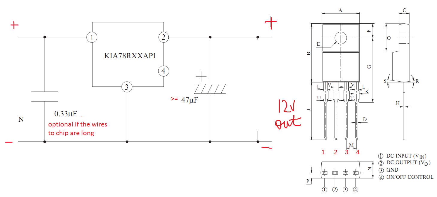

                            On an old LCD power suppy board I found a
                            KIA78R12API
                            It looks like it would work but I am not sure how to wire it.
                              That one has 4 pins :
                              IN (DC)
                              OUT (DC)
                              GND
                              ON/OFF (unconnected = ON)
                              So you connect the + of that board to the IN of this chip, GND to GND pin, and you connect two wires to the OUT (+) and GND (-) and that's your 12v output. The ON/OFF you leave floating in the air, the chip is by default ON.
                              Note that this chip is rated for maximum 1A, so it will probably turn itself off and on if you pull more than 1A from it.
                              (minor correction: that's "optional, **should use** if the wires from the input capacitor to it are long, say... more than 5-10cm)
                              You'll NEED a heatsink for it otherwise it will keep turning itself off and on due to overheating if you use it with more than about 12.5-13v.
