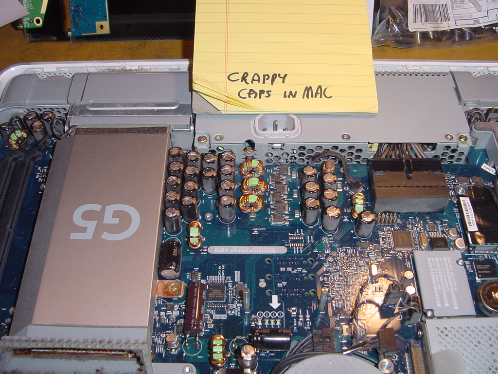

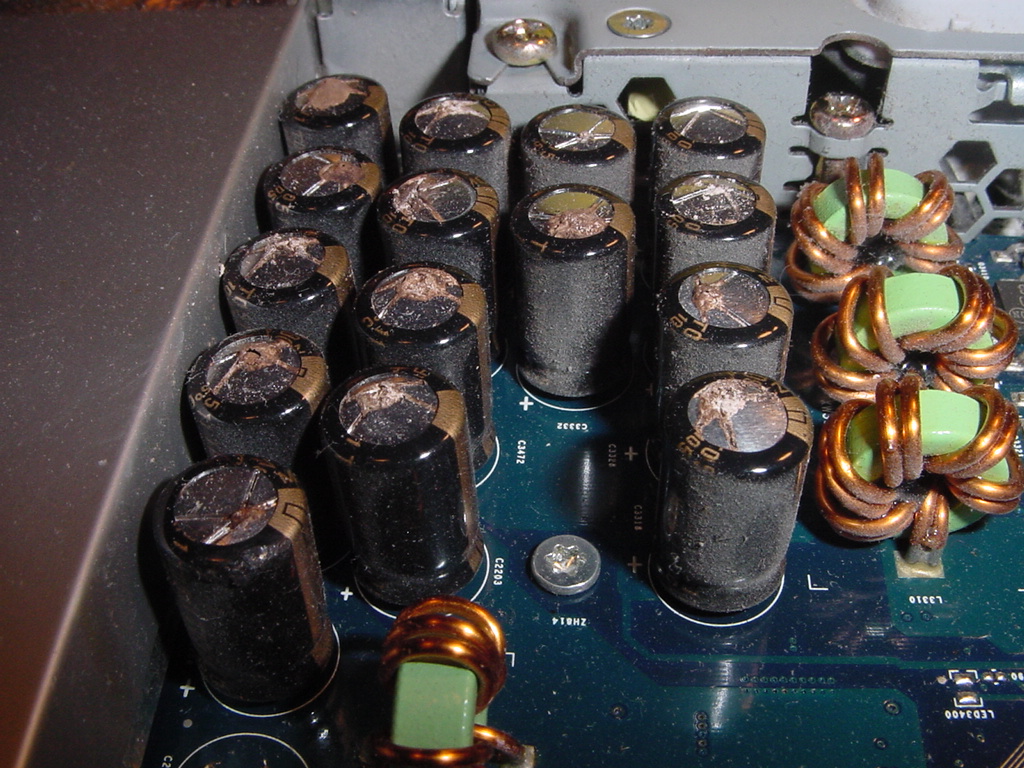

Failed RUBYCON MCZ caps in iMAC G5
    Failed RUBYCON MCZ caps in iMAC G5 mother board.

    Amazing. The ones I fix usually have a couple of good caps left. Yours was good to the last drop.
    A badcaps kit puts them back on the road!

      Those G5s run hot enough to cook the caps, which is probably why they failed.
