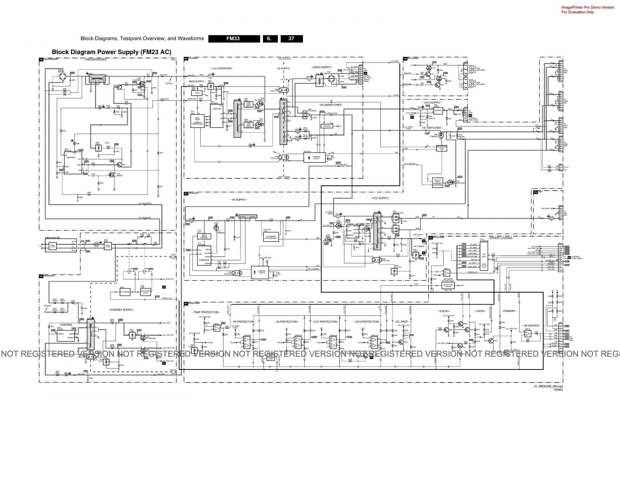

                My issue is plug it in the wall stand by red light comes up, switch it on with the remote, then light goes green for about 5 sec and then constantly blinking red until I switch it off (remote doesn't respond on switch off command). The display doesn't light up and no sound.
                Through some internet search I found that if standby voltage is low like in this case then the blinking occurs. There are no bulged capacitors on power board and 9V stand by is 6.5V roughly.
                I am very bad reading schematics and so on but after looking at the one I attached to the post the voltage after the transformer "5500" should be 9V but its 6.5 there, all other voltages like 5V and 3V are there which apparently derived from that 9V and in my case from 6.5V.
                Can it be that the transformer is not completely failed but on the way there?
