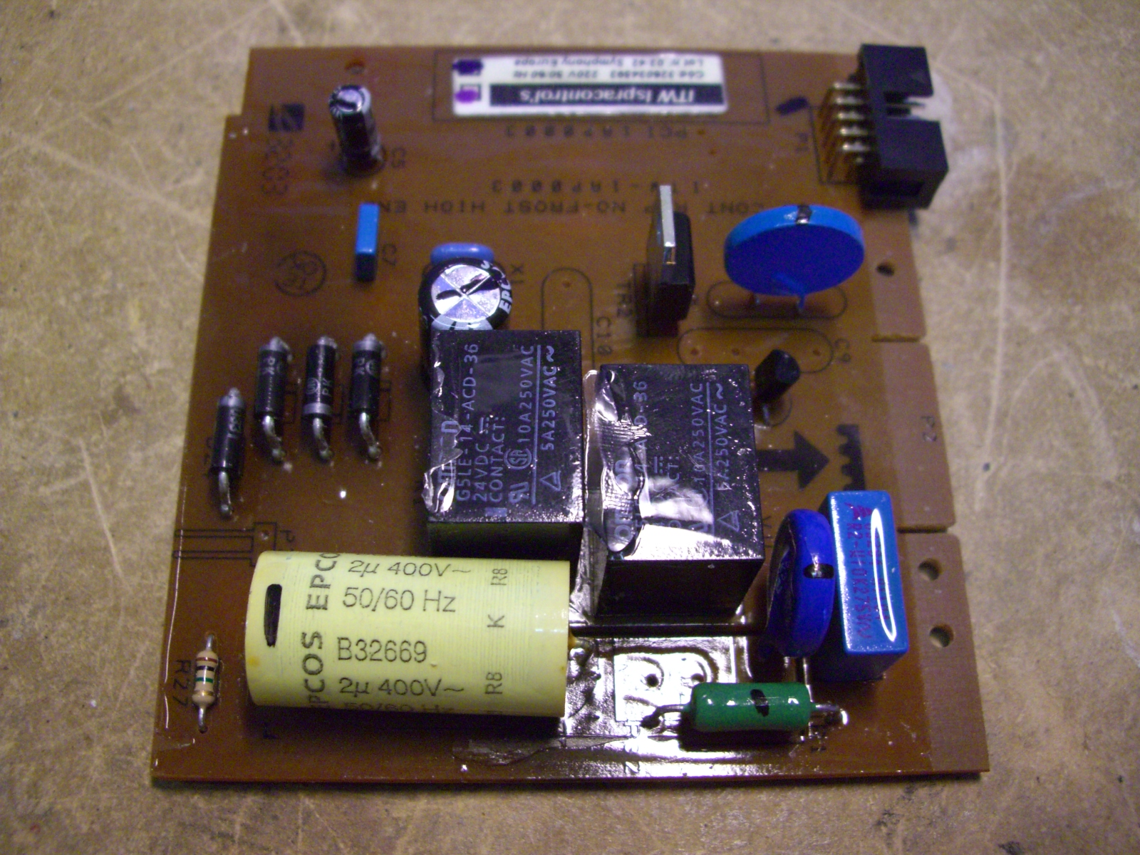

          Do you have a picture of where the capacitor goes?

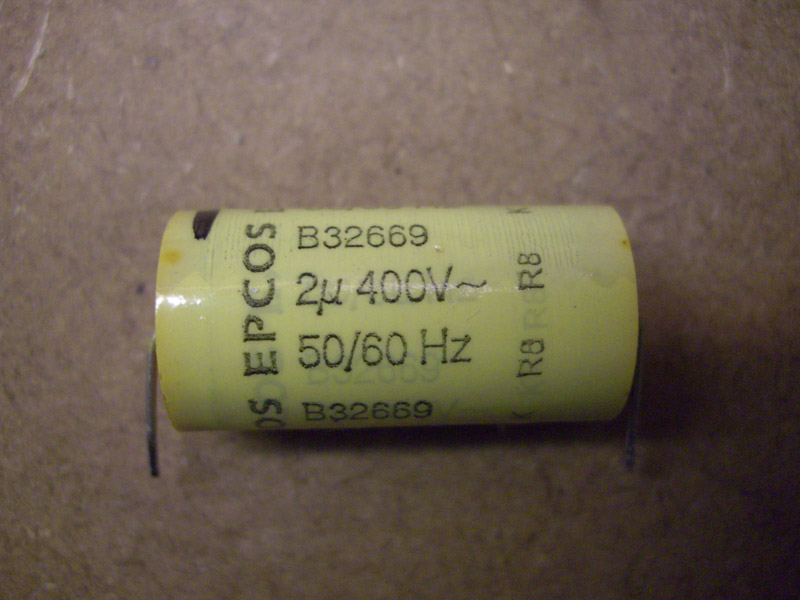

            This is the original cap removed from the board. It's only showing a capacitance of .5uf on the meter. I managed to find the exact one on uk-mouser but with a minimum buy of 265 units !!
            Rant Time .... this is the 21st century and an otherwise perfectly good fridge freezer will be scrapped because of a £2 part that is unavailable to buy as a single piece.
            Someone somewhere must have one of these, or an equivalent, but i'm ****** if i can find one.

                        the ones at mouser are electrolytic and dc. I need 875vdc/400vac. I have found a good match B32674D8225K but nobody has stock.....just have to wait i guess or tell them to buy a new freezer...

                                Original is a film cap.
                                https://cdn.badcaps-static.com/pdfs/...3a46754070.pdf

                                  Also note: The manufacturer's data sheet doesn't mention 875 volts anywhere.

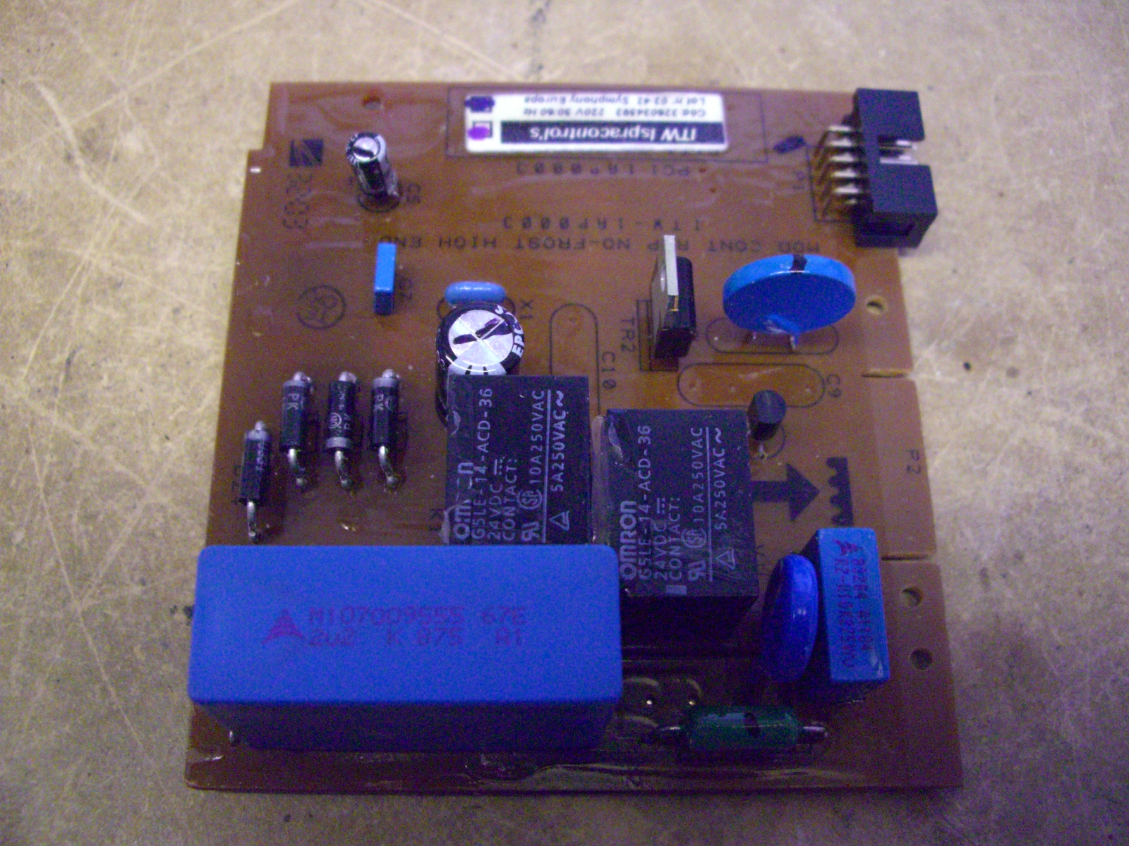

                                      Well ... you'll all be pleased to know that the freezer is working again...
                                      the two pics are before and after. I replaced the small triac too as it was sometimes giving dodgy readings.
                                      Fitted it today and the freezer fired up like a good un...
                                      Price for appliance man to come out and fit new module = £200
                                      Actual cost for parts and repair = £4.98
