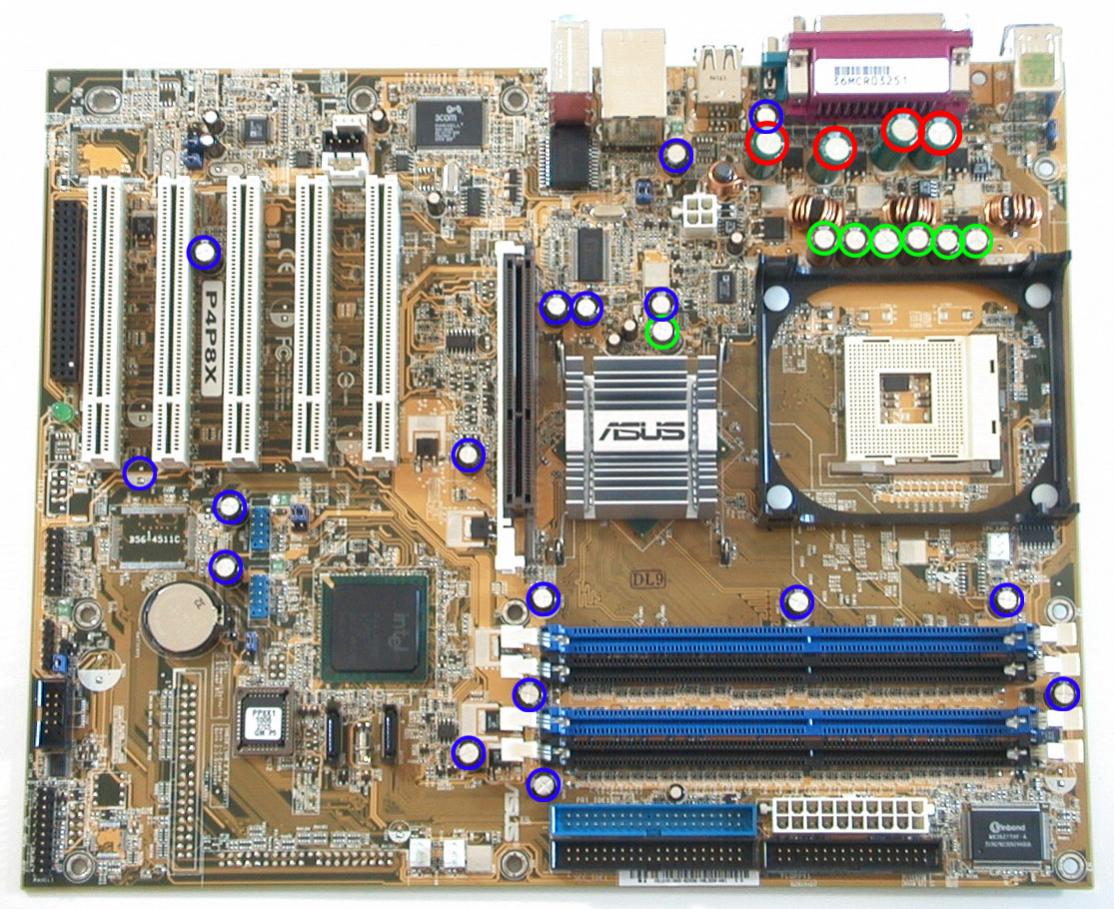

            i want to repair some older Pentium3 Motherboards for practising, after that I have planned to repair some broken Pentium4 Boards and after that I have a broken K8 board.
            additionally I have two PSU's with broken caps (one 200 watt fujitsu from one PIII Computer and one 600 Watt Tagan PSU)
            over all I have over 10 different Motherboard with cap-problems to repair, mostly asus, asrock gigabyte, msi, nmc and fujitsu from very old PIII to AMD K8

                for example board one ASUS P4P8X
                The Broken Caps:
                marked green (color: dark-blue with gold print)
                Lable:
                RLZ
                105°C
                0340
                OST
                6.3V
                1500uF
                Additional Caps:
                marked red (color: dark-green with white print)
                (M)105°C
                3(7)
                0V
                KZE
                16v
                1200uF
                and more 1000uF caps
                marked blue (color: black with white print)
                RLS
                105°C
                0341
                OST
                6.3 v
                1000uF

                  The OST RLZ are cpu vrm output caps.
                  You could replace them with: Rubycon MBZ,MCZ, or Nichicon HN,HZ.
                  The rubycons are sold at on this site and the Nichicons should be available at mouser or digikey.
                  The KZE caps are United Chemicon which are considered reliable.
                  The OST RLS woud be replaced by rubycon ZL (there should be more similar, but I'm rather new here.)
                  good luck.
