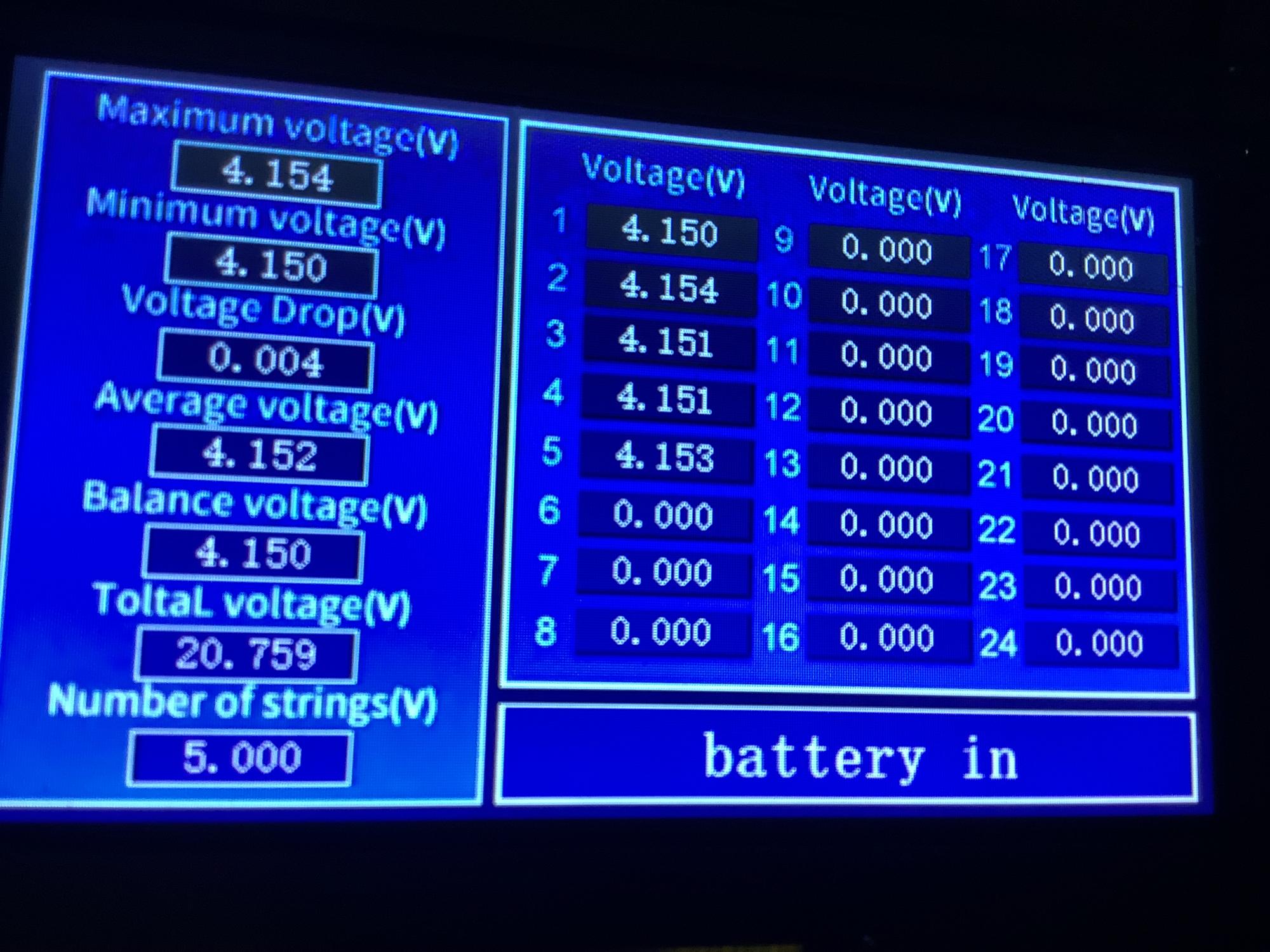

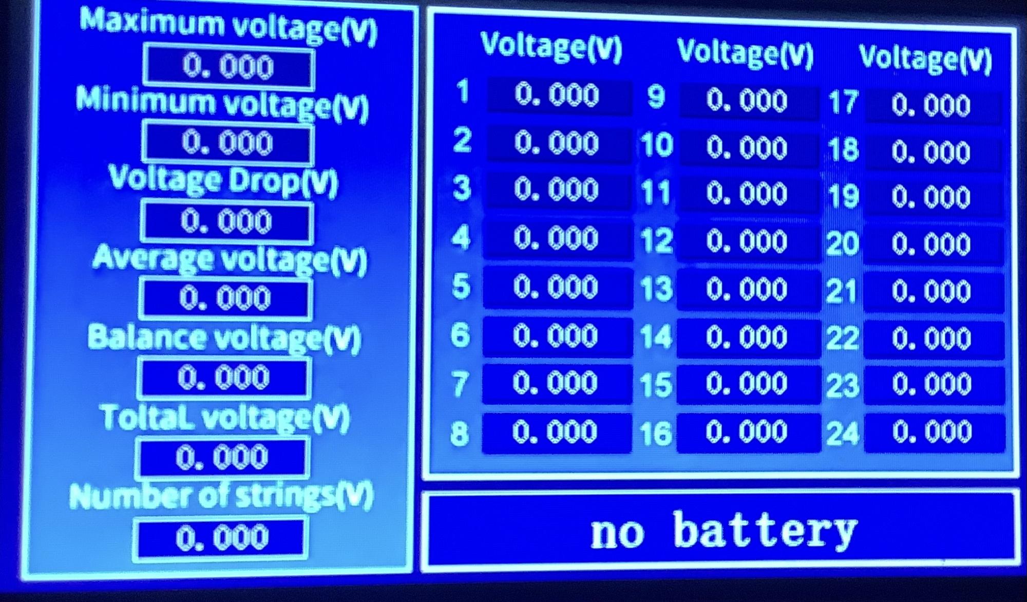

            Finally arrived today in the mail I powered it up just to make sure that powers ON and that the device was not damaged in any way

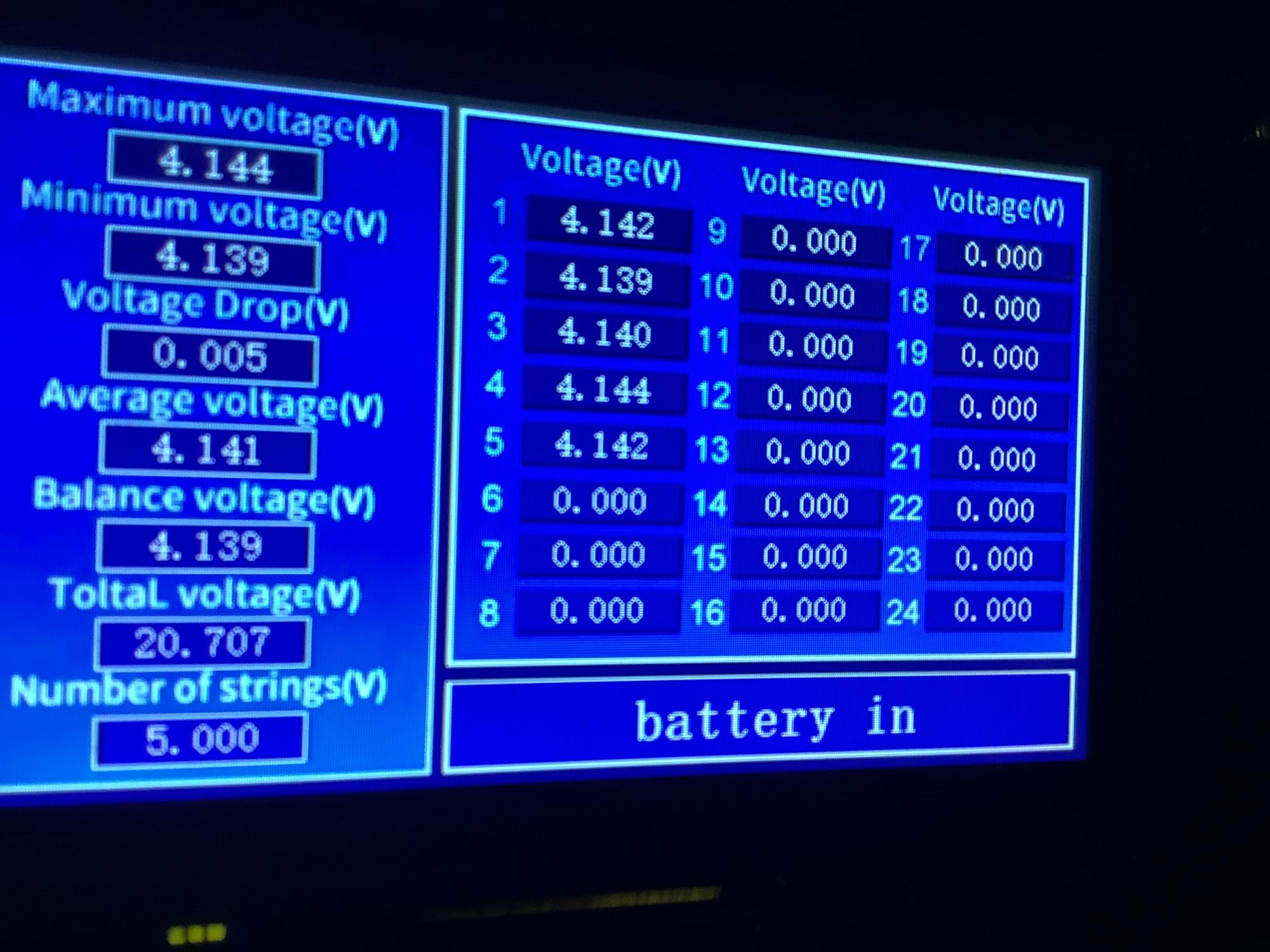

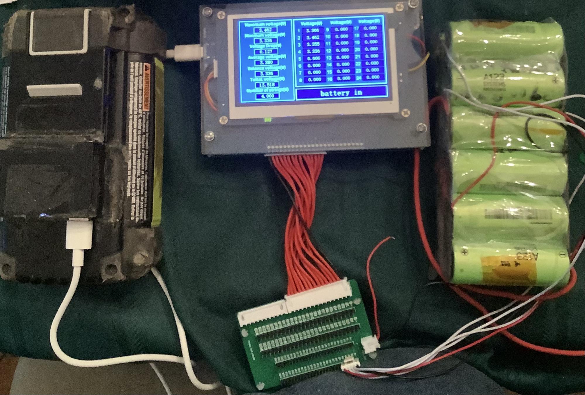

            Here are the results from the battery packs that are for the battery operated air compressor
            This will do exactly what I want it to do I just have to make the testing jig so I can hook up the the SkyRc battery charger to it and or a BMS balancing protection board to see how well it behaves in the balancing mode
            The left side of this display has some very interesting data that can be very informative about the battery pack

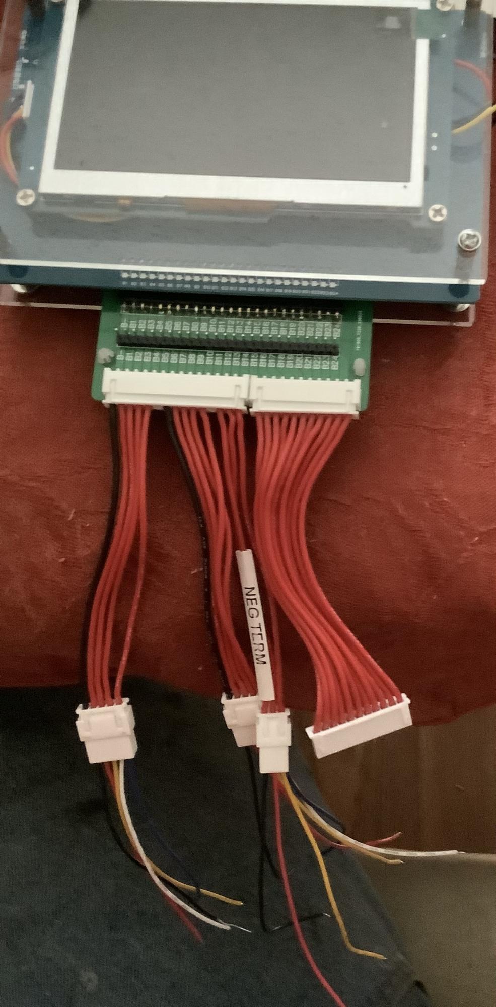

                How do I determine what type of JST pitch and spacing this connector configuration this that is used on this BMS balancing protection board
                What I do know is that it is 24 pin JST type connector
                Because I want to modify the connector so that I can put this single cell voltage in series with the BMS
                I could buy two 12 pin BMS balancing protection boards for the JST connector but I really do not have a use for 12 pin BMS protection boards right now

                  use a caliper to work out the pin spacing

                    I do it same way as stj. I’ve got the pins and work out the size and spacing using a calliper.

                      I looked at Digikey website last night for JST connectors and found some but there are several different types so I am not sure which style it is

                            There is a picture of the connector on the website link and the picture below
                            JST XH Pitch 2.54mm
                            As you can see in picture below this battery pack is not very balanced this is why I need a balancing board for battery packs that I going to use my own charging device

                                    Well did have some time this early morning to make up some connectors “see the description” as you can see in the picture below
                                    “DIY Toy JST XH Pitch 2.54mm 2~12P Connector 100/200/300mm 26AWG Cable Wire”
                                    I also ordered the same type except that they are 2.00 pitch not the 2.54 because I both types of connectors for some BMS protection boards that I have and I want used them and watch them charge and discharge when testing them

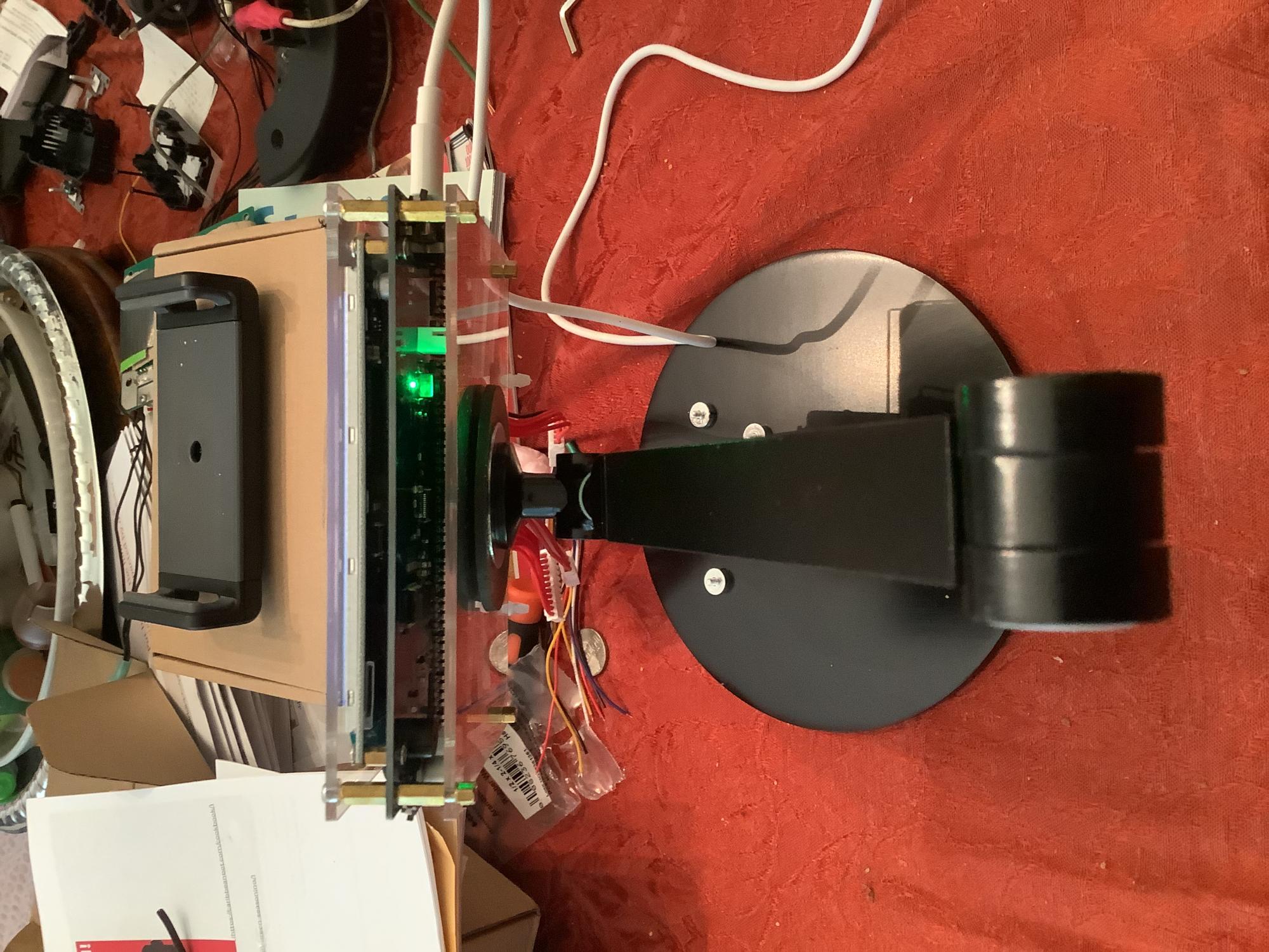

                                      Well I found a stand for my battery BMS voltage monitoring board in the one picture you will see a
                                      ( red circle around the )
                                      tablet holder that is suppose to on this stand but instead of doing that I put the battery voltage monitor on it instead I used two fender washers and two rubber washers and sandwiched the plexiglass in between the washers
                                      Now I need to spend some time working on the switching power supply and it hookups to the battery voltage monitoring board
                                      If anyone is interested in the tablet stand please let me know and I will post a website link on EBay to where you can get one
                                      One note not all tablet stands are the same and some of them do not have it where you can take off or just not use the tablet holder itself and just use the stand
