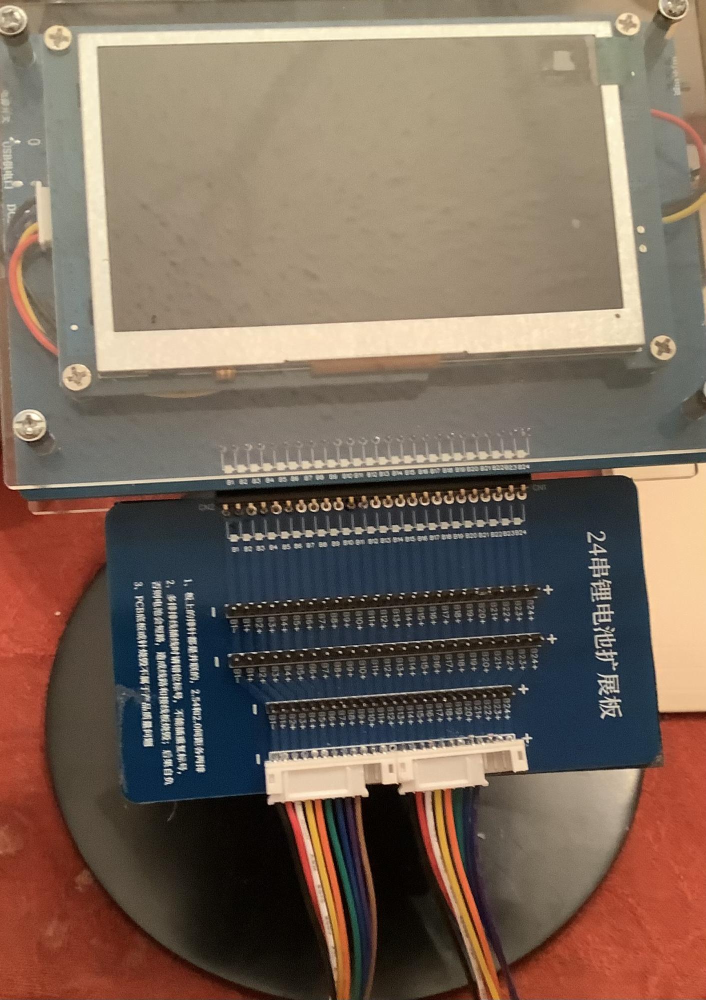

            Update on the 2.00 pitch connectors
            I used some connectors of a incomplete BMS protection board that I could not reuse so I reusing some of the components of the board for the same purpose but in a different configuration
            Using these two connectors I loose numbers 12 and 13 when using these connectors not bad I could put a wire in the empty connector and then I would have all of meter connection which I might do later if needed for a battery pack but right now I can except the fact I loose two meter readings

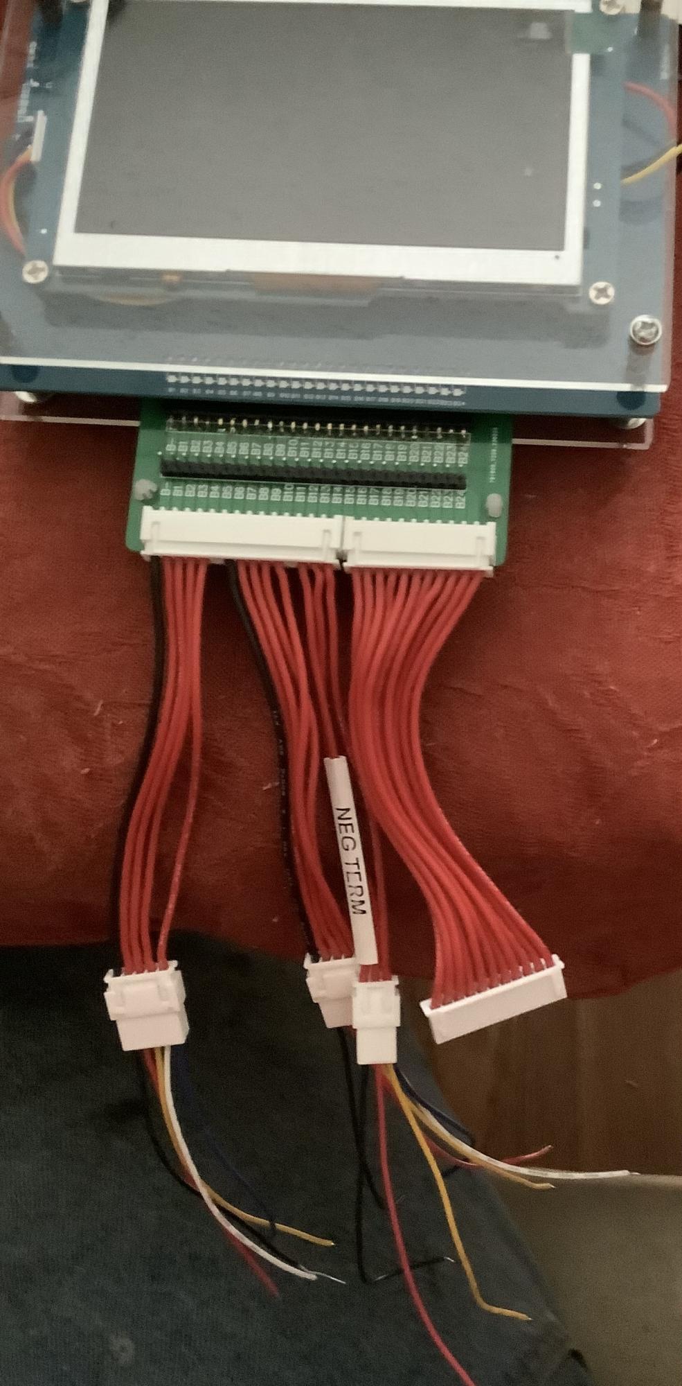

              Re: Found this 2~24 Series Lithium Battery Equalizer device,is it worth the money or
              I ended up putting a two pin connector on the bottom of the and removed one of the wires so I would not short circuit the battery cell by accident

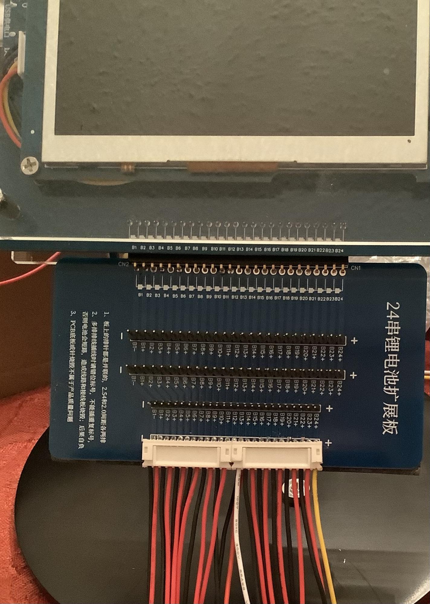

                I just finished putting new wires in the one of the two connector ( in post #25 is a picture of the board that I am taking about ) that was for the BMS protection board of a 36 volt battery pack that I modified the battery pack that I wrote up a post a few months ago I will be taking this battery pack apart again to add this meter module for multi battery cells so when I put the battery pack on charge I can see what all battery cell rails are doing in real time
                Now I have to remember where I put the other two female connectors that I have so I can make up the other side male connector
                This project is a work in progress and as I have time to devote to it I still have to make up cables for other battery cell configuration which is going to take some time to complete
                I have both versions of these connectors to do for both boards the 2.00 mm and the 2.00 mm pitch connectors
                  • Jul 2011
                  • 6070
                  Well I found the container that had the BMS board in it and I also found the container that that had the female connector ( unfortunately there is one connector that has not been found yet) in it so I was able to complete the individual battery cell connector so now I have to put the battery holders on a cutting board so they will stay in place it is also going to be used as testing jig for selecting and matching battery cells together while they are changing and discharging cycle curves
                  In the picture you can see that the connector on the right side has a white wire and a yellow wire on the other end of the connector these two wires are not being used when testing individual battery cells
                  The white wire is to let me know not use it in individual battery cells function and the same thing with the yellow wire
                  Now when testing a 24 battery cell function then I would use all 25 wires instead of 23 wires in the single battery cell battery testing mode
