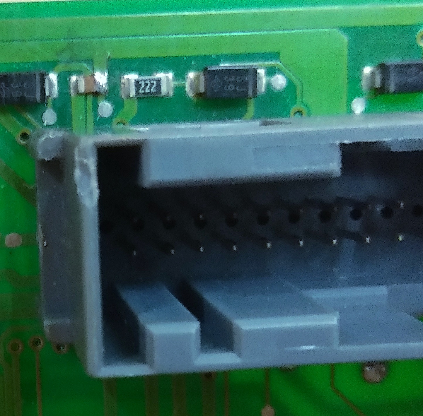

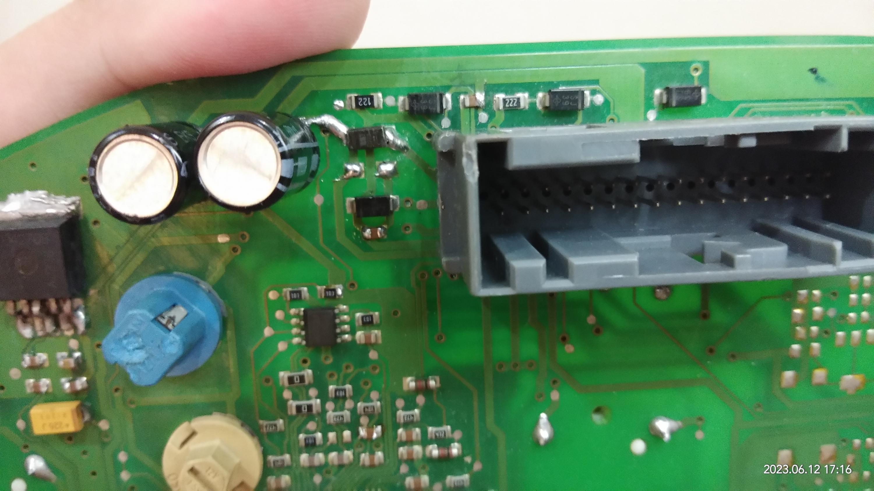

    Hi! I hope someone can help me out cause I'm looking into replacing one of the barrier diode that is faulty on my VDO odometer circuitboard due to short circuit lately. The part has marking on its body which reads "SJ" on the upper row while "39" on the lower.
    Close-up photos included for the part and the numbers but the problem i can't find this part for sale anywhere. Oh! I don't even know if this part has any datasheet available for free online. So I wonder does anybody know any suitable replacement ot something equivalent to it?
    Thanks ahead..

    It's a S1J surface mount rectifier , Originally made by General Semiconductor Inc. which Vishay Intertechnology has acquired in a $538.9 million stock transaction exchanging ...
    Attached is its specs within its series , and you can still find it depending on your location otherwise , you can acquire a similar one from vishay ..

      Thanks a lot for your responses, the info you given here is very much useful and correct. I'll post some of the follow up repairs of the VDO odometer circuit board which i'm currently working on after i buy the replacement parts frm my local online store. Cheers!
