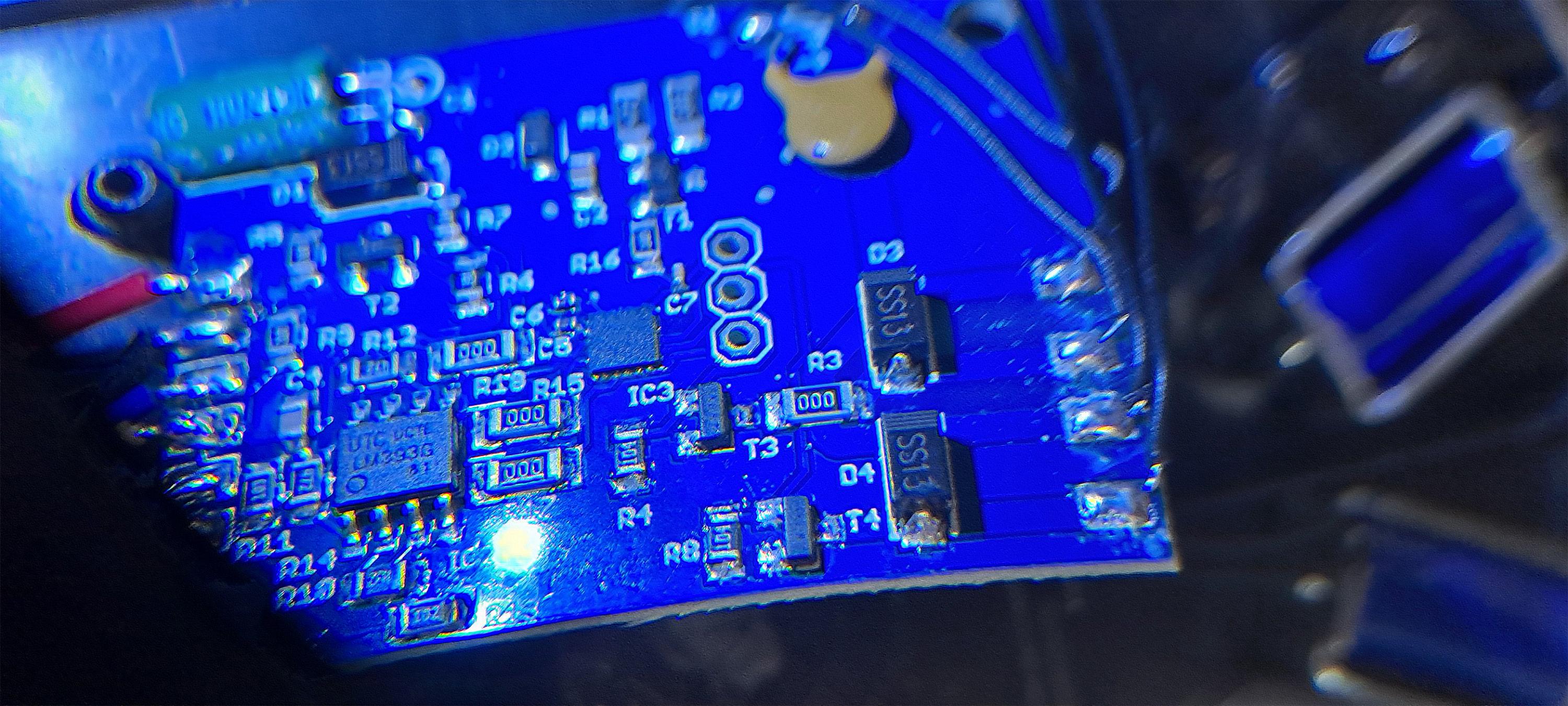

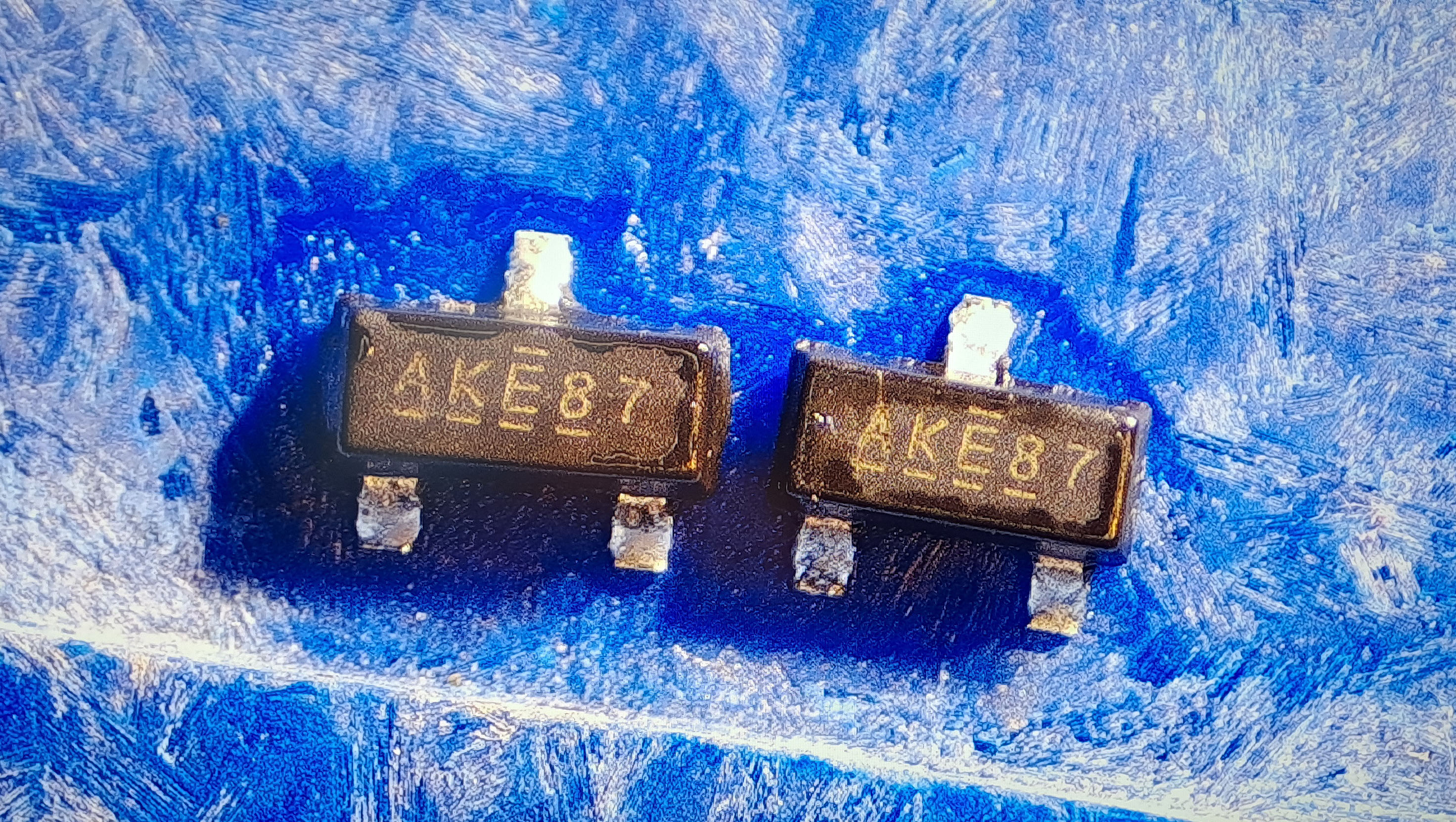

    I am trying to fix a dead lane switching track piece for slot cars made by Carrera. I measured component on PCB and found out that at least two components have gone bad. I suppose they are transistor which drive the solenoids. Their marking is AKE87. Those components are marked T3 and T4 on circuit board. I tried to search that marking from the internet but didn't find anything. I would like to know if those are transistor and what could be used as a substitute.
    Any help is greatly appreciated! Thanks in advance!

    Sorry for bad picture of PCB. I took it through a magnifying glass. In the right side there are four connections. Those are connections for two solenoids which move the lane changing mechanism.

        It could be a digital transistor (has built-in base resistors). You'd have to know the pinout and if there is a base-drive resistor to the MCU. Or it's a MOSFET.
        cross-posted: https://electronics.stackexchange.co...-marking-ake87 saying maybe IRLML2402.
