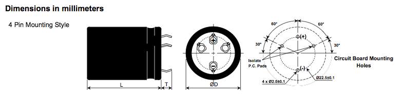

    So I made an mistake when I read the capacitor type and referenced the wrong datasheet.

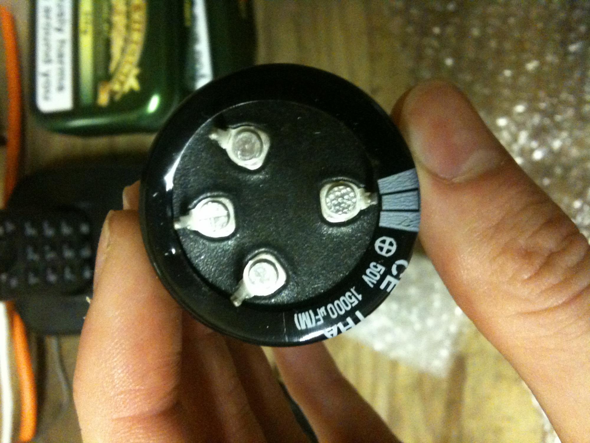

    I'm replacing a snap-in capacitor with 2 legs, the ones I have purchased have 4 legs.
    The datasheet just seems to mention that it improves 'stability' and keys the polarity, I'm assuming it's physical stability, not endurance.
    So as you can see from the image and datasheet, we have positive, negative and two 'isolate' pads. Are they isolated, as in, do nothing? Can I amputate the legs and use the capacitor as a normal 2 pin snap-in?

    The answer to my own question, is that even if I had chopped the extra legs off, the positive and negative legs on these are too wide compared to a standard 2 pin snap-in capacitor.
    Case closed. I'll see if I can exchange these for the right ones with Mouser.

        Check out Panasonic TS-HA, TS-HB, TS-HC, or TS-ED series.
        They're all standard 2 pin radial snap ins and I'm sure one of the series will have the size you are looking for. I have always been able to find the right can size to fit in those four series.
        That datasheet was deceptive usually they have a drawing of the bottom leads with the pin spacings on it.

          ...and if they don't want to exchange it you could get a drill and make new holes in the PCB spaced further apart
          If it is a single layer PCB and there is room underneath that would allow this
          Could even make the two extra holes for support if there is room for that too
