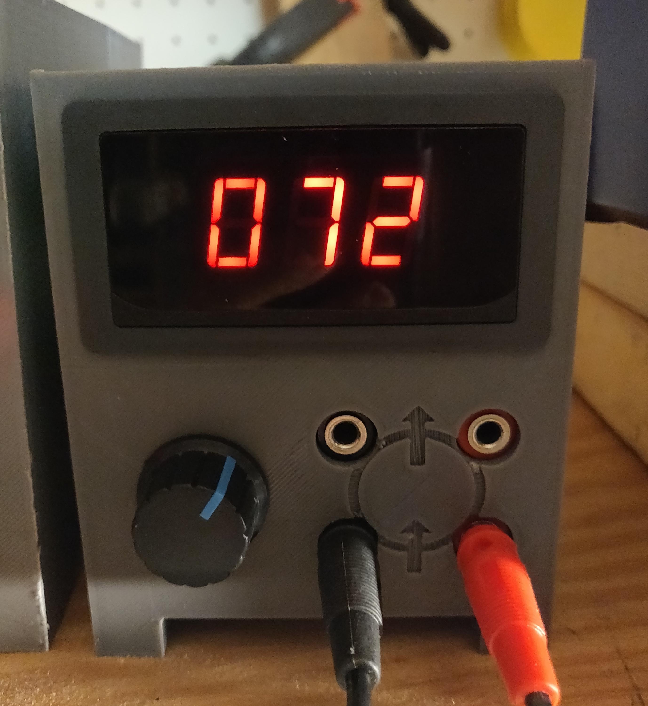

    Anyone build their own equipment? Plans for small benchtop power supply.
    I knocked this together with a 3d printer, some spare parts and a broken laptop power supply.
    Anyone build anything useful?
    https://www.thingiverse.com/thing:4126979

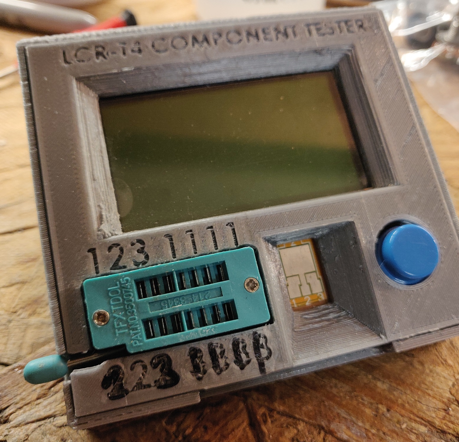

                      Re: Anyone build their own equipment? Plans for small benchtop power supply.
                      Oh, I forgot about this, I did print a case for my lcr-4. It's not my design, and it's pretty rough because it was printed before I really had my printer dialed in, but it's functional enough, if not aesthetic.
                        master hoarder
                        • May 2008
                        • 12175
                        • Bulgaria
                        I like it!
                        As for making the case smooth - I've seen people make their own "hot acetone baths" particularly for making 3D-printed ABS plastic projects shiny / with a mirror finish.)
                        Me - I'm more about function over looks, so I haven't even been bothered to make a case for my T4 meter.

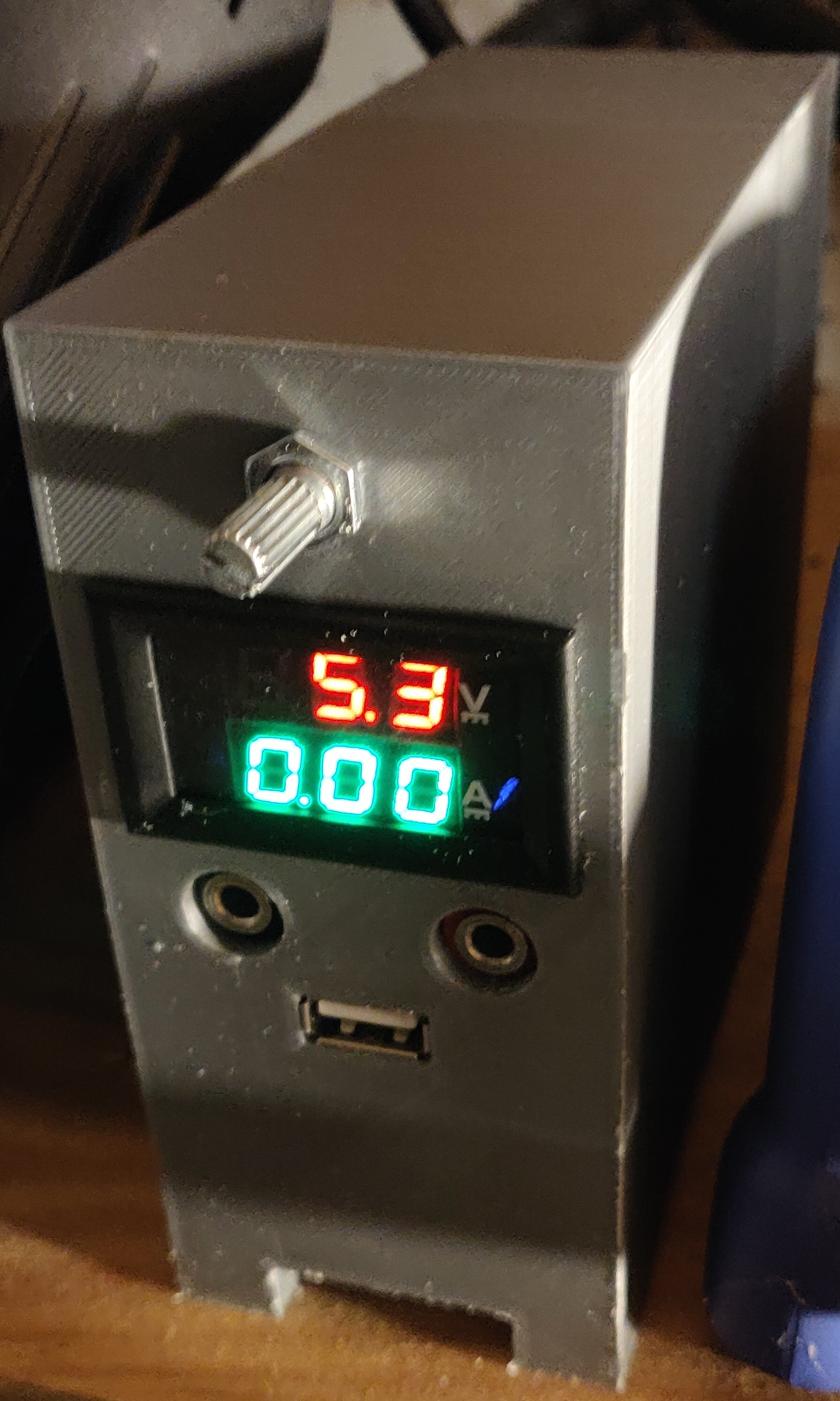

                            New design. CCM5D PWM motor controller. First thing I'm going to hook it to is a computer fan for a fume extractor. No more getting buzzed off kingbo fumes for me!
                            Pretty simple design, also helped that I used a lot of the design from the power supply.
