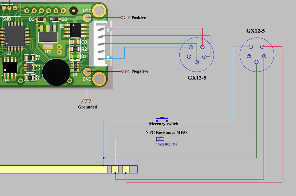

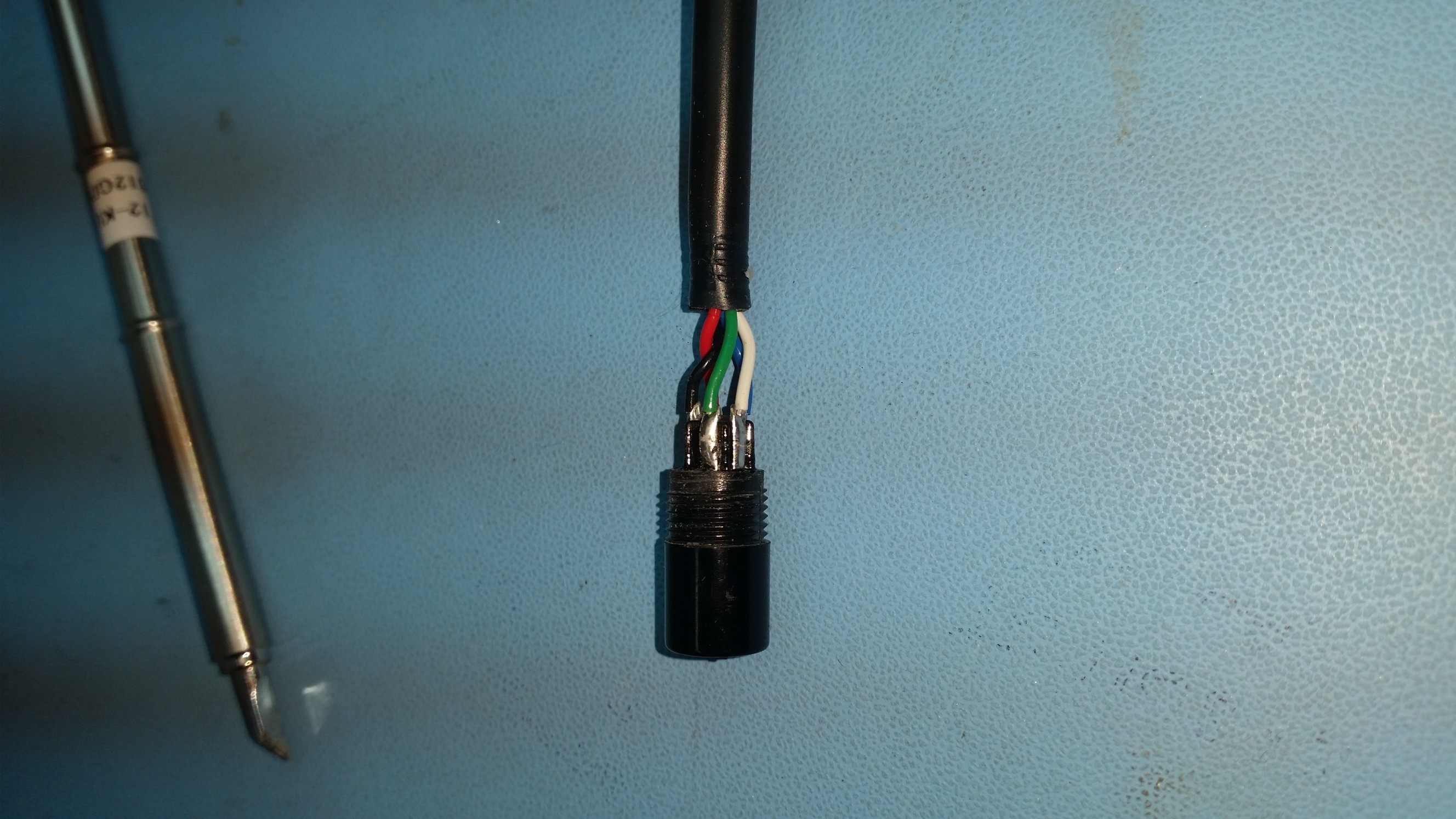

        I'm sure the tip is not making contact. If I measure the resistance between the two rings on the tip then I get a low resistance.
        If i insert the tip I don't get a low resistance between any two pins of the 5 pin connector
        I do get a connection from one pin to the main body of the tip (ground I guess)
        The little PCB seems to be well stuck inside he handle, Is there some technique to getting it out without breaking the wires?

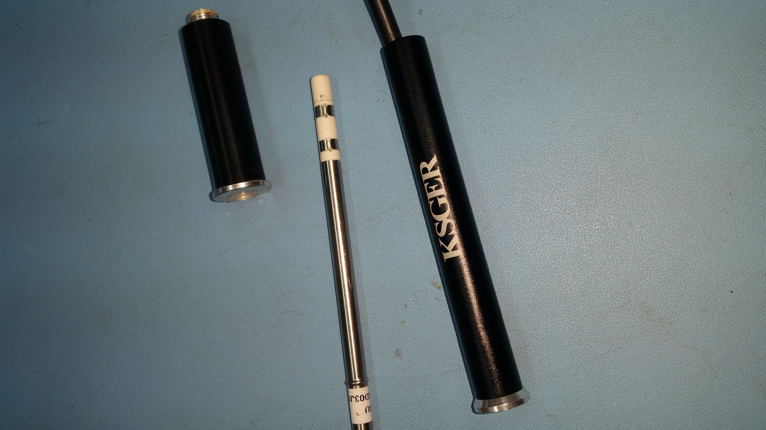

            It looks like the silver end unscrews from the black handle
            • R_J
              • Jun 2012
              • 9588
              Re: KSGER T12 OLED - says ERROR or INVERT
              Cheers
              Does this help?

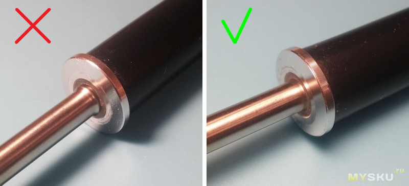

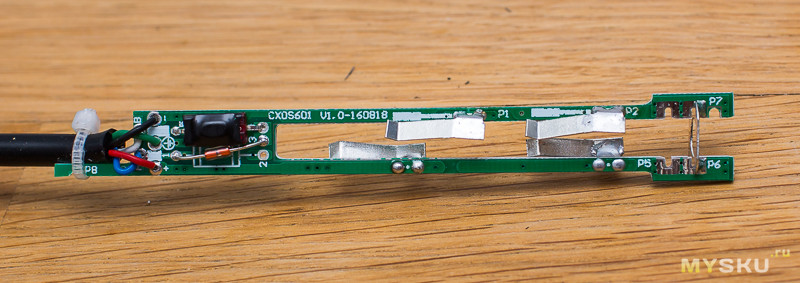

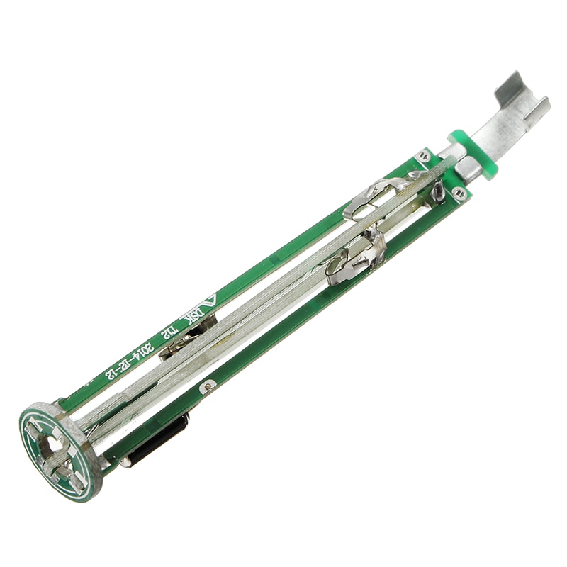

                You might not be putting the heater in all the way, it goes in until the flange in the handle end. This is really important dfor the socket - the higher quality handles have a socket instead of pcb.
                To take apart a 9501 clone handle, unscrew the end-tube at the heater end and push the cable in, so the insides slide out.
                It takes several seconds for the 24V PSU to come up, and then a few more for the RTOS to boot up. I think my station takes 5 seconds before the OLED is on.
                edit: added pics of pcbs

                  You have to move down the strain relieve boot from the soldering iron handle and push the wire cable up the handle and gently pull up the circuit board

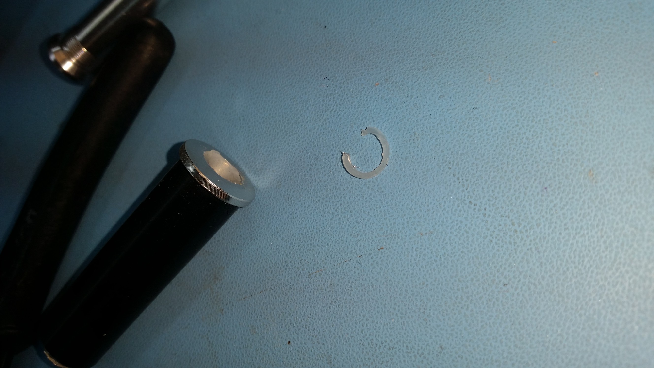

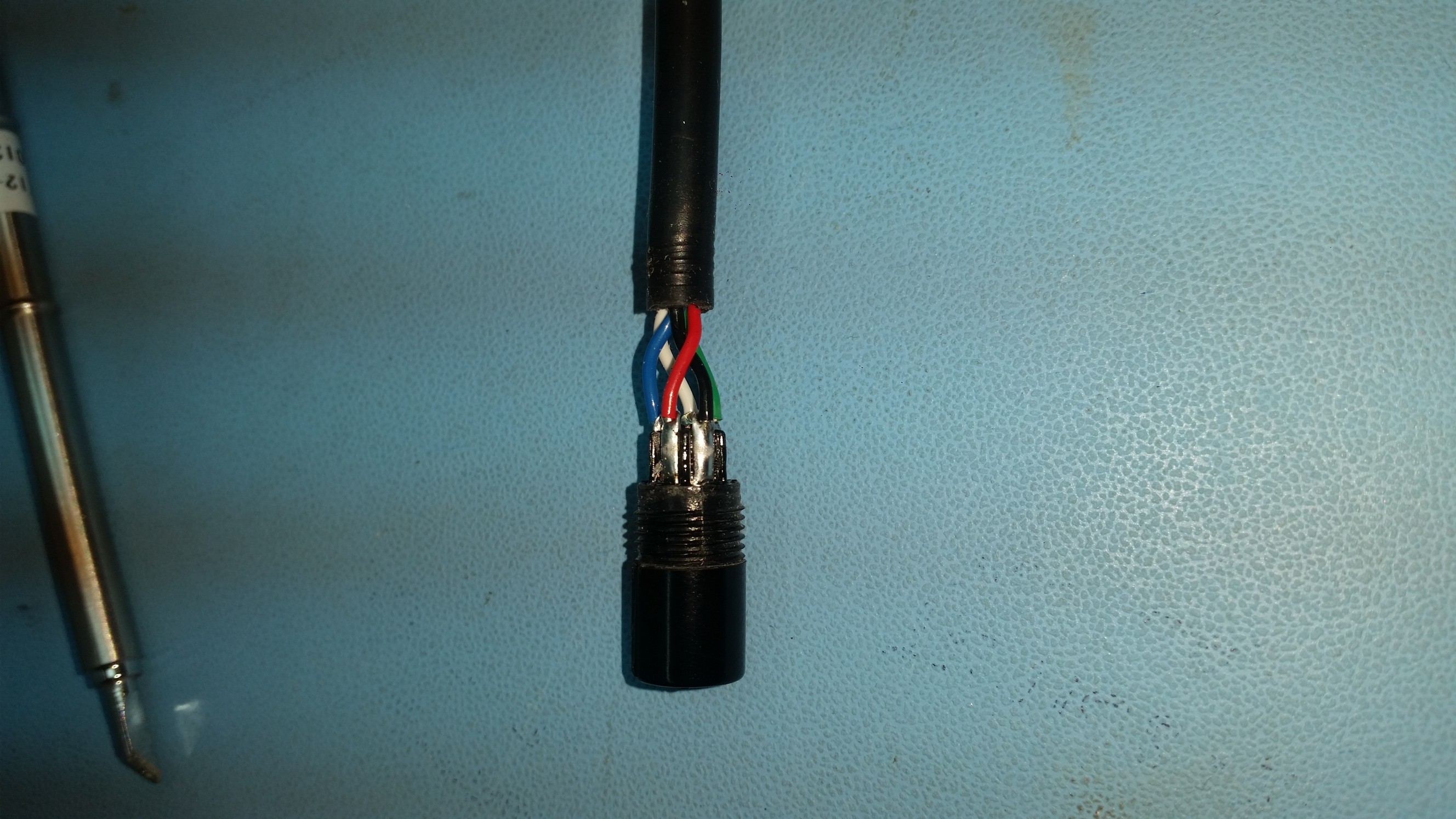

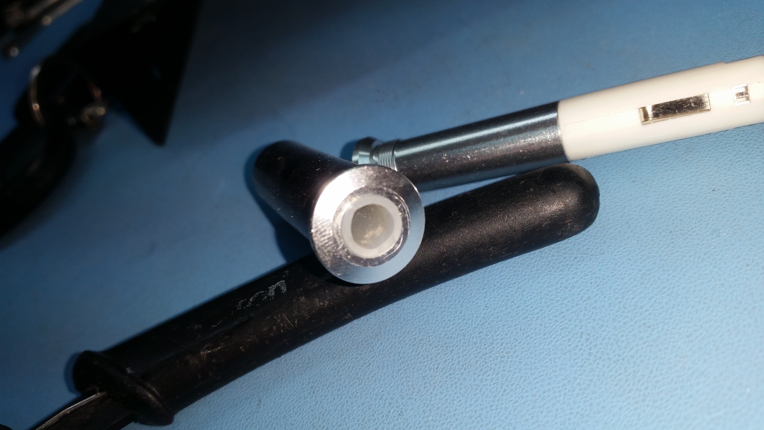

                    I got it sorted - there isn't a circuit board inside the handle it is a plastic thing with clips to connect to the bit (so this is one of the higher quality handles?). The silver part unscrewed from the handle section with the stain relief and the plastic part with the clips was screwed onto that
                    with the iron disassembled and a tip pushed in I could get it to work, but wiith it reassembled it would not. After having a very close look I figured out that the tip can not insert far enough into the handle to contact the clips
                    This is because there is a white silicone insert in the front section of the handle (the end where the tip inserts) and it is a bit too long so the tip can not insert far enough. I had to tease it out a bit with a small sharp screwdriver and slice a couple of mm off with a Stanley knife.
                    The soldering iron now works fine
