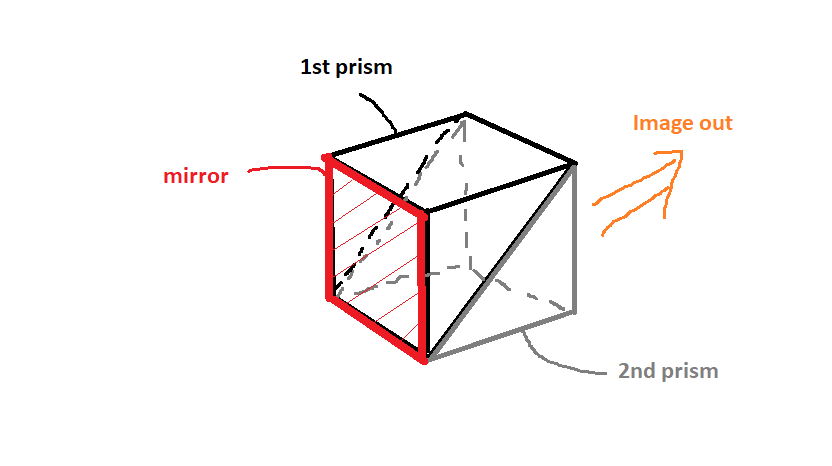

    I see a lot of BGA Rework stations that offer optical alignment and I'm curious about how it works.
    I guess you need two right angle prisms placed in a cube with a mirror on one side like in the attached picture (sorry paint is all I had) but what determines the image size you can see and how does the camera that captures the image work?
    I tried googling but can nowhere find a diagram, so if anyone could draw one in paint or whatever, or has some info I'd be thankful.

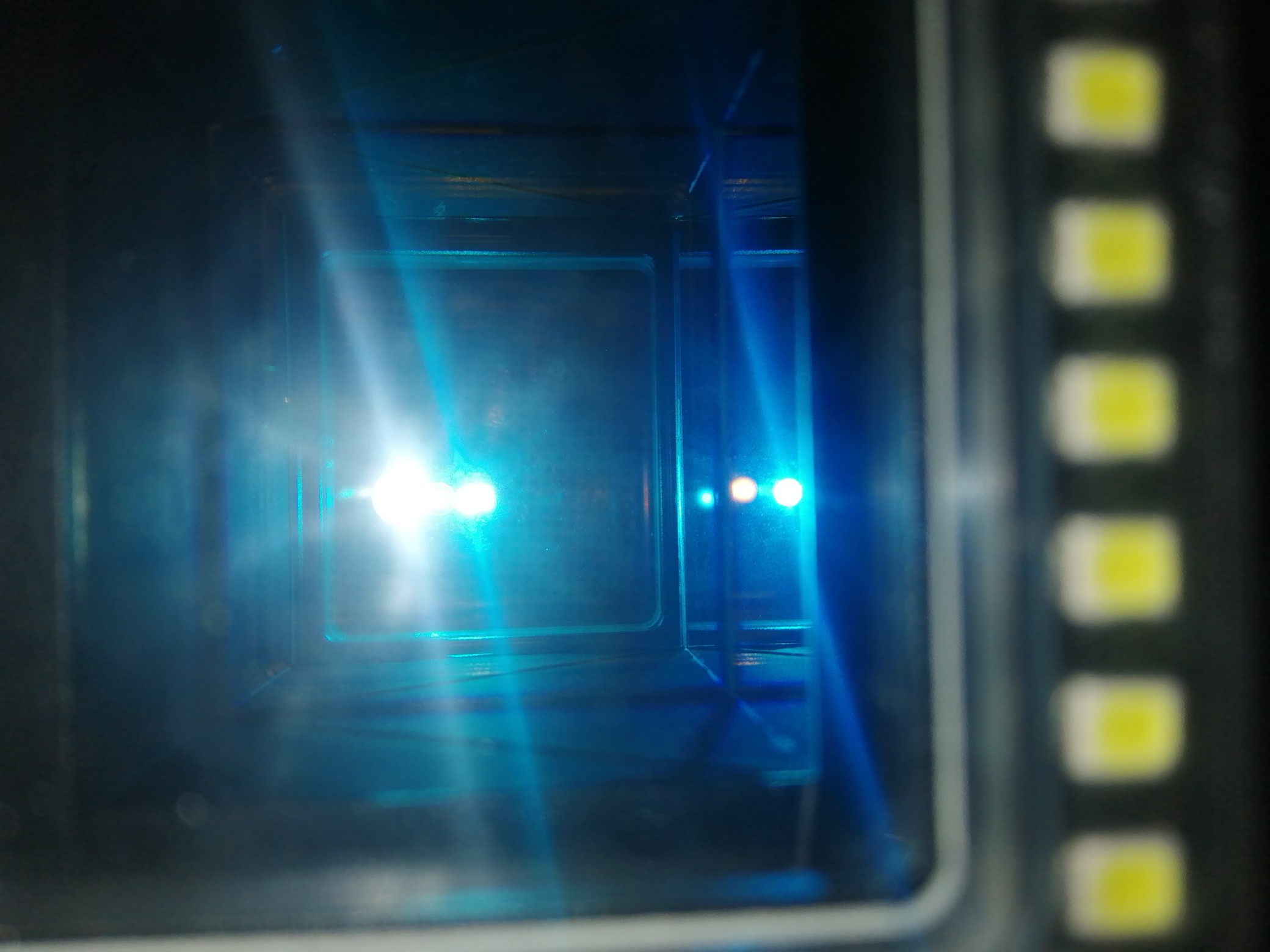

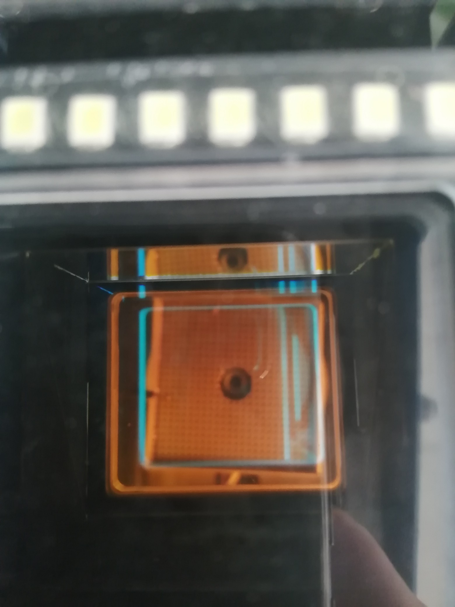

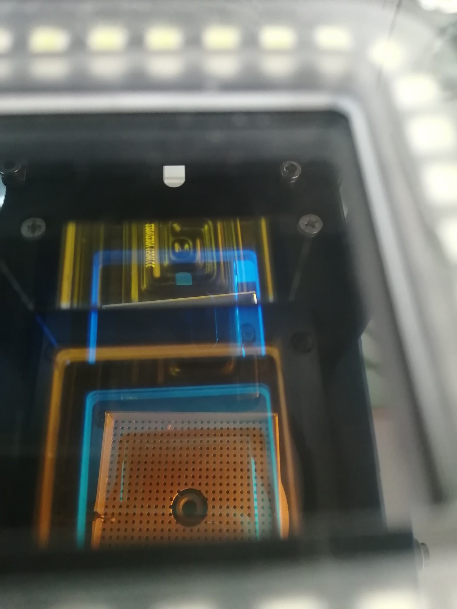

              Its 70mm cubed though the LEDs around the top and bottom obscure some of that
              Here are some pics looking the cube from different angles.

                Re: How does optical alignment work?
                Thank you very much!
