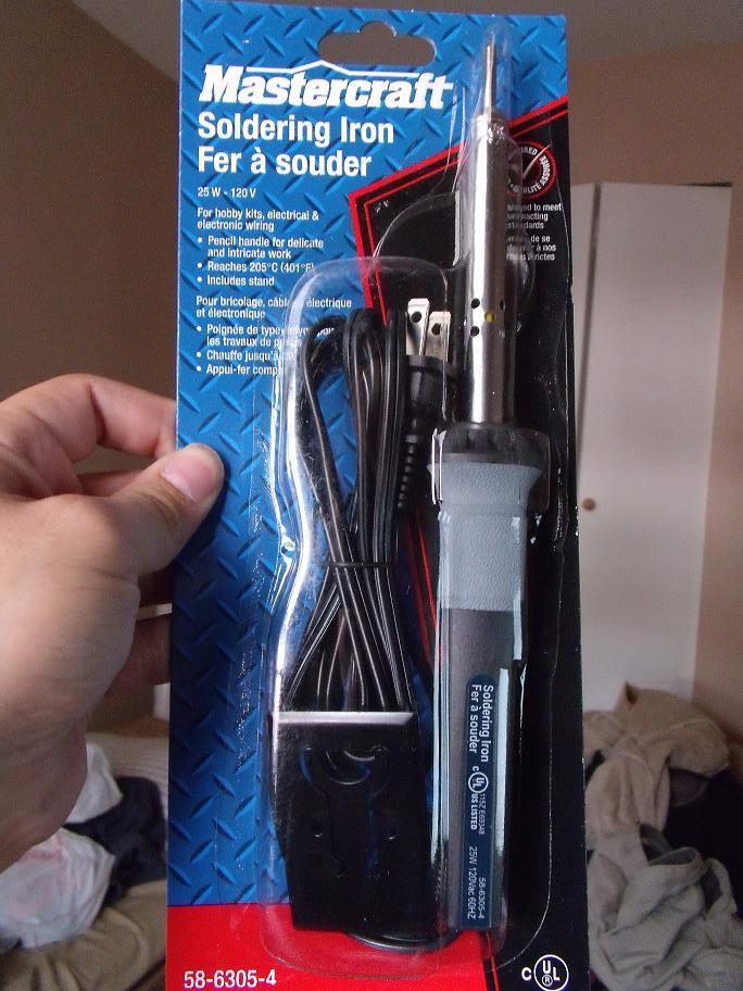

25w 120v soldering iron?
  • Phaihn
    • Jan 2009
    • 842
    is this good or do i need more watage?

    Re: 25w 120v soldering iron?
    Ehhh, you need at least a 40W for motheboard work. A 60W is good for working on a nicer psu with good soldering. Though, my cheap 40W radioshack soldering iron has been fine with cheap psu's, it has a hard time taking apart nicer psu's.
      a good quality 30w does me fine. mine is a xytronic 258 temp-controlled (phase). tips are cheap (same form factor as hakko tips) and last forever...

        I talked to a guy at the Source today he recommended a 15 w or a 20 w.
          A 15 or 20W would work, but the problem is that you would have to hold it there a while and you could burn or damage the board or traces. With a 30 or 40W soldering iron you just hold it there for a second and the lead will pull right out.

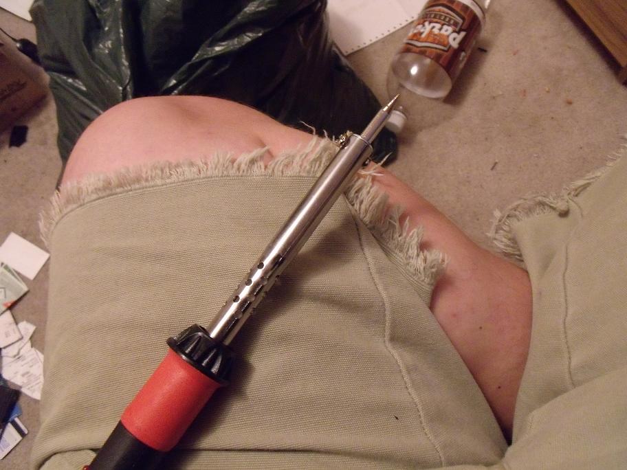

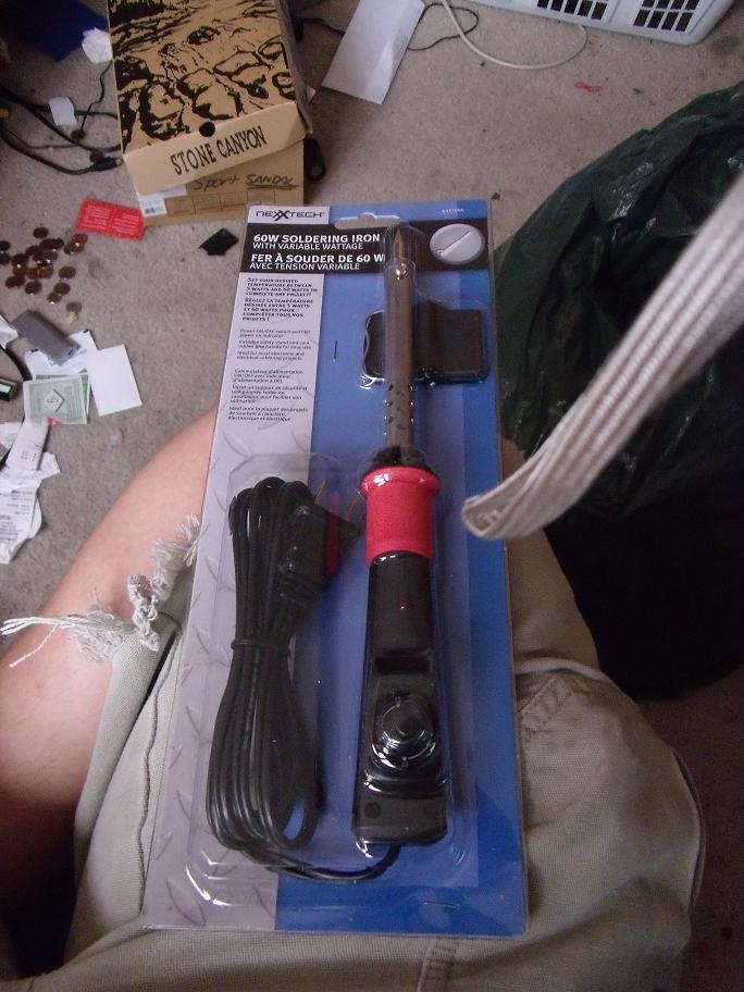

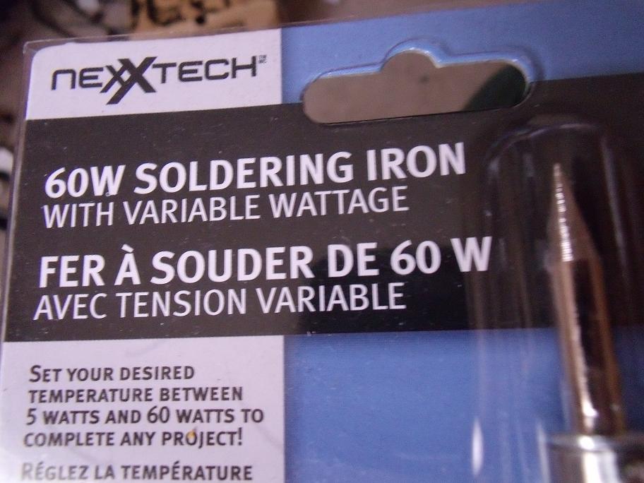

                  Ok got a 60 w with Variable wattage.

                  • ratdude747
                    Black Sheep
                    • Nov 2008
                    • 17136
                    i donlt like the tip design. dont shop at a tire place. get one like mine:
                    http://www.assemblyoutfitters.com/images/XY-258.jpg - id embed it but it is high resolution. see the knurled part at the base of the shaft? thats how good irons with replaceable tips are. the kind you have has a tip that will not last and can kill boards when it wears out (killed a nice server board that way). screw at tip= bad quality tip that is not made as a replaceable part (so you have to buy a fresh iron) and poor heat transfer. trust me, the reason my 30w does the job is the tip style. my other 30w had your tip and died quick, has crappy heat transfer, and had no replaceable tips avaiable.
                    i use xytronic because the local electronics shop carried that and since i know the owner, i shop there. id also reccomed hakko because they make great quality at lower prices. weller make great stuff but they charge out the a** for tips. shop online if no quality is avaiable.
                    remeber that wattage does not account for heat transfer/ honesty of manufacturer. id return that and look online or shop eleswhere where elecronics is the specialty, not tires.

                    • weirdlookinguy
                      • Sep 2007
                      • 1638
                      It looks fine.
                        I got that at the Source not canadian tire.
                        and the tip comes out its just a realy big one lol.

                        • Gianni
                          • Jul 2008
                          • 681
                          • Italy
                          From my experience I don't agree at all.
                          If you look at the pic you attached the 25W - 120V reaches only 205ºC.
                          To solder and de-solder correctly you need 250~350ºC.
                          The temperature is important to melt solder, power is important when you have a big area to heat.
                          So a 25W can be enough to desolder a SMT resistor but will be useless to desolder a cap from a MOBO VRM, where large tracks dissipate the heat very quickly.
                          Another important thing is the tip, they must be suitable for the area you are going to solder because a thin tip can't solder well even if mounted on a 60W solder.
                          I use Weller WS50, they have the temperature controller and the maximum power is 55W. When I have to solder small components I set the temperature at 300ºC, but when I have to solder component on large tracks I set the temperature between 350 and 400ºC.
                          About the 60W you got I think it has enough power but it looks not very comfortable for working on electronics board and probably there are not different tip available but with some practice you will be able to do a good job with it.

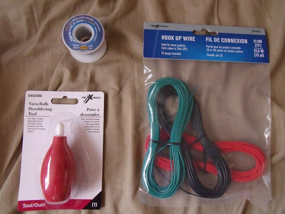

                            • Phaihn
                              • Jan 2009
                              • 842
                              Rest of the stuff i got.

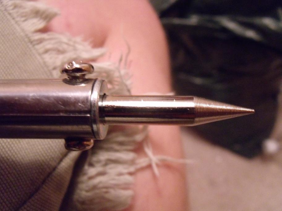

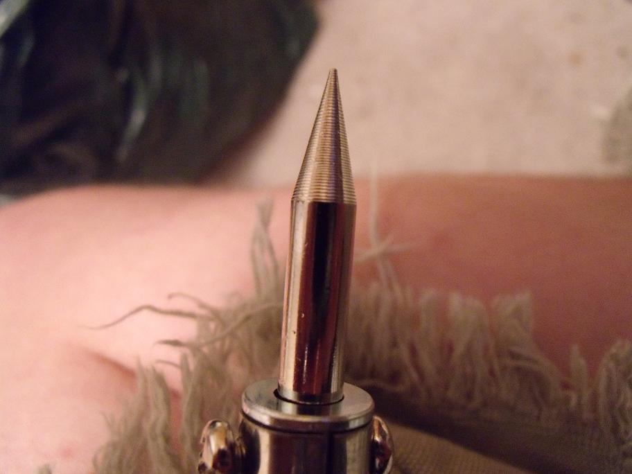

                              • 370forlife
                                Large Marge
                                • Aug 2008
                                • 3112
                                Ehh, its a pointed tip. You really wanted to get a flat tip. You can make it a flat tip if you have a grinder or something, or you can get a new tip.
                                The wires are 22 gauge, good for low current things like fans or small projects, but for smps work you need at least 18 gauge. Solder suckers are always good, and rosin core solder is good. 60/40 is best.
                                • Phaihn
                                  • Jan 2009
                                  • 842
                                  the wire i got for HD motor i wanted to play with ..
                                  i am going to see if there are replacment tips for that iron.

                                    • Krankshaft
                                      • Jan 2007
                                      • 2328
                                      You CAN'T grind the tip down you'll lose the plating.
                                      On a related note I just got my FIRST soldering station a Hakko FX-951 it kicks ass . Goes circles around my corded unregulated Hakko Dash. I can even hot swap tips they plug in like cartridges heats up to 350 C in 10 secs.
