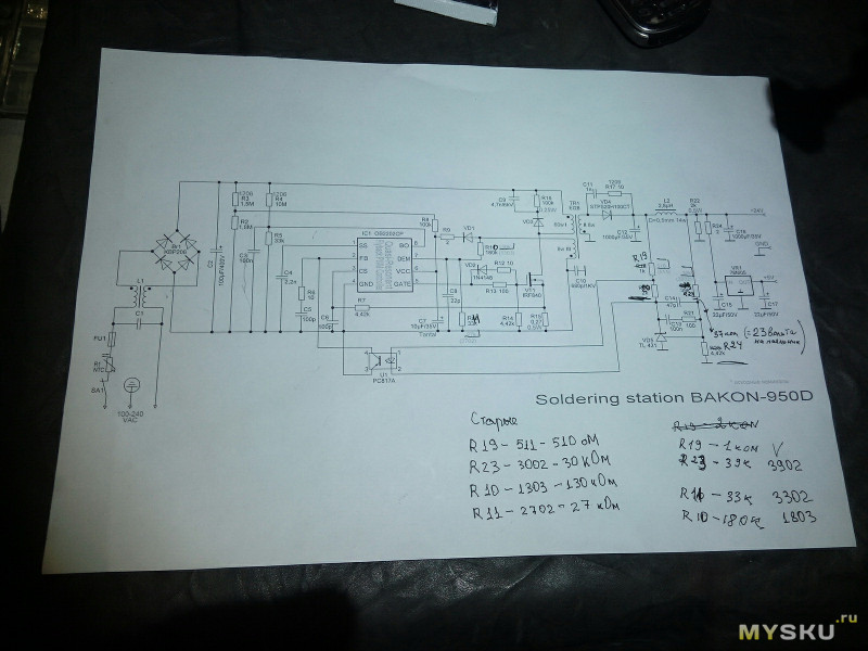

                  Re: Bakon 950D "Extra Crispy" mod (19->24 Volt)
                  What about this I took it from a russian blog

                            • 31294
                            #33
                            looking at my notes from russia, i suspect it's R1 or R14 needs to be messed with.
                            i have this line "parallel to the current resistor in the primary we add a resistor to 2.7 ohms"
                            nice & vague, looking at the psu schem i can only imagine they are talking about R1(0.27ohms) which is a shunt for the main switching fet.
                            by putting 2.7ohms in parallel you reduce the volt-drop the chip will sense.

                              #34
                              It should work without messing with the current shunt, mine does no problem. Try 20k for R11. 27k (original) paralelled with 91k gives 20.822k, so 22k is a bit high and could very well be your issue.
                              As for tip temperature lower than expected, make sure the tip is clean then pick up some solder with it, before placing it onto the thermocouple. Any oxidation acts like a thermal barrier. When you are sure the temperature reading of your thermocouple is correct, use the built-in calibration function (described in the manual). It works very well.

                                      #38
                                      Originally posted by dssence
                                      If I'm not mistaken and missunderstand he said to replace r11 by 20k resistor.
                                      Yes exactly. R24 (bottom feedback resistor for TL431) is the one that needs to have 15k in parallel added, take another good look at the pictures, stj.
                                      I did not check the Russian schematic. I did the homework on my own in the first place.
                                      The label on the transformer showing the turns ratio helped greatly. Since the OVP is on the primary side, sensing the aux winding, and both circuits are simple resistive dividers, it follows that when adjusting the bottom feedback resistor of the TL431 to bring the voltage up, the OVP level has to be scaled up by the same ratio by lowering the bottom resistor of the OVP divider. It was all grade school math there.
                                      I did not need to go thru extra iterations once I discovered where the OVP circuit is, it worked first go for me with the values that I have posted. Still works great, and no I haven't even bothered to replace the output capacitors yet.
