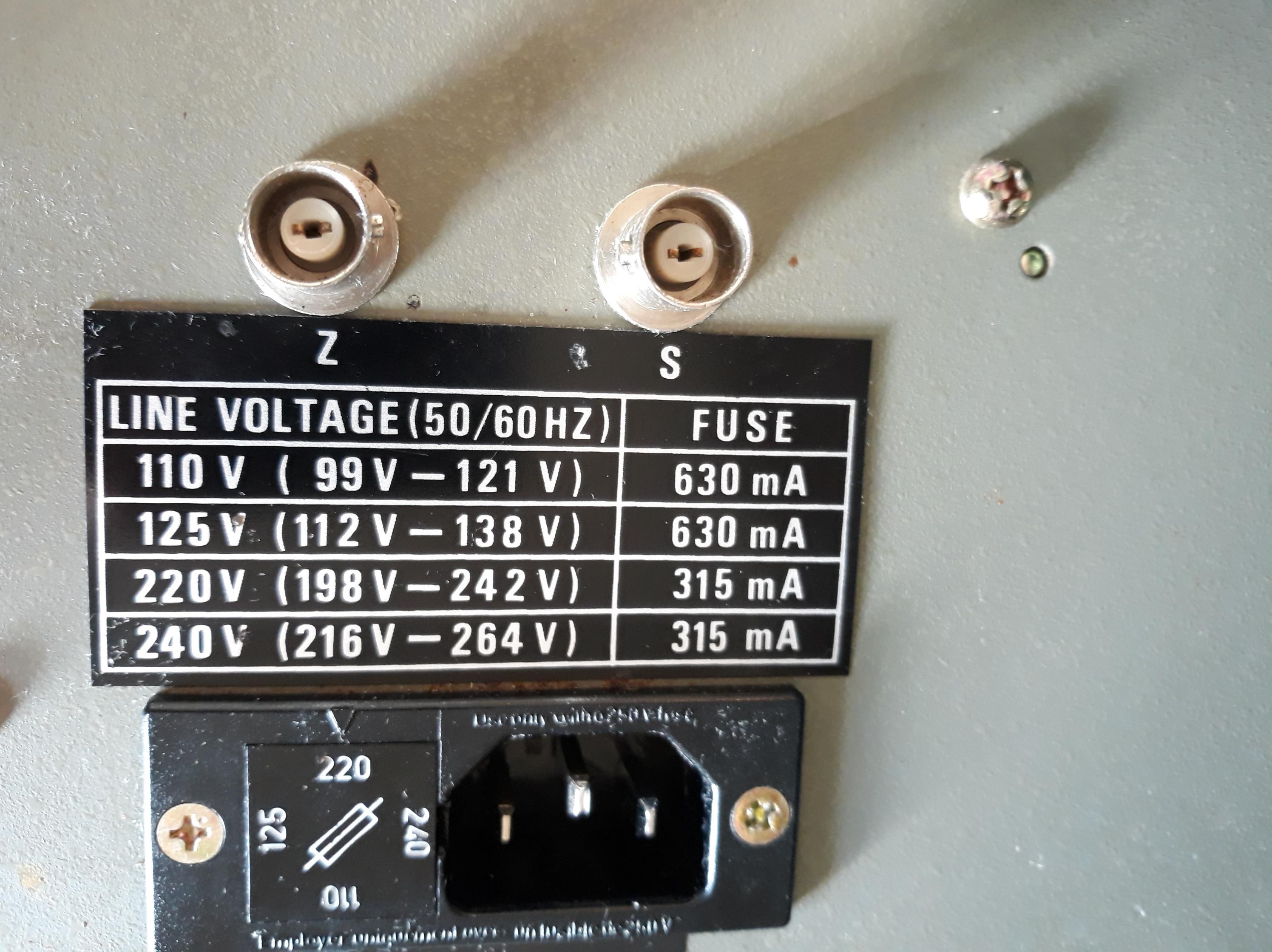

        In back, I can find a BNC with sawtooth ... and changing TIME / DIV, I tested with a DMM -
        300 Hz -> KHz
        I visualiz. the dots -> rotating the POS and the dots appear from left side.

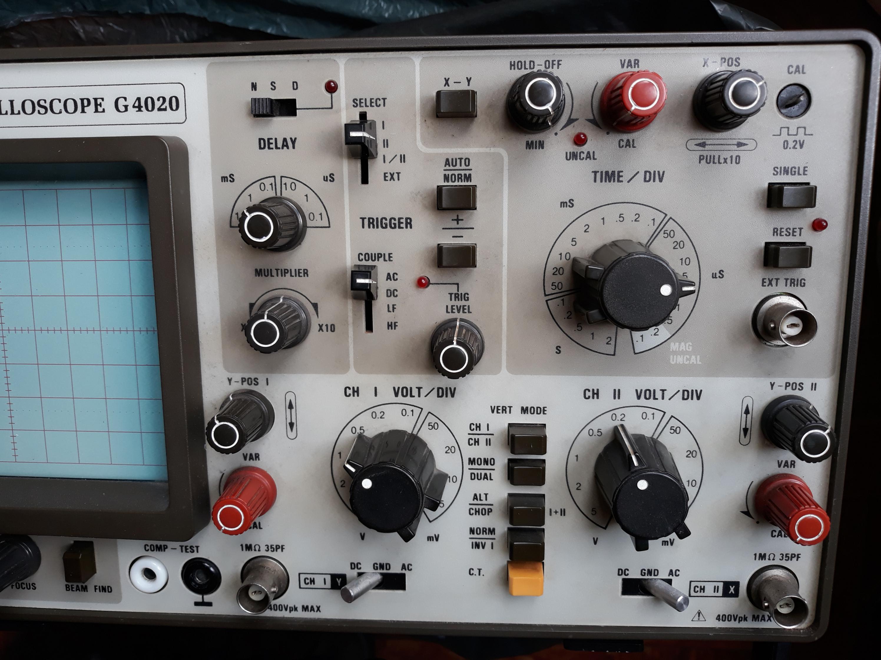

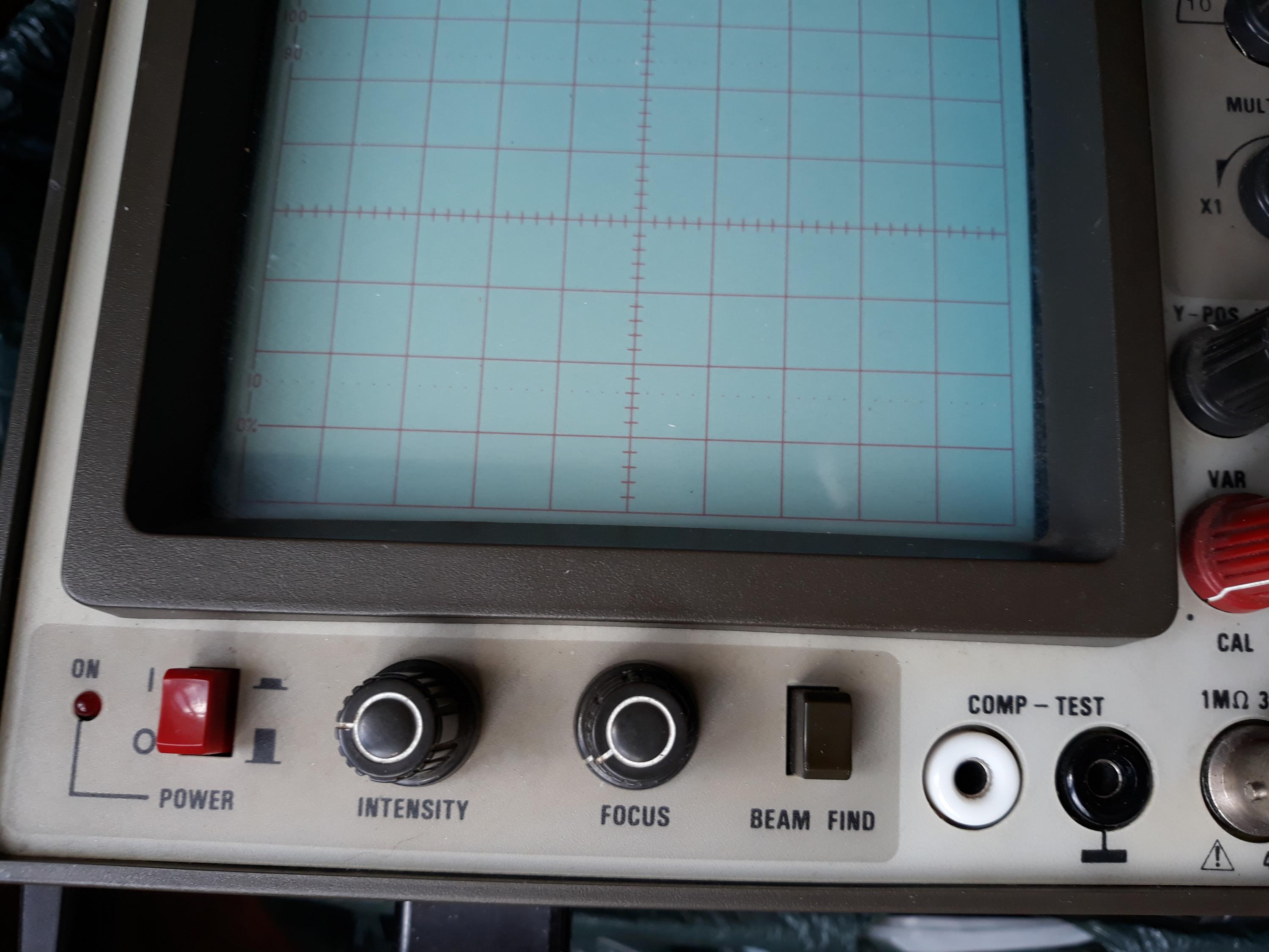

                  Might be best if you post pictures of the exact screen (and controls) of your device, it's hard to tell what you see by text. A good cleaning of the time/div switch is good just to make sure.
                  Since you can move the dots up and down, vertical deflection is working.
                  So you do see some horizontal deflection of the beam even if it's not fully across the screen?

                      Some pics ... feeling of device

                        does the x-pos control in the upper right efect the dot position?
                        and make sure "single" isnt pushed.

                          It might be in component test mode. Check the C.T. button is not in.

                            Let me rephrase ... explain ...
                            If the Scope is working properly and you select XY or
                            Test Comp = Curve Trace you get a dot in middle of screen or
                            in CT a single line ... because no component in the leads.
                            only volts.
                            In this case I don't get nothing in the screen. :-(
                            Because the dots are hid. in left side - border.
                            Everything in middle position (X-POS, Y-POS) or
                            off (HOLD-OFF ->MIN, VAR-CAL off, etc)
                            DELAY -> N
                            Push Buttons -> not press ... none
                            Lets begin.
                            Nothing in the screen ...
                            Rot. the X-POS (white mark in middle ) the dot emerge
                            from the left side.
                            And I can move anywhere in the screen.
