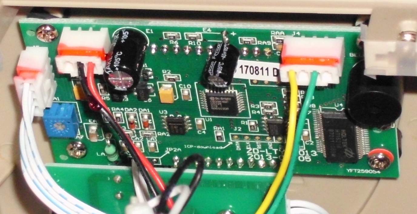

        Originally posted by sam_sam_sam View Post
        Like I said earlier I would recap the temperature controller board you can reach the pins of the caps because the pins do not go very far on the other side board because of the LCD display
        that is why the caps are not flush with the board
        The easiest way to get the caps off the board is heat the pad and tilt the cap to one side then heat the other pad and gently pull out the cap from the board
        You will know if you have older version is when you turn it on it might turn off then turn right back on and might keep doing this a few times before it will stay on
        The older version was used with the transformer the new version uses the switching power supply
        The difference between the two is that older version the heater comes on right a way on the newer version there is a delay before the heater comes on
        From what it looks like either they had a lot of the older controllers or they did not realize that you can not turn the heater on right a way so they wrote a new version of the program to fix this problem so some of the unit have this problem
        We have a JAKEC 330 uf and a Fencon 100uf cap here, both are 25v
        Do these need to be low esr? i assume they should be upgraded to 35v
        should these be used?
        EKYB350ELL331MH20D 330uf KYB 35v
        EKYB350ELL101MF11D 100uf KYB 35v
        I understand the ones in the PSU should be 35v, but since the psu outputs 18v, shouldn't 25v be good as the voltage SHOULD be regulated and smoothed out at this point?
        does this look like a old or new controller? *points at photo that turned out wonderful*
            “STJ
            18v output.
            25v caps - hell no.
            for smoothing 18v you want 35v caps.
            old rule, a smoothing cap should be atleast 1.5x running voltage to handle the spikes.
            18+9=27
            that's far too close!
            also, if it pulses the element with DC does it have a reverse protection diode? “
            I would use 35 volt on the temperature controller board
            You will not know which version of the program it is load until you power up the unit the temperature controller board look alike

              So the only difference on it is the software that can be flashed, given one can get a hold of the new version
              does the voltage regulator not clean out spikes, that is what a voltage regulator does right? or am i thinking too linear
                #87
                Re: What is a good de-soldiering iron/tool?
                Most the filtering the voltage to very close to pure DC voltage
                You have not said where you got your ZD-915 from but it might be the new version of software but you know which one you have when power it up
                  from page 2...
                  I would very much like a de-soldering gun, but there is one issue, i hate to spend money
                  I can find a ZD-915 for 119 at amazon
                  I am going to get a zd915 for Christmas, so those links would be useful
                  I know you said you replaced the caps in it's PSU would you happen to have cap part numbers or specs? I will need to make sure the PSU is the same in this unit, but if they are that would be a time saver
                  here was the link: https://www.amazon.com/dp/B07542D82F

                    Lol, that's not even close to being "too close".
                    That old "1.5x rule" comes from a time before switchmode power supplies existed. It has mostly to do with the fact that linear power supplies (i.e. a simple line transformer with a rectifier behind it) would output a much higher voltage when unloaded than when loaded. This is especially common with small "wall wart" -type of transformers that have poor load regulation. Hence the 1.5x voltage rating.
                    Also, during the early 2000's, it was common to see caps on many motherboards with much higher voltage that what the circuit needed. This was done because there weren't as many (and as good) types of low ESR capacitors as there are today. When you move to a higher voltage electrolytic cap, its size increases. This increase in the can size reduces the ESR and increases the ripple current handling capability. So in short, you get a cap with lower ESR without having to resort to a higher capacity cap.
                    Both of these design strategies are outdated and unnecessary when it comes to choosing caps for a switchmode power supply today. So there is absolutely NO NEED to go with the "1.5x voltage rule".
                    Thus, for a regulated power supply, the voltage rating of your caps really only needs to be about 20% higher than the circuit voltage.
                    Now, if you want to talk about cutting it close... I repaired an active amp speaker set last month which had 63V-rated caps on its LINEAR PSU filter a voltage rail that was about 59-60V. Now THAT is close. But guess what, even those caps lasted almost 20 years in that spot. And they were CapXon. After nearly 20 years, only one of the four failed. That's not too terrible, IMHO.
