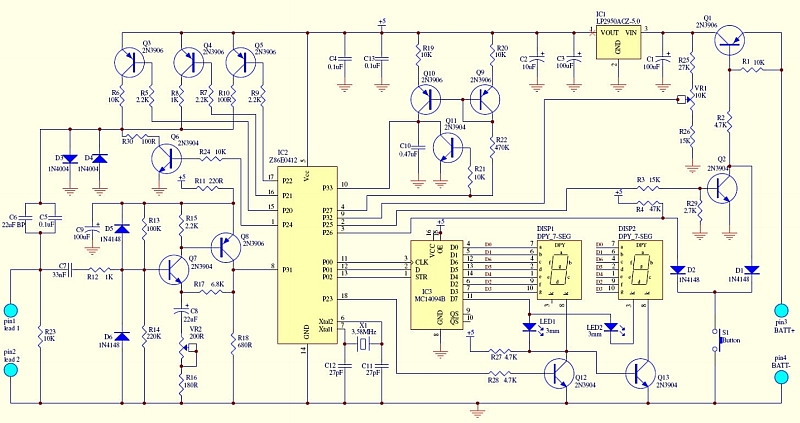

    I just finished assembling my meter and everything powered up just fine with the “-” on the left display. I went to calibrate the meter and adjust the VR2 pot and I cannot get it to display 82, 56 is as high as i can get. I am wondering if I have the pots switched.
    One POT has 103 marked on the adjustment screw which I believe is the 10k and the other has 201 marked on the screw and I assume that is the 200ohm pot. The 201 is mounted in the VR2 position and the 103 is mounted in the VR1 position. I haven't run any diagnostics yet but I was just curious if the pots are in the correct location.
    Anyone else happen to have this problem during calibration? What was your fix? Thanks for any insight.

    The schematic that comes with the kit and the BOM does not tell you what the Values of the VR1, VR2 should be?
    Or may be some of the parts are in the wrong locations?

      You adjust VR2 to read 82ohms with an 82R test resistor in place.
      Just double check you did not mix up a component, especially a resistor. Use a ohmmeter to confirm the 1% values are hard to read.
      R15,R16,R17,R18 make the pulse amplifier wonky.
      Bob has troubleshooting instructions here

        Thank you for the reply. Currently I am going through all components. All 1% and 5% resistors are in the correct locations based on colors by using a 10x loupe and a LED flashlight for color correction. Next I will start on the semiconductors. I am also going to scrub the trace side of the board with denatured alcohol and a tooth brush to make sure all whiskers and flux is removed. Then I will attempt to recalibrate and see what happens.
        I will recheck your suggested R15,R16,R17,R18 resistors just to be sure. After that I was going to run the diagnostics as I have a DC power supply so I can get the necessary 6.2-6.8V. Since I am not an expert at this, the destructions reads that R30 needs to be shorted. Does this mean to remove and jumper across or can I jumper across with the resistor in place? Thanks.

          I believe I found it. The Q8 semiconductor has been installed incorrectly. It is 180 out. I will reinstall and do the calibration to see what happens and report back.

            A flipped transistor would cause the low calibration numbers.
            R30 is shorted (temporary jumper is ok) as part of running the unit's self-test. There are quite a few diagnostics the firmware can do to make sure things are working. I think you just run the self-test once after building the kit.
            The low battery alert you can just turn VR1 until it trips, with say 5.5V power, which is pretty much a near dead 9V battery. R30 is not part of this at all.
            It's a good kit, but kind of complicated with so many parts.

              Ok, that was the problem. Thanks for the assistance. Not sure how I could have installed that 180 out, must have been in need of some food.
