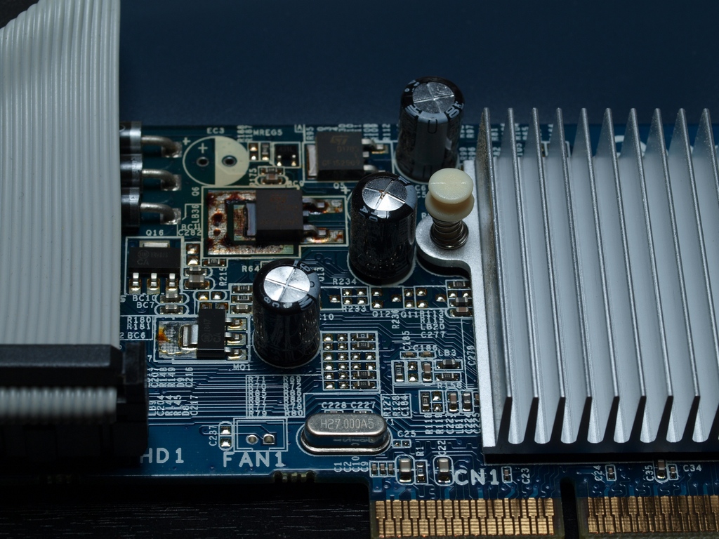

    Google Earth got more and more unstable on my PC until I couldn't use it any more. I read all kinds of forums about what might be causing it, changed program versions and video card drivers, and nothng helped.
    I finally pulled out the Gigabyte Nvidia FX5200 video card and checked the electrolytic caps. The 1000uF 6.3V with the swollen top had an ESR of 13 ohms. The others measured 0.03 ohms each so I left them alone.

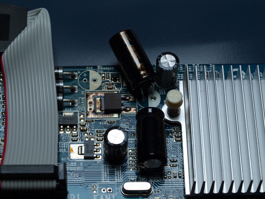

    I replaced it with a pair of low ESR 1500uF 10V caps I had (using the existing cap's solder pads + two spare pads in parallel with it), and suddenly Google Earth is perfectly stable again. The weird thing is that the video card was working OK with all other programs.
    My final act was to install a small fan to blow air over that board. It used to run too hot to touch and now it's just quite warm and I'm happy.

    look at that fet being almost completly burnt by the bad cap!
    look at other two being completely normal, as caps near it are ok.
    yeap. caps eat fets....

      The "crispy" look on that "transistor" could be regulator and heated flux that got more brown as time goes.

          Yeah that device has been running extremely hot ever since I installed the card a few years ago. It's an STD1703L and I finally found a data sheet for it. Yes, it's a DPAK MOSFET probably functioning as a linear regulator. Even with the new fan blowing air over it, it still gets too hot to hold my finger on it for more than a few seconds.

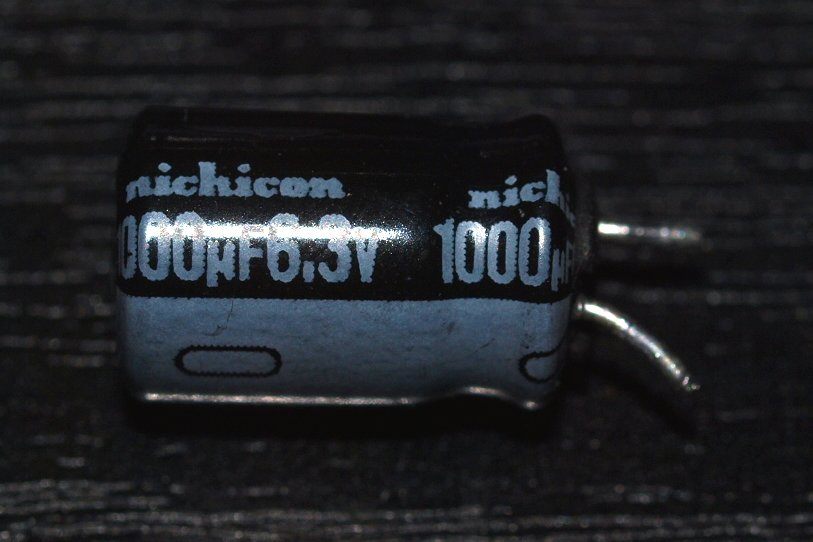

            what series were those nichicons?
            that hot mosfet is likely to blane for the cap failure.
            the plating on the tab has turned colors from the heat.

                Yeah, the cap which failed was closest to that device. Some photos of the cap should be attached to this so you can work out what series they are...

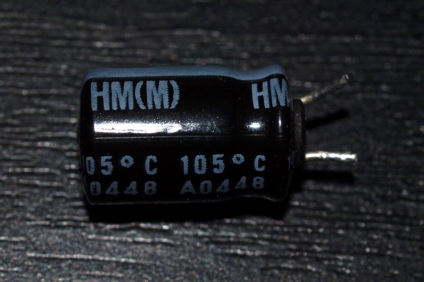

                    The Nichicon HM bad batch curse is still in full effect I see.
                    The instant I saw the Nichicon logo in the first pic I knew that they were HMs. A04 so they have a 2004 manufacuring date. Right at the cutoff point when the mistake was corrected. The overfilled caps were manufacured between 2002 and 2004.
                    Kind of like the Samxon GF series a good company that just goofed up.
                    Unfortunately though they left the manufacturers to deal with the mess.
                      All three electrolytics have been getting heated too hot to touch by other components for more than half of the last 3.5 years, but the one which burst its top was getting even hotter from being next to that discoloured MOSFET. I was amazed that they lasted this long and that the other two were still reading 0.03 ohms of ESR, especially if that series of Nichicons is known to have problems!
