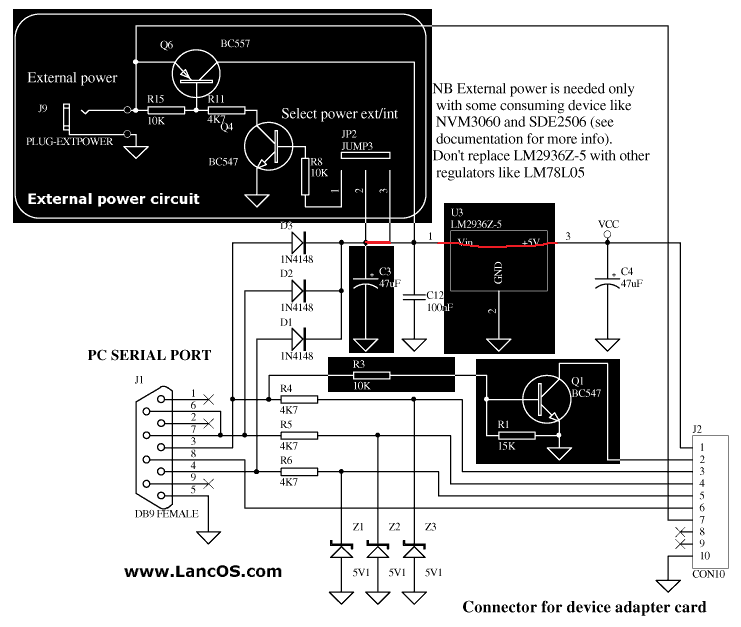

        I've started looking yesterday on the Pony prog 2000 website. As far as I see, I need to build the Base board (SI Prog) + the 93cxx adapter (Microwire eeprom adapter) using the schematics provided on that website. Is that right?
        I want to build those, but as simple as it can be... So what would be the simplest schematic that I should build? Do I really need the extra power source? And if I do, can I use the 5V rail from the PC's PSU for this purpose instead of the one presented on the Base board schematics ?

          you only need what will be used, so really just 5v

            Re: Using my CH341A.
            I inverted in the image below the colors of the components which I want to remove from the Base Board interface, and I retraced with red color the connections that I think it needs to be done in the circuit. Would it work this way?

              you need the voltage regulator, the serial port outputs 12v.
              well it should but modern stuff is closer to 9v but it will still fry your chip!
                • 31248
                or get 5v from a usb port.

                  I see... If 12 V is the voltage from those serial pins, then I think I definitely need a 5v regulator... But if I don't have the 5 V regulator (LM2936z-5), what else can I do using other common electronic parts that are easily available? Or can I just eliminate the 1N4148 (D1, D2 and D3) along with the regulator and the other capacitors (C3, C4 and C12) and just use a 5V from USB or from an 5V PSU rail to drive the pin 1 (that's VCC, + PE + ORG of the 93cxx EEPROM ) ?

                    You can salvage an LM7805 from any common domestic appliance, TO-220 easy to spot.
                    You can also find 5V regulators in 3.5" hard disks boards.

                        just use 5v from usb or ps2 connectors.

                                    Well, I did it! I built myself a Pony Prog adapter for the programming of 93cxx EEProms using PonyProg and the result is: SUCCESS! I managed to write a 93c46 EEPROM that I bought from a local shop for testing purposes.
                                    Next: I will try to read/write the 93c56 in circuit. Keep ur fingers crossed for me, pls !

                                          I successfully read and wrote in circuit the 93c56 and 93A56 EEPROM's. I didn't have to power on the circuit, I just used the SOIC8 test clip with the interface
                                          that I built!
                                          I could not use the CH341a though, so I have no use for that interface... at least for now.
