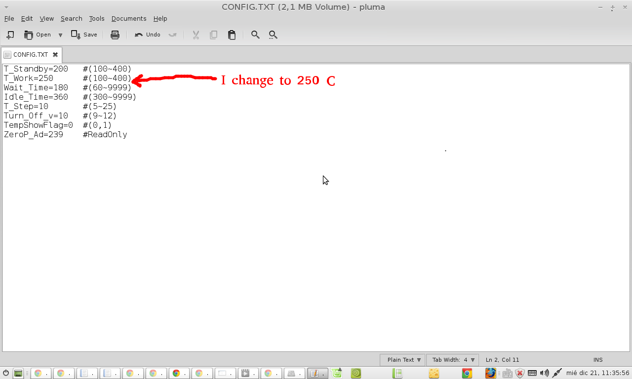

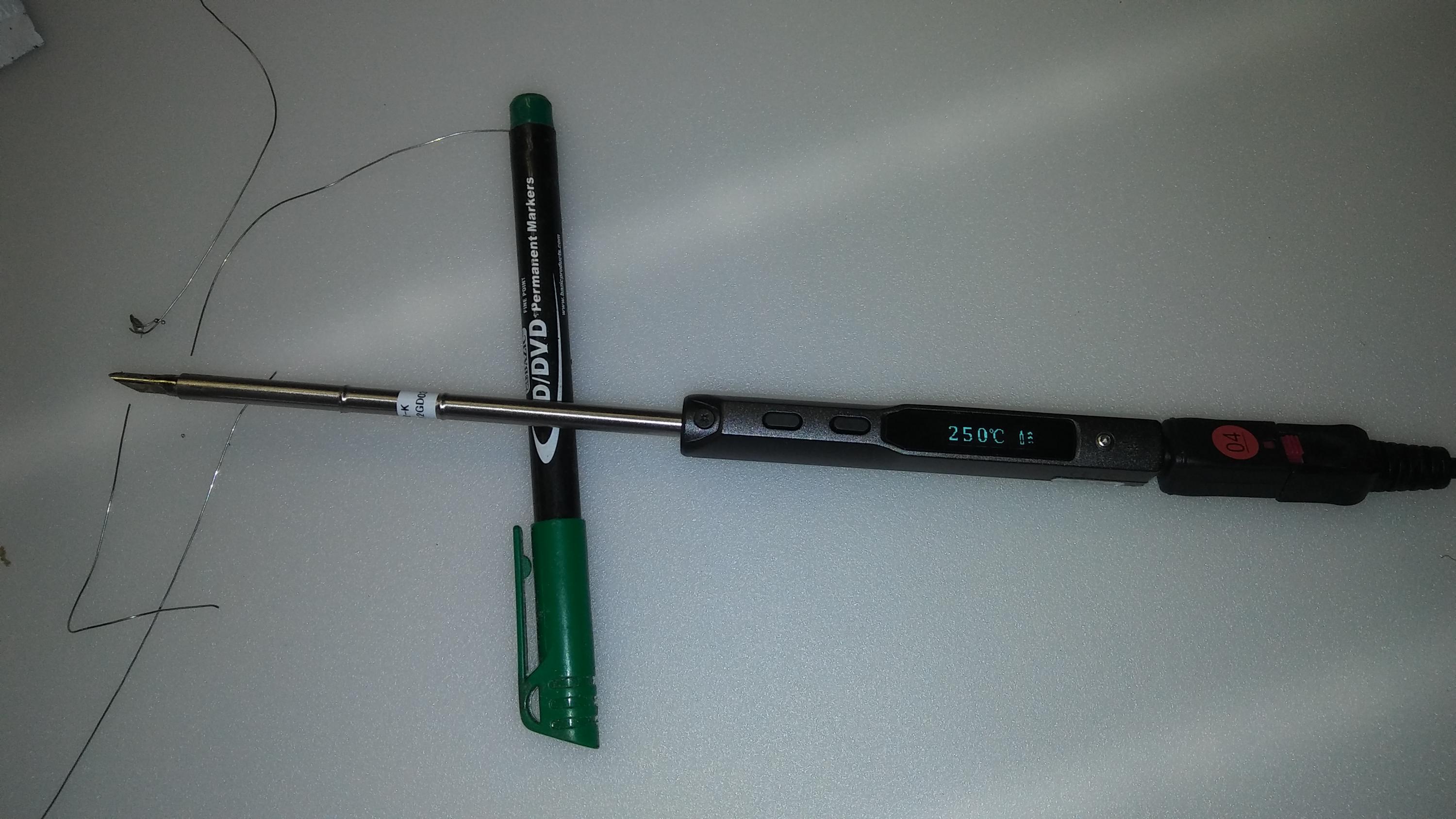

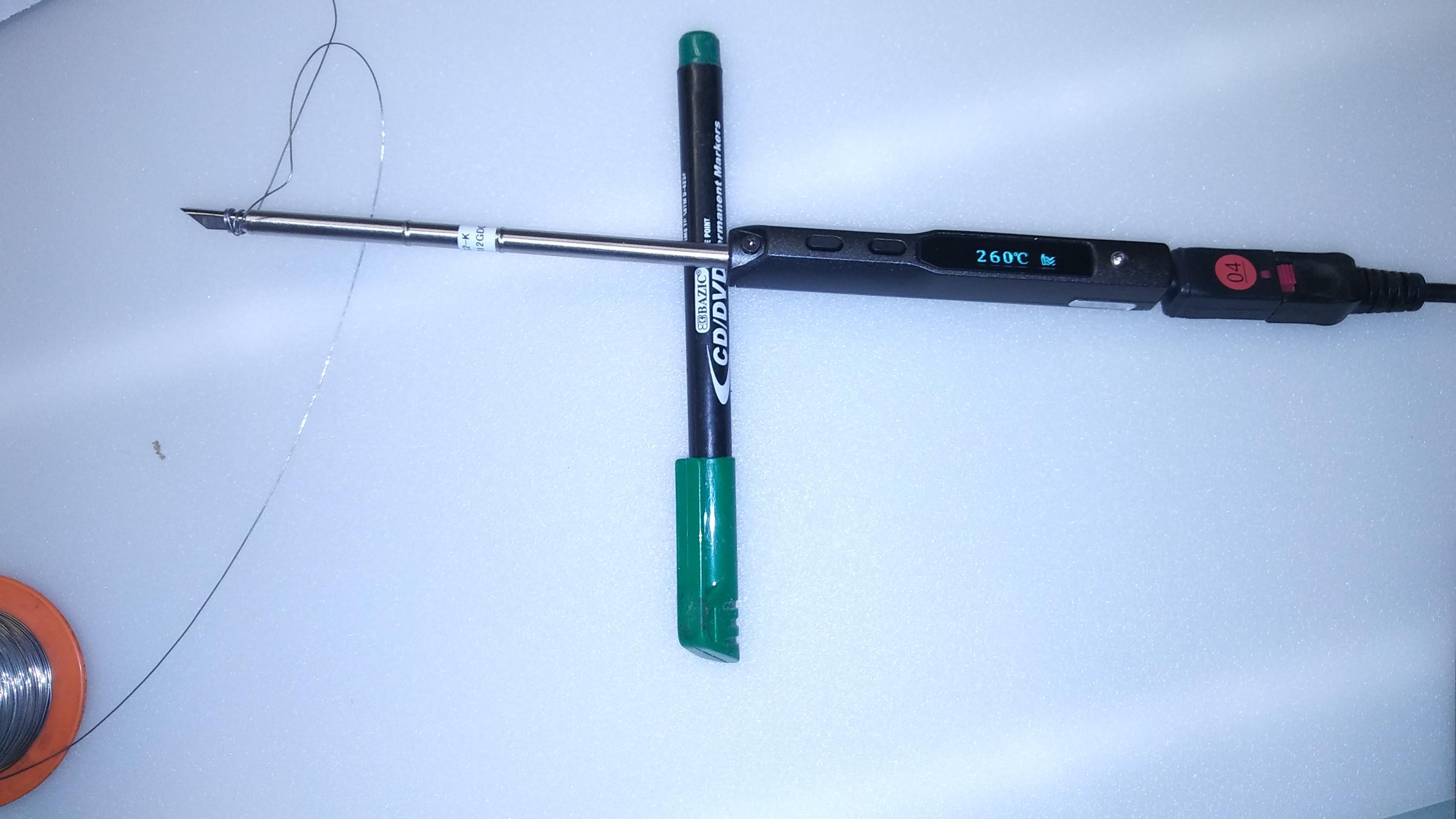

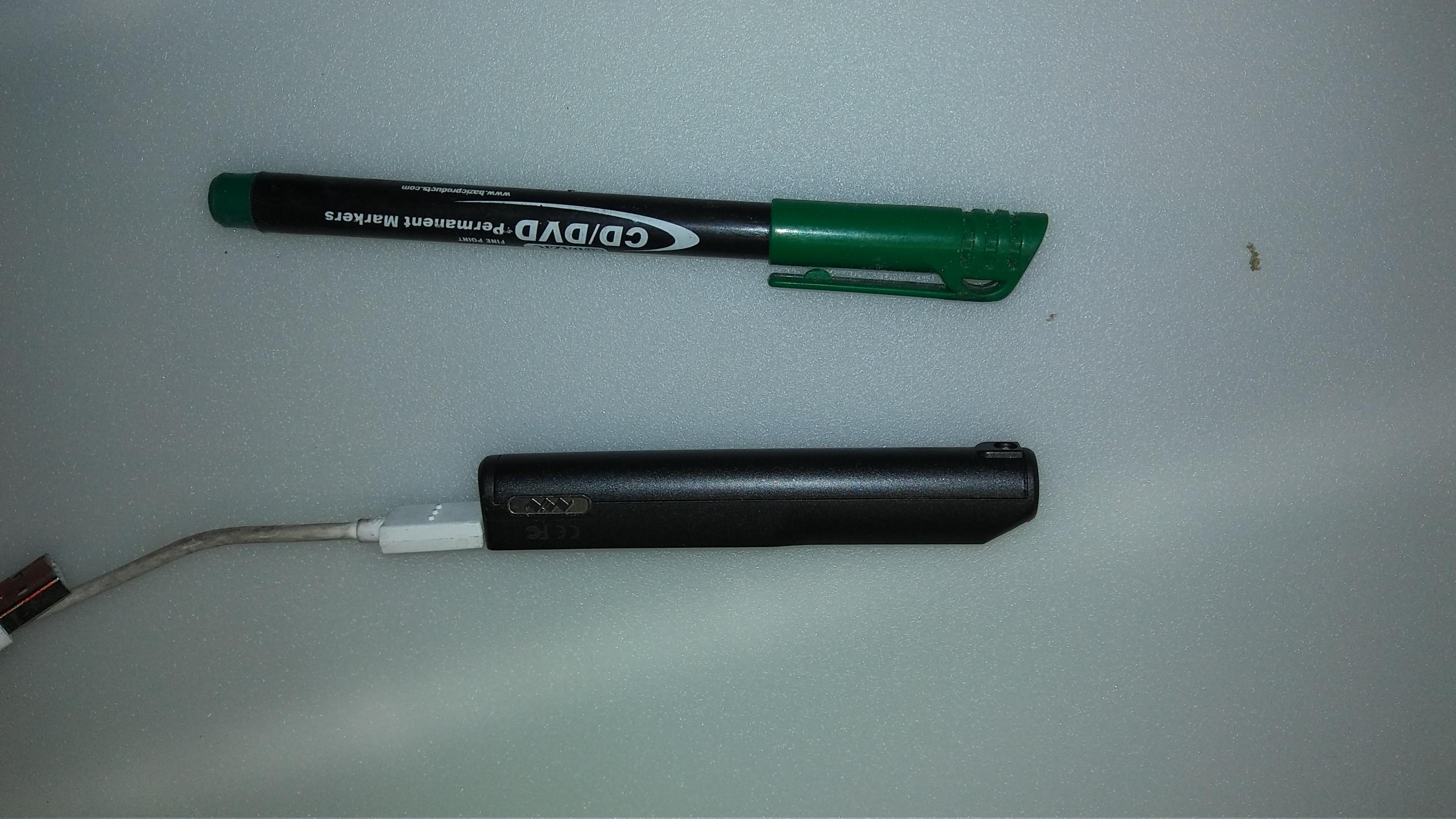

      Ive changed T work from 300 to 250 prevent tip discoloration. work on Linux.
      Ts100 is smaller than a pan if it without tip.
      Had an idea is put a min reed relay, if pick up will wake up like kill relay. use microcontroller INT pin to do it, then this is almost like A Soldering Station.

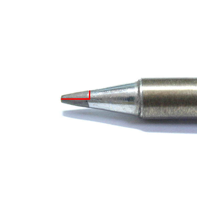

          Competition time: From now until March 1, 2017
          Requirements (Very Important !!!):
          1, we provide TS100 tip general interface T1 detailed size, participants in the T1 interface based on the design of various accessories, such as: heat sets, iron stand, lights, anti-skid handle;
          2, Participants can provide hand-drawn design drawings, renderings, computer design documents, 3D print samples and even in kind, the information provided by the more detailed, the higher the chance of winning;
          3, the same contestants may publish multiple entries, all works must be the original or partner.

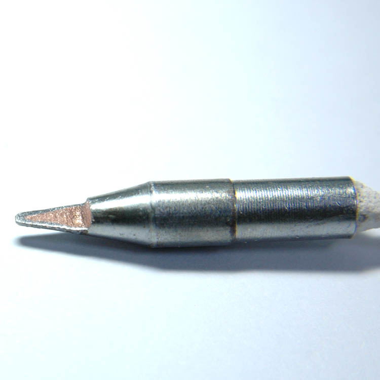

            Re: A deep-dive on TS100.

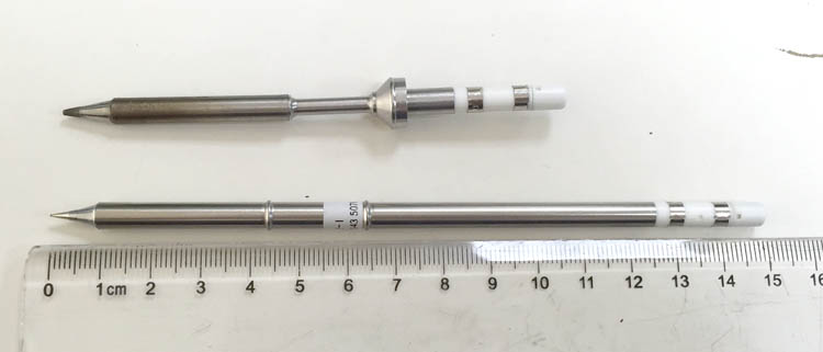

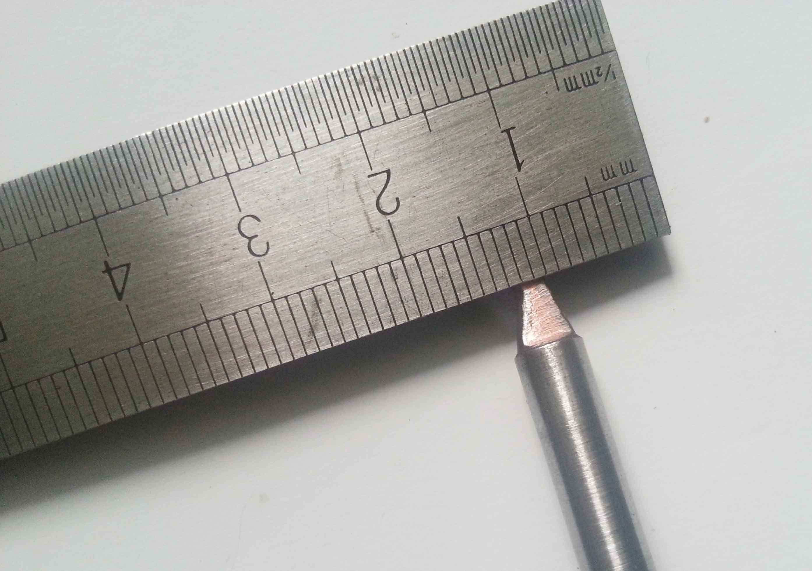

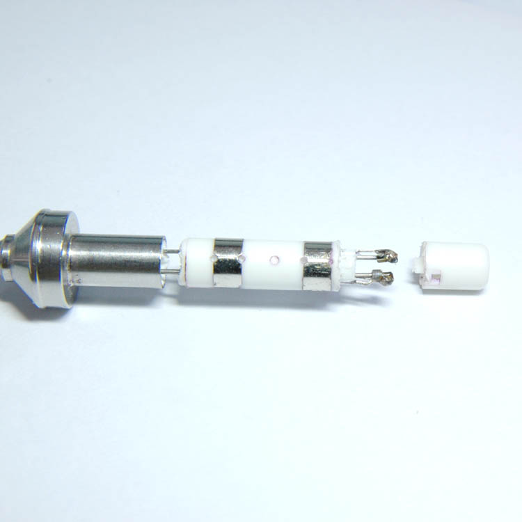

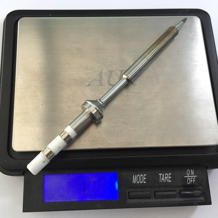

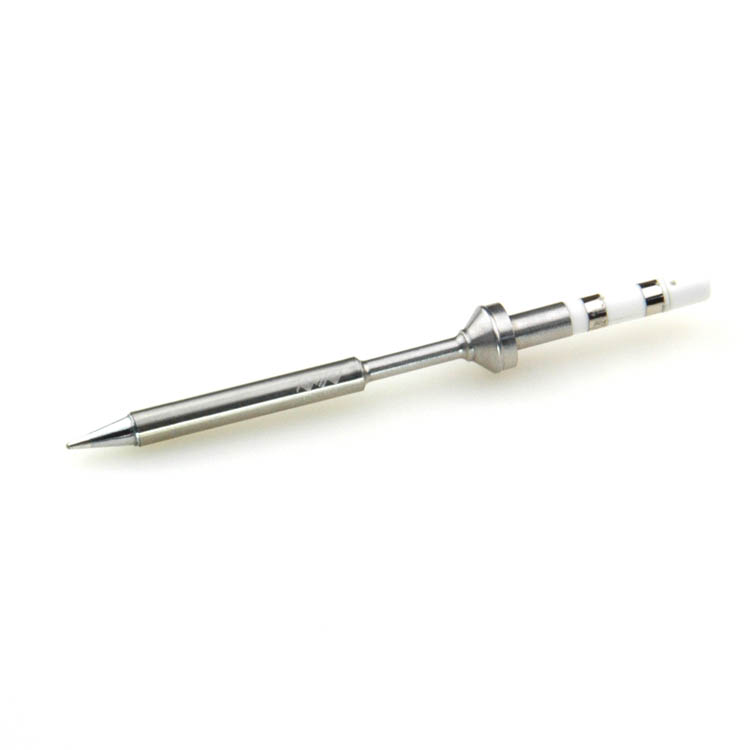

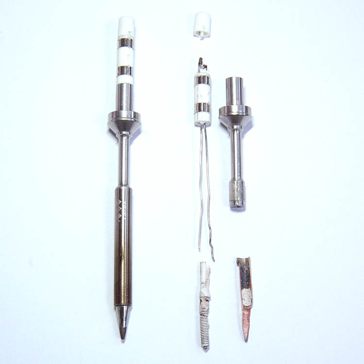

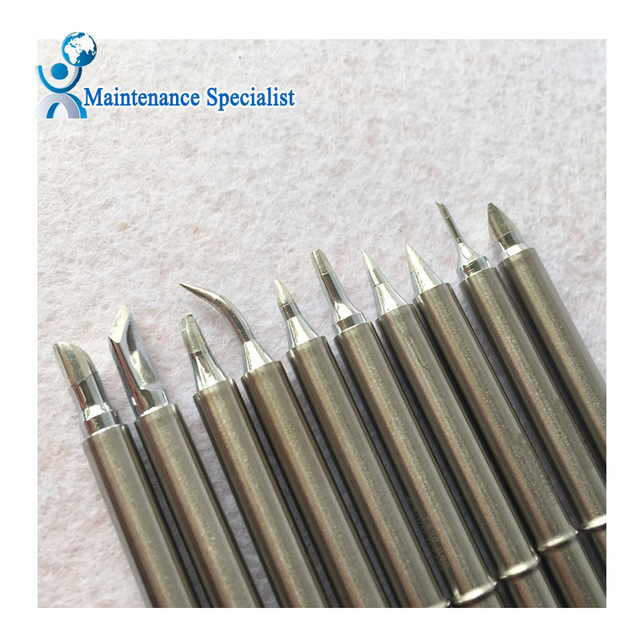

            YES...........T12 tips works on TS100. ...............
            on a daily basis abuse user.
            FOR REFERENCE ONLY:
            https://www.aliexpress.com/item/10PC...4-1960247d814e

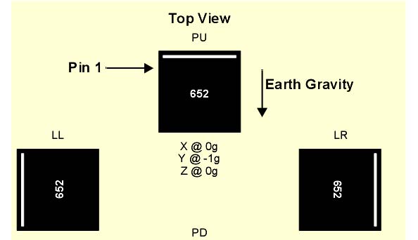

              Sti Thank you again. "you dont need a relay, it has that function already by using the gyro chip."
              Ifthe IC inscribed with 652 is MMA8652FC, that will be awesome. With 3-Axis and12-bit Digital Accelerometer, you could sense every slightest move of thesoldering iron.

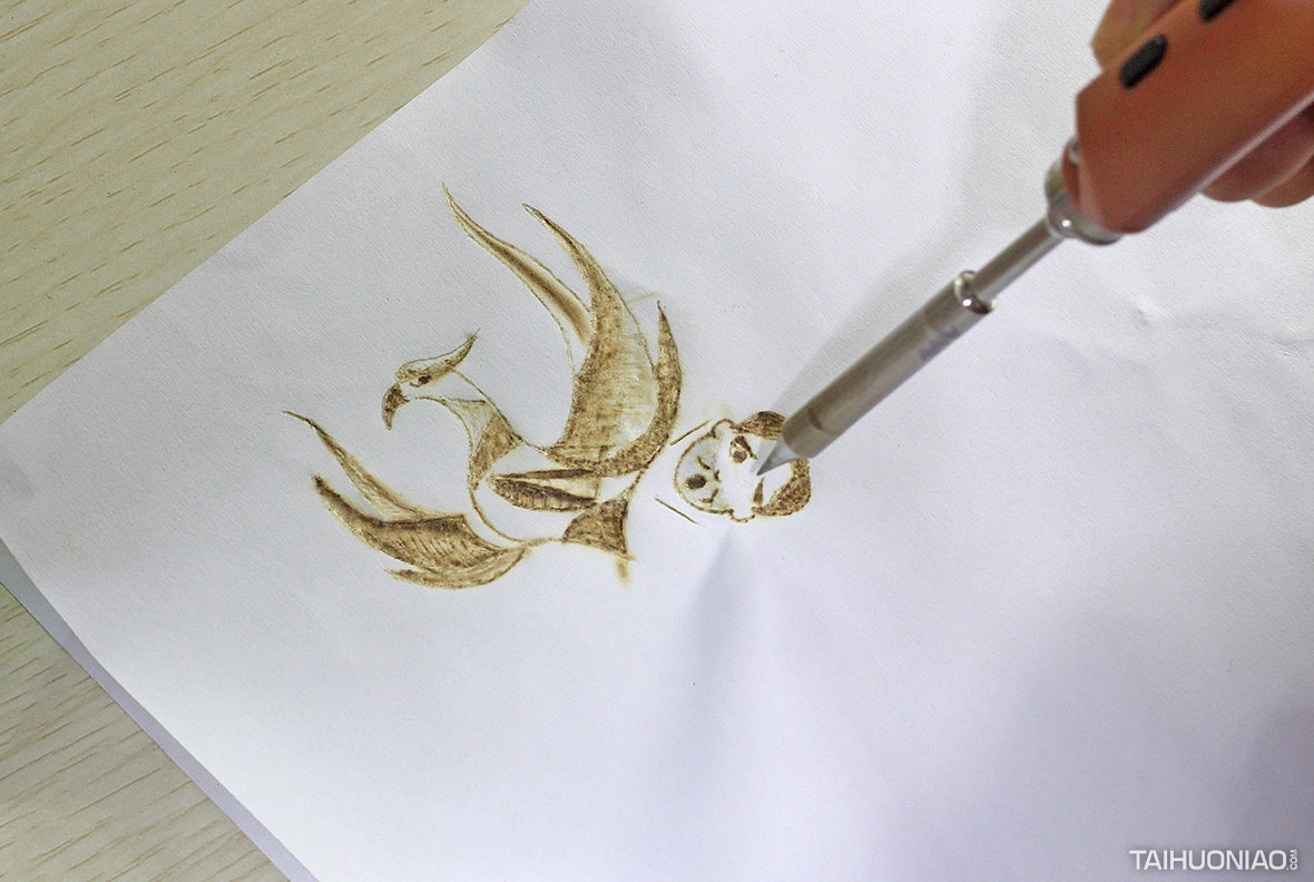

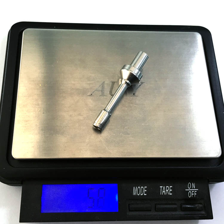

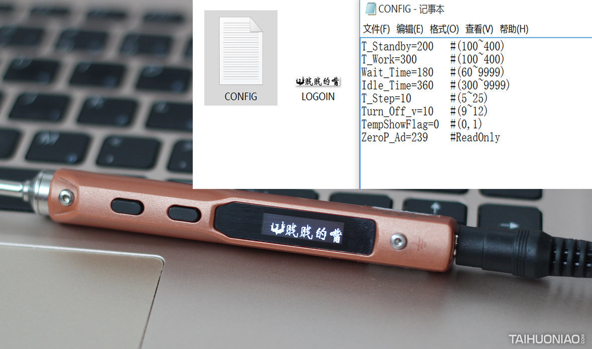

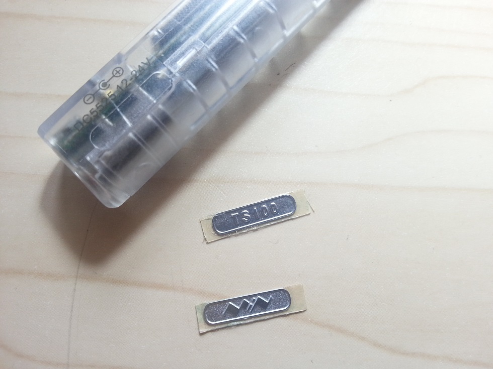

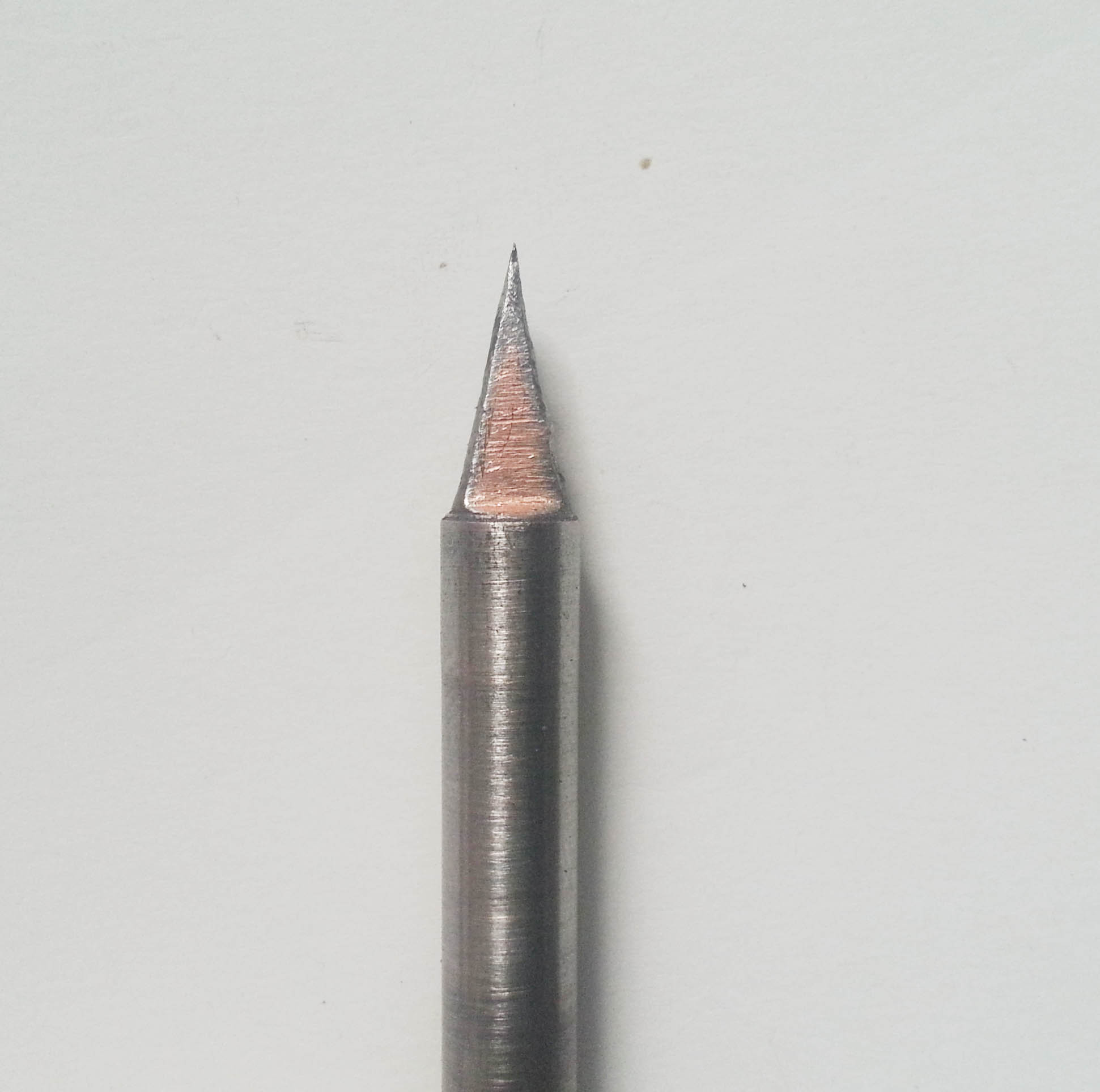

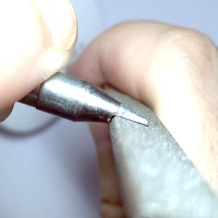

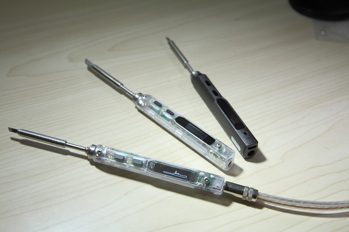

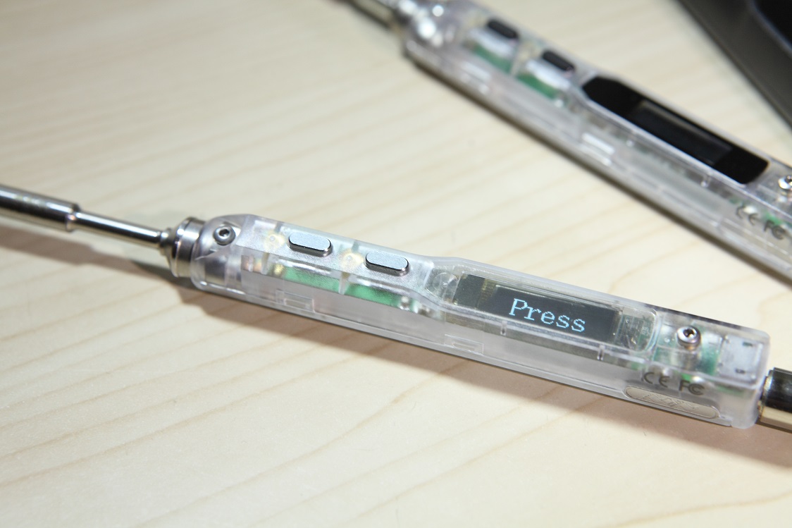

                  more fun picture.......
                  Pic 3 : design your own logo

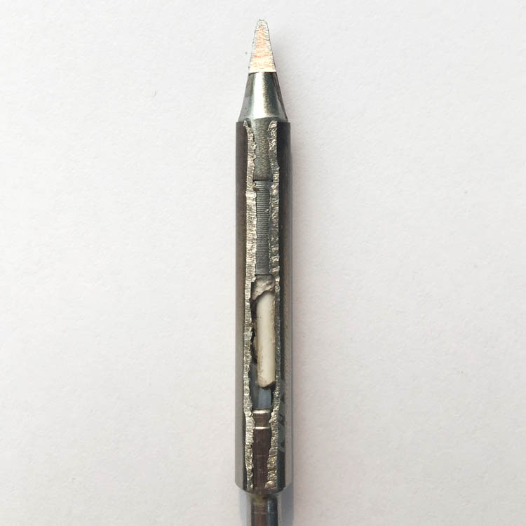

                    #29

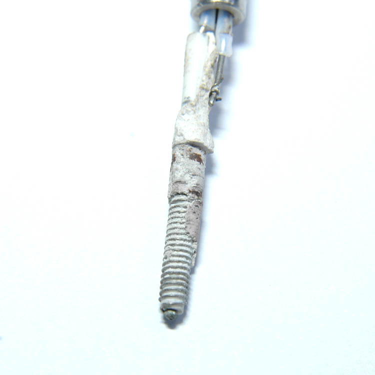

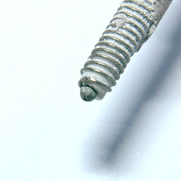

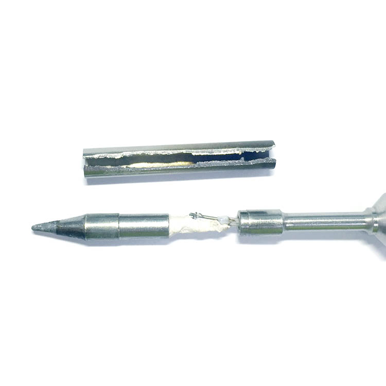

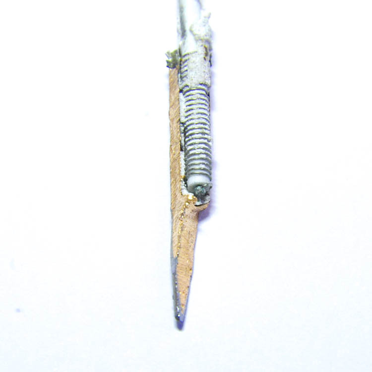

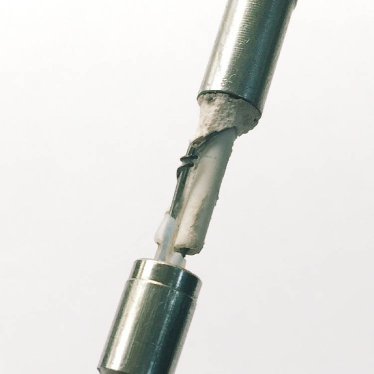

                    I almost gonna do what he just did, CUT IT OPEN.........I have saved $10

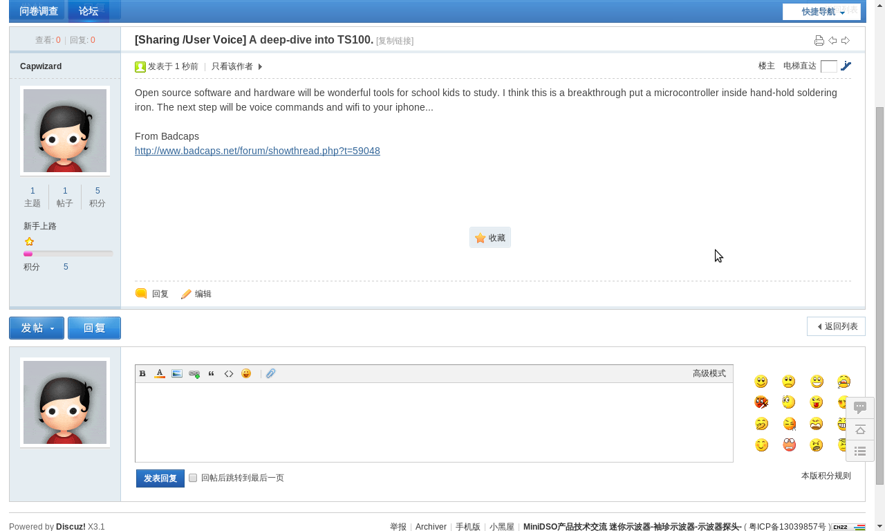

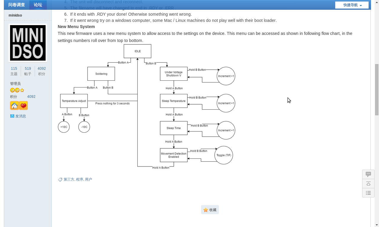

                      Thanks to Mr. Sti once again : have found the official forum with firmware updates etc.
                      http://www.minidso.com/forum.php?mod...display&fid=67
                      Ive posted this on their official forum, now both of us can have crossfire, hope more people will know this product......
