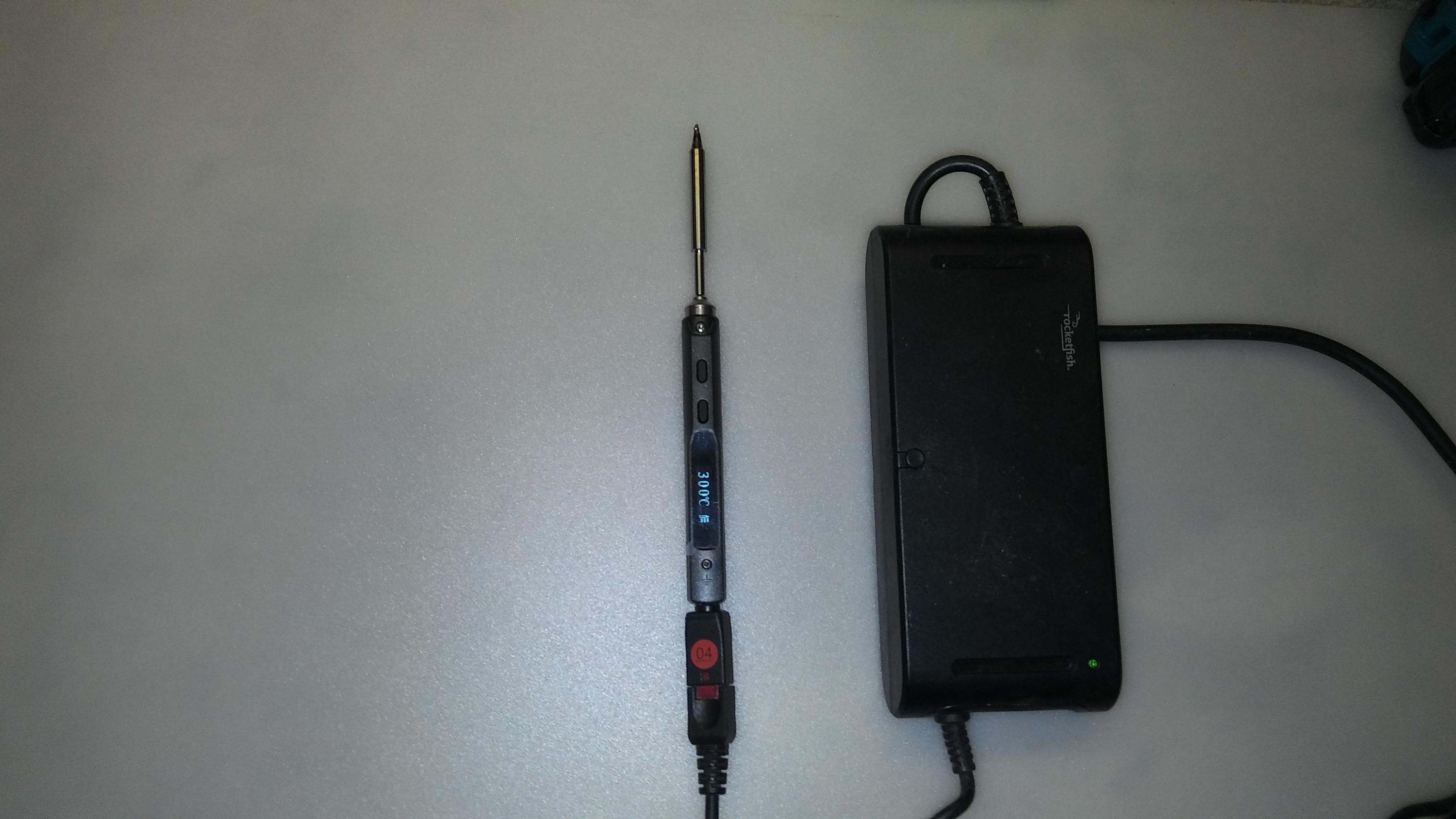

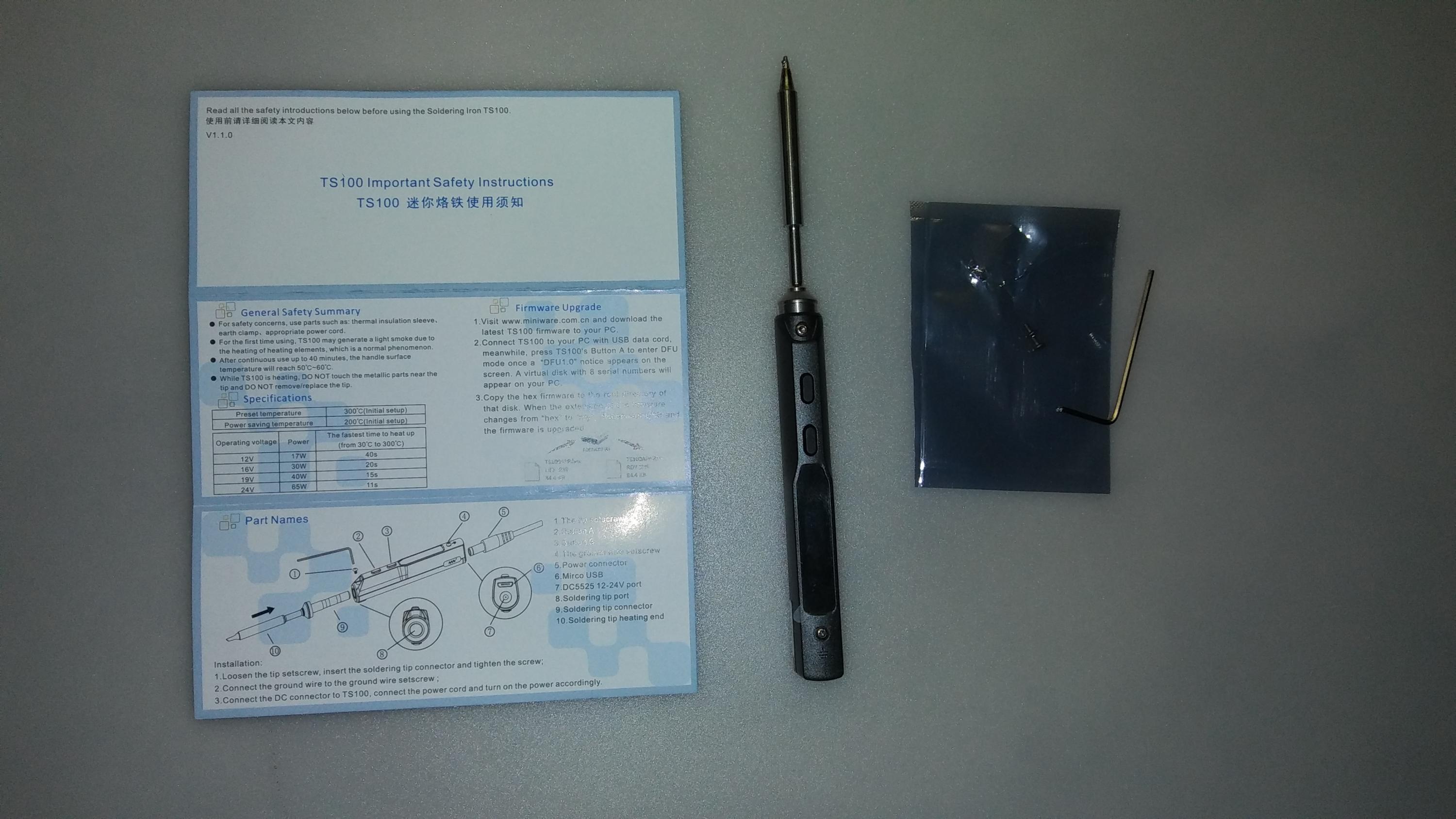

    TS100 OLED Programmable Soldering Iron, Ordered from Banggood, received yesterday, after 20 minutes play around, its feels like my PAL, hope not going to be one of my junks.

    Here are 3 helpful files to you, Could read/download from below.
    >>>>TS100 English User Manual <<<<
    >>>>TS100 Schematic Diagram<<<<
    >>>> TS100 Open Source Code<<<<
    http://www.banggood.com/TS100-Digita...tml?rmmds=cart

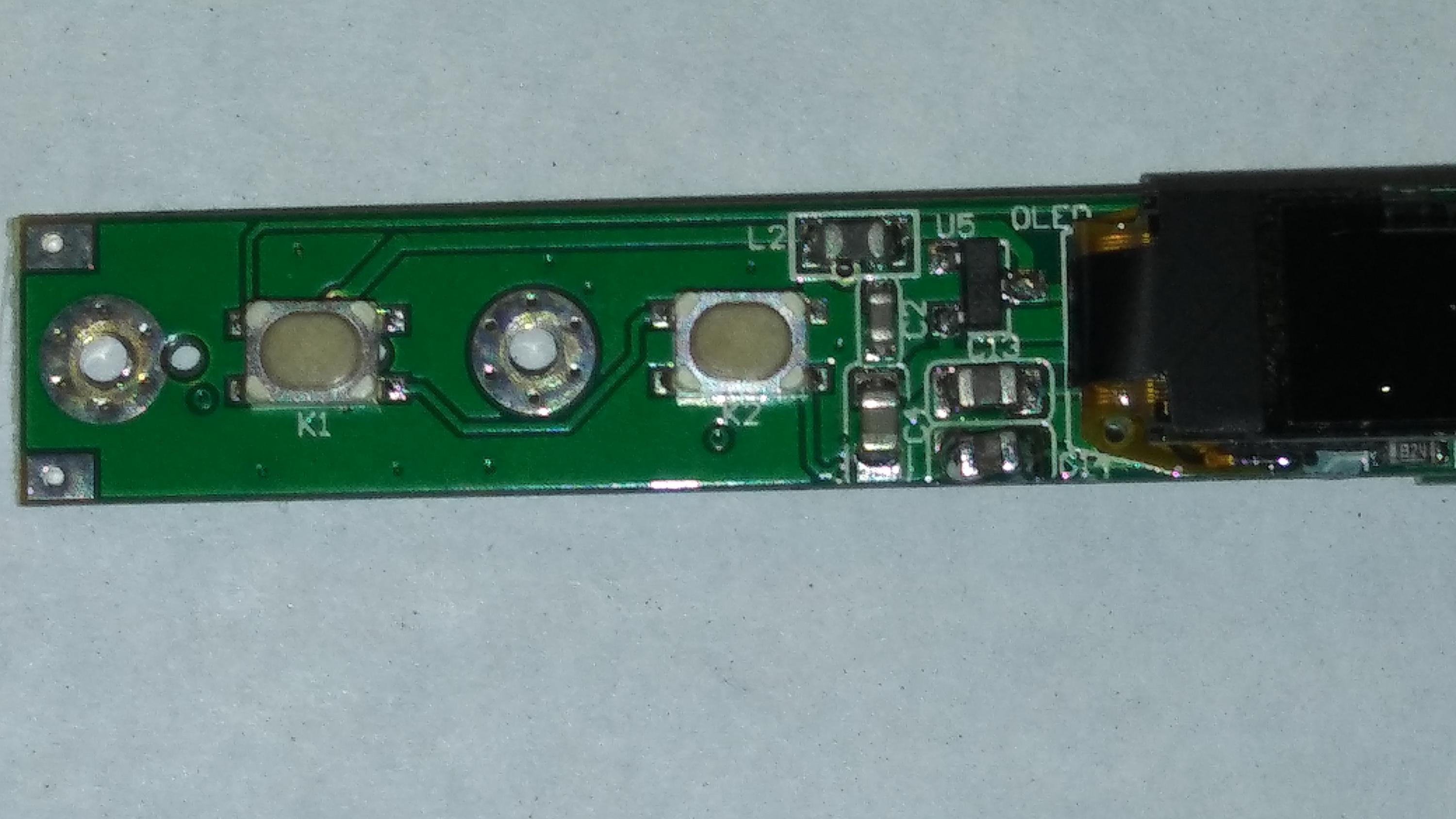

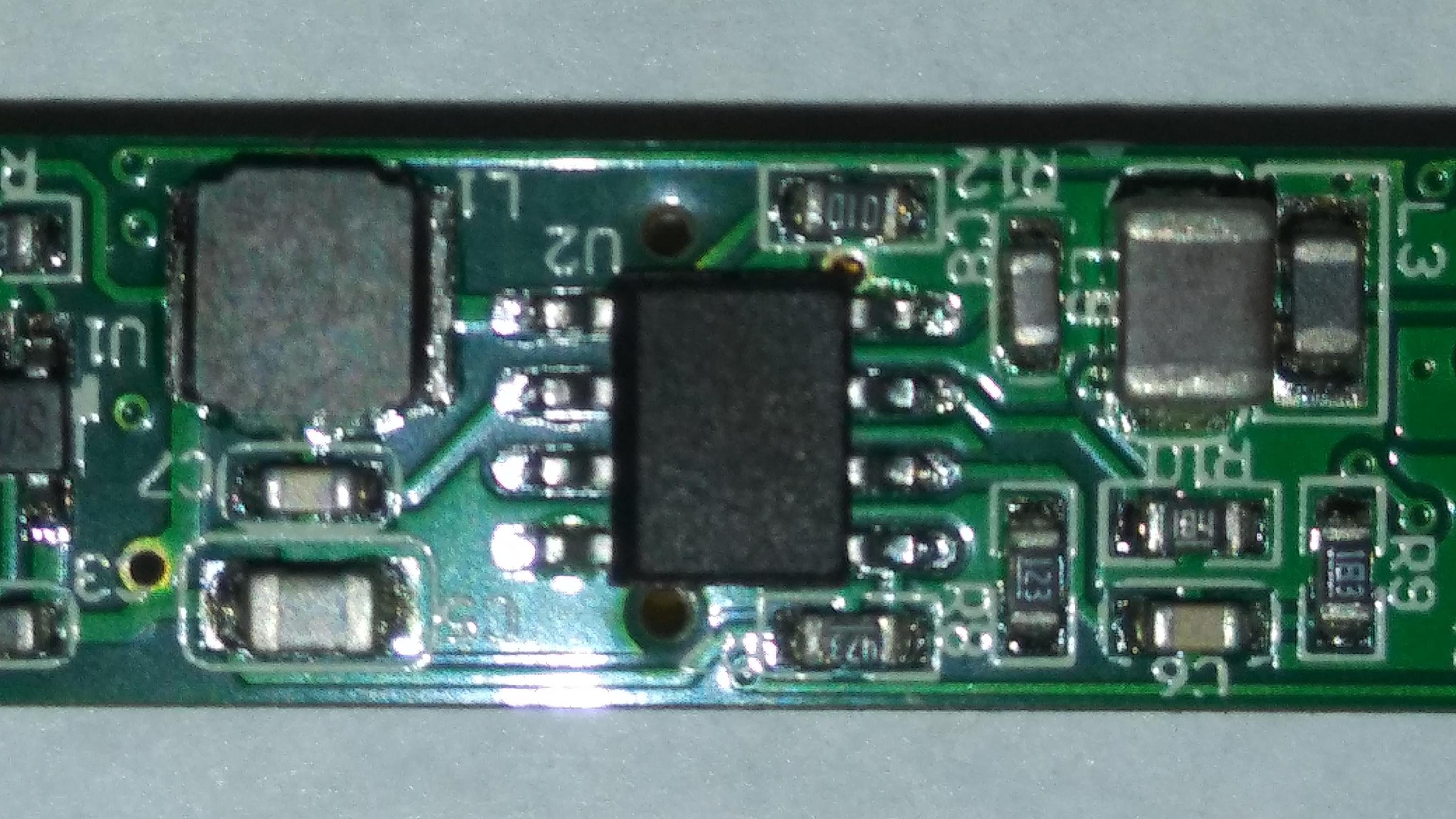

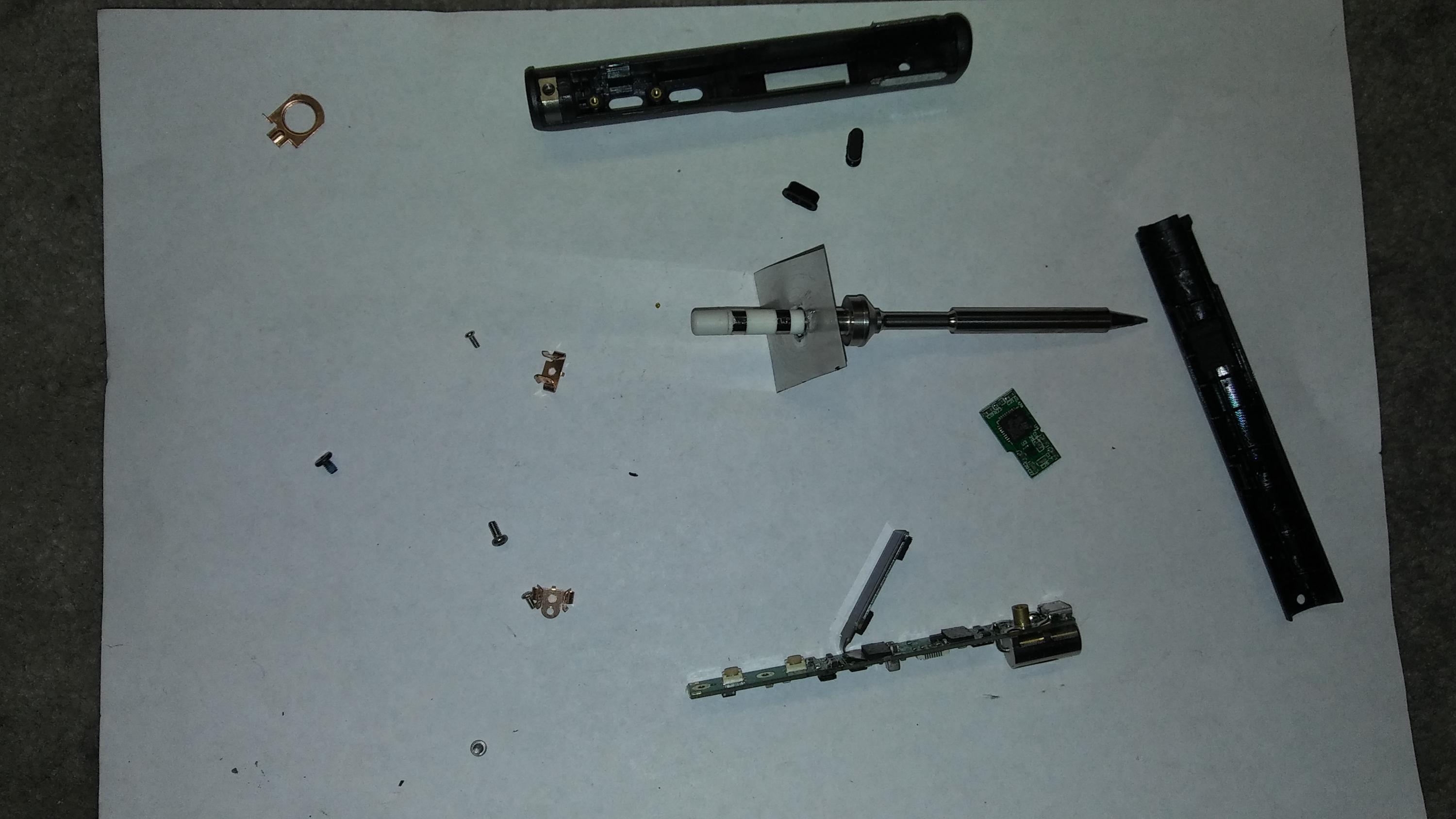

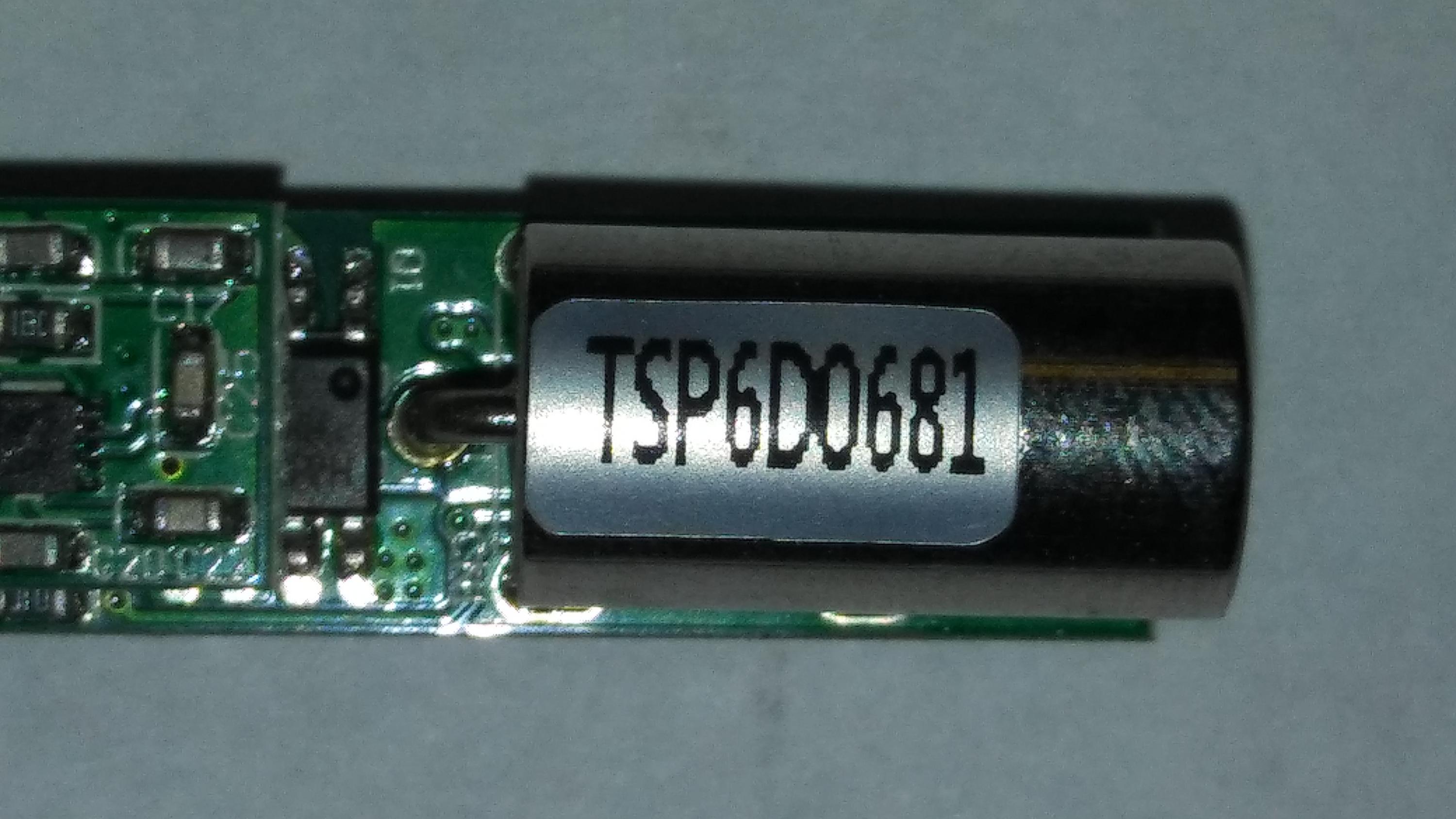

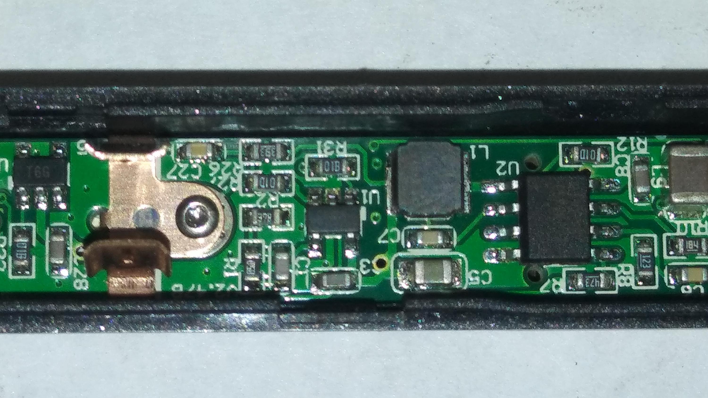

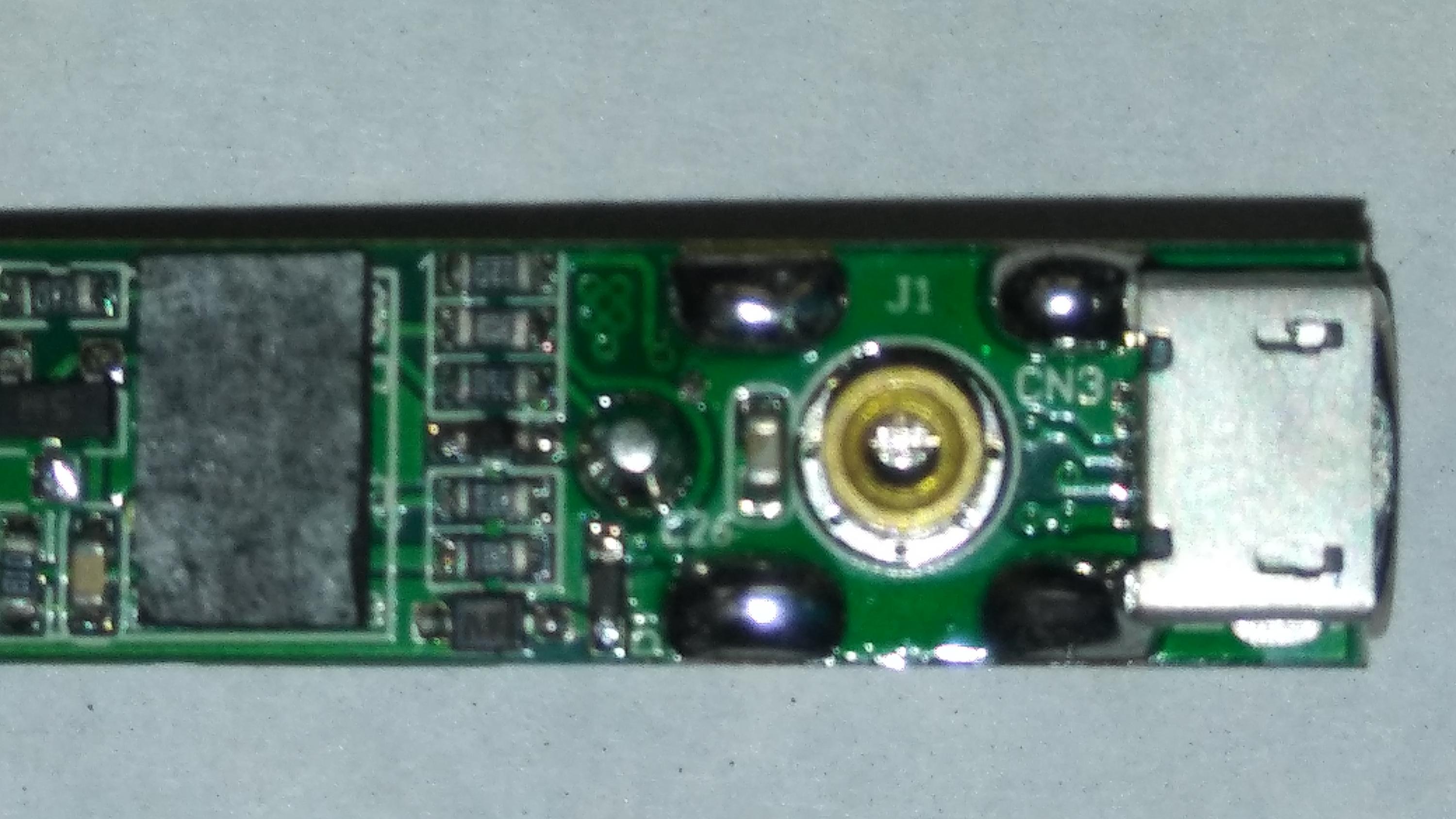

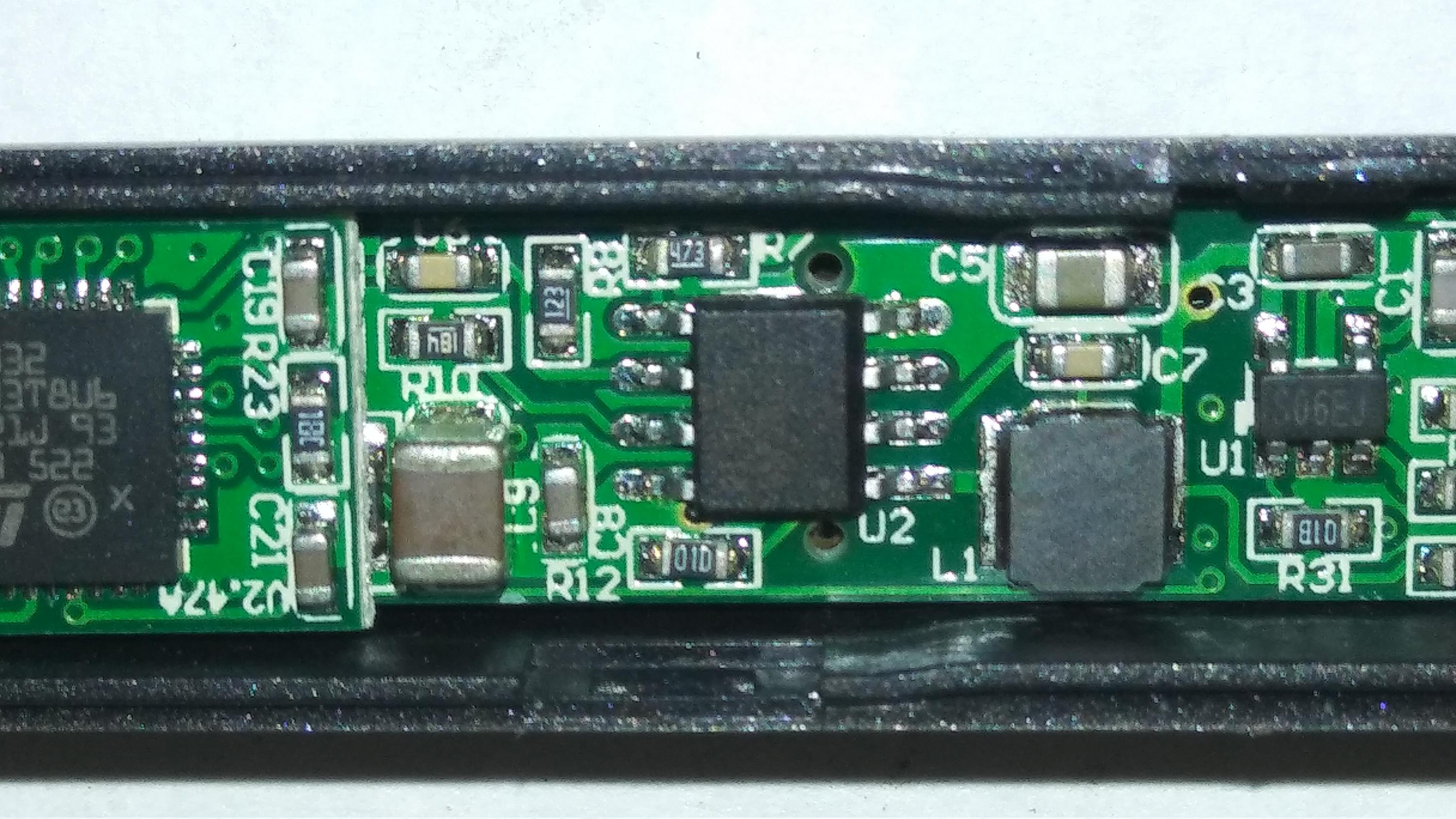

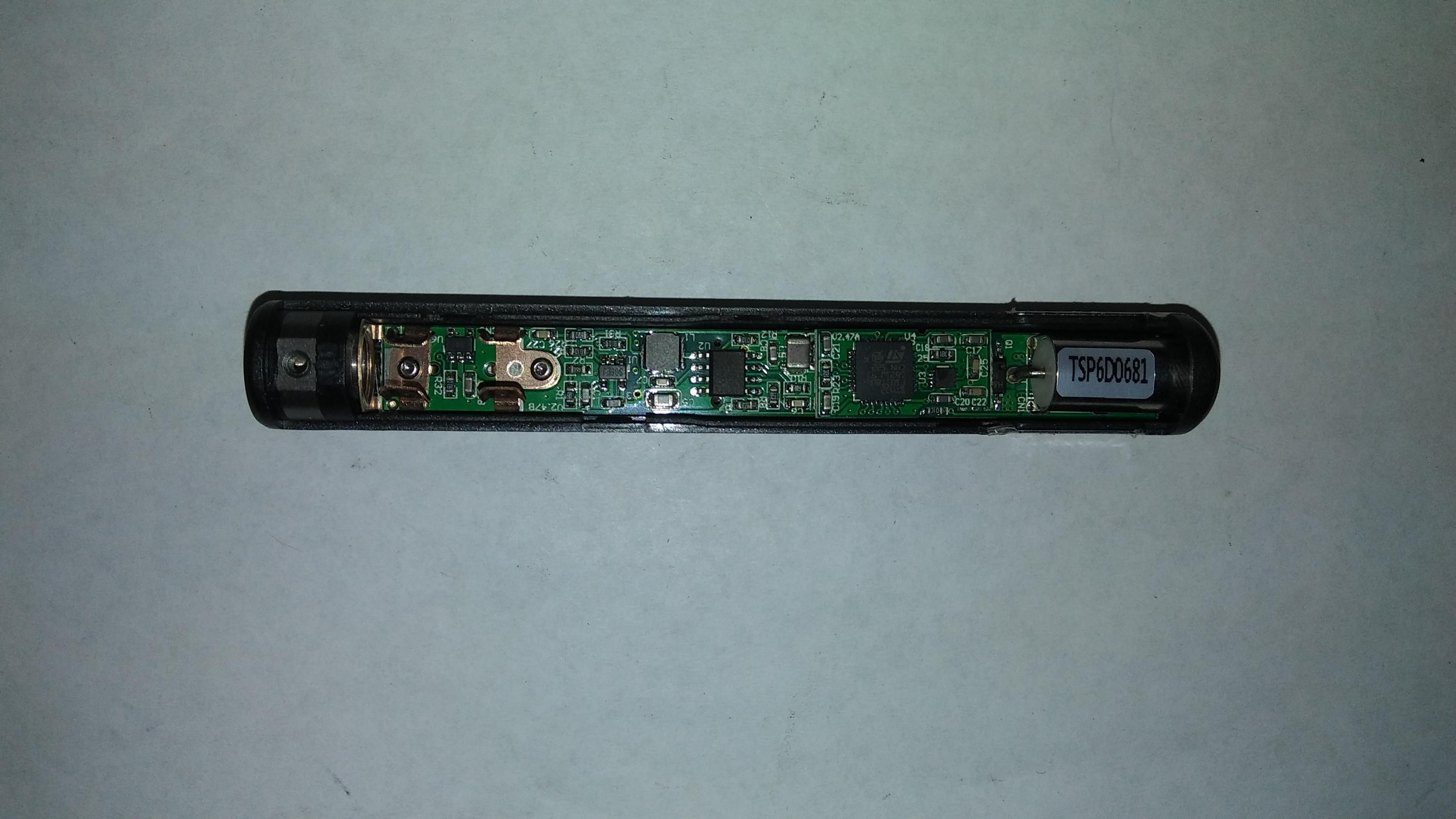

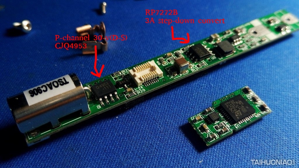

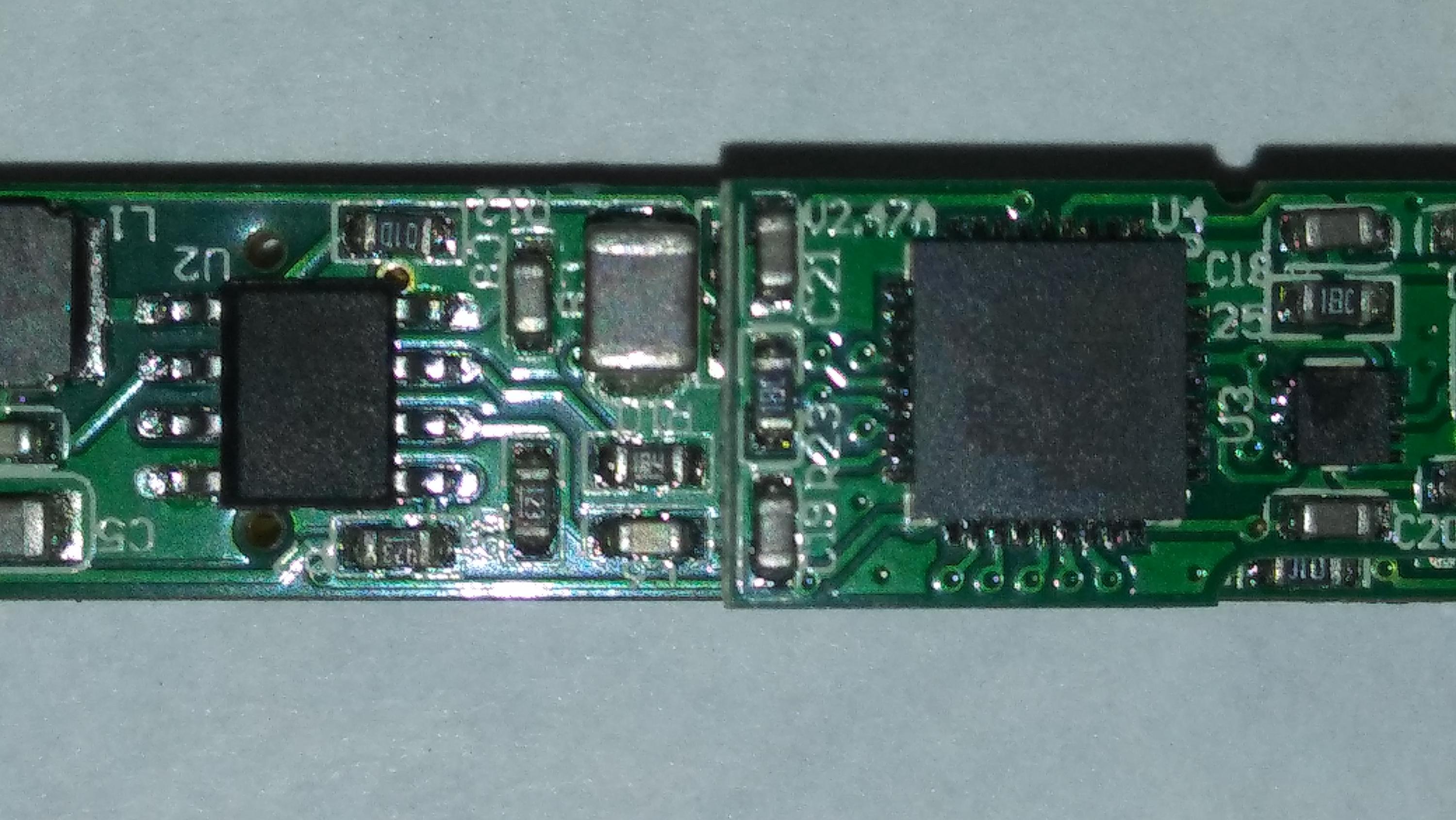

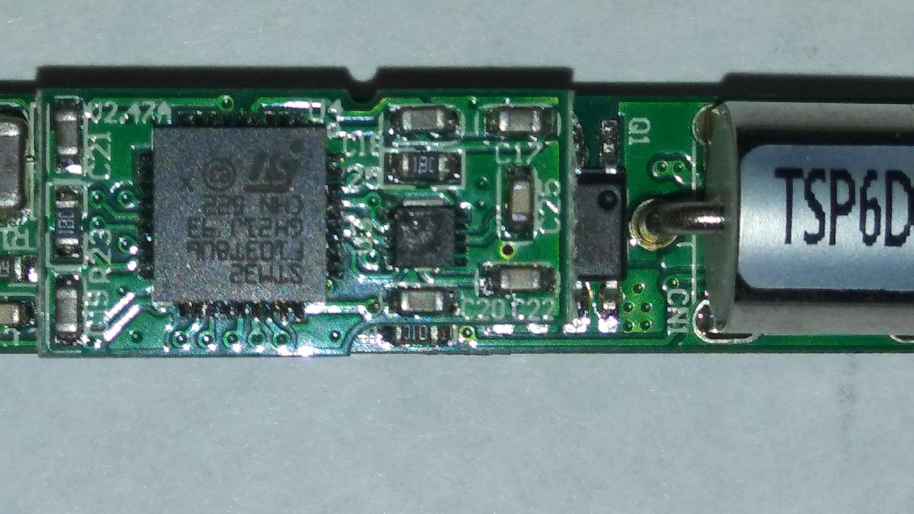

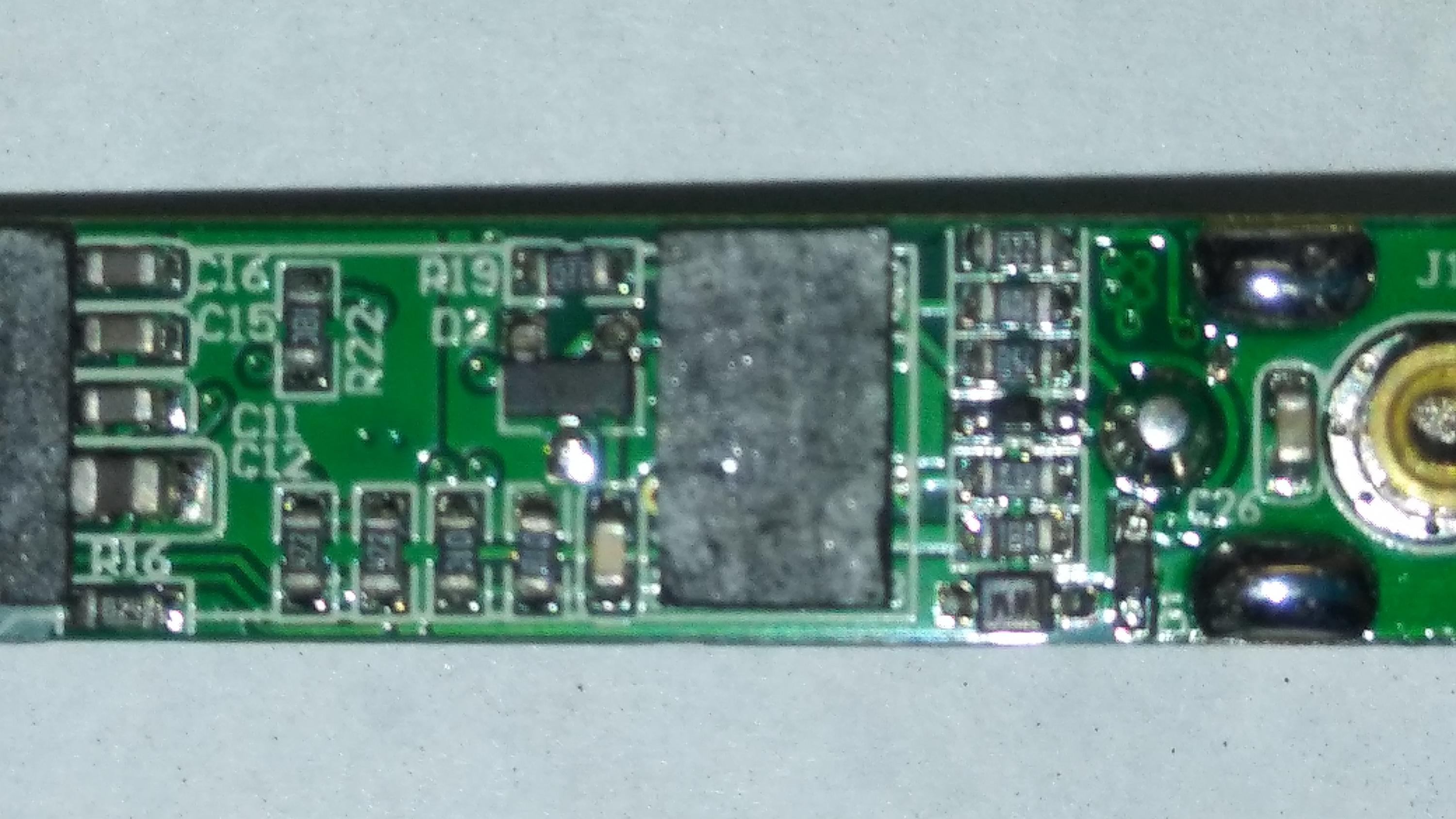

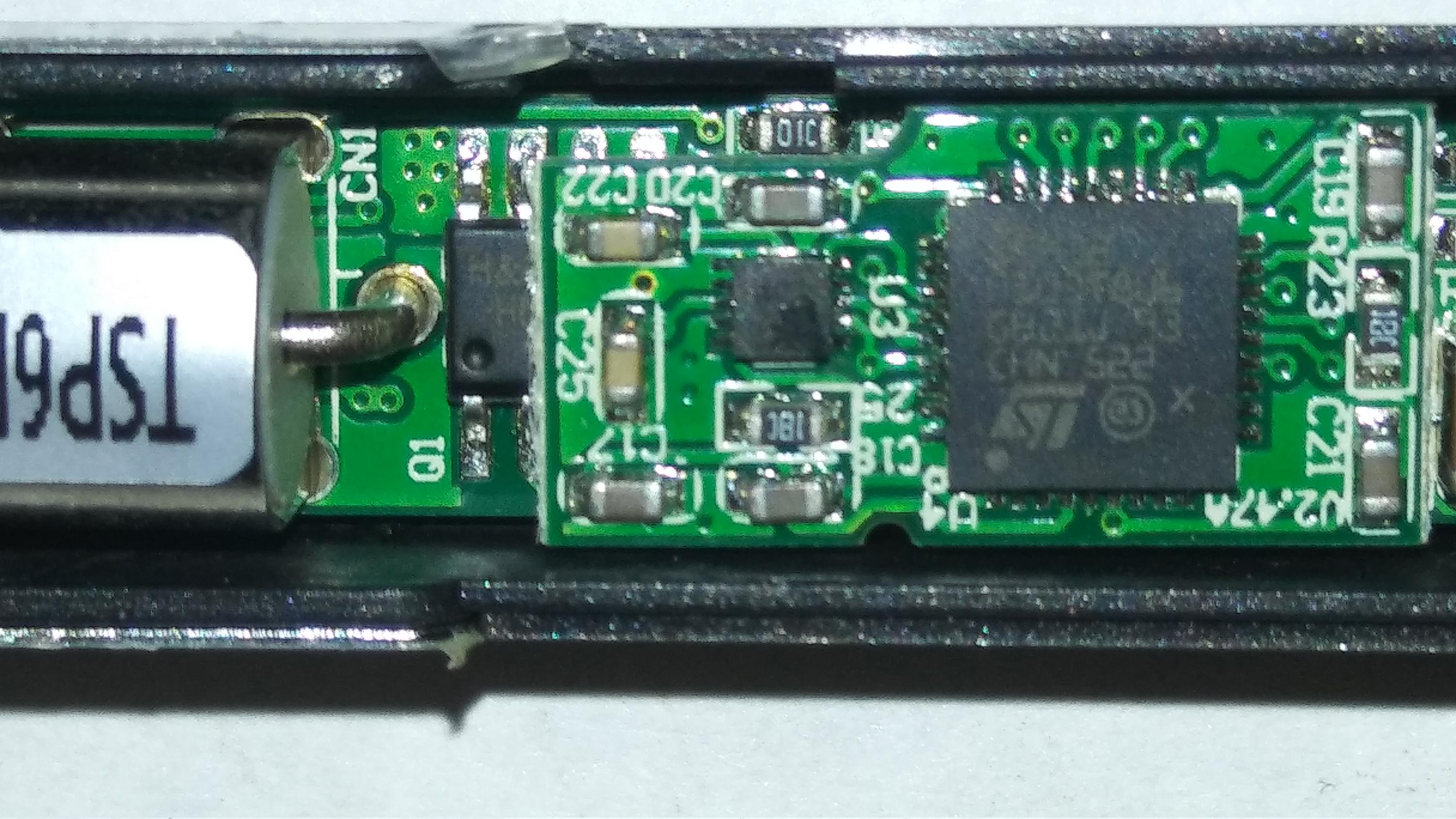

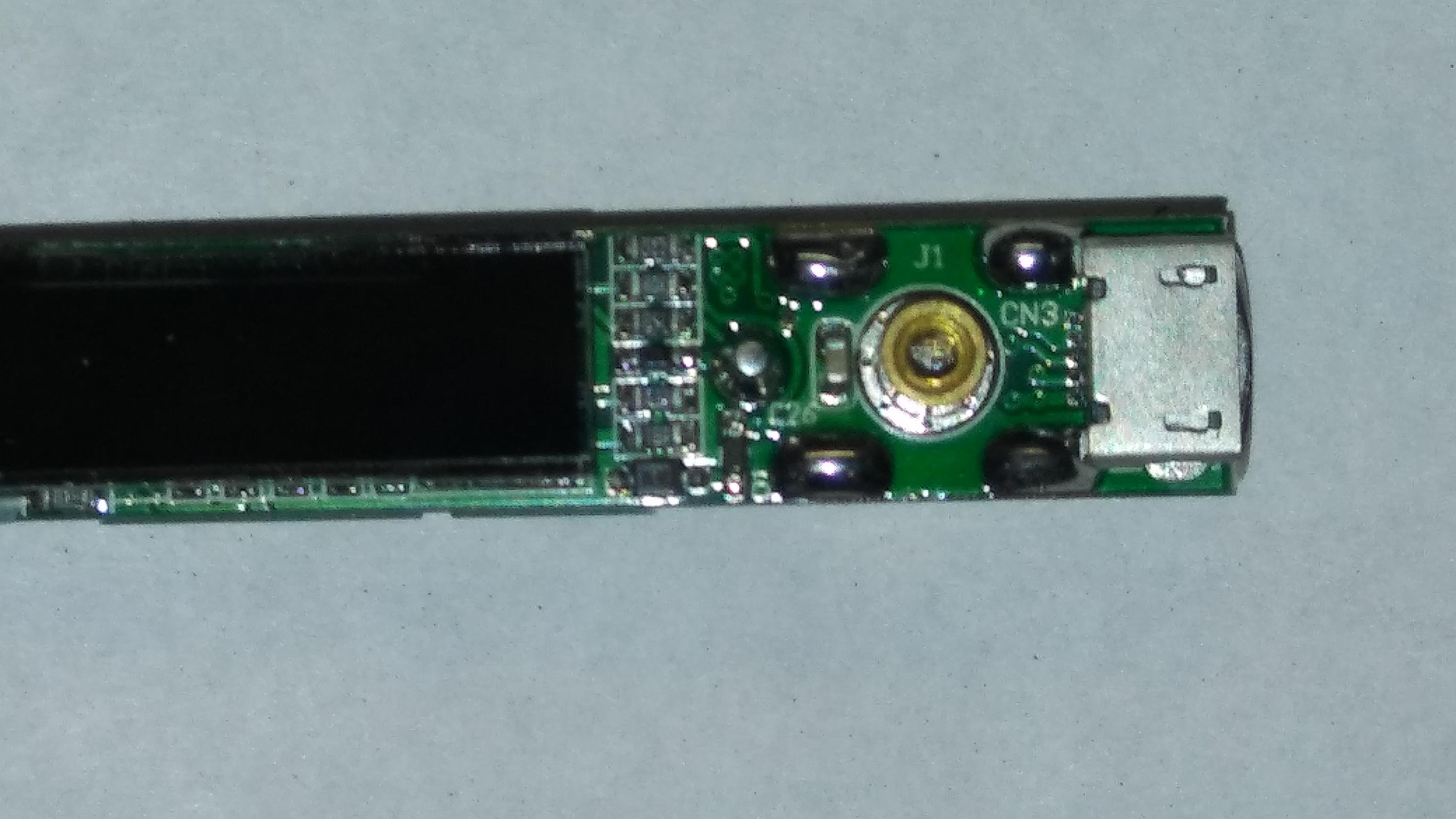

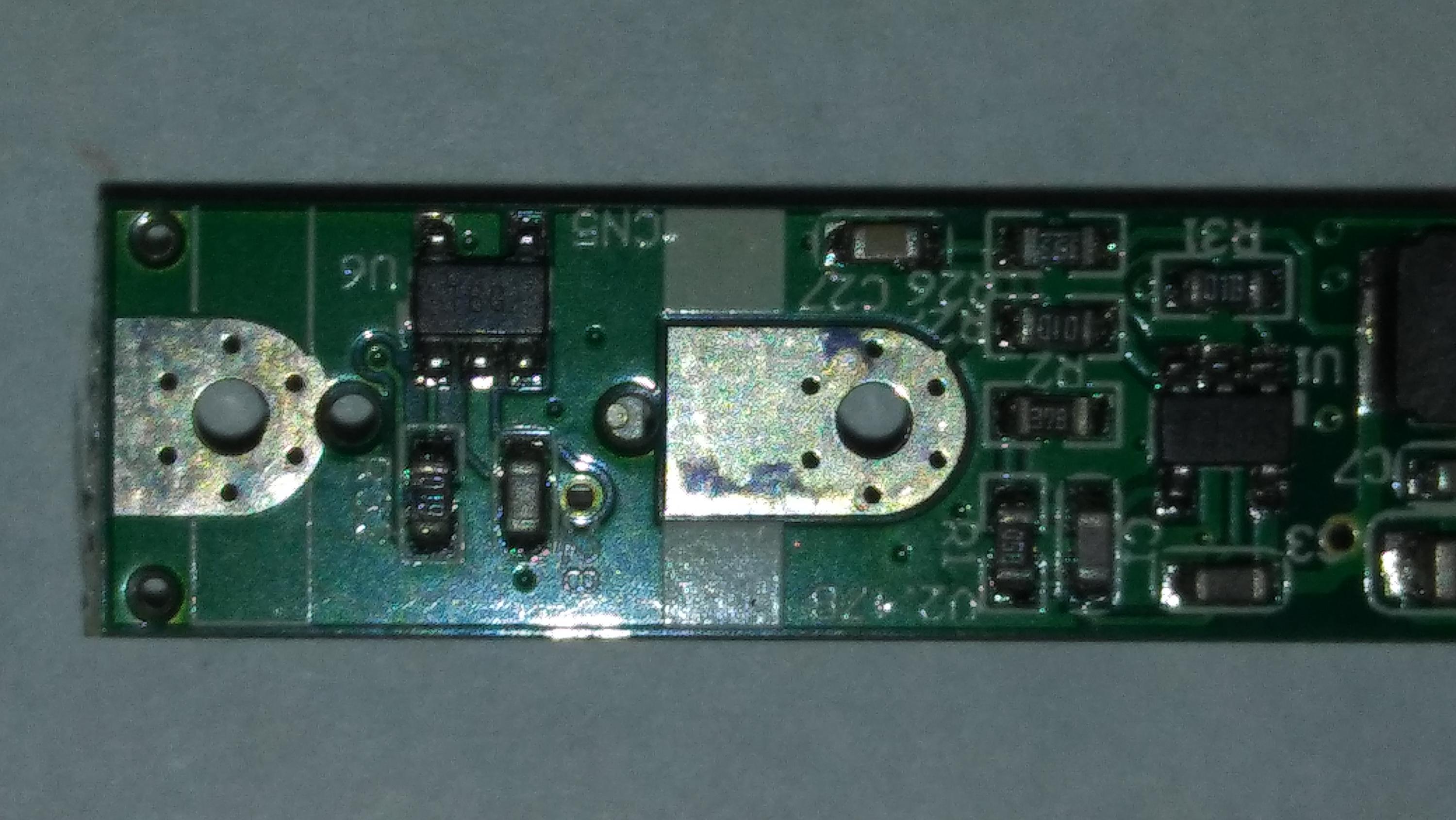

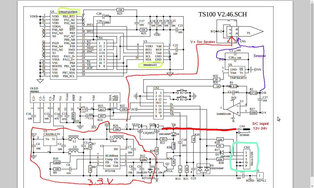

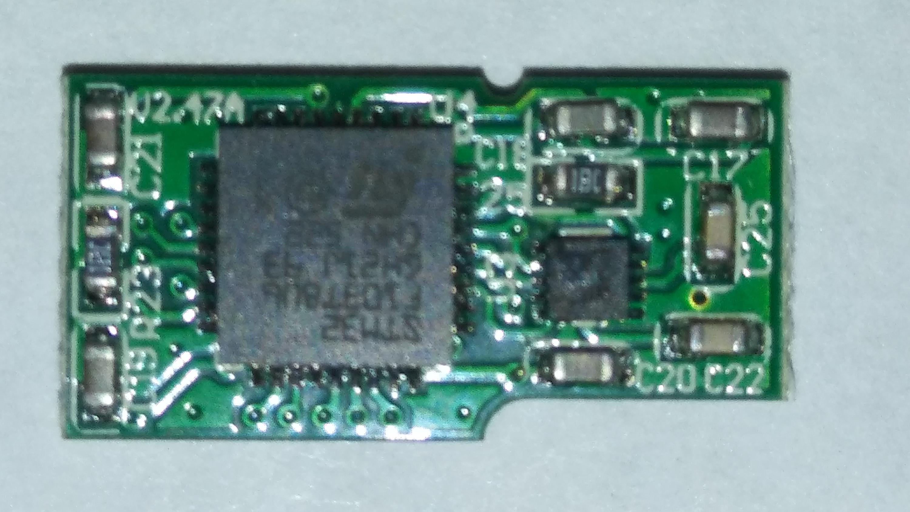

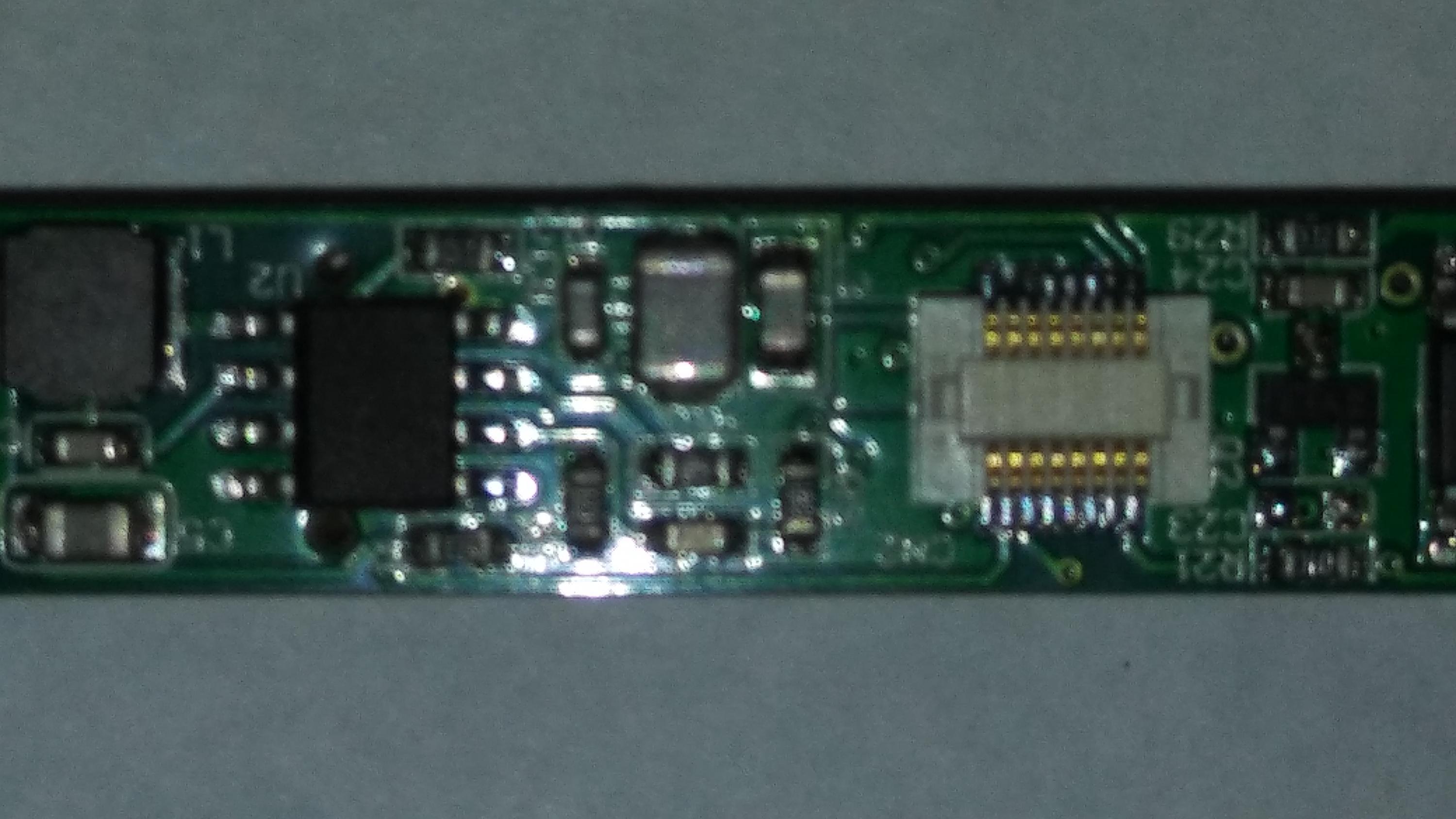

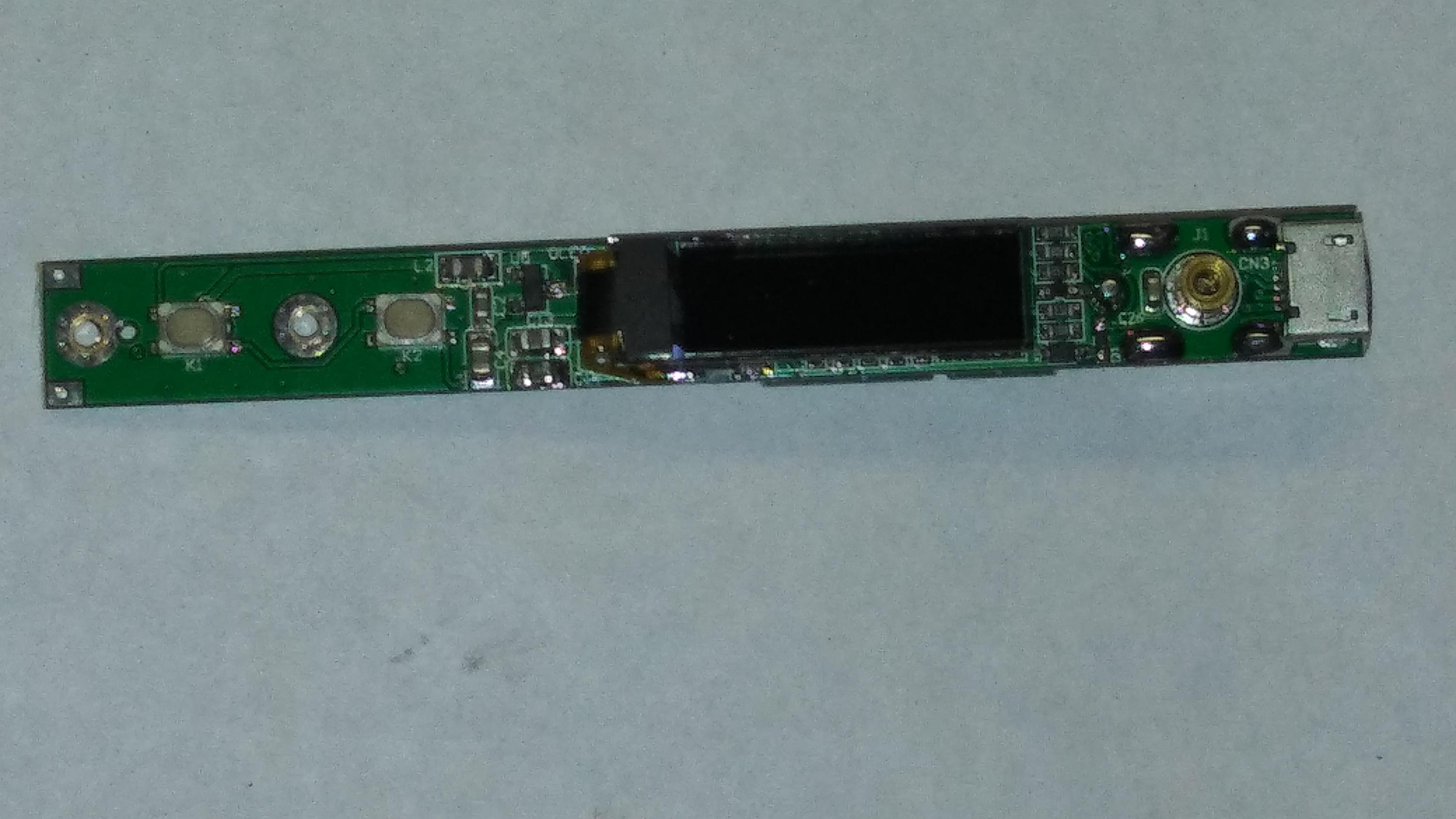

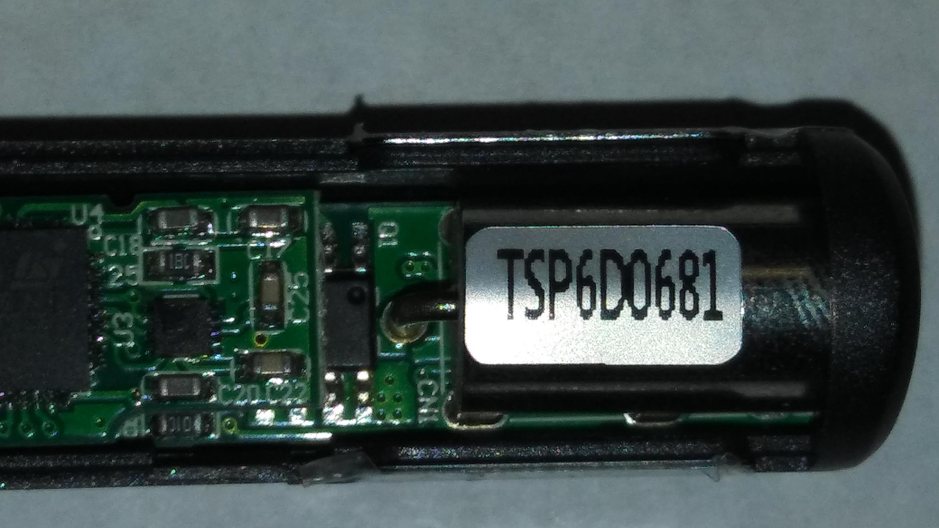

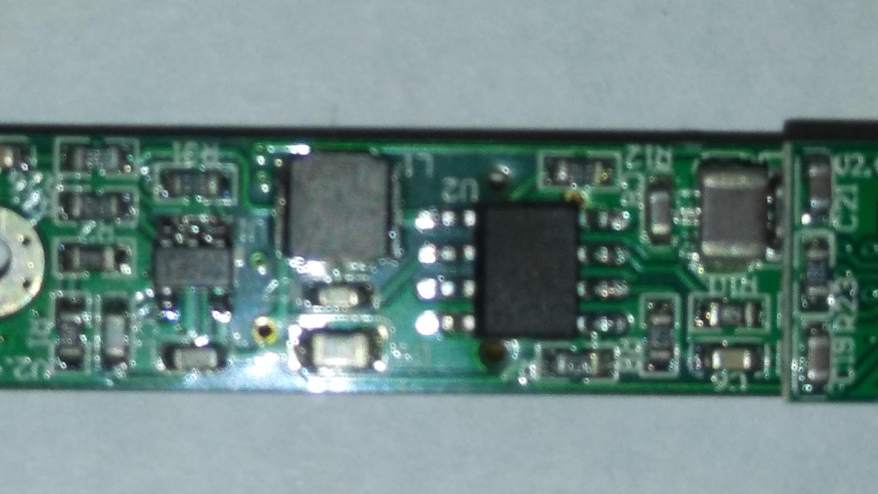

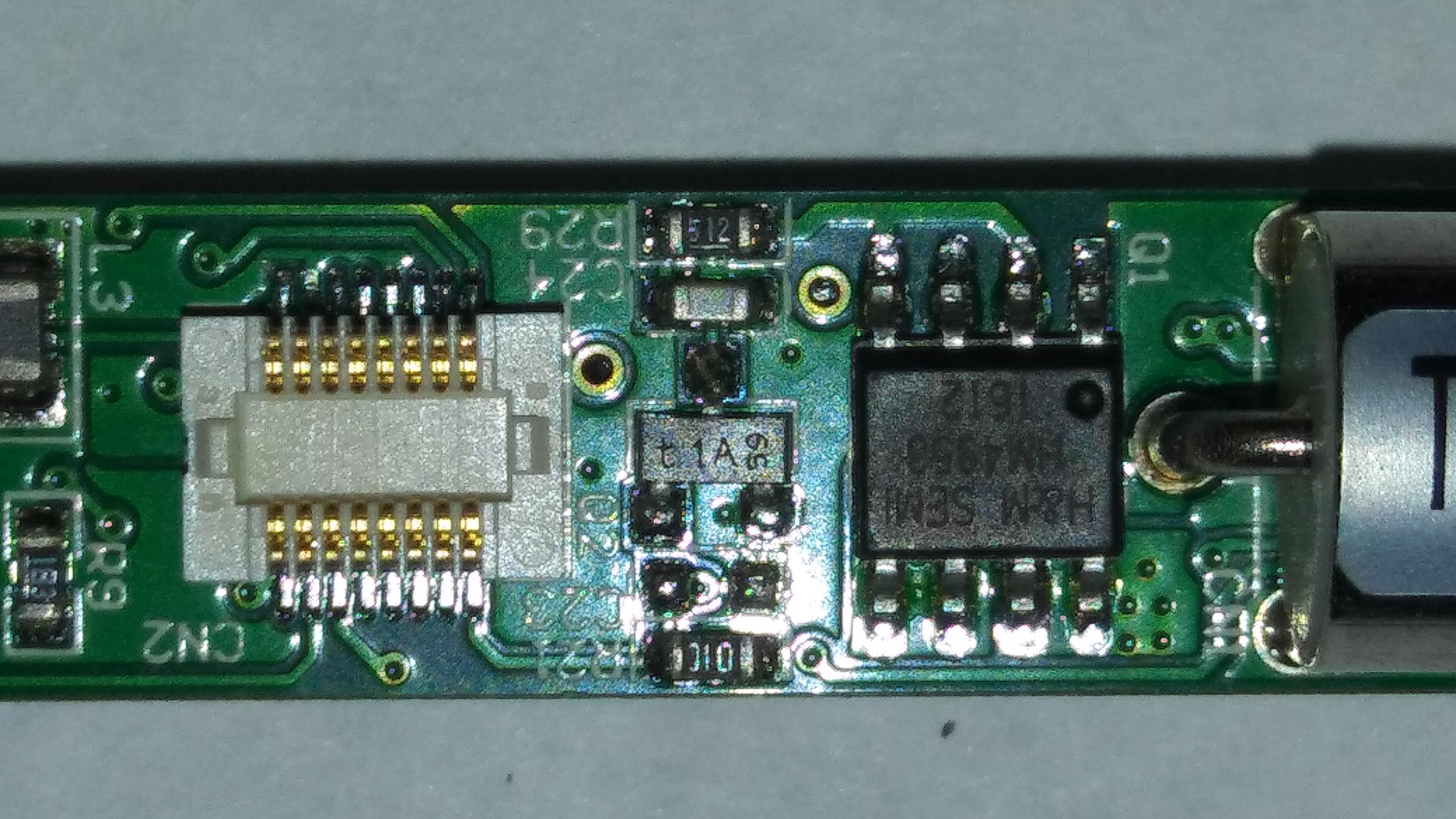

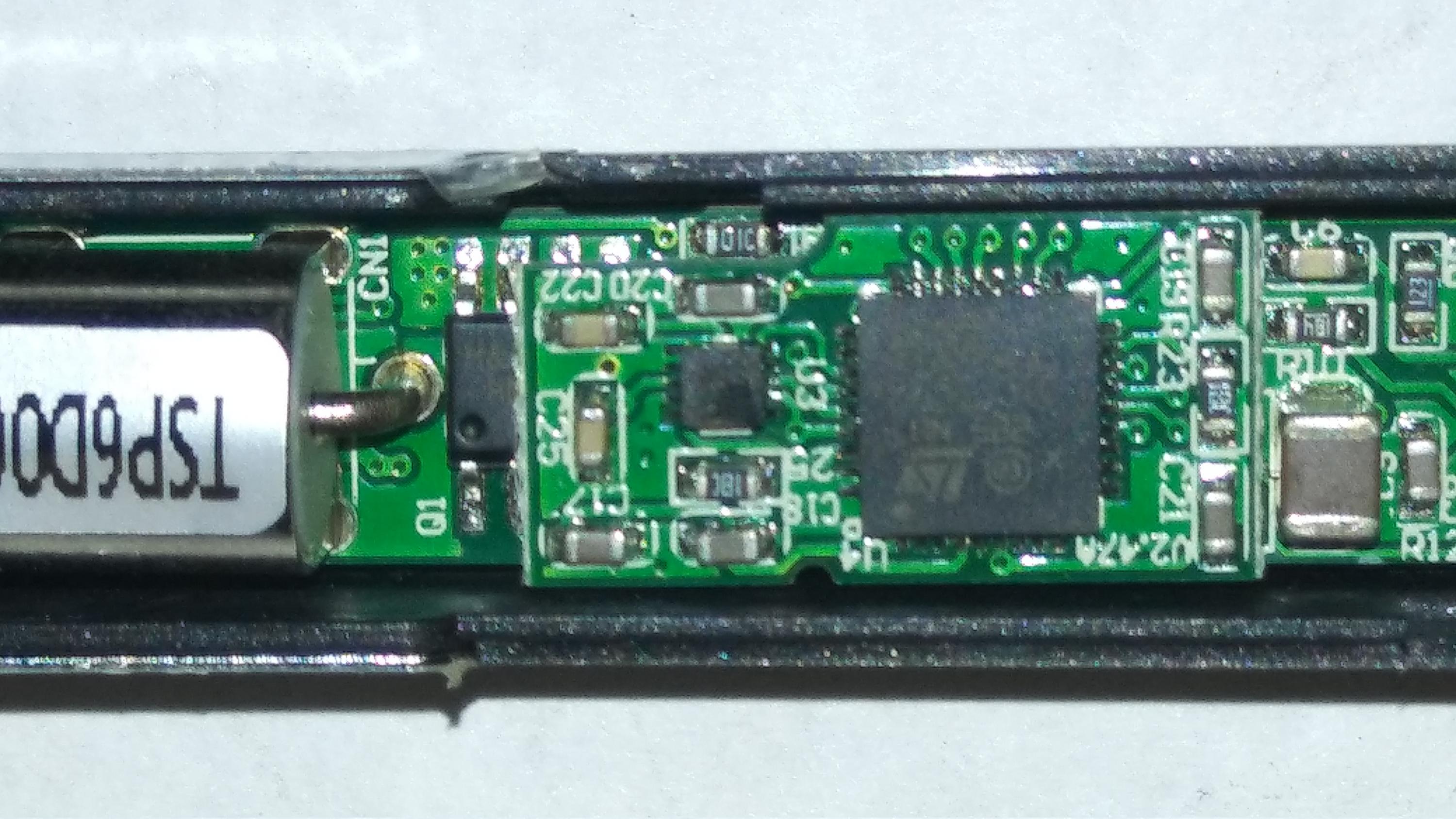

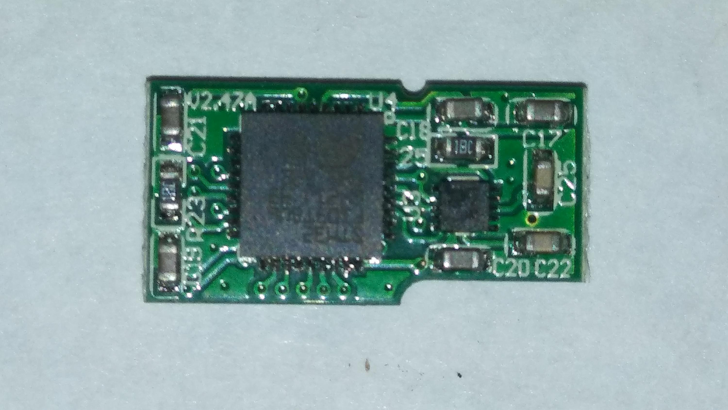

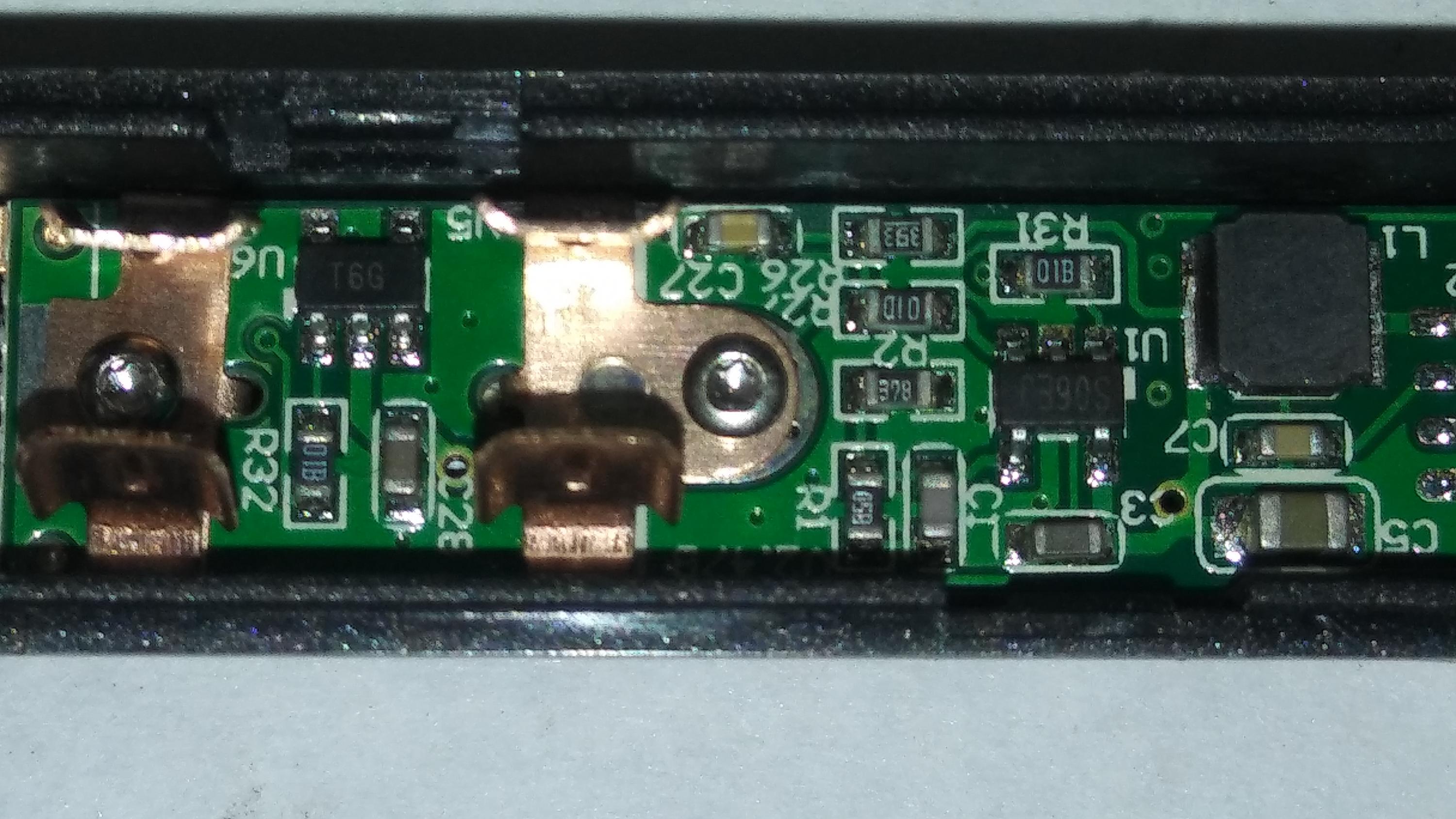

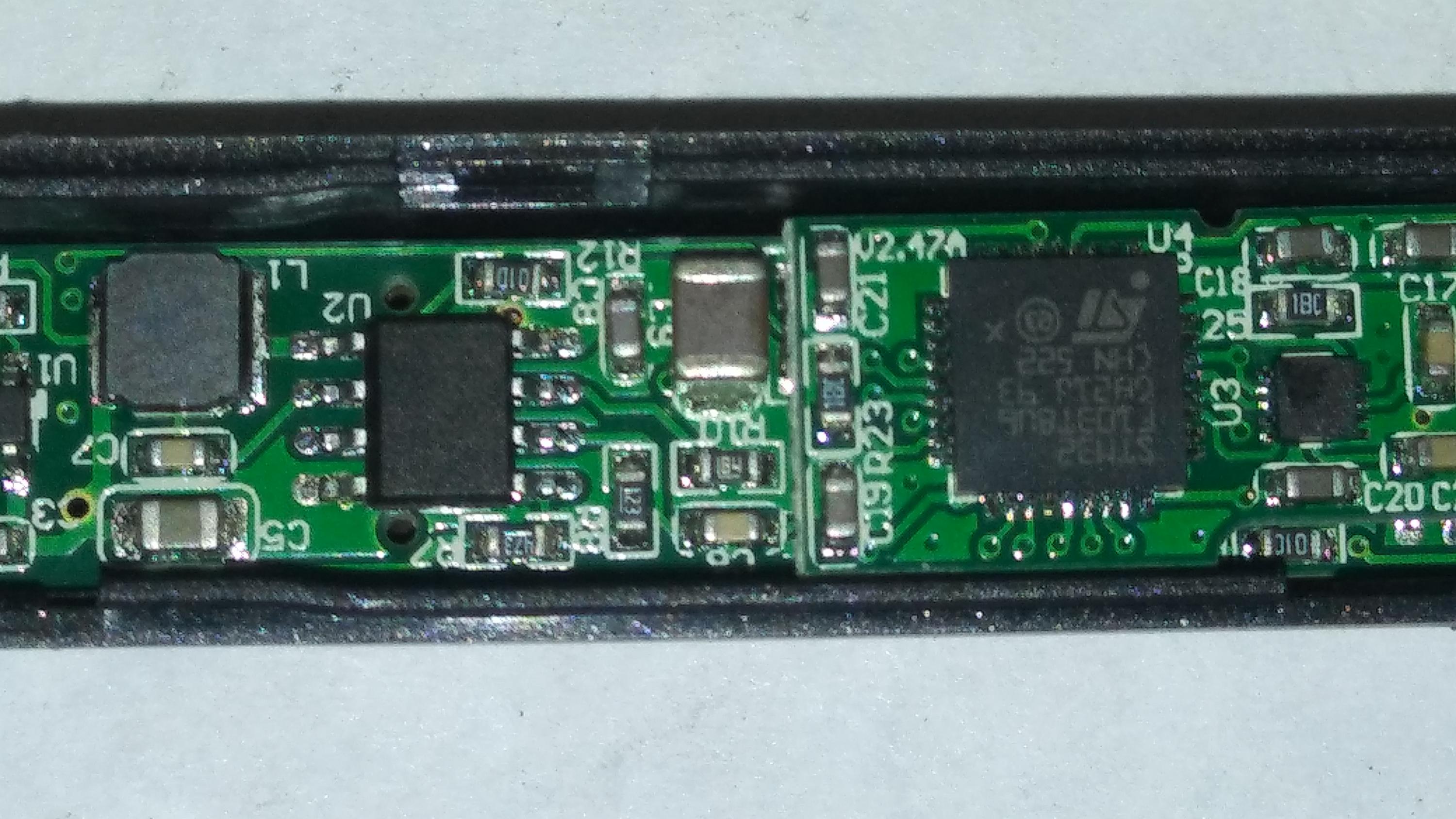

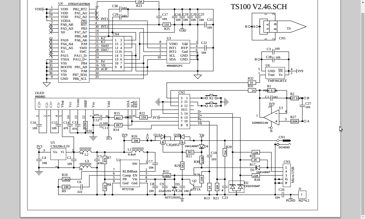

    Hardware: I study each IC by myself.
    U1 SGM8551XN : Single-Supply, Single Rail-to-Rail I/O Precision Operational Amplifier.
    https://cdn.badcaps-static.com/pdfs/...65384ebfbe.pdf
    U2 RT7272B : 3A, 36V, 500kHz Synchronous Step-Down Converter.

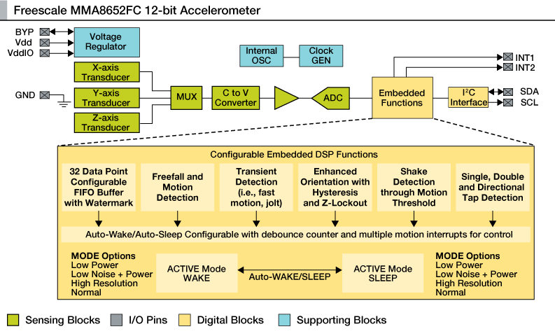

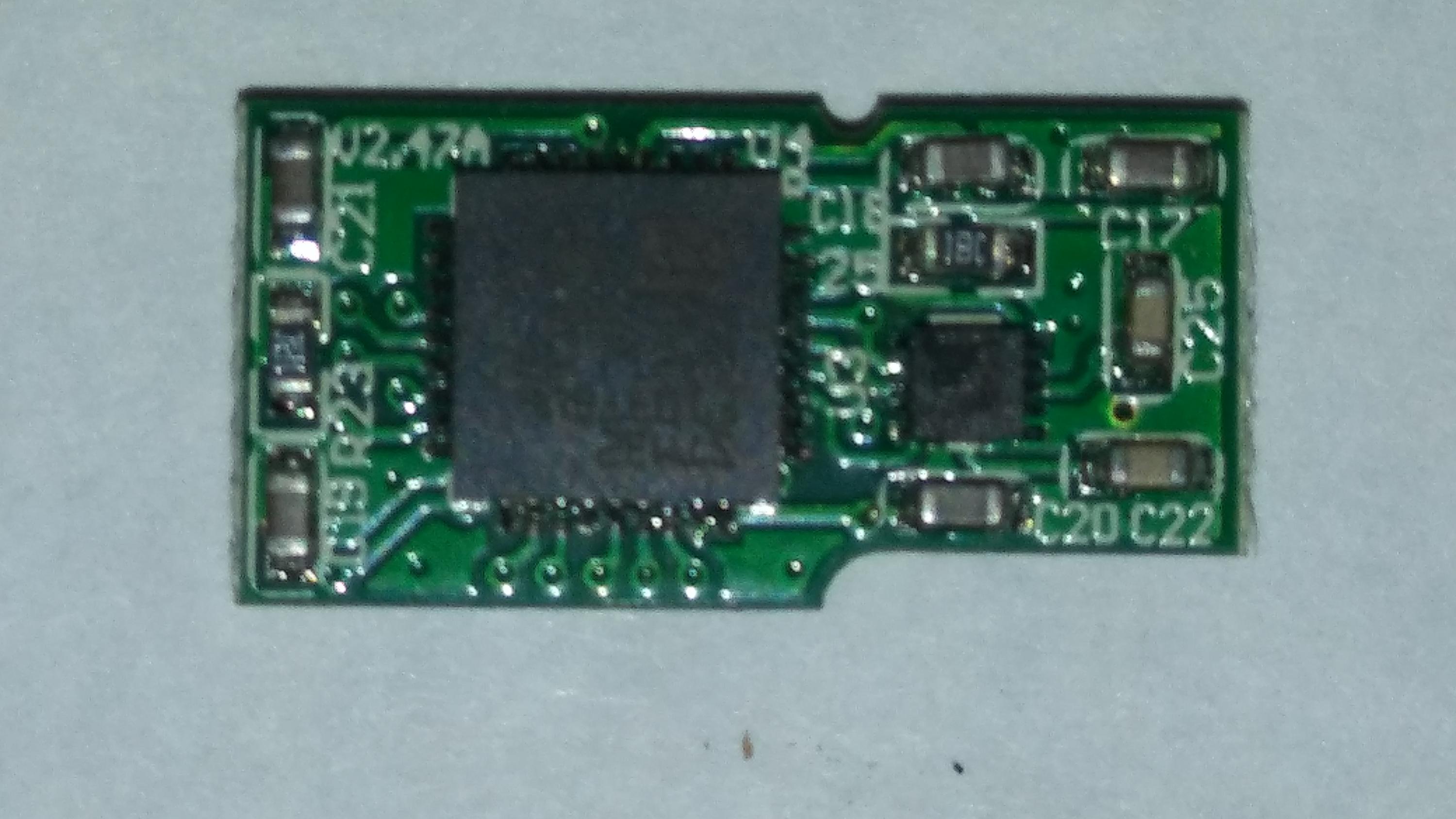

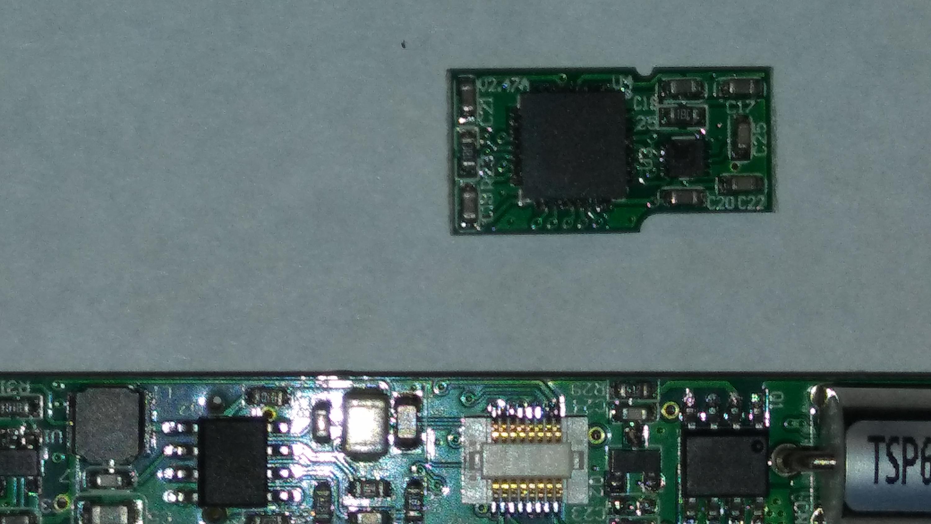

    U3 MMA8652FC : Freescale Semiconductor, 3-Axis, 12-bit, Digital accelerometer. Pic 3
    U4 STM32F103T8U6: Medium-density performance line ARM-based 32-bit MCU with 64
    or 128 KB Flash, USB, CAN, 7 timers, 2 ADCs, 9 com. interfaces ARM® 32-bit Cortex®-M3 CPU Core
    https://cdn.badcaps-static.com/pdfs/...e2440eba90.pdf
    U5 CX6206-3.3V: a CMOS step-down voltage regulator with high ripple rejection, low power, low dropout, overcurrent and short circuit protection. These devices have very low quiescent bias current (8.0μA Typ.) Which can deliver 250mA output current with very small input and output voltage differences, Output voltage: 1.2V-5. 0V (steps of 0. 1V), High precision output voltage: ± 2%, Low temperature adjustment factor.
    U6 TMP36GRTZ: Low Voltage Temperature Sensors.
    https://cdn.badcaps-static.com/pdfs/...02981bb424.pdf

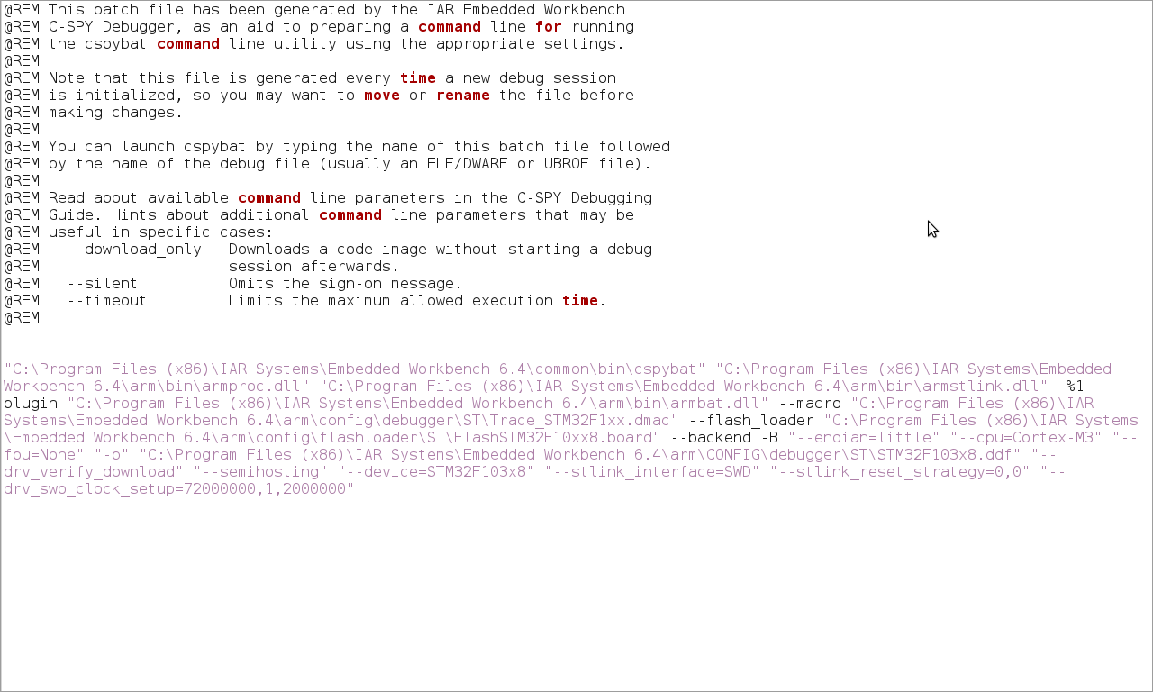

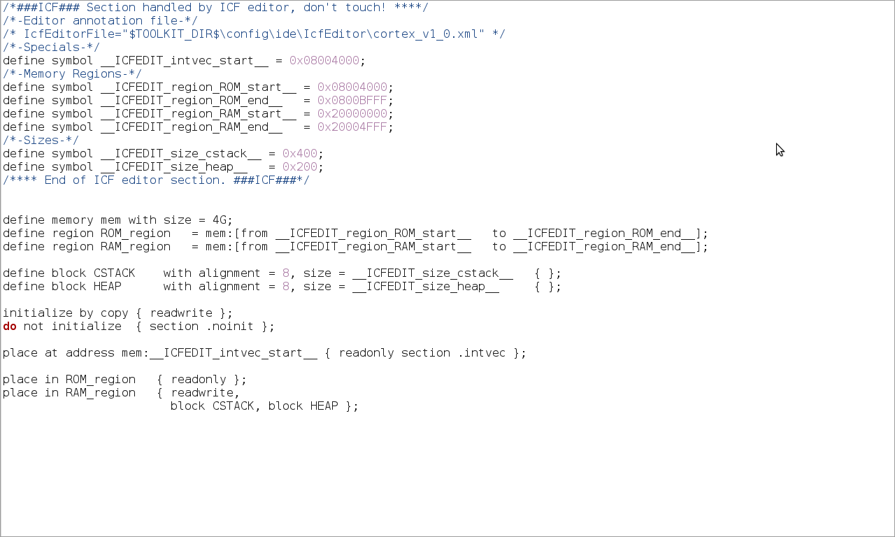

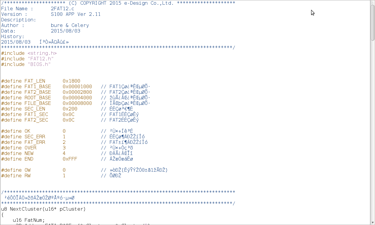

      Open source software.

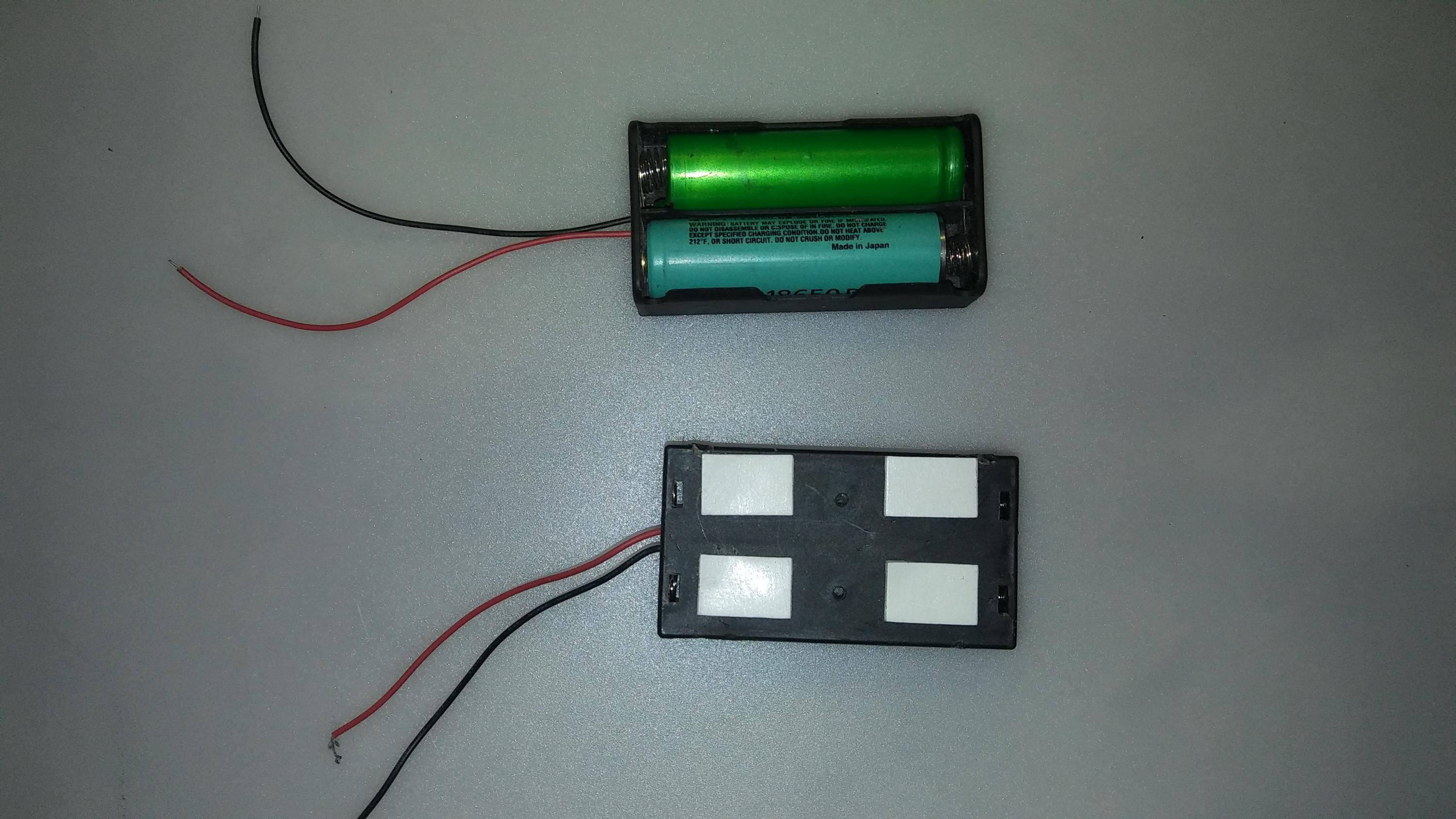

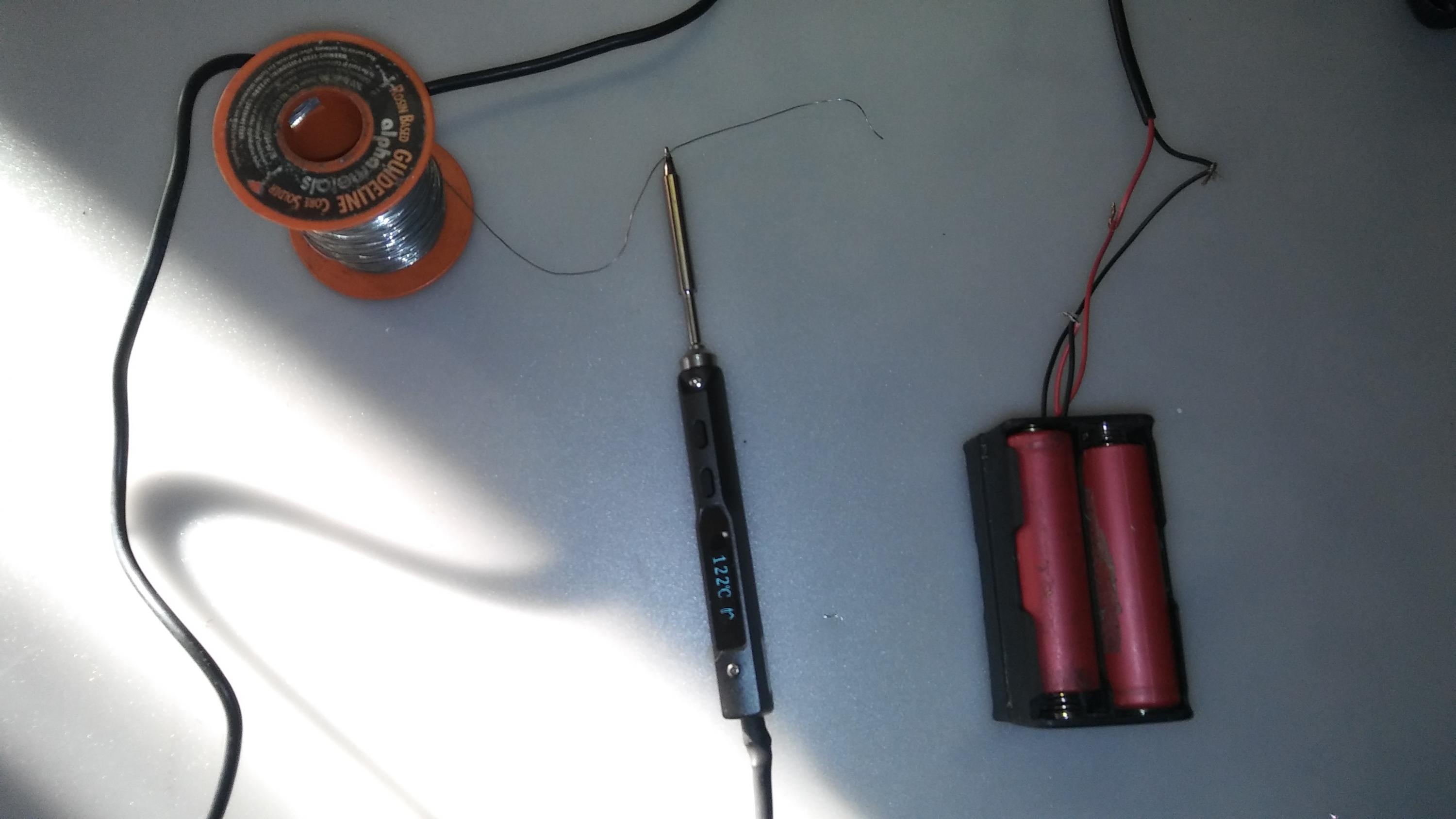

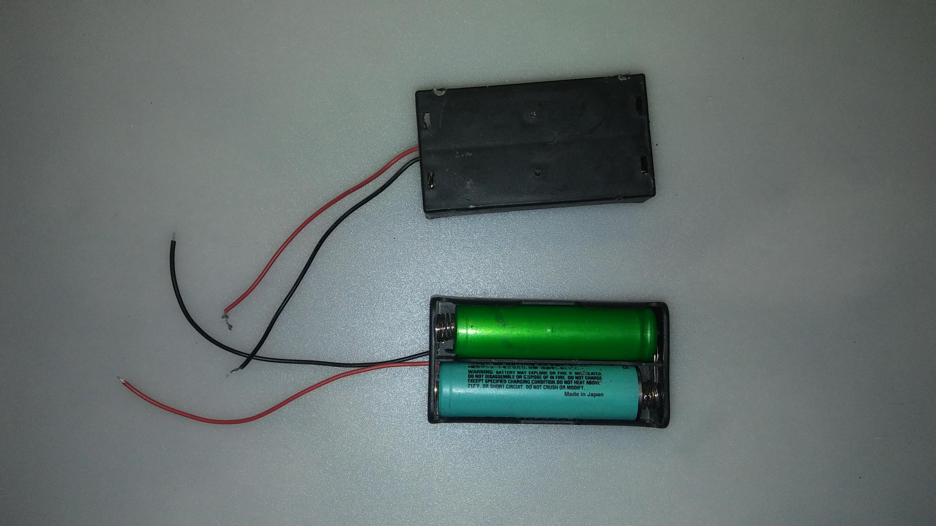

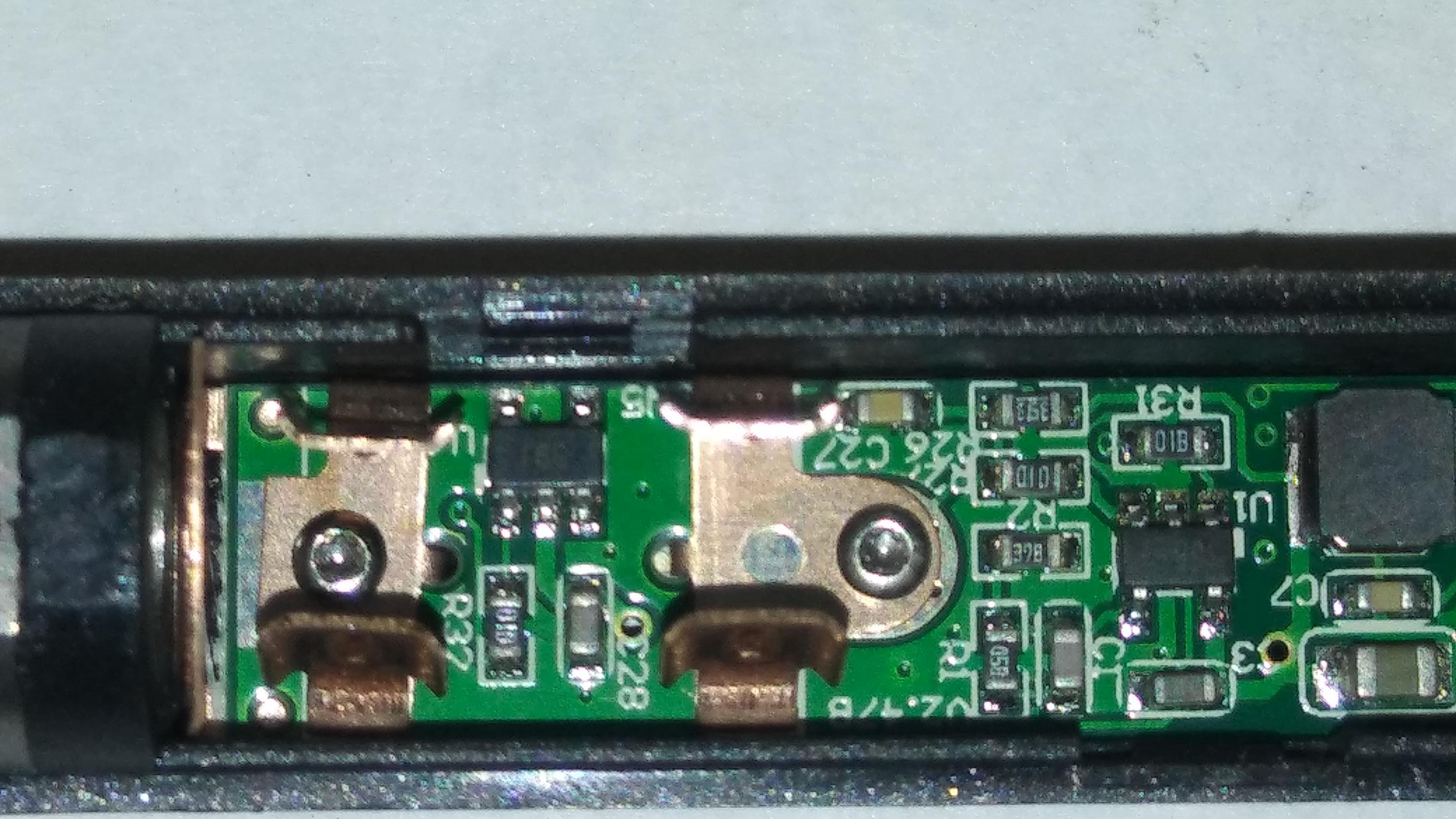

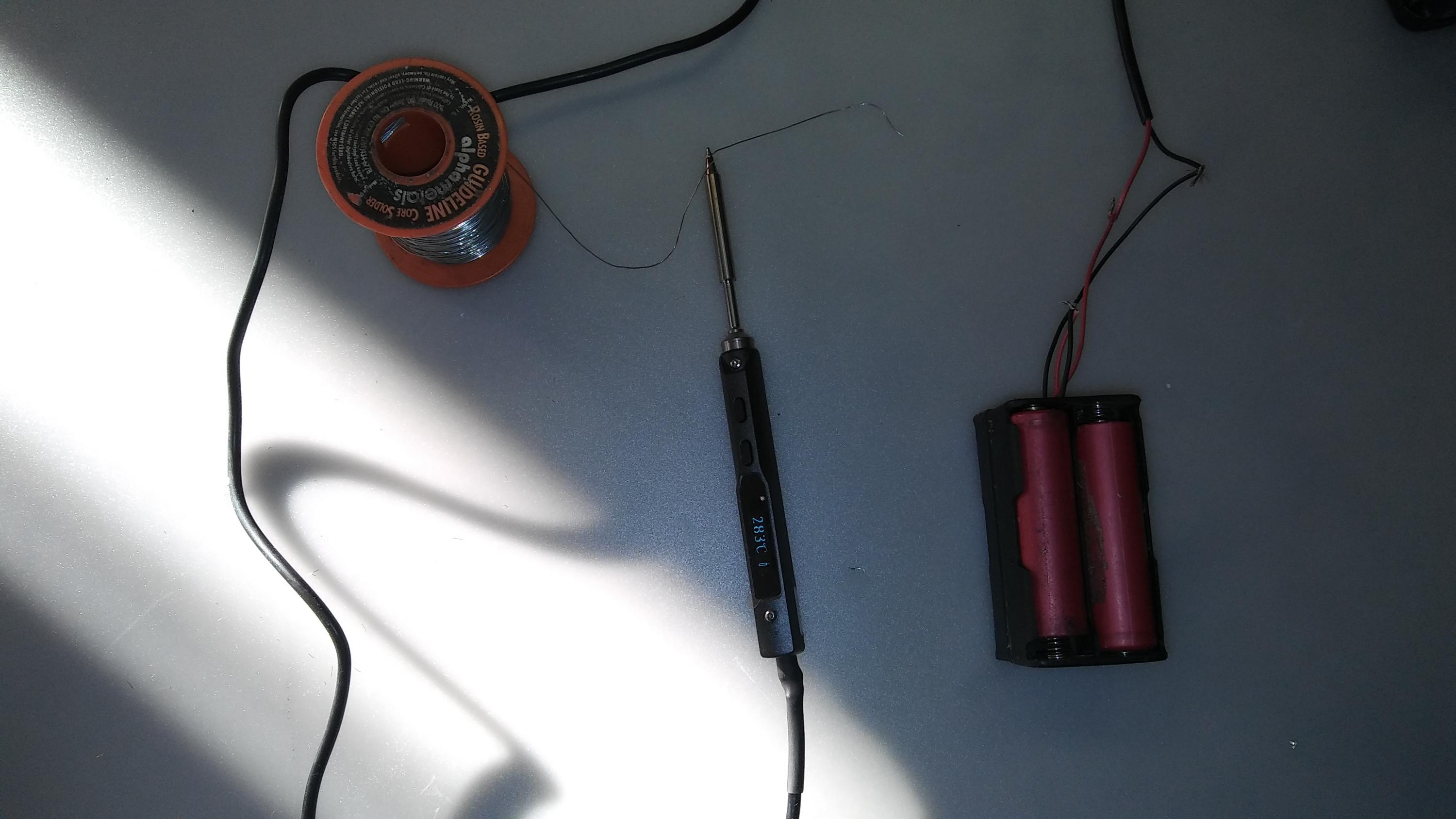

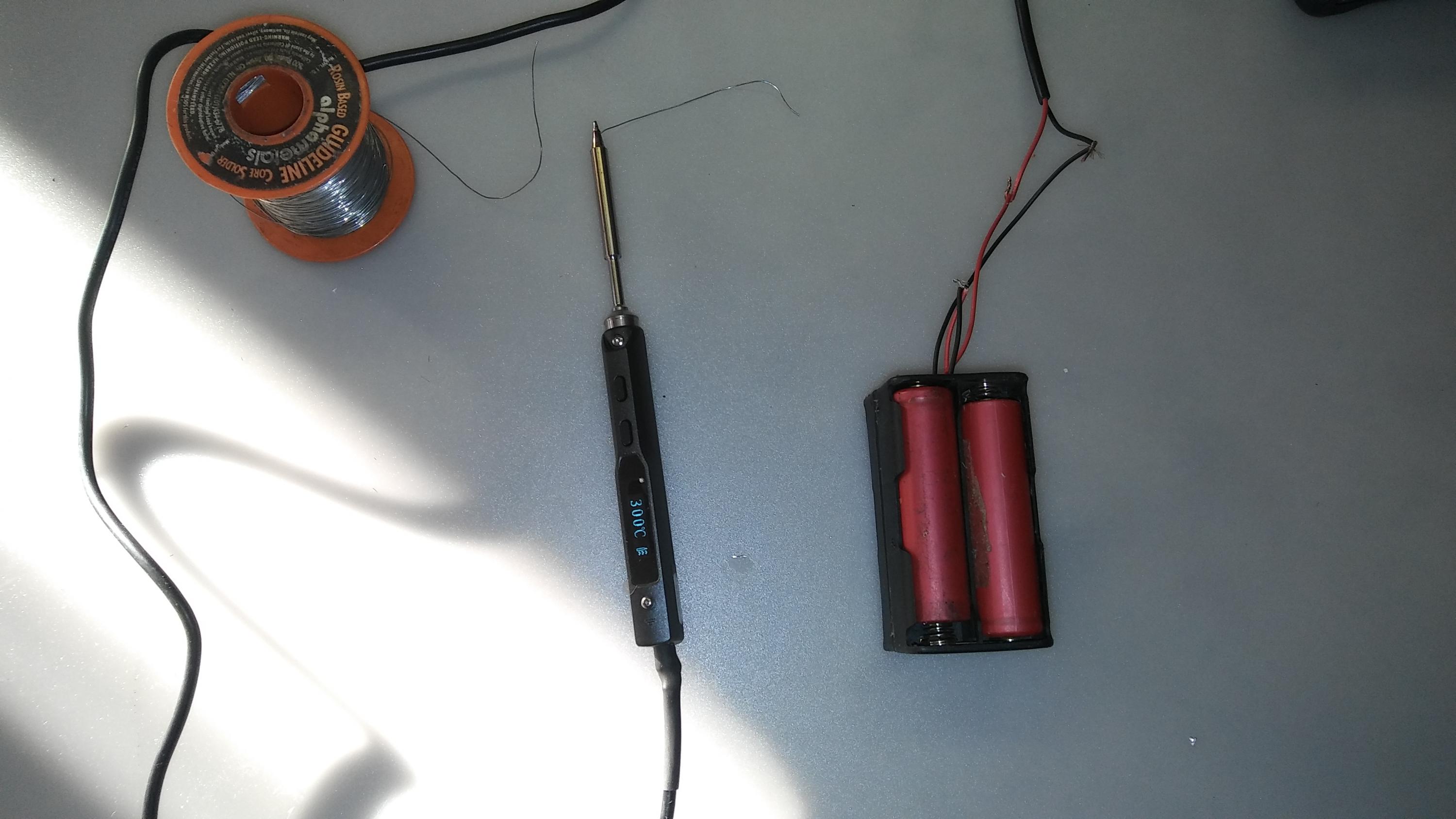

          Another adult toy, after you put a battery pack.( portable microcontroller battery powered iron)
          Use 4 x 18650 = 16.4v, work really good with TS100.
          Better 18650 Battery Holders
          https://www.youtube.com/watch?v=euNRqVOH580
          DIY Storage Box Battery Case Holder for 2 X 18650 Batteries 3.7V Rechargeable Battery 4 Pin Black.(reference only, always shop around.)
          https://www.aliexpress.com/item/DIY-...608.0.0.NEDFQQ

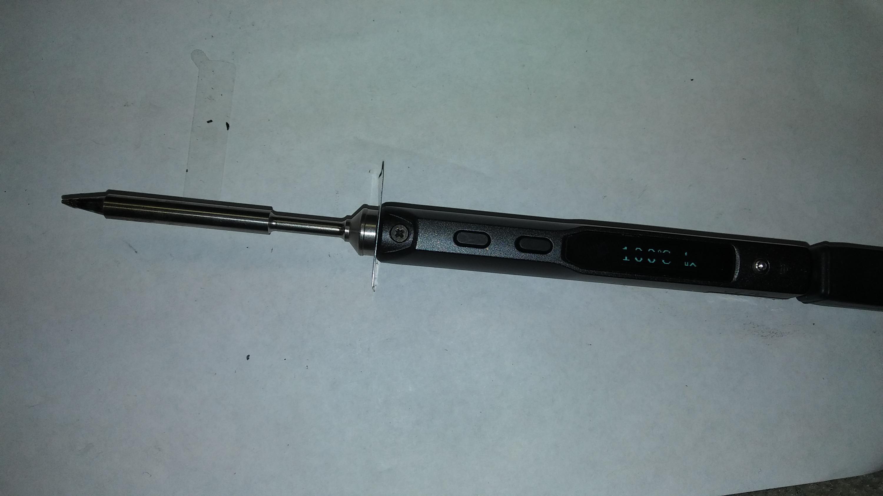

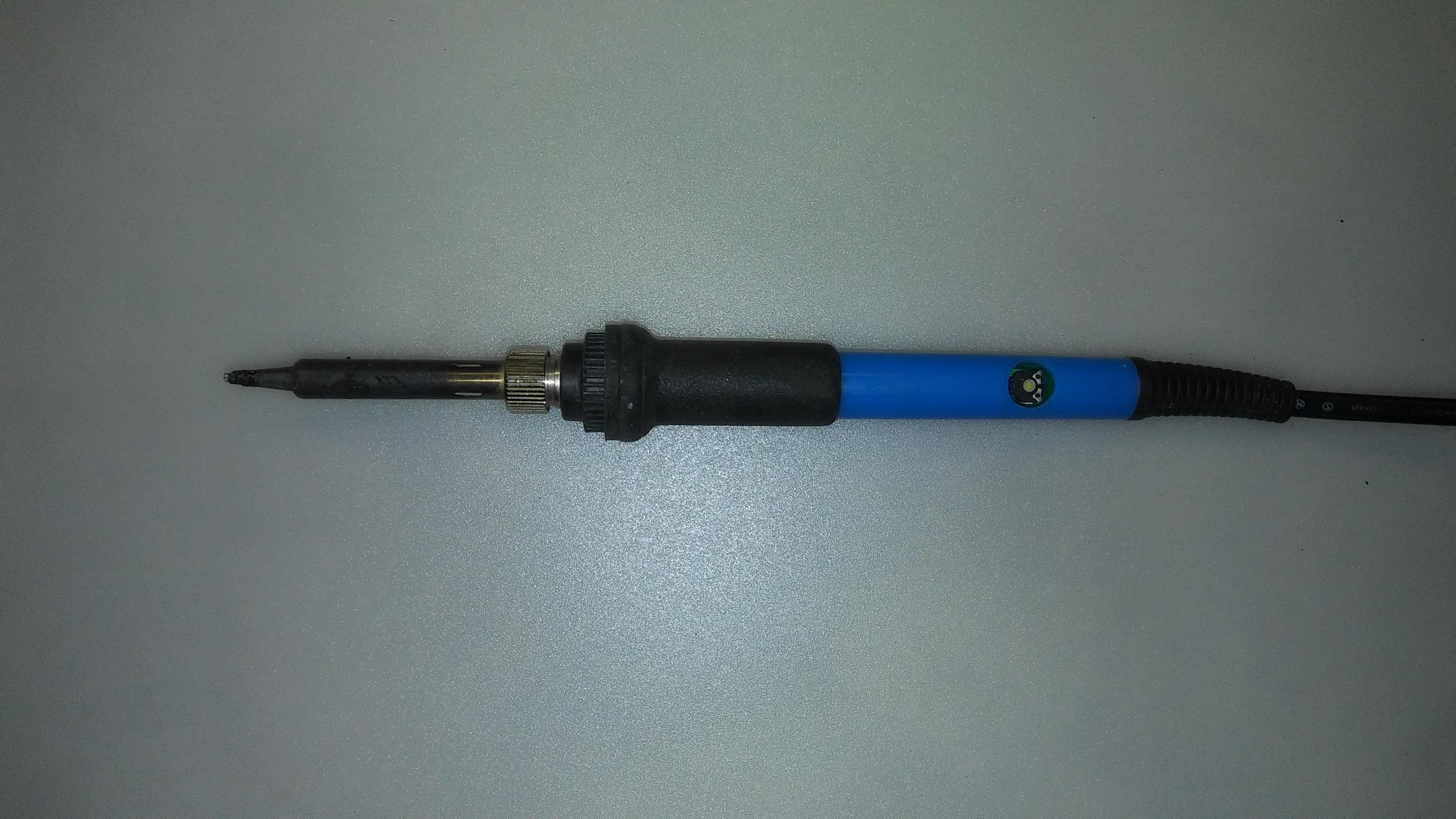

            All I try to doo the experiment is will cheap T12 tips can put inside TS100 for daily abuse use and save $.
            PS: I ordered T12 tips is on the way, will update.
              • 31196
              Re: A deep-dive on TS100.
              i was wondering about that.
              wattage shouldnt be an issue - fets can be upgraded,
              but i wonder if the sensing will be too far out.

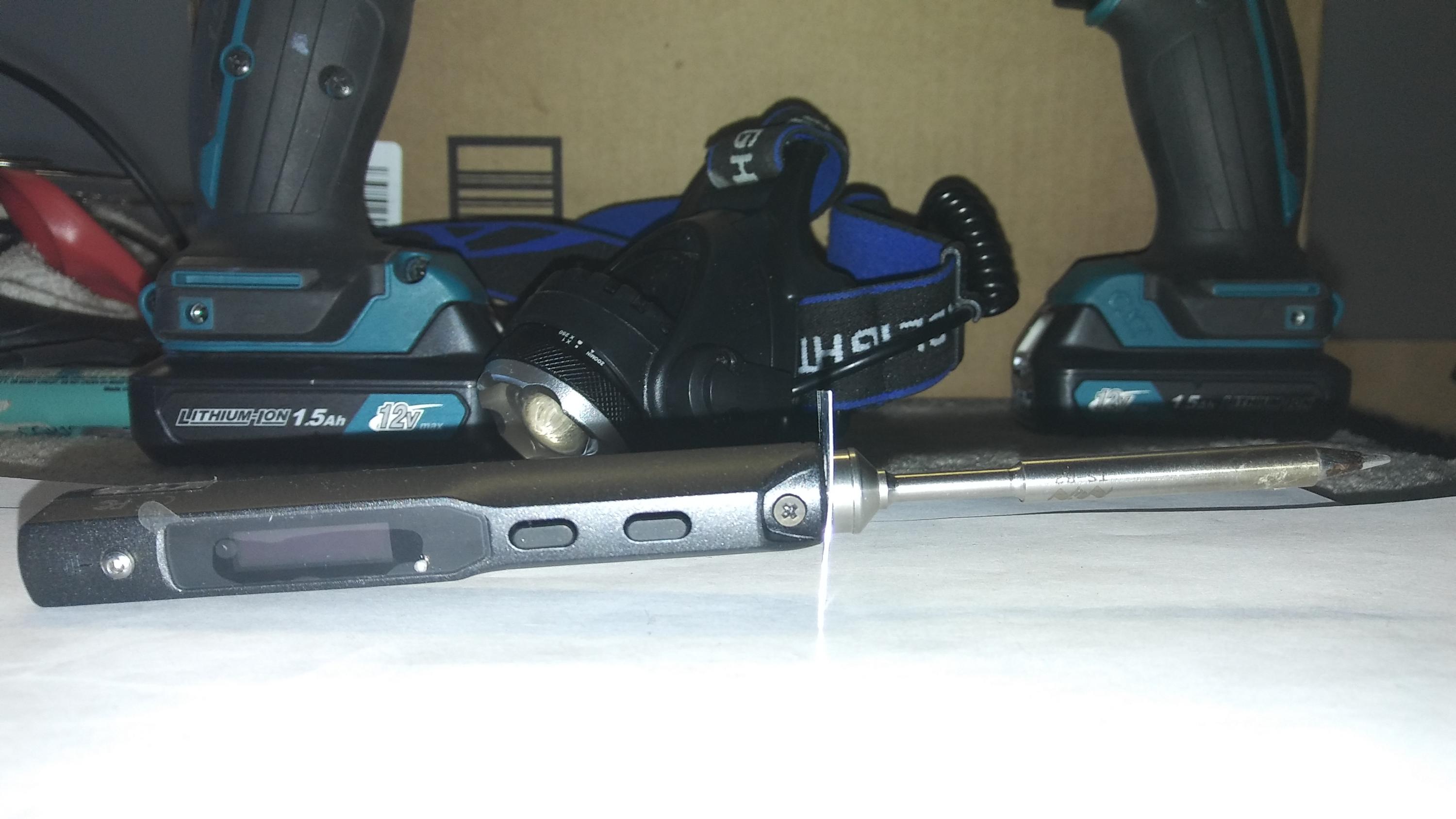

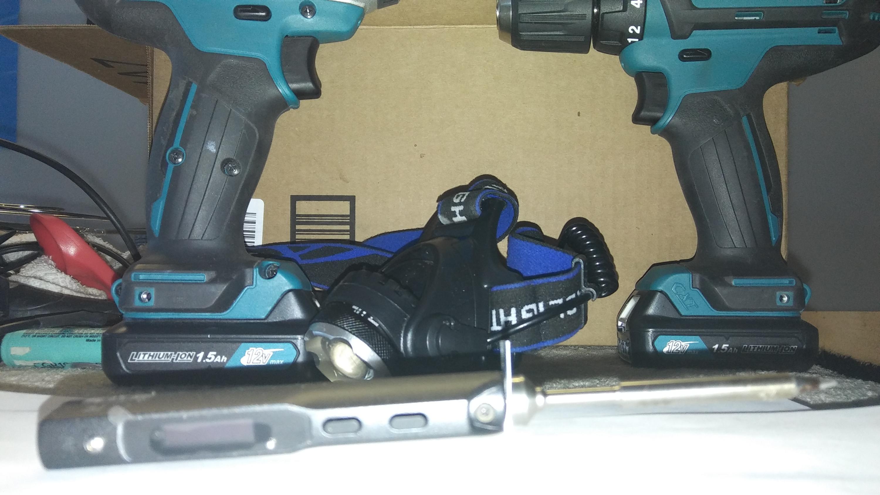

                It looks like great tech but kinda fail on ergonomics - nothing to stop your fingers from sliding onto the heating element! Unlike every other soldering iron ever made. Sigh
                • capwizard
                  • Jun 2016
                  • 1991

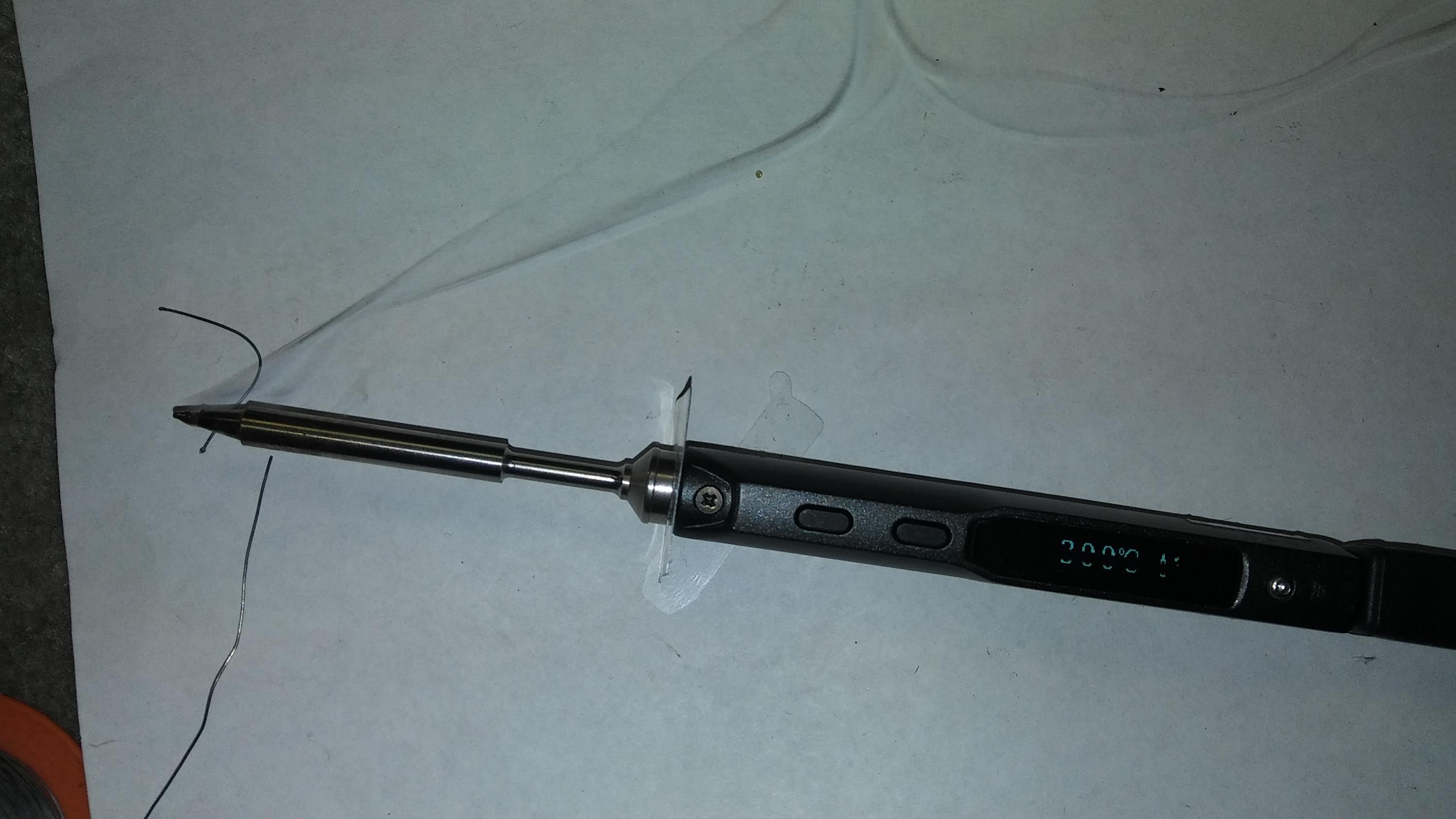

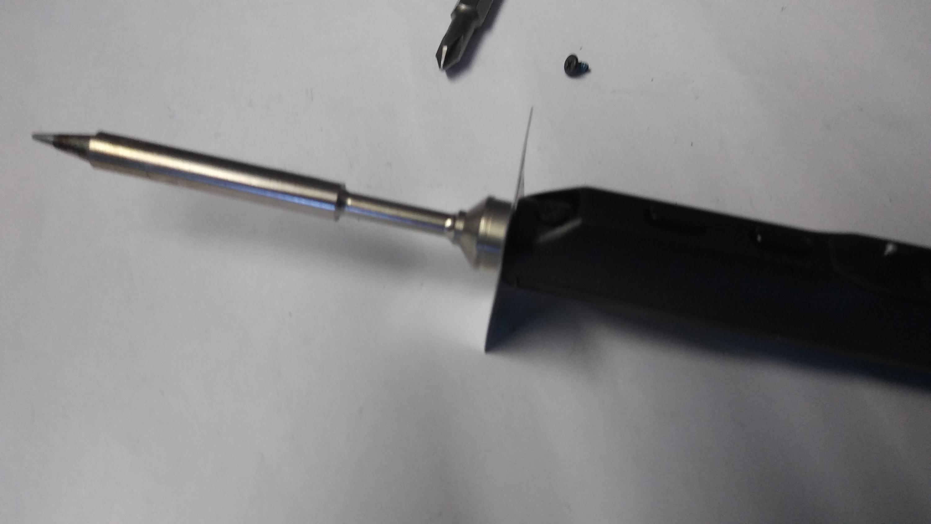

                  I thought about that I try to put black silicone or high temperature red silicone over there of which for handle comfortable touch and stop sliding onto the heating element at same time.

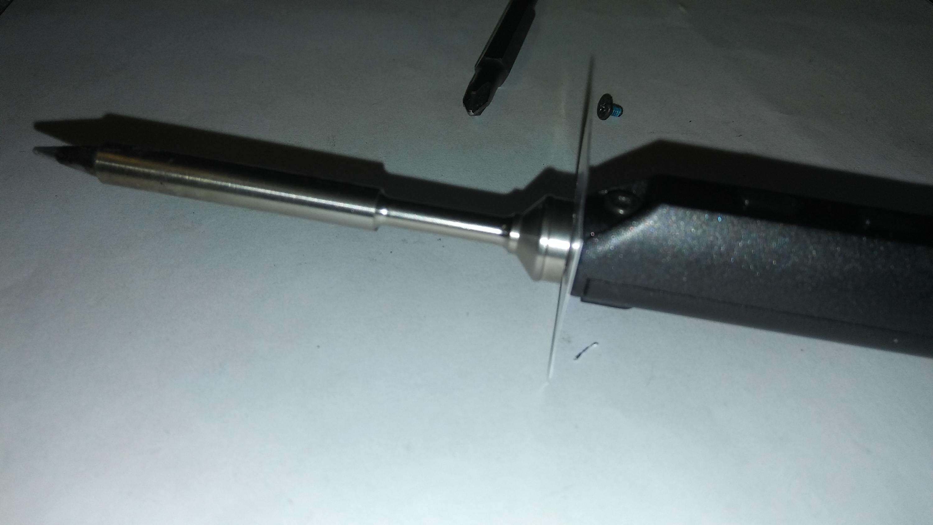

                    • 31196
                    just put a thin washer between the tip & handle.
                    1mm difference shouldnt stop it connecting internally.

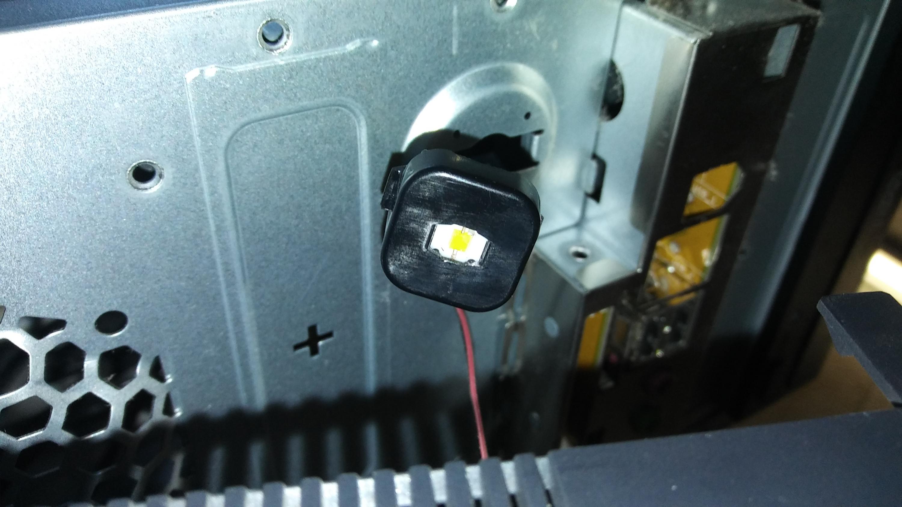

                      PS: I try to add a LED which can light up the tip.

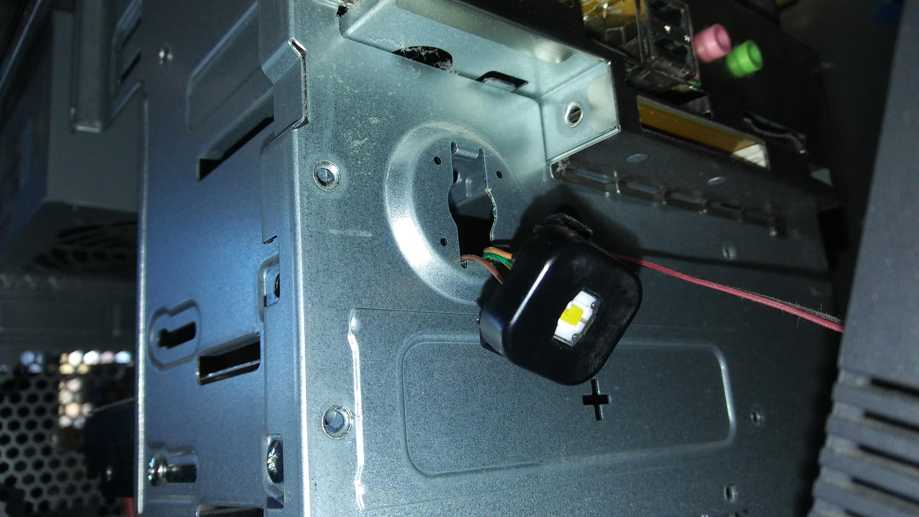

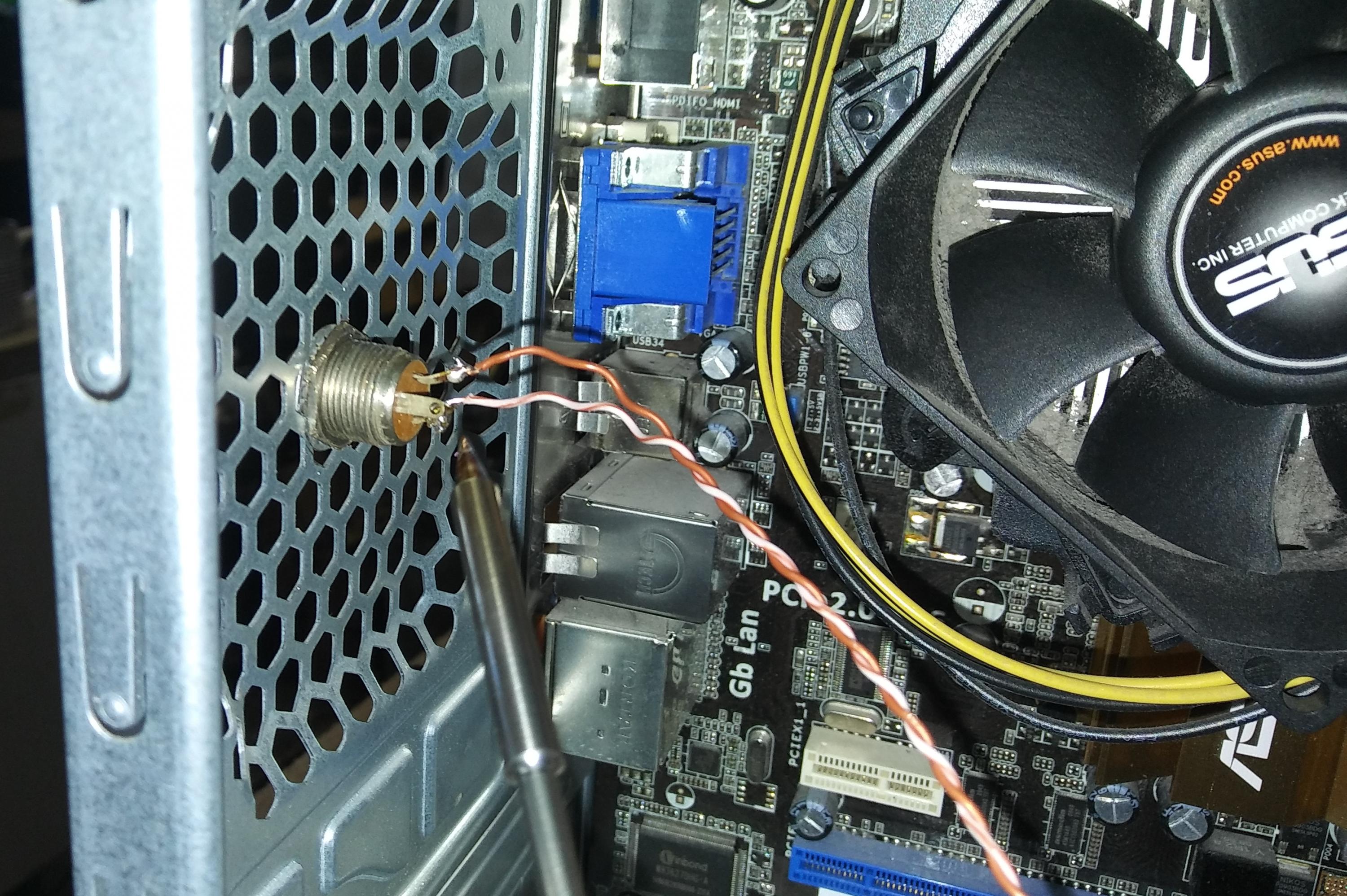

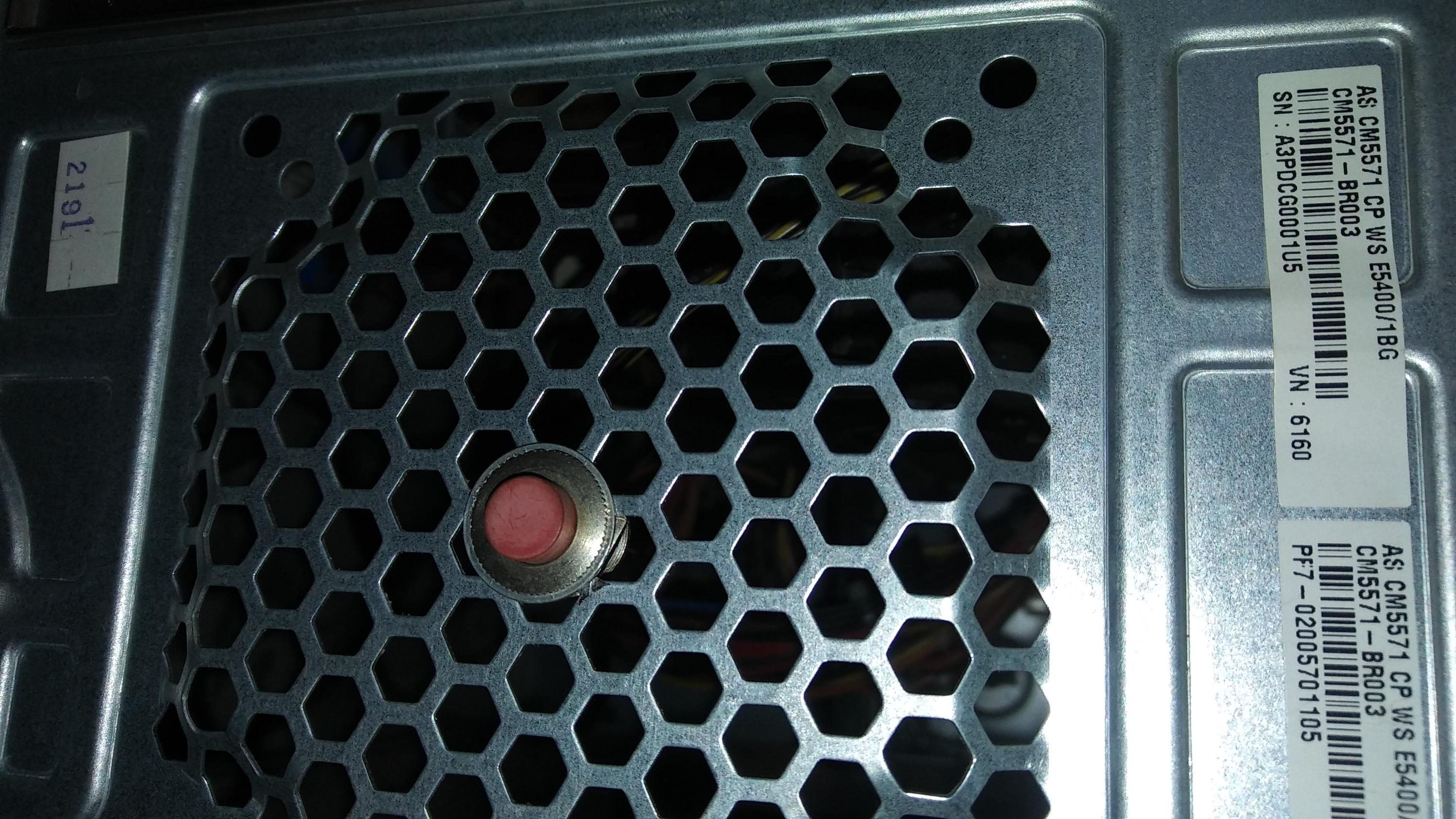

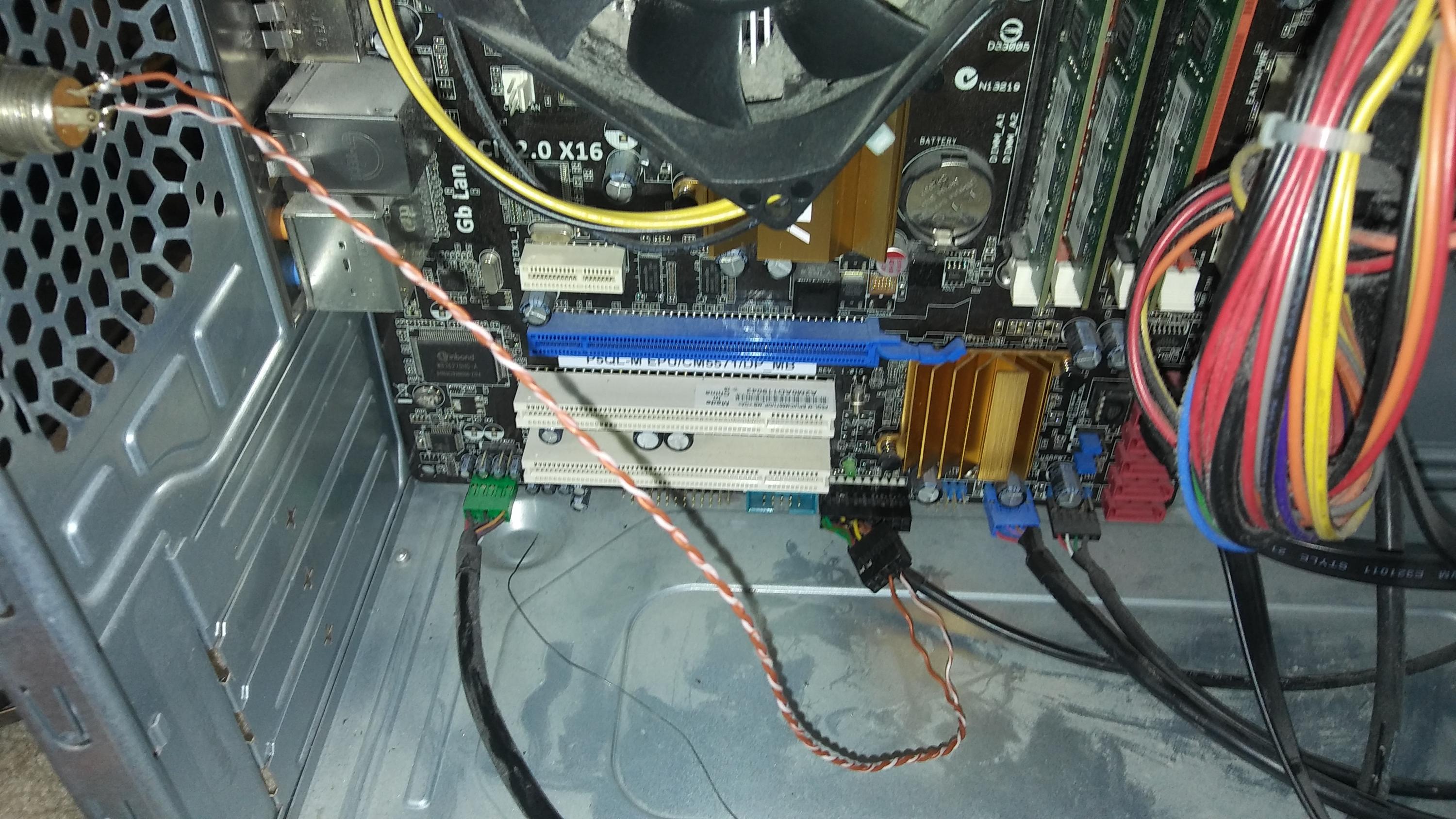

                          One repair job paid for (TS100) itself. Customer is a DJ, needs his PC, the power switch broken, 2TB music inside, needs today. I said no time for parts order, if you don't mind, I will put a switch for you. The solder job is smoothly finished.

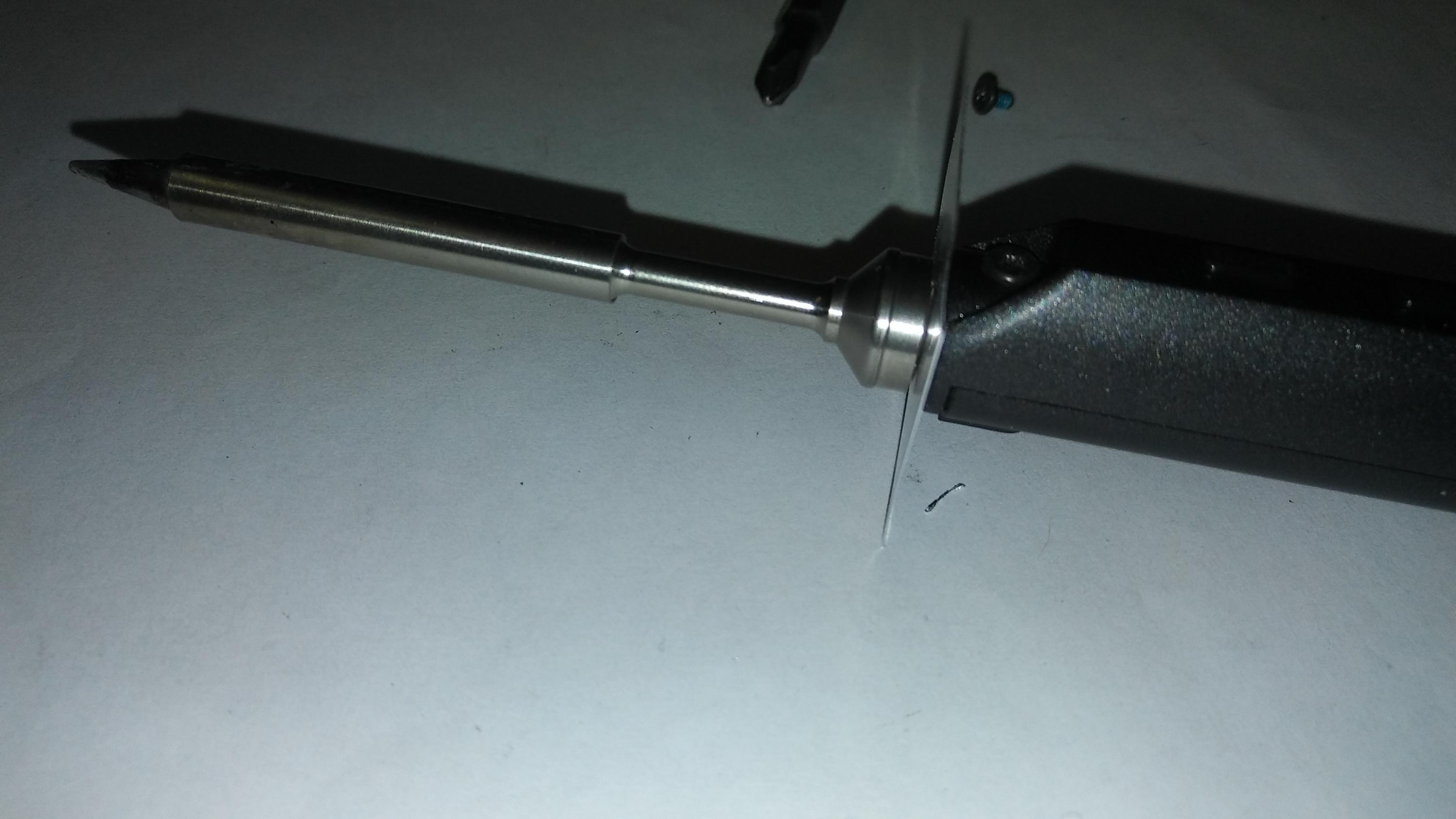

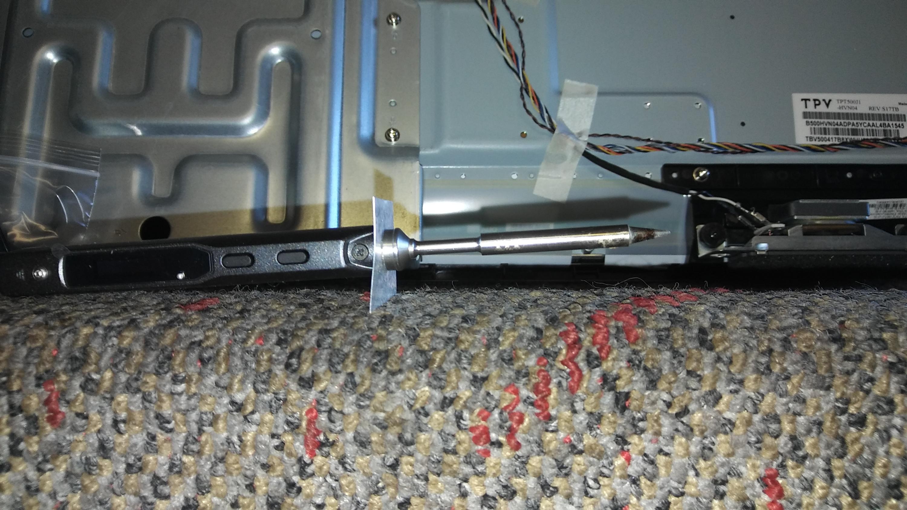

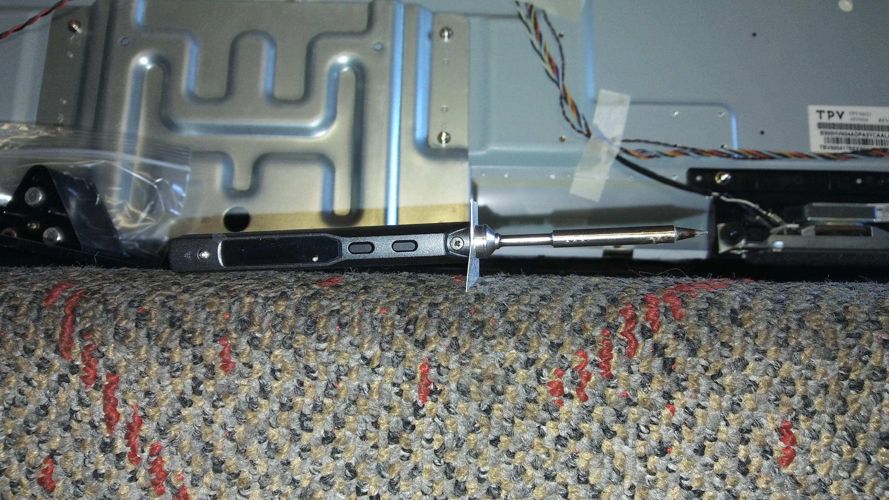

                            Best tips I ever got, is From Mr.Sti, just put a thin washer between the tip & handle. 1mm difference shouldnt stop it connecting internally.
                            Solve the solder tip to close to table problem, at meantime change HEX to Phillips screw .

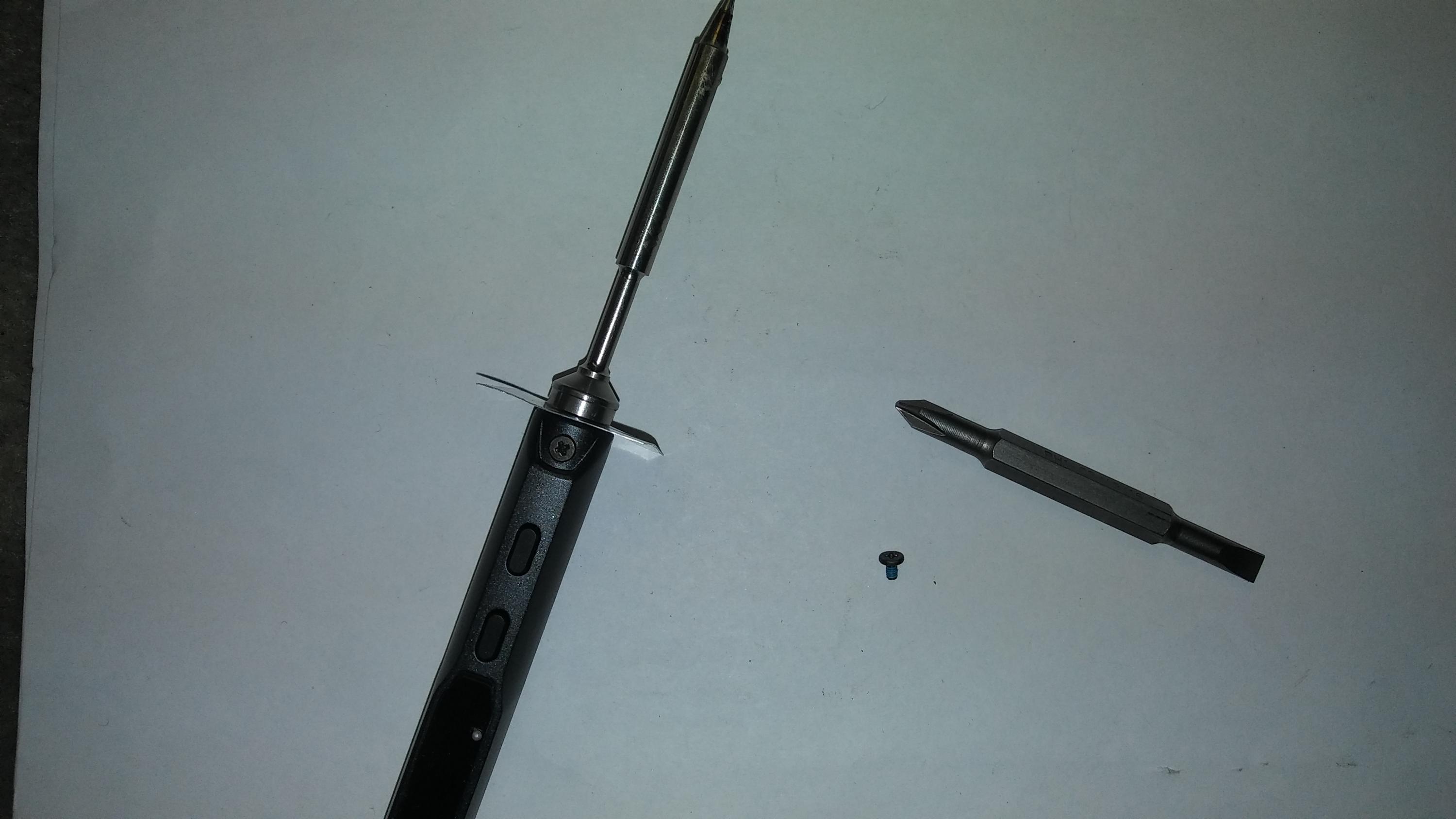

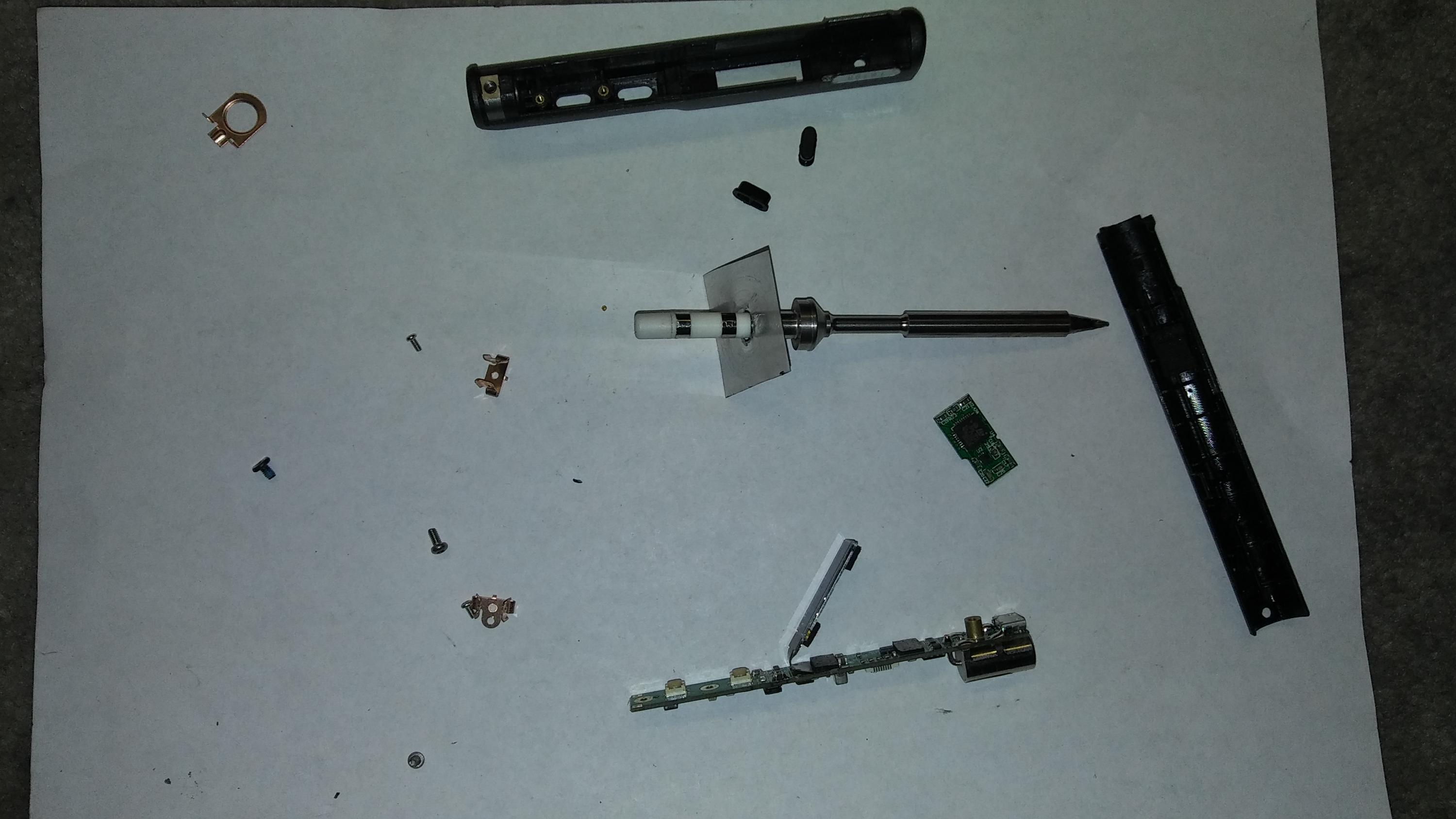

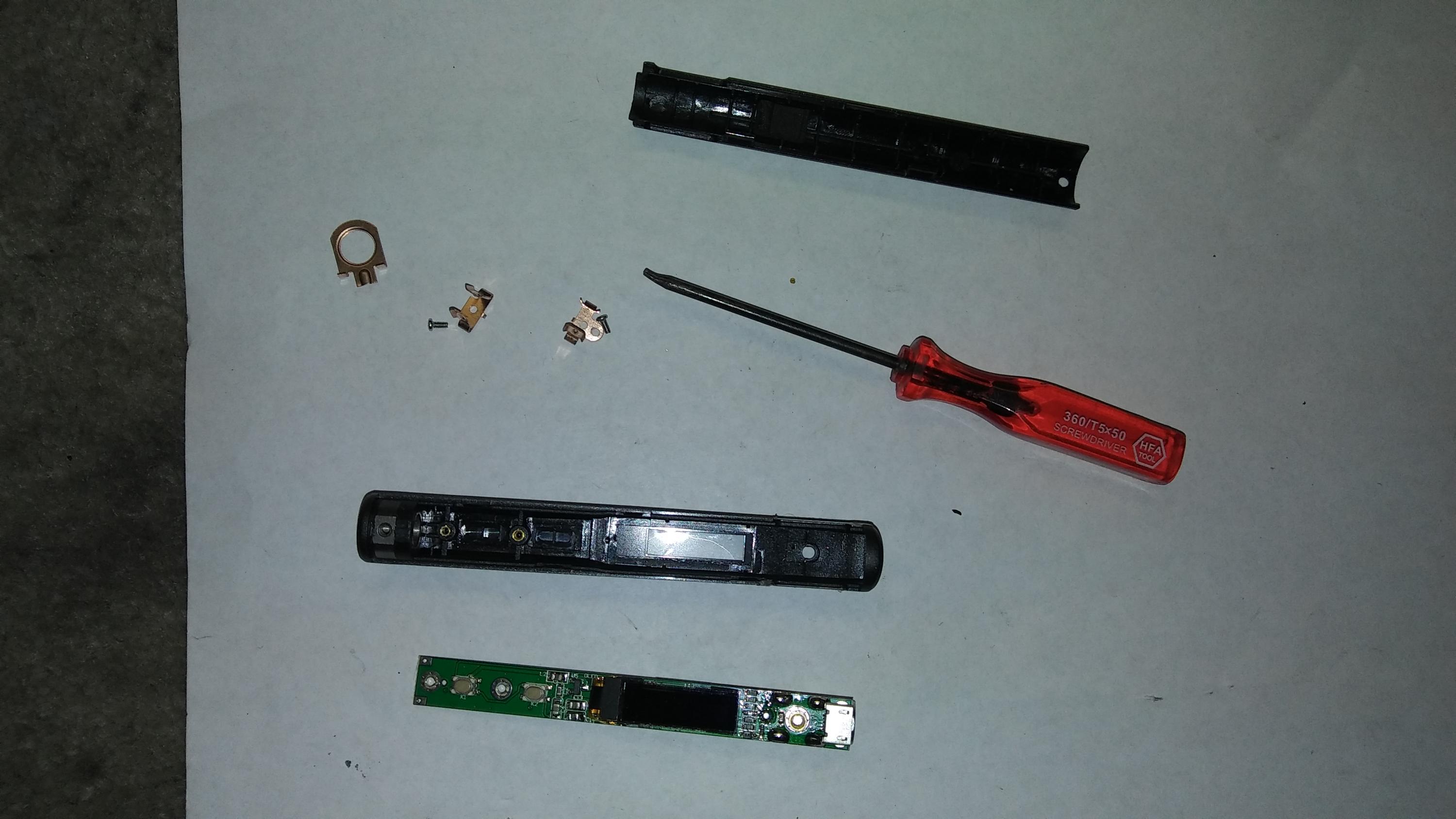

                            • capwizard
                              • Jun 2016
                              • 1991

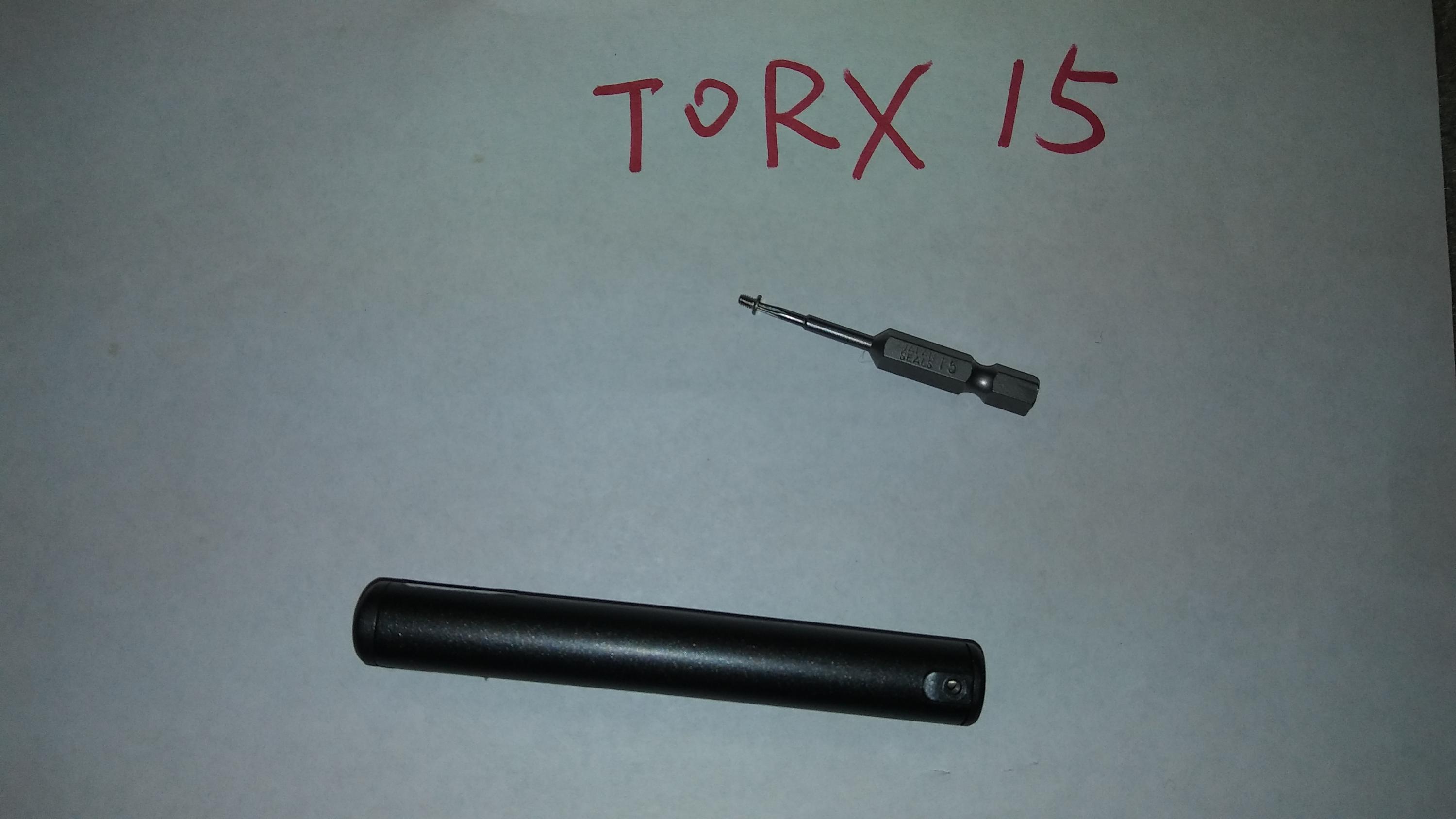

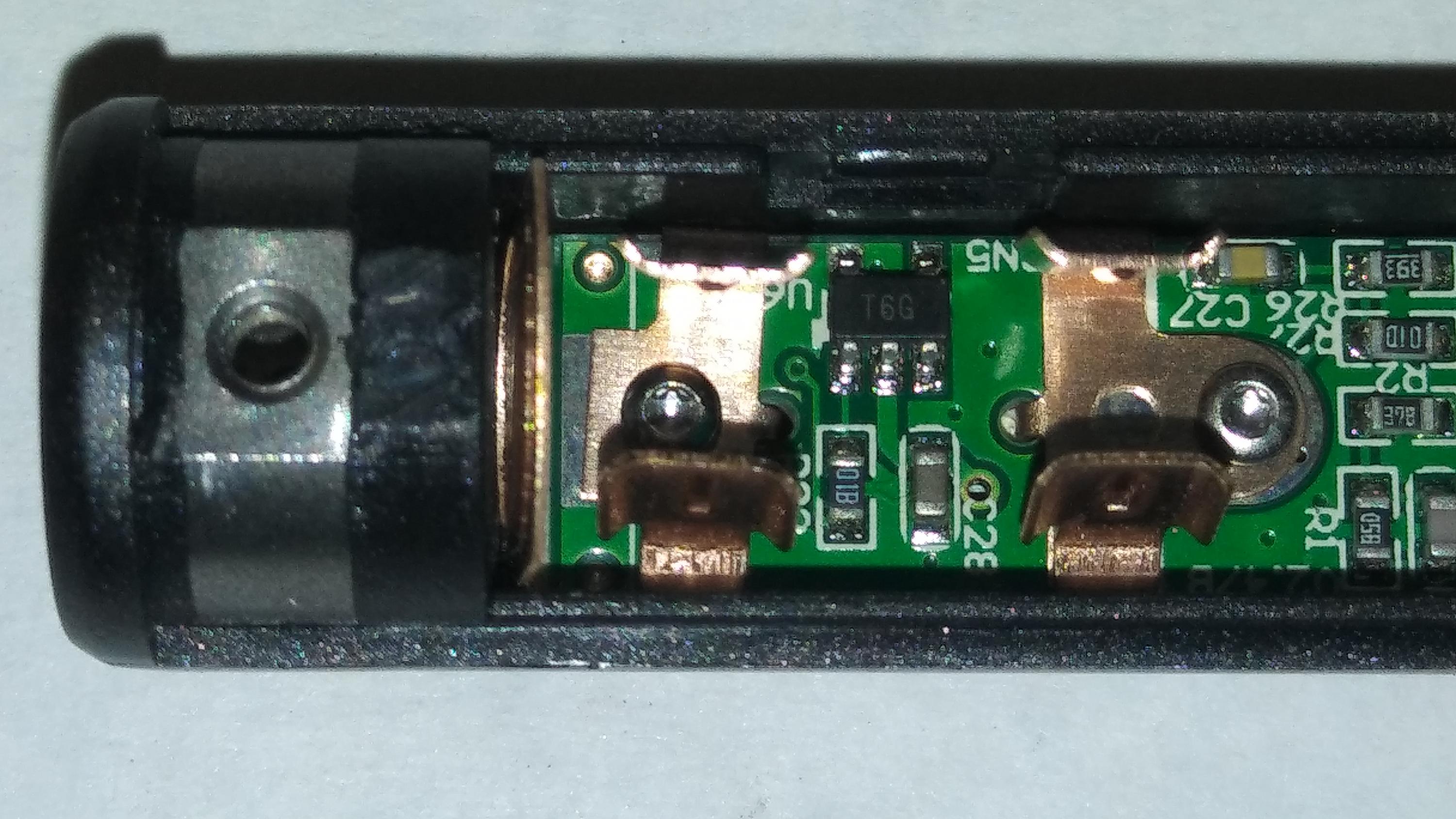

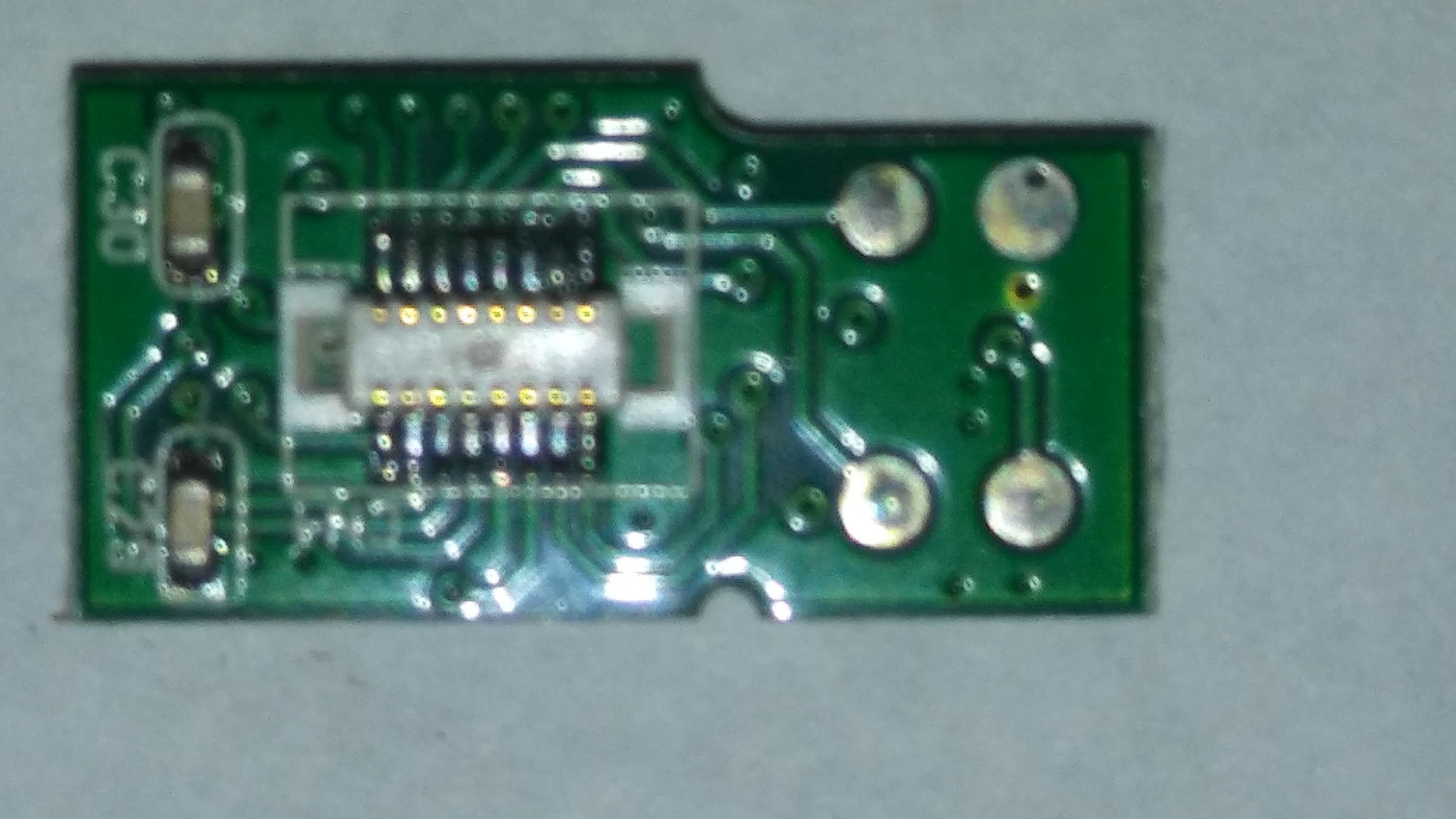

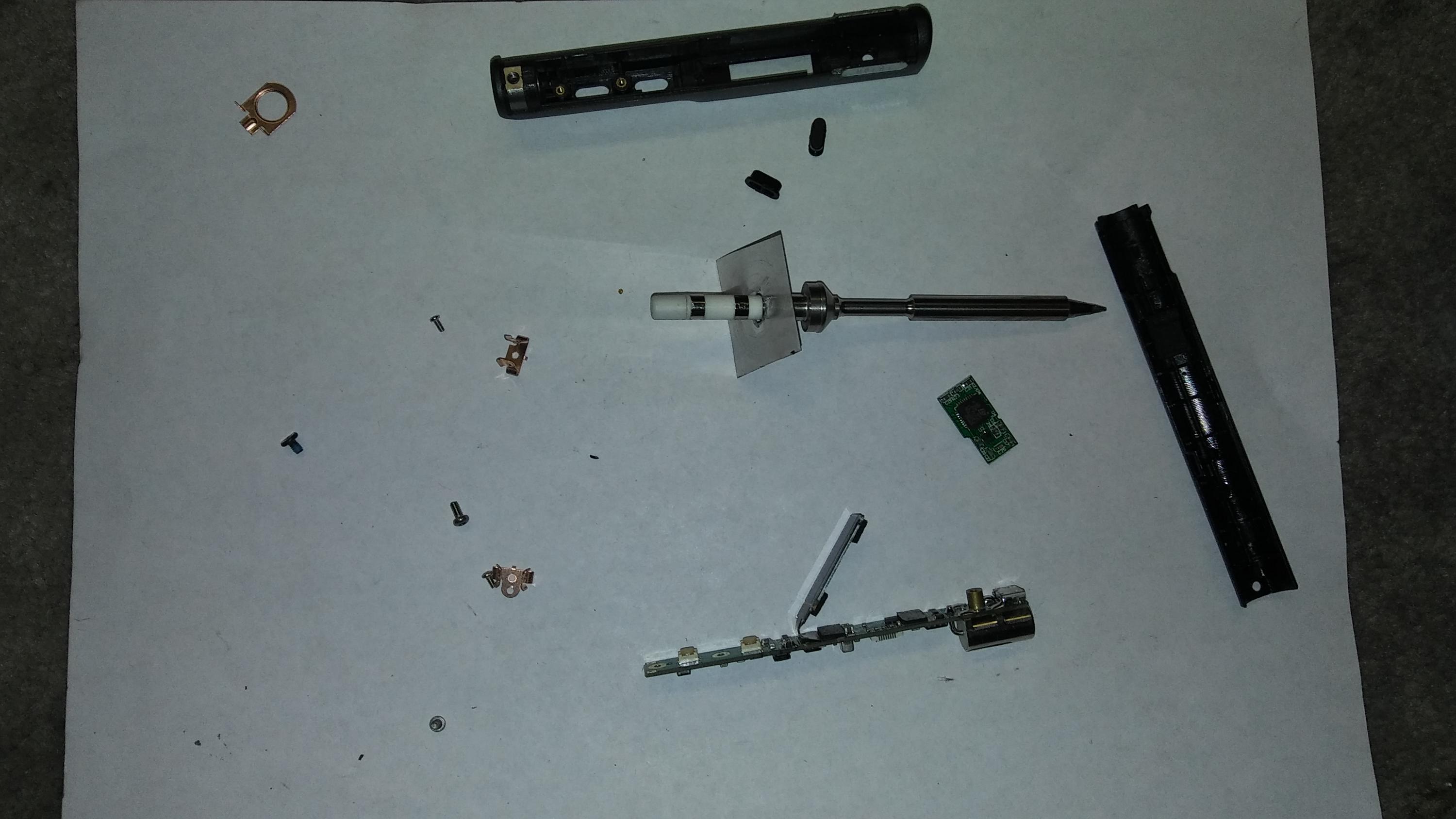

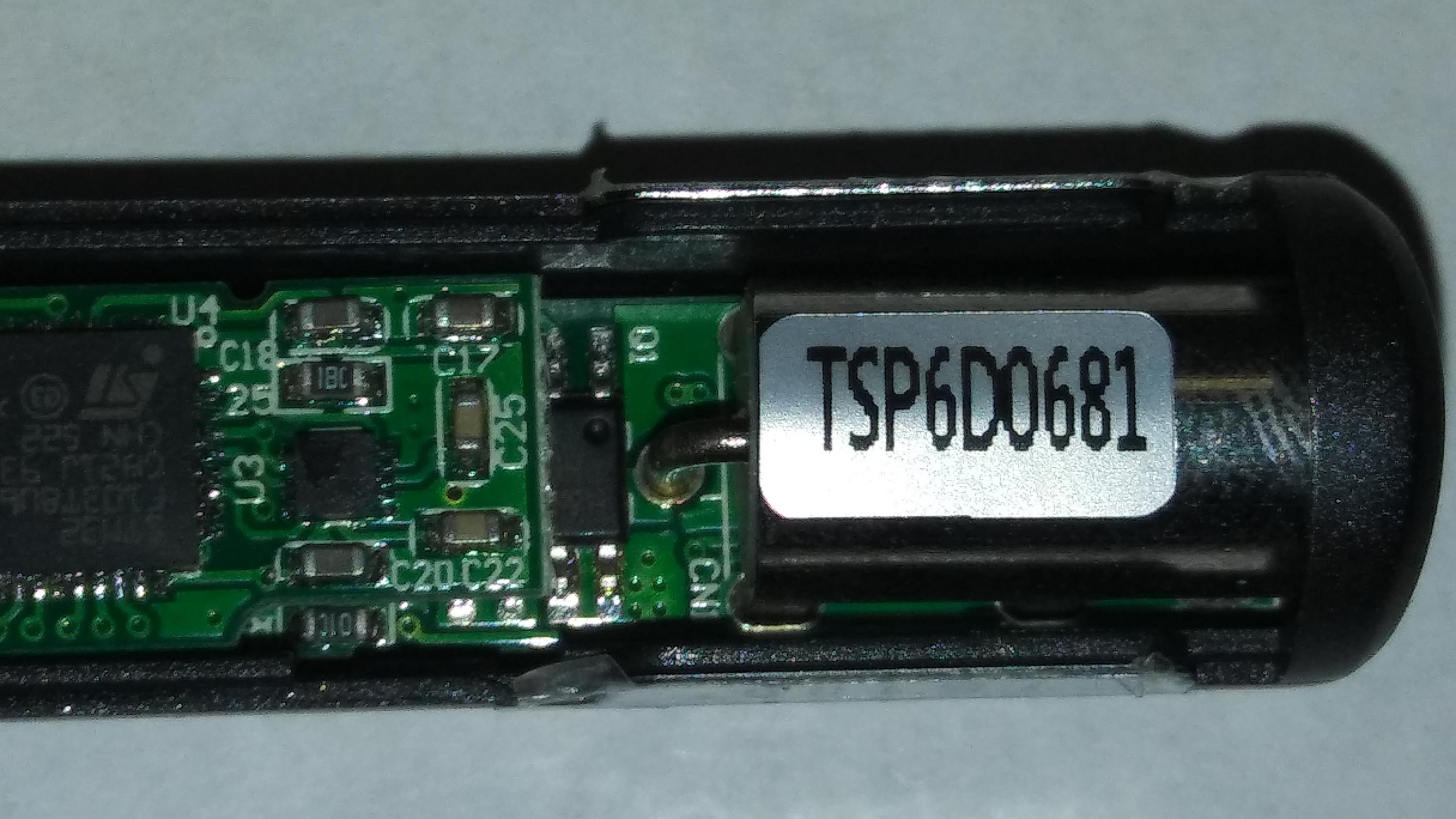

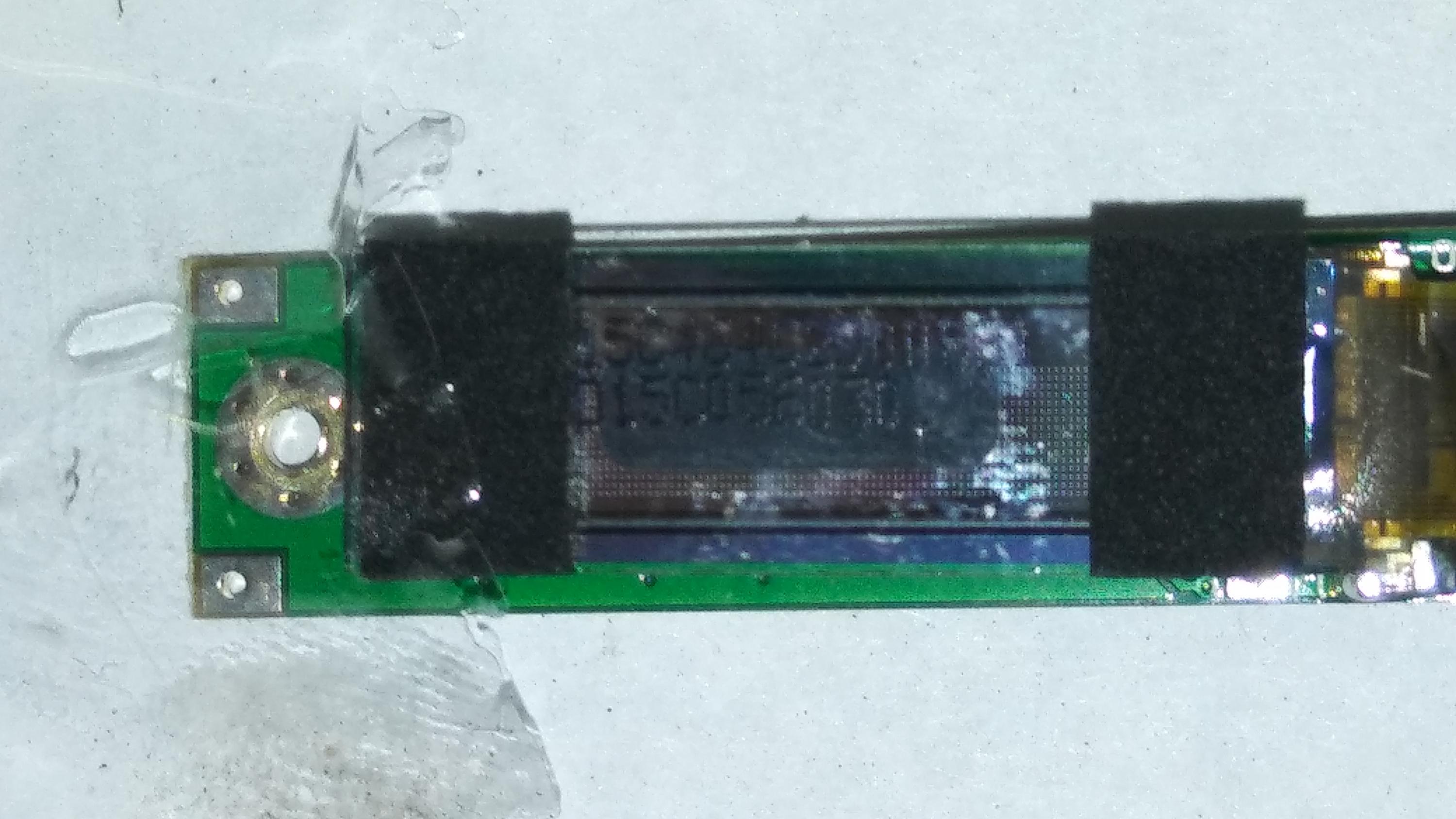

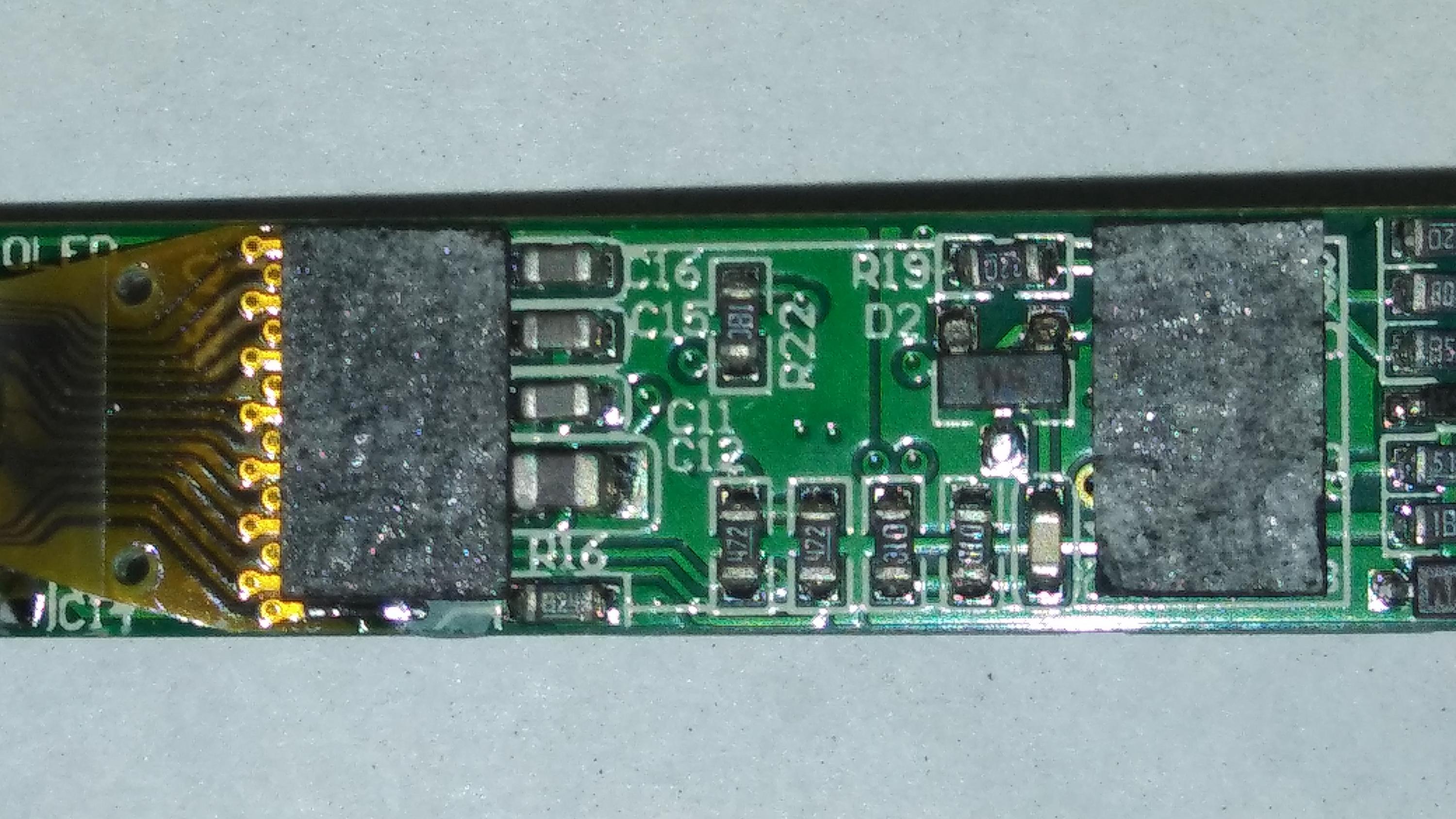

                              Prepare to return if.....
                                • 31196
                                so why is it stripped??
                                • capwizard
                                  • Jun 2016
                                  • 1991
                                  I didn't cut it open.................

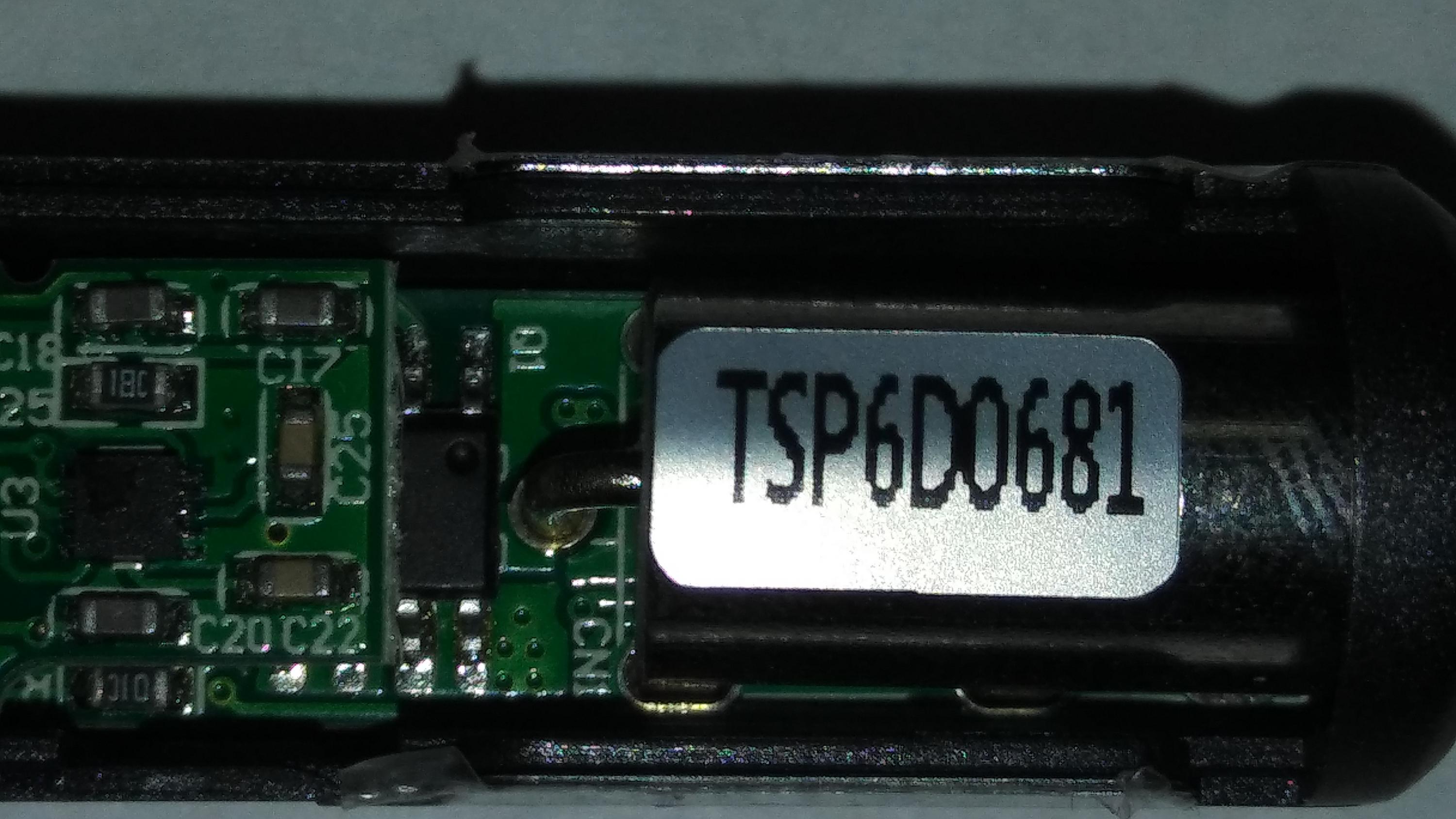

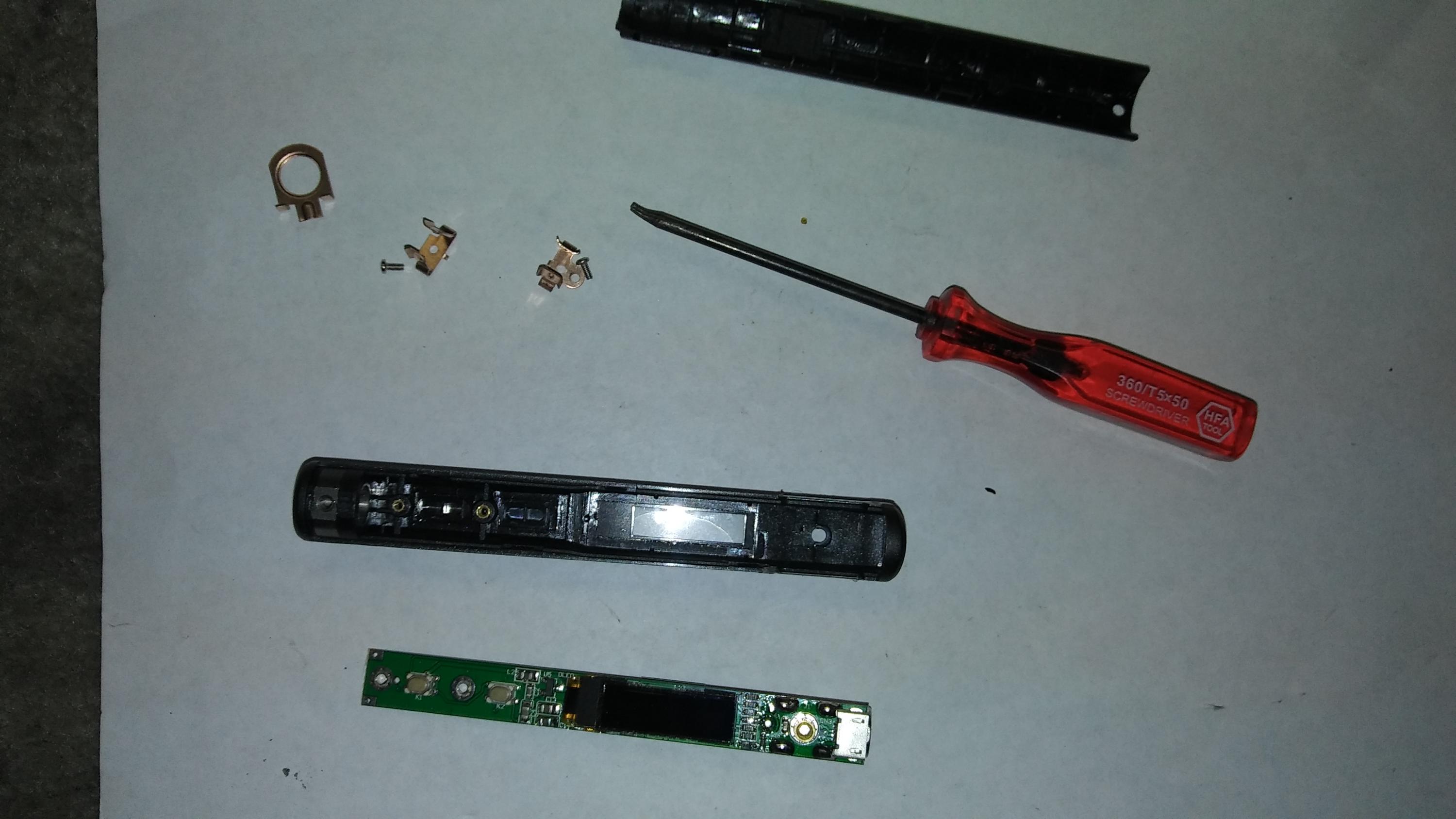

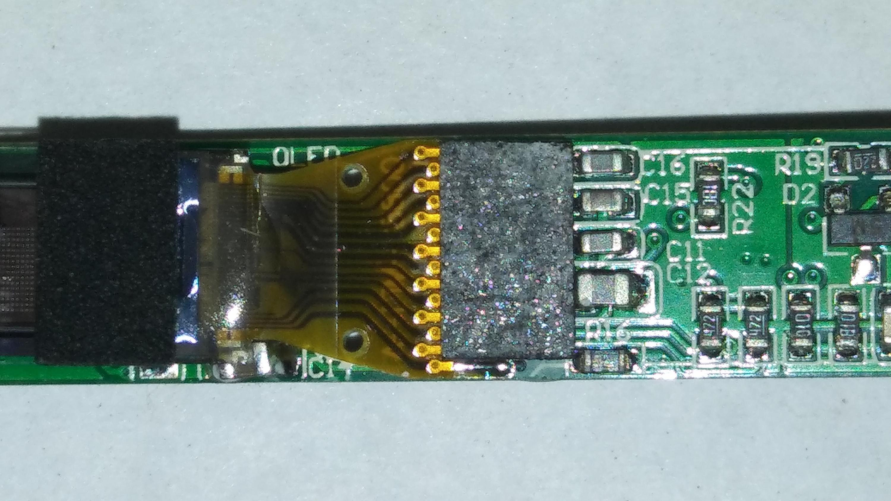

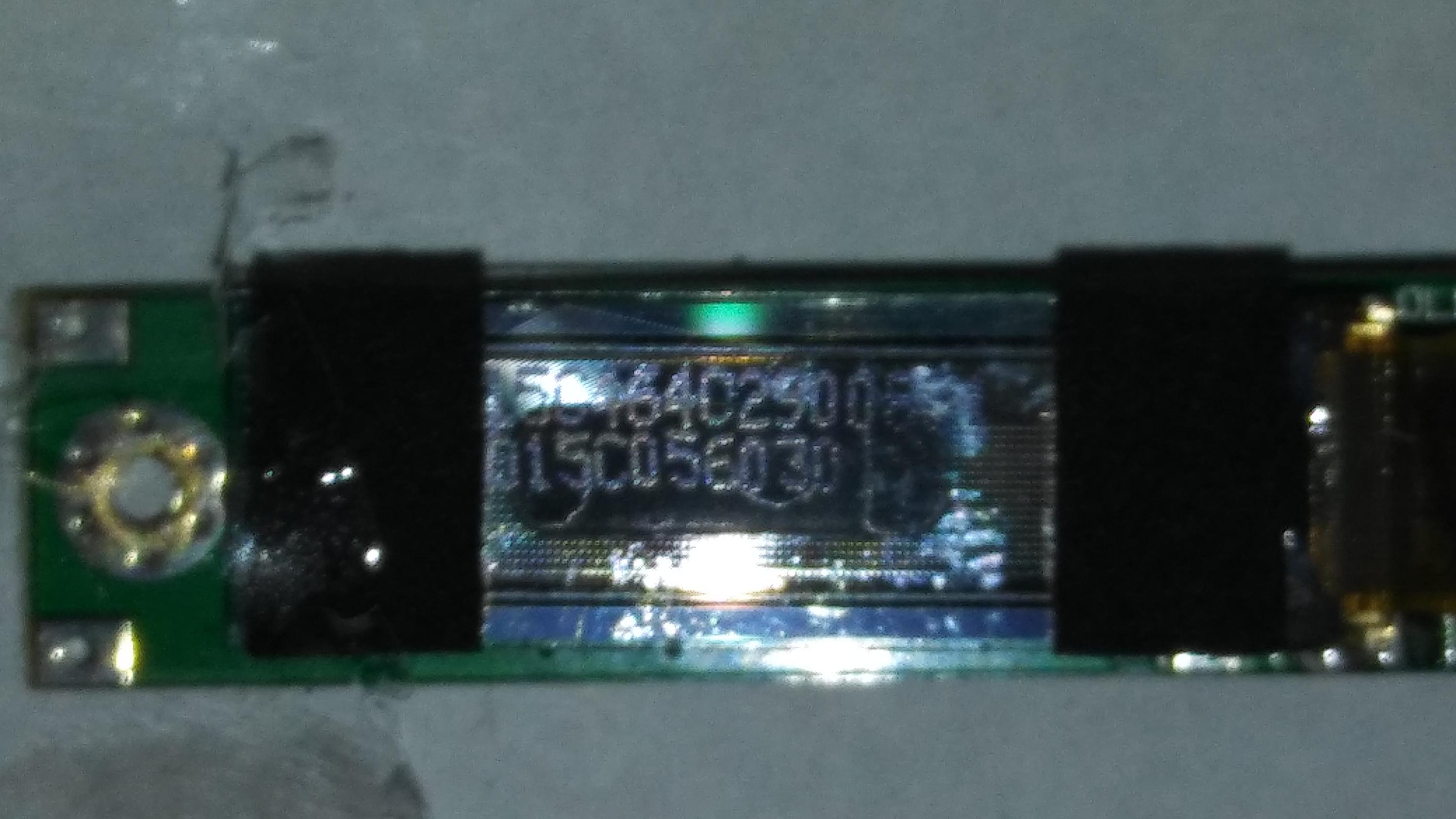

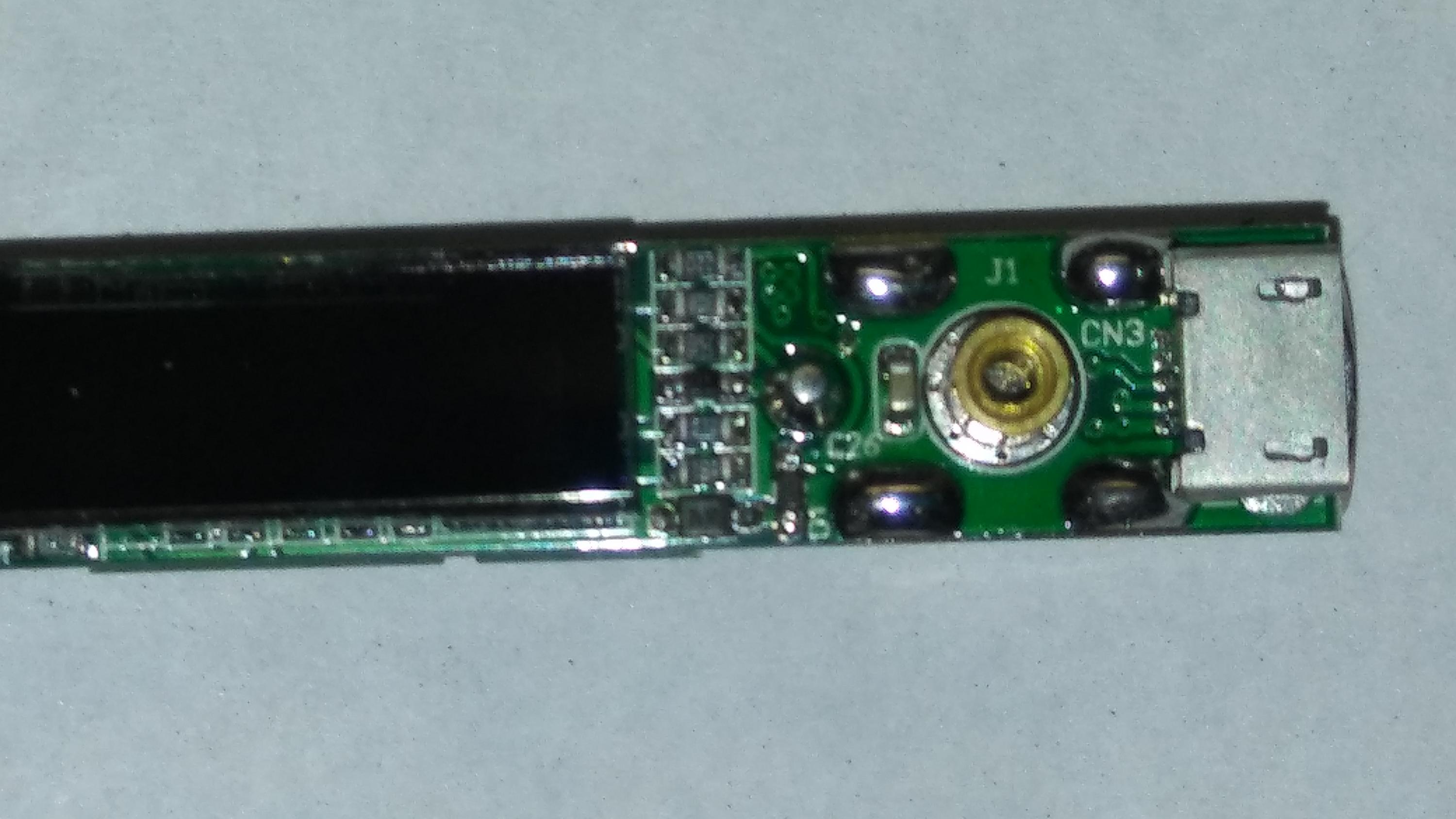

                                  • capwizard
                                    • Jun 2016
                                    • 1991

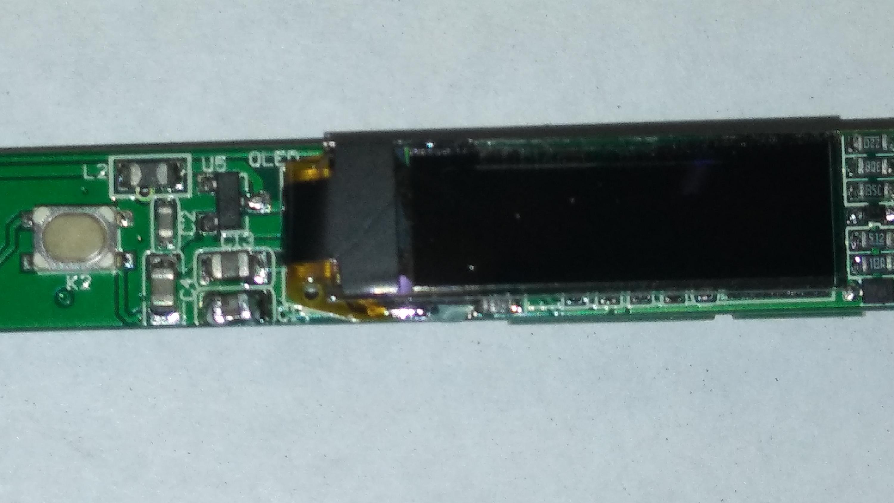

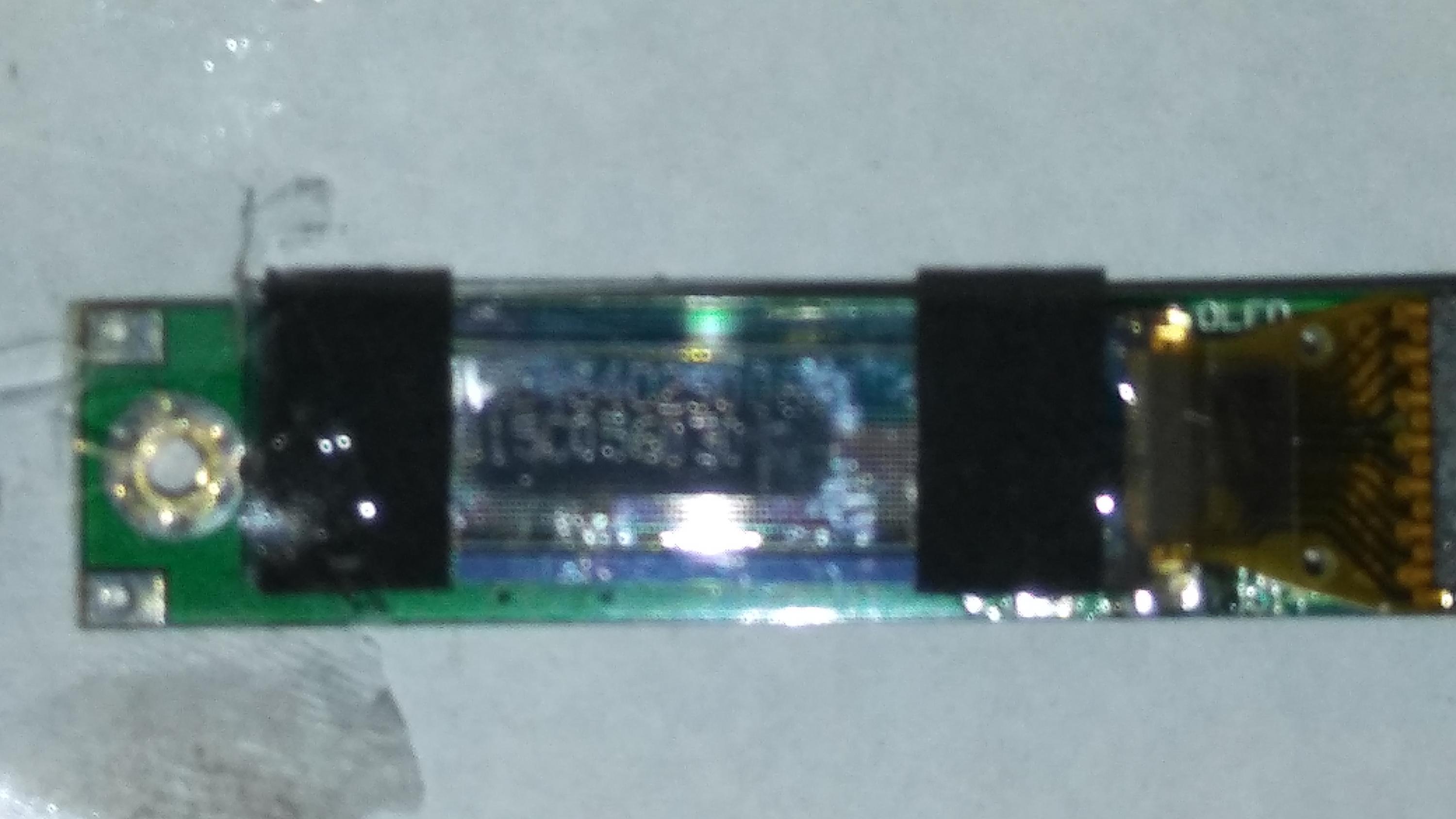

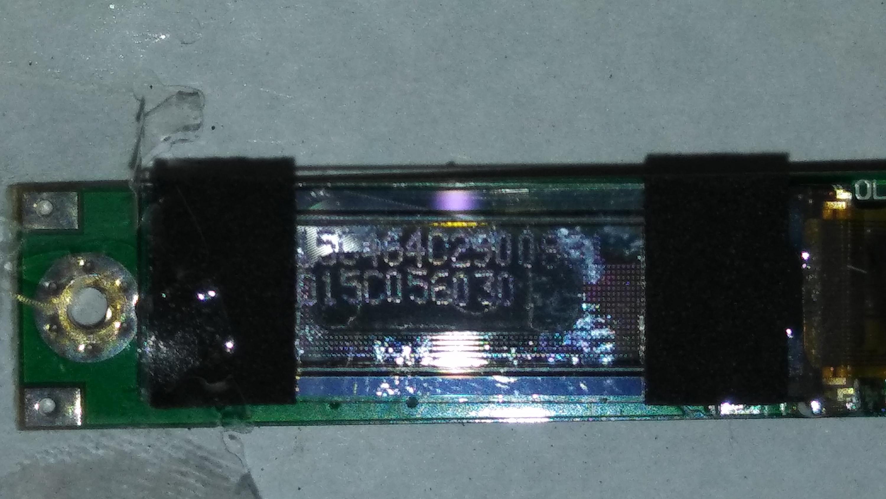

                                    last picture show lines is the camera problem, LG Stylo 2 PLUS 1080p camera used,
                                    NO!! is the OLED I did not put in right position, and Polarizing filter film show the lines, but my eyes show was A good display. i FOUND the technology of how LCDs work on polarized light. I mean OLED=LCD same display technology.
                                    Thats OK I will correct this problem next time.

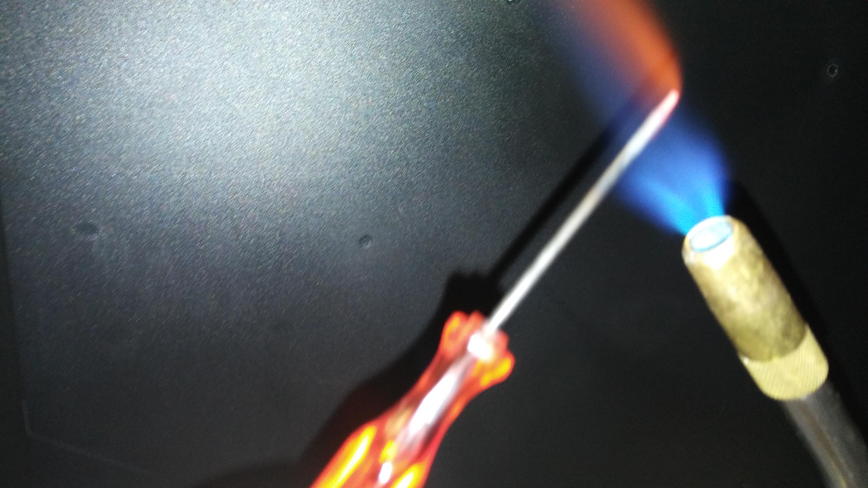

                                    PS: Ive fixed the bended TORX screwdriver, by heated the tips.
                                    Should I return??? NO, I learn a lot, love even more on this pre-open TS100 than my wife.
                                    This theftproof TS100, I could take a picture and show that was mine.
                                    • capwizard
                                      • Jun 2016
                                      • 1991

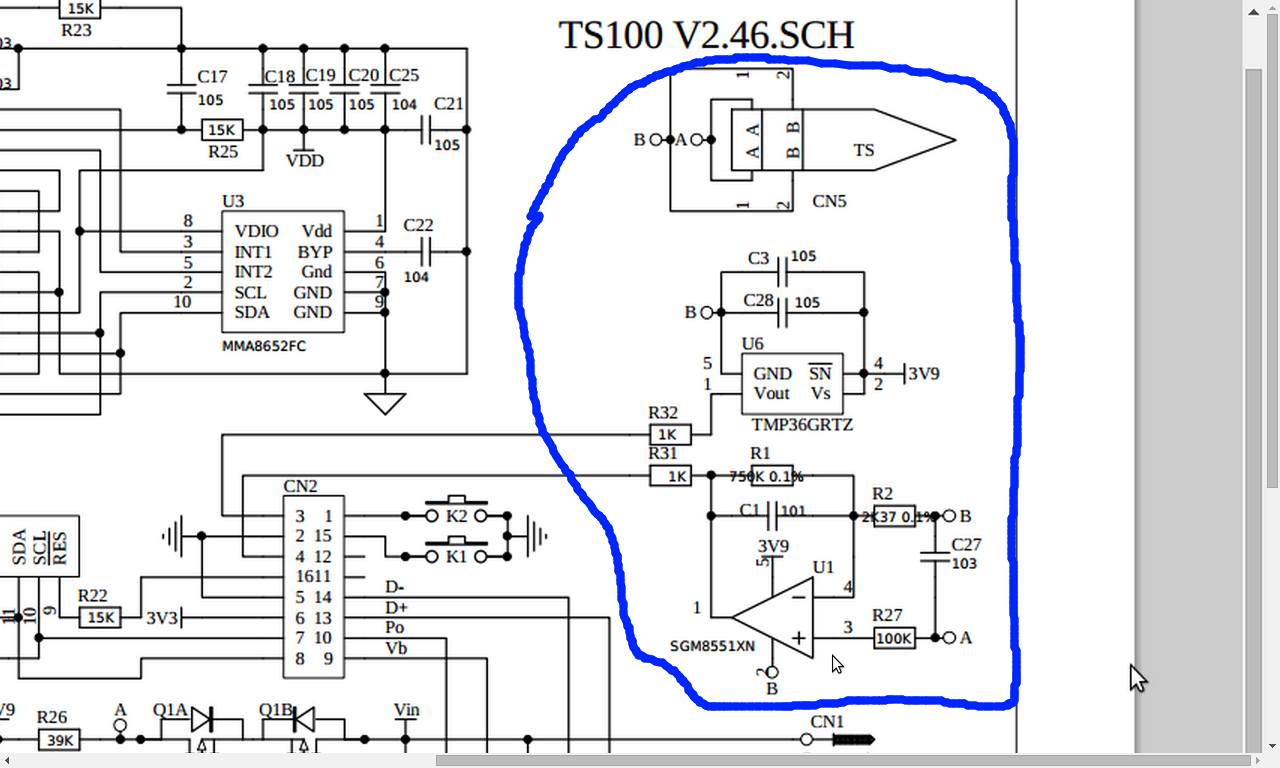

                                      k-type temperature sensor circuit is kinda confuse will completely explain at tomorrow.
