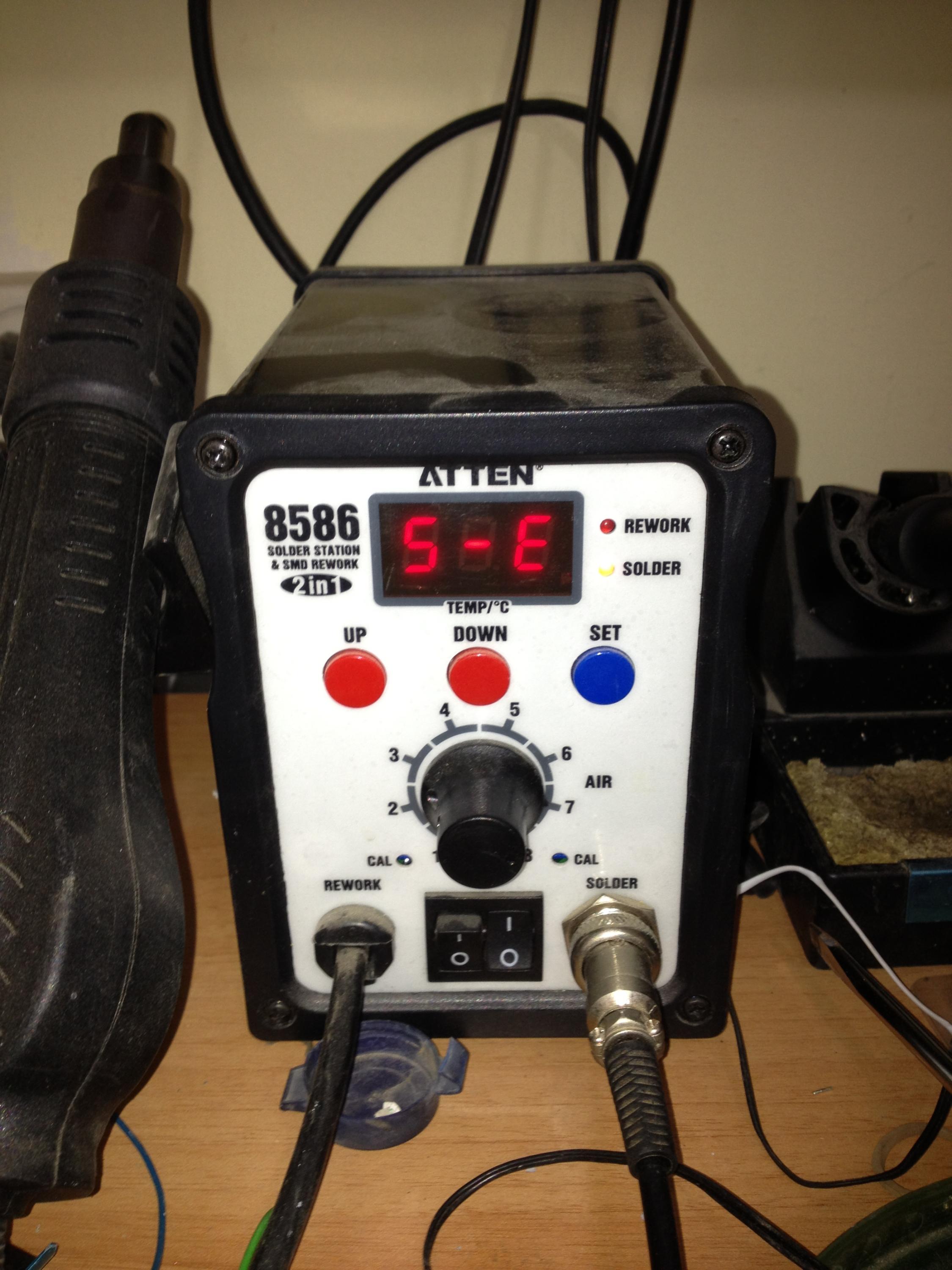

    hey guys, got this station for about two years,
    yesterday it stopped heating the soldering iron, the hot air works.
    and i can see this on the screen, any ideas?

    i would remove the soldering iron and do a resistance tests across the terminals on the iron, more than certain the element has gone O/C,then if that fails do a voltage measurement from the out put of the station to verify voltage and troubleshoot from there.

      i think so too, but before i order a new heating core, or the whole iron.
      between which pins sholud i test resistance,
      and what should i expect.

        check the red and blue coming out of the white ceramic core,id expect to see fairly low resistance of a few ohms

          out of the core,
          goes 4 wires:
          red and transparent on one side,
          and on the other, yellow and transperent.
          between the red and yellow, i get 20.7Mohm
          does it mean its dead?
          should i order only the core or the whole iron
          (14.83$ for the element, 18$ for the whole iron?)

                  hey sam, thank you very much for the link,
                  "Display "S-E" means there is something wrong with the sensor of the working channel.
                  so the device stops outputting signal."
                  i already ordered a new soldering iron for the station, i hope it's not for nothing , :-(
                  any idea what it means?

                    GOOD NEWS,
                    the iron arrived today and the station is now working again!
                    thank you very much!!!
