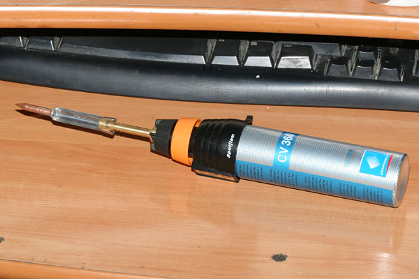

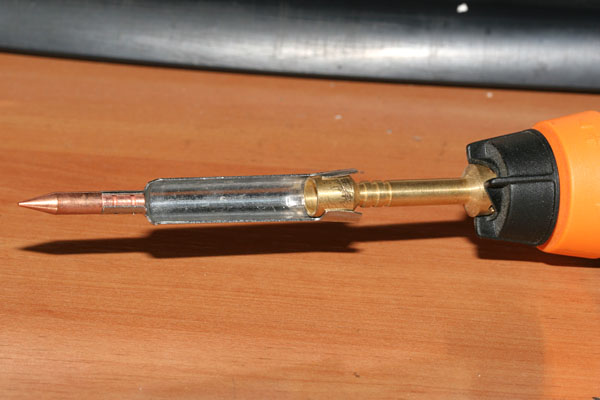

                                        Campingaz cv-360
                                        good for doing heatshrink and smoothening edges of acrylic. yup
                                        good for smoking crack...probably
                                        good for recapping.....nope. cartridges are expensive, tip is wobbly and too hot.
