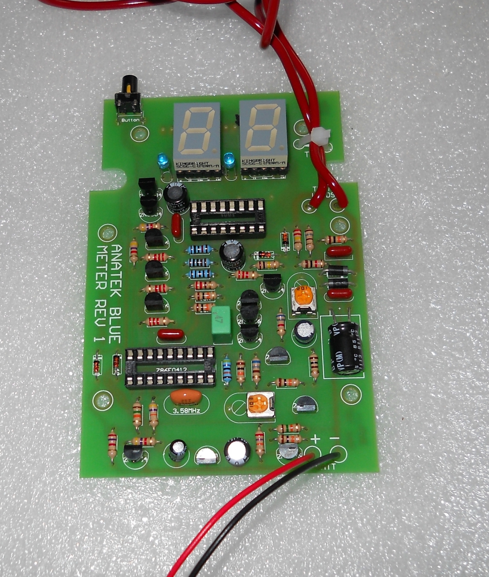

    Hi everybody!
    Yesterday I assembled my blue esr meter according to the instructions and stumbled upon initial checks section (with only integrated circuits left to install), precisely: "Set both VR1 and VR2 to their mid-range positions and connect a 9V supply to the battery connection. Press the pushbutton. You should see something on the 7-segment LED displays, hopefully “-” on the left hand one.".
    Well, my meter doesn't show any signs of life and I couldn't locate any soldering mistakes or wrong placement of components. What to do next? I will provide pictures later if necessary!

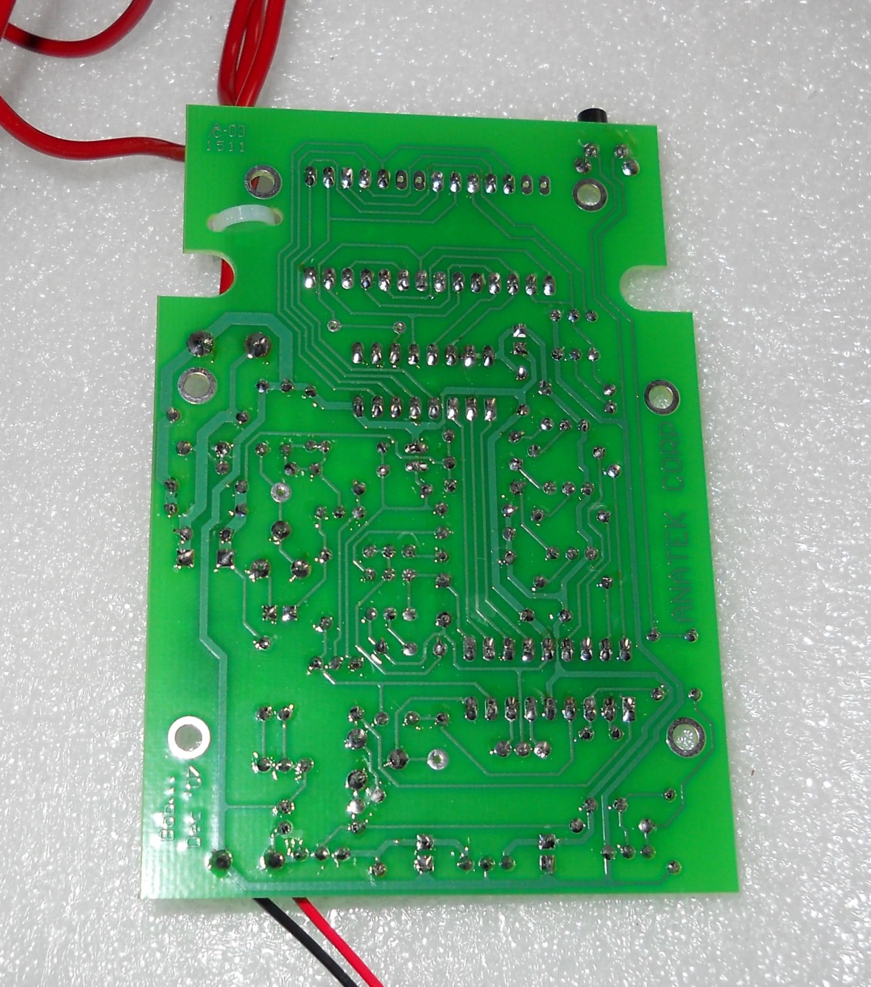

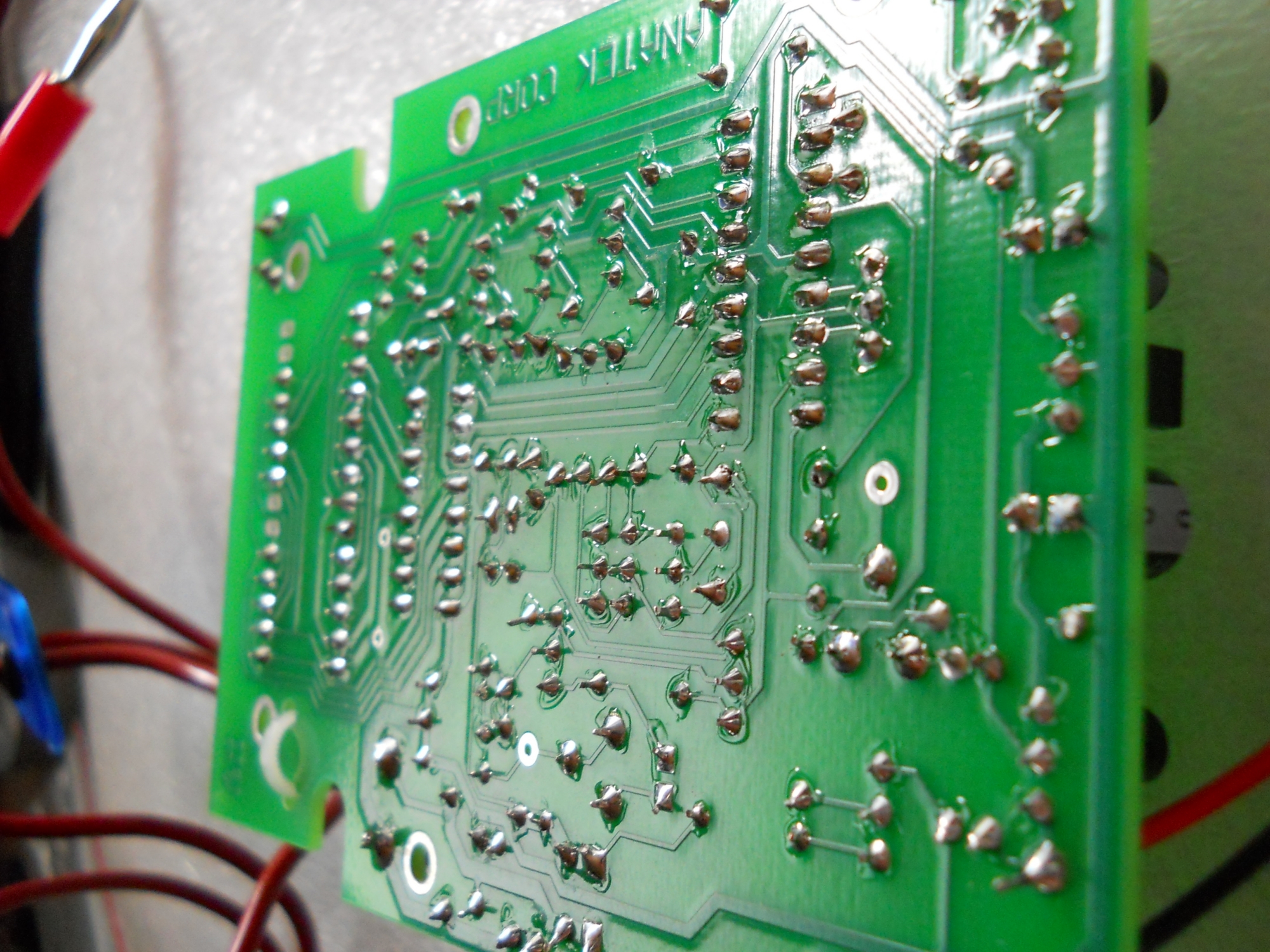

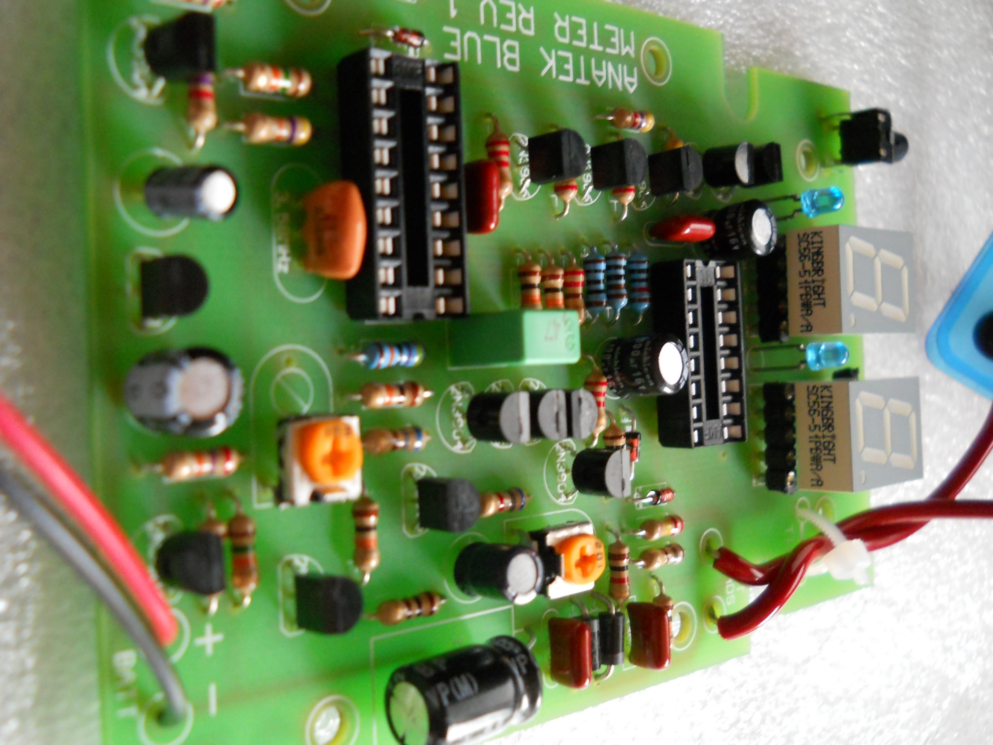

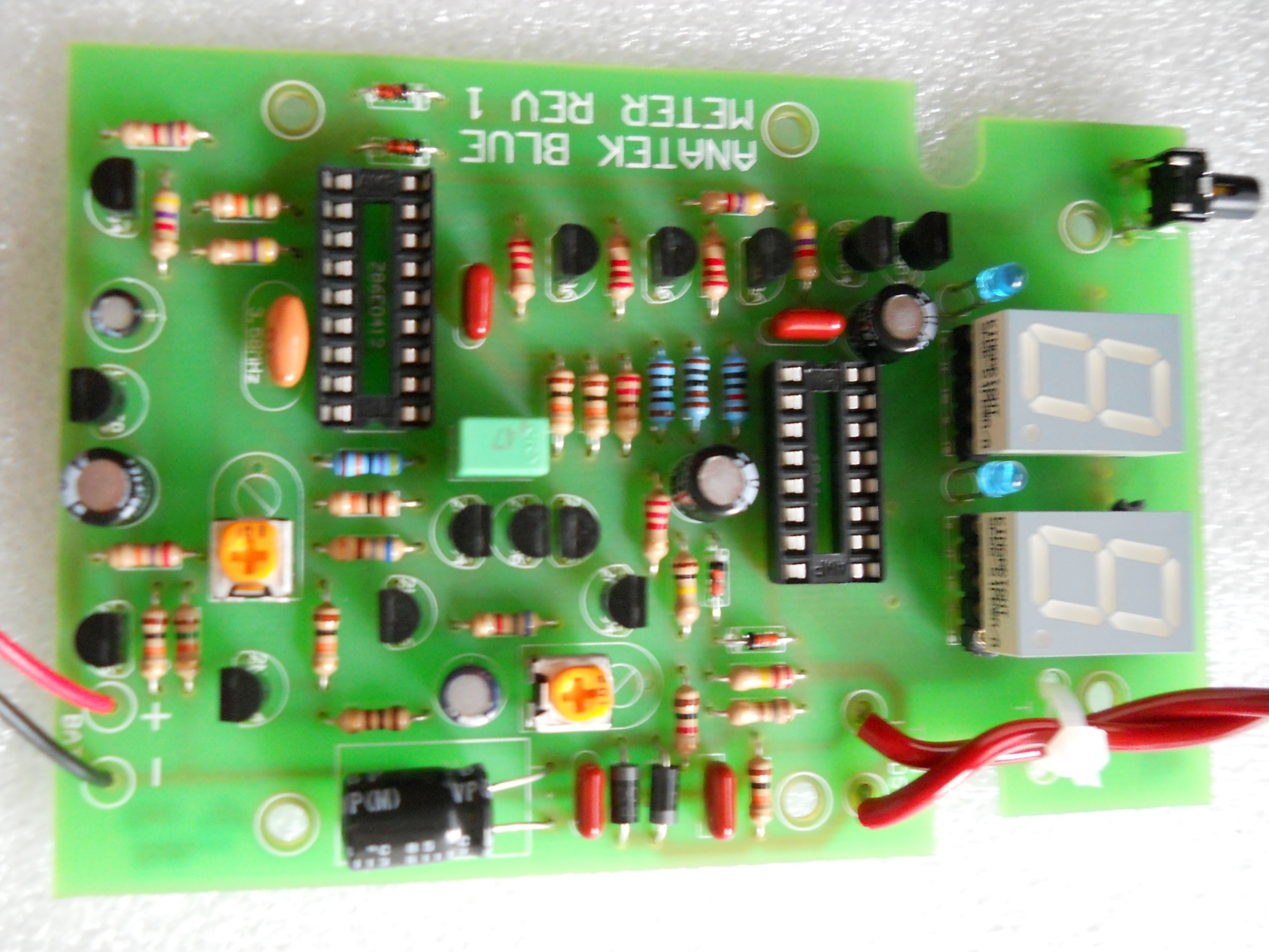

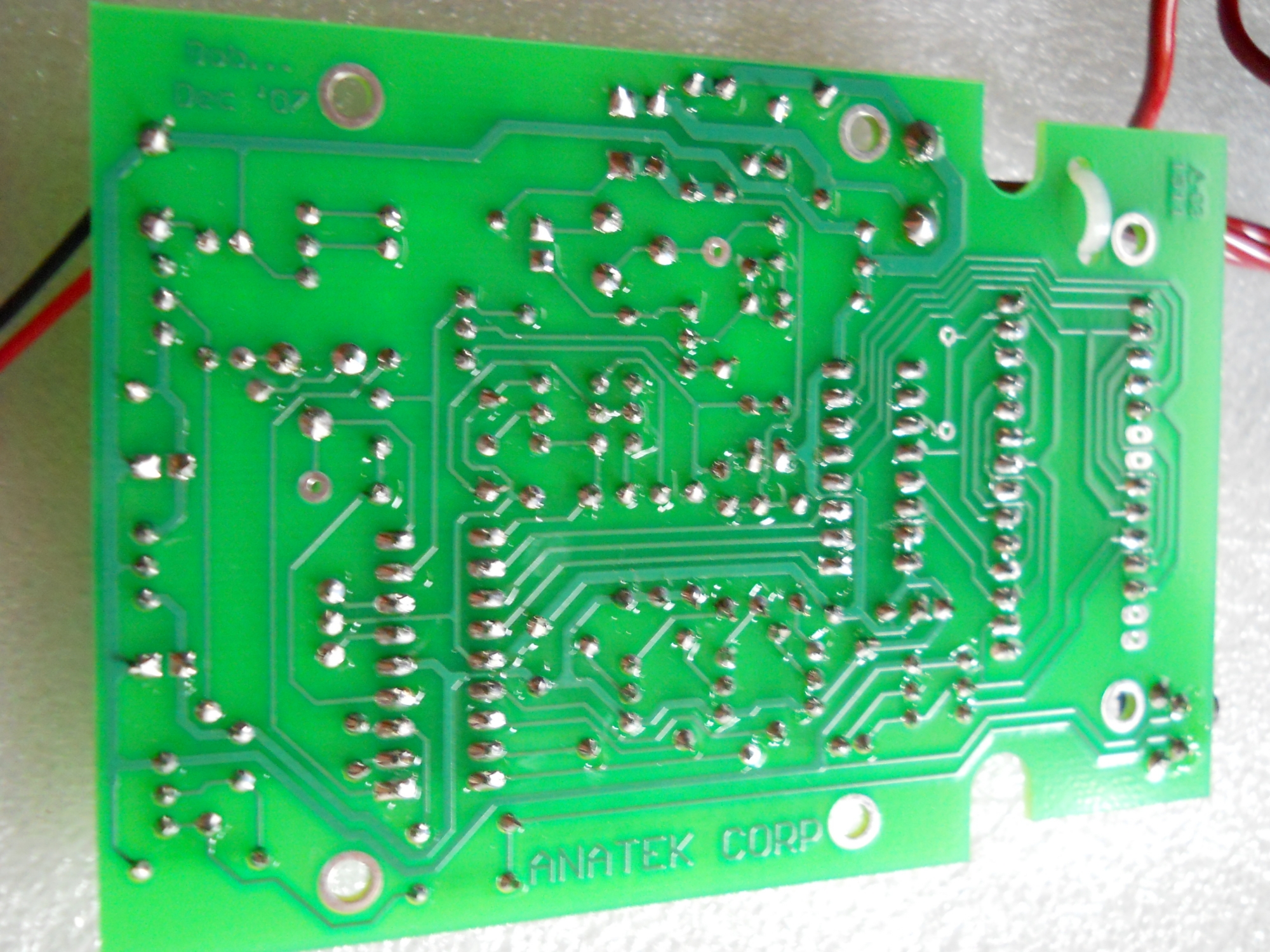

            Ok, so here are the pictures...
            • Moustahil
              • Jun 2011
              • 8
              • Croatia
              Re: Blue ESR Meter assembly problem
              It is very confusing since on some pictures it might look like there's solder on board, but it's only light reflection from flux!

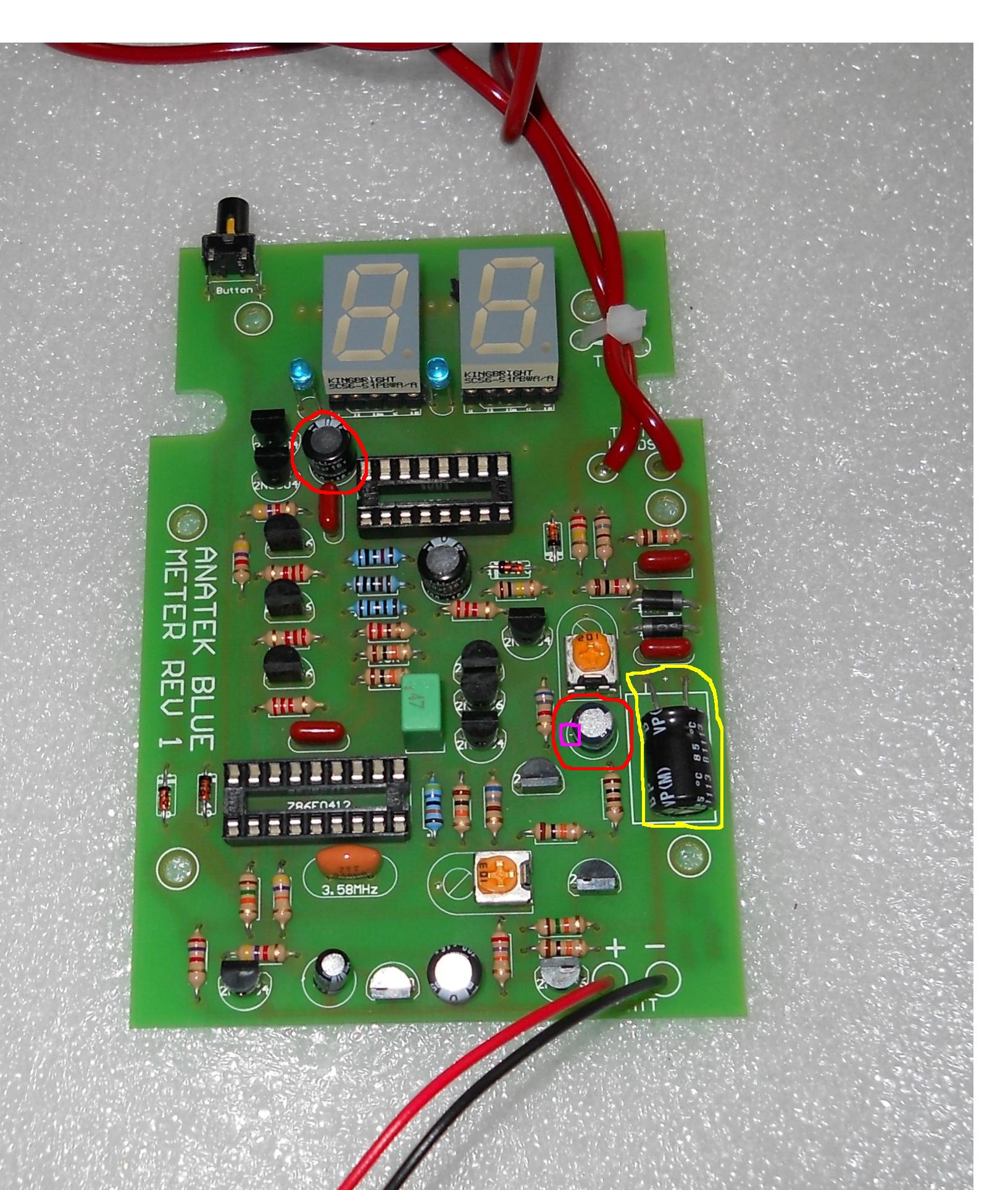

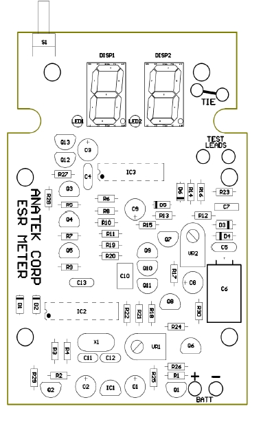

                Hi - On the diagram (Revision 1)I have for the blue the cap at the top just under the left hand "8" is oriented with the negative leg at the bottom?
                Also check the other two I have ringed The small cap on my diagram is the only one on the board which shows the negative leg (ringed in pink)all the others it show the positive. If so that could be the wrong way around.
                The Big Cap (Ringed yellow) just has a + at the top so could be either leg.
                Is your diagram better.- perhaps you can post it?

                  Great observation selldoor, thanks! Capacitor on the top left side indeed had wrong orientation. I corrected that, but nothing shows up on LED display yet. The small cap is fine, it's a + sign underneath actually, and the big one is bipolar!
                  Diagram I used is slightly different, I will post it!

                      Maybe having the cap reversed has damaged it? following quote from ELNA capacitor site
                      DC usage for aluminum electrolytic capacitors have polarity.
                      If the polarity is reversed, the electrical current across the capacitor will be extreme. Thus, possibly causing shorts or damage to the capacitor. Do not use a DC polarized aluminum electrolytic capacitor in circuits where the polarity is unstable or unclear. Also note that the bipolar aluminum electrolytic capacitors for DC usage cannot be used in AC circuits.
                        Hi, I think the Blue meter kit notes leave something to be desired (I didn't write them but I should have). After putting all but the ICs on the board, the idea is to connect a battery and hold down the button while checking that you see very close to +5V (relative to battery negative) on pin 5 of IC2. At this point you won't see anything on the displays because the IC which drives them has not been installed yet.
                        If the +5V test is OK, then you install the ICs and push the button and hopefully you'll see "- " on the displays.
                        NB! In your photos, it looks like the socket's pin 1 notch for IC2 is on the right-hand side. Pin 1 of IC2 absolutely MUST be facing the left, not the right otherwise there's a good chance of destroying it. The same goes for IC3. Double check the pictures in the kit notes. Disregard the position of the paint dot (which is probably at the wrong end)... pin 1 is indicated by a small notch on the IC itself!
                        I hope this info helps....

                            You don't really have to unsolder and reverse the socket, just as long as the IC itself is facing in the correct direction.

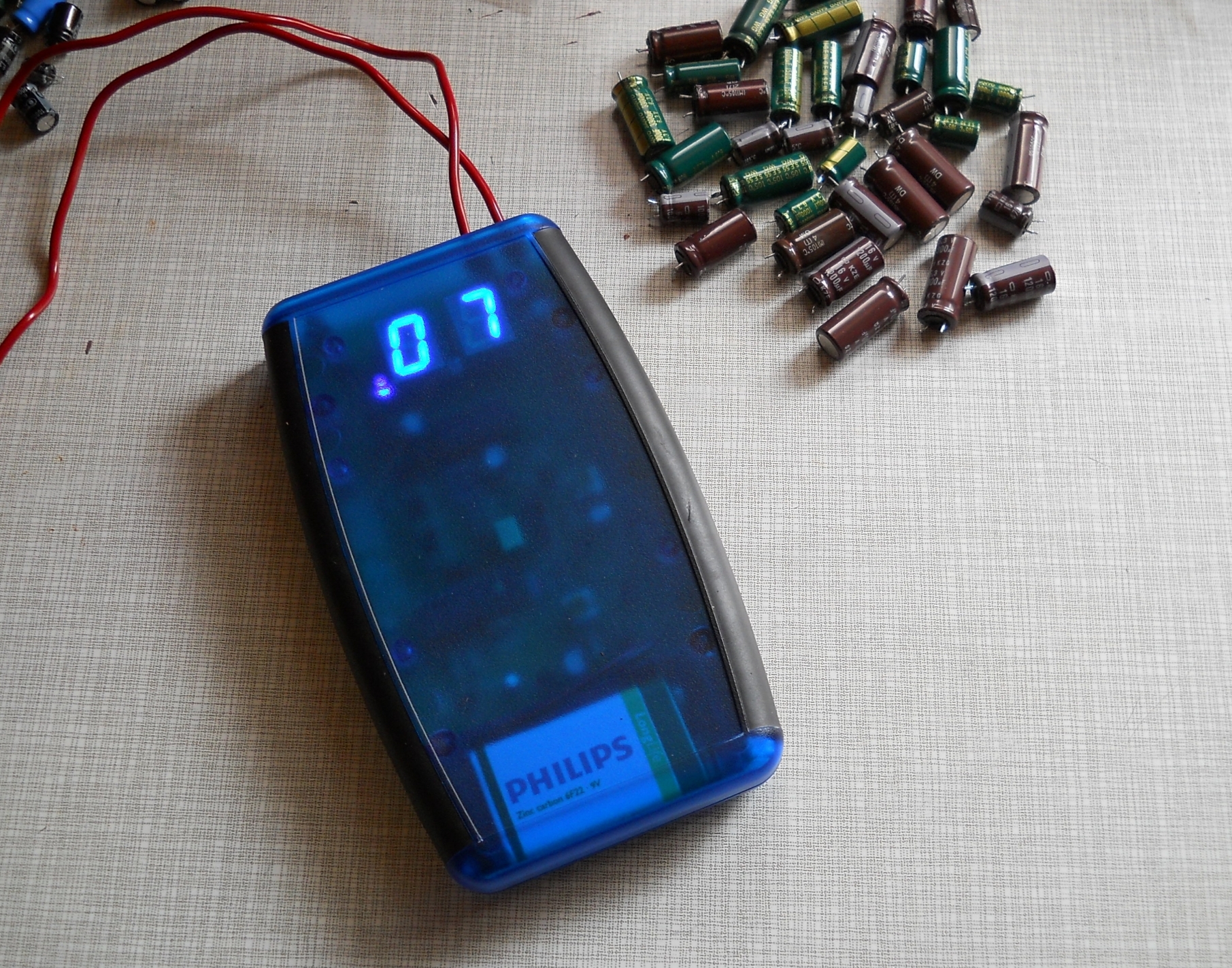

                              IT WORKS!!! I have checked pin 5 on IC2, +5V as you say it should be, mounted IC's, and that's it! Thanks Bob for clearing that up and selldoor for spotting a cap!
                              Tomorrow I will upload a photo of it!
                              • Moustahil
                                • Jun 2011
                                • 8
                                • Croatia
                                Finally assembled unit and diagram...

                                      Are those green/yellow caps made by Sanyo/Suncon? If yes, did you buy them from ebay? Most of them are fakes on ebay. It would be interesting to see a picture of the top, bottom (bung), and your ESR measurements of those caps.
