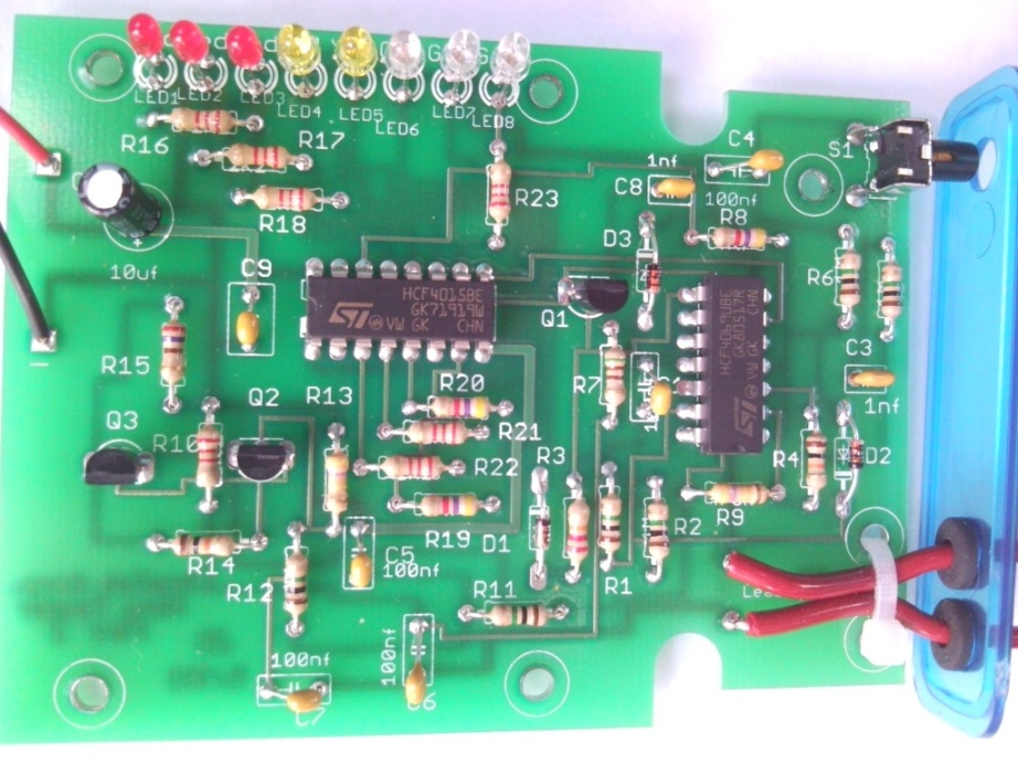

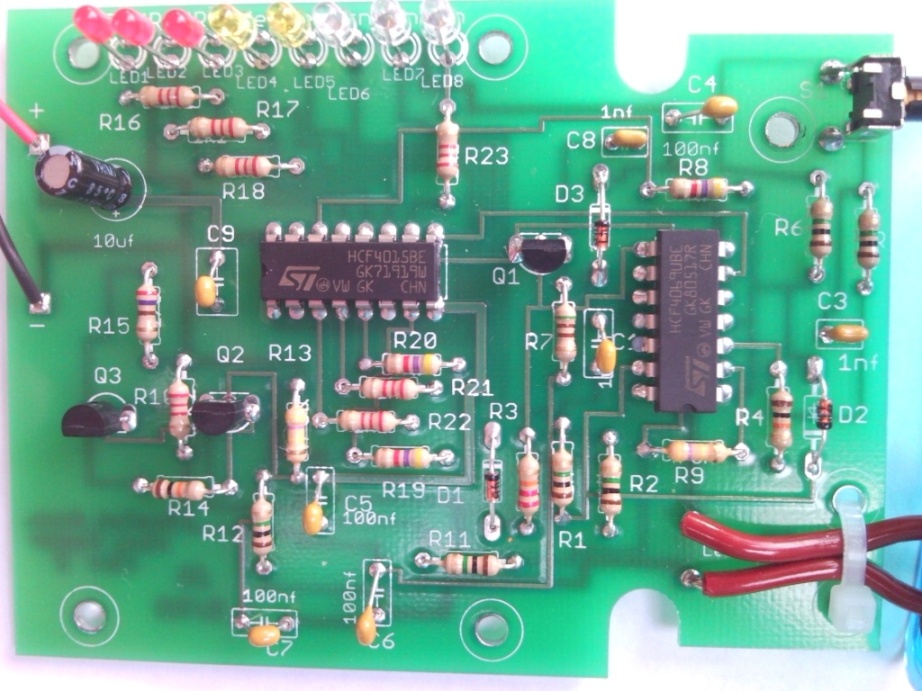

    ESR meter blues
    I purchased a blue ring tester kit about 6 months ago, and it has been working well, until... I was checking a transformer on a circuit board on a computer LCD monitor. The led's just went out and would not turn back on. I tried another battery but no luck. The only "life" I have managed to squeeze out of it is to remove the battery for awhile, and then when I connect the battery again I see led 5 and led 6 turn on (sometimes 1,2, and 3 also flash), and then back off, and then it seems dead again. I can also remove the battery, press the power button about 10 times, and then when reconnecting the battery the same led's flash once.
    It is possible that a capacitor was not discharged and could that have had enough voltage to damage the tester? A component has failed, but I have no idea where to start looking. There are not visible signs of damage to the board. If you have any recommendations please let me know.

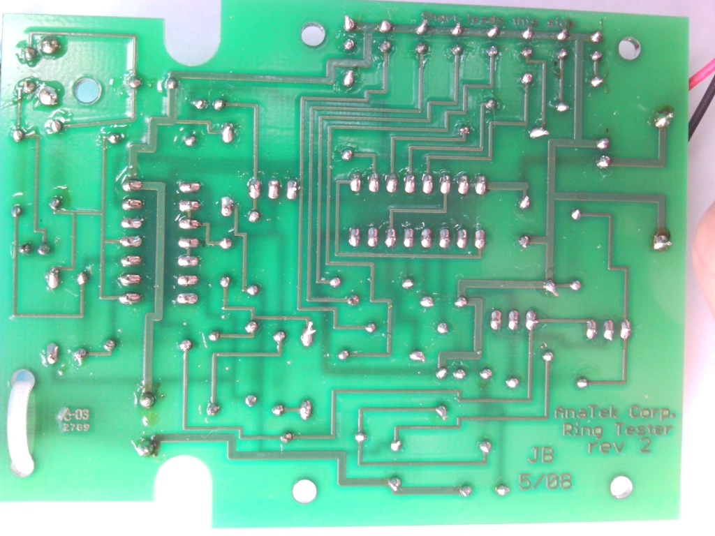

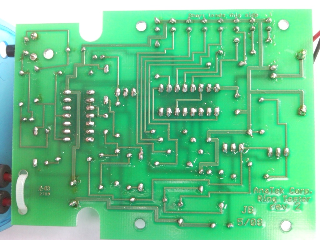

    I redid all the solder joints and and put in a brand new battery, but neither helped. There were a few solder joints that did not have much solder applied, so I was hoping that would be the problem, but no such luck.
    I was testing the main transformer with the power off. I had just removed the plug 15 seconds before, and since it the lcd isn't working, it may have not discharged before I applied the probes...
    I removed the three transistors and they all tested ok.
    I connected the battery and tested voltage at the two large ic's. Pressing the power button has an affect on the voltages at the ic's, but no led's ever appear. So I have two voltages for each pin, the first for as it was when first testing, the second after pressing the power button.

  • Krankshaft
    • Jan 2007
    • 2328
    Re: ESR meter blues
    You probably killed some semis in circuit check all of the transistors with the diode check.
    If they're fine you probably fried one of the ICs that's why I put sockets in mine.
    IC1 is both the oscillator and the comparator. IC2 drives the individual LEDs.
    IC1 applies the oscillations to the inductive component and the comparator also part of IC1 counts the rings. It's findings are sent to IC2 which drives the LED indicators.
    Killing either can cause your issue unless you have a scope to check to make sure the oscillator and comparator in IC1 is working there's no point in going further. On a circuit this small troubleshooting is a bit of a waste.

          Re: ESR meter blues
          It was the 7 pin IC near the probe wires. Replaced it and all is happy again. I did not realize how much I used it until it was gone...
          Thanks for the info about repairing the ESR meter, as I will undoubtedly wreck it someday!
          I had posted this first on the forums at Anatek without much luck, and when I just went back to update that post there was a message saying that Anatek would have provided the parts at no charge... if I had asked. So that could save someone a couple of bucks if they encounter problems.
