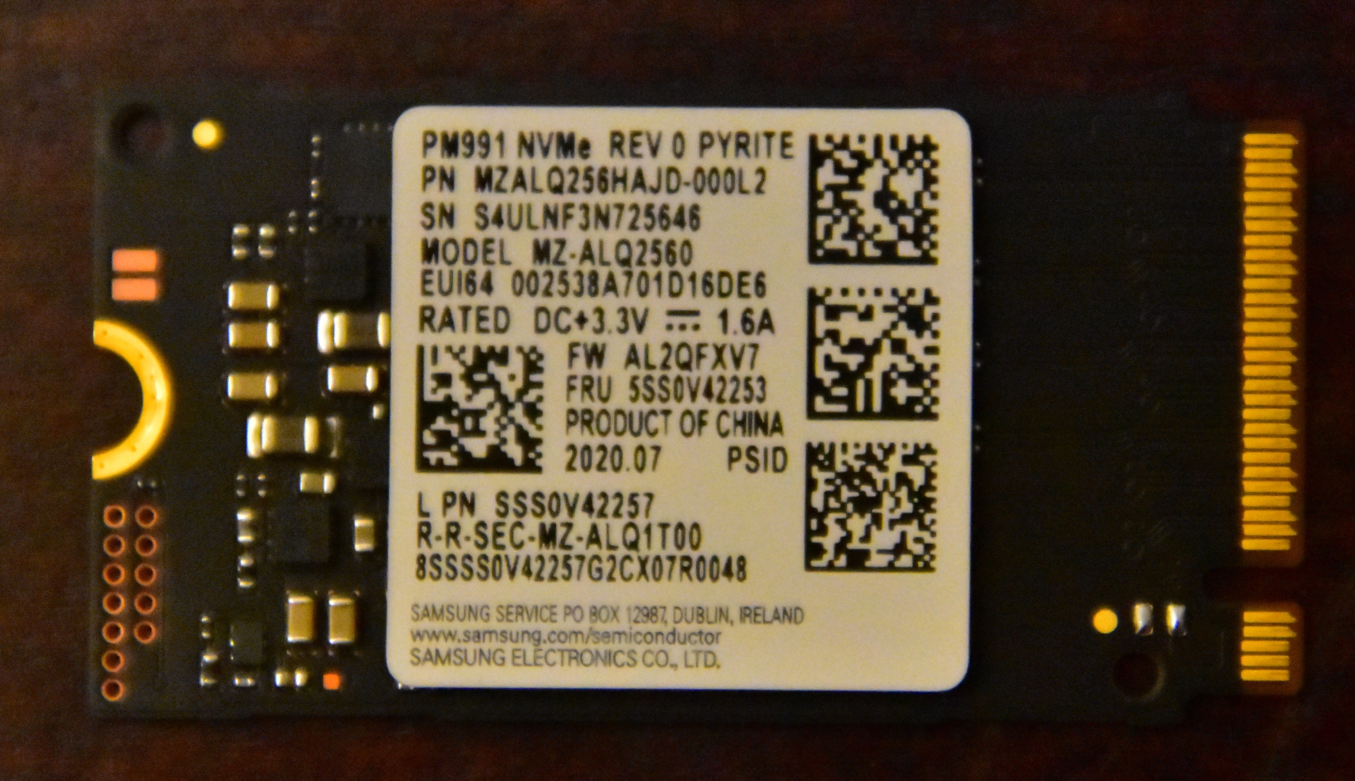

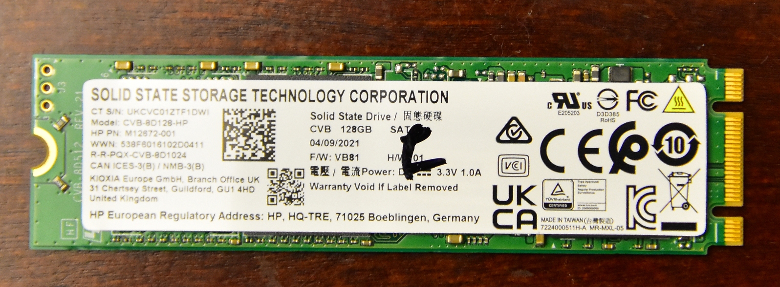

              SATA M2 drives have 2 key slots in the connector, and are limited to SATA speeds (6 Gbps) and look like this:
              NVMe M2 drives run on the PCI Express bus, have one key slot on the connector and can run at much higher speeds (as fast as the generation of PCI Express X2 or X4 slot the CPU/Motherboard supports depending on how the drive and slot are configured) and look like this:
              (Ignore the different drive lengths, that's just packaging and either type of drive can come in either length, it is the connector that matters)
              A SATA drive can run in an NVMe capible slot (but limited to SATA speeds), but an NVMe drive cannot run in a SATA only slot (and the different slot keys will prevent it from being inserted).

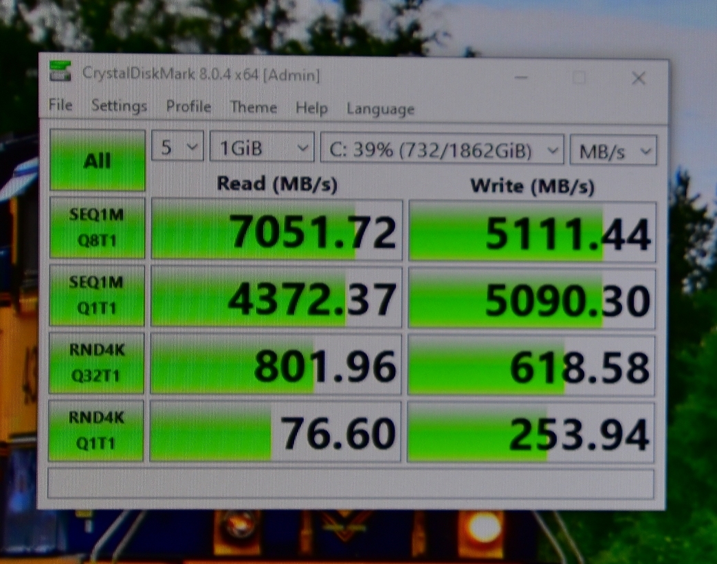

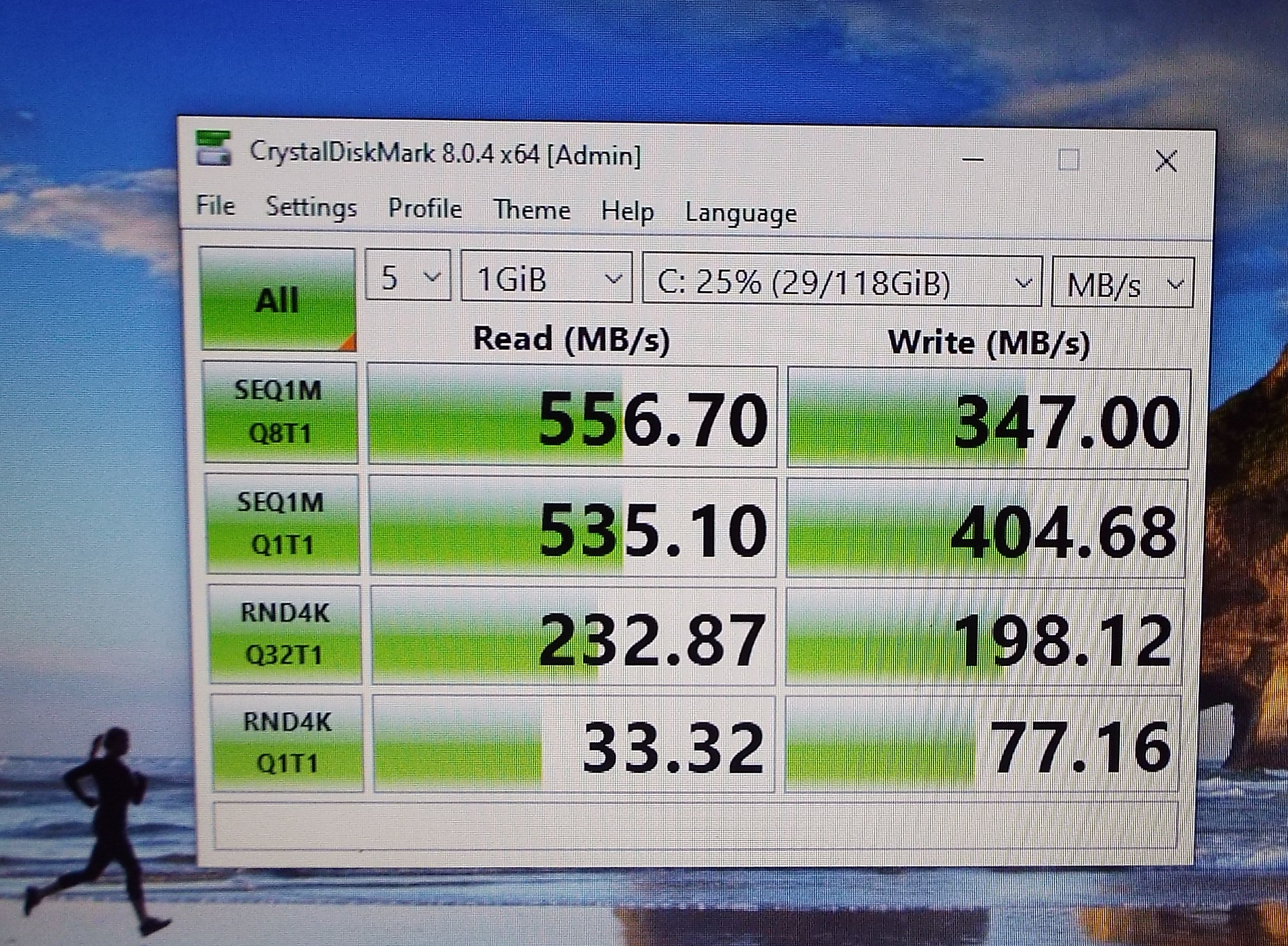

              And The Speed Differences:
              SATA:
              (yes there are SATA drives with faster write speeds, but the read speed is pretty close to bus saturation)
              vs NVMe (Specifically a Western Digital SN850 running in a PCIe 4.0 X4 M2 slot):
