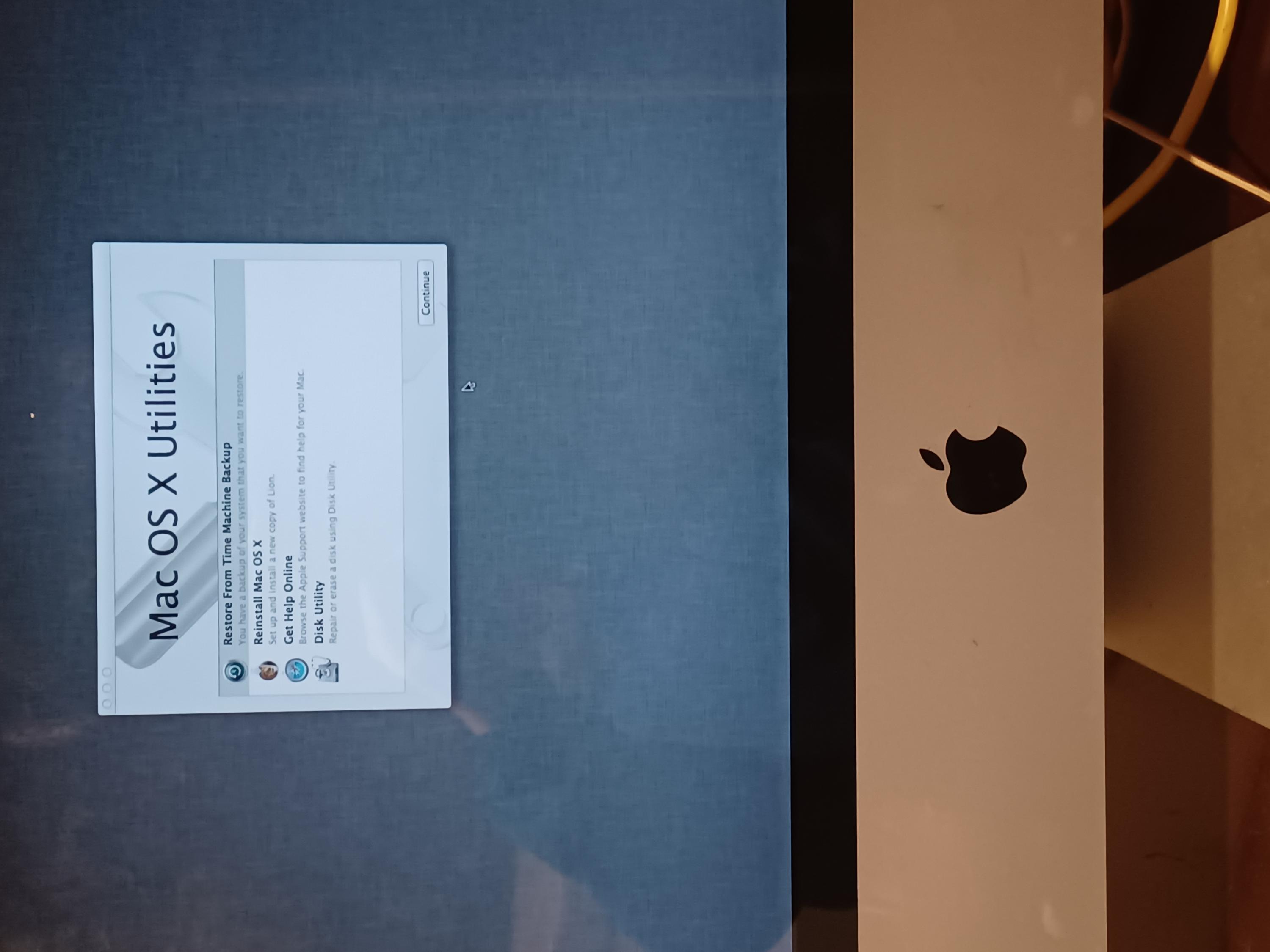

    I've got an Apple iMac that I can't update or restore the os on , I've tried a few different things that I've read on Google & watched on YouTube, so I thought I would see if you lot could help me out as I have had loads of success with TV help from this site.
    Basically it's on the Mac OS X Utilities screen but all the options come to a dead end, I am not too familiar with apple I'm more windows so I don't want to try wiping the hd to end up having to take it to a shop
    Any help would be appreciated

      All options don't work, selecting install Mac OS bought me to yet another dead end, I've ended up wiping the hd thinking I could download some version of Mac OS but I've been unable to so far , I think it's going to come to buying a replacement hd with a working OS installed

          Format the internal drive in Disk Utility as MAC OS Journalled, then back out and select Install MAC OS. You'll need an internet connection via WIFI to do that as it pulls the installer directly from Apple. I never use that method as its too slow, and installs the version of MAC OS it came with. Use a USB installer instead. I'm assuming this is a pre-2012 iMac, so High Sierra should work ok. Use this guide to create one..
          https://dortania.github.io/OpenCore-...INSTALLER.html
          Check what the highest version of MAC OS is supported on your iMAC. Prob High Sierra given it's age.
          Use Option key on bootup to get to the bootpicker, and select the USB drive you created. This will at least get you to a more recent version of recovery. You can also use an external HDD connected via USB to install MAC OS on as well if you suspect the internal drive is stuffed.

            I think I might of goosed it , I messed around with it one night when I was more than tipsy �� and now it's the flashing folder , obviously I've formatted it, is there still a way of installing an os ?
            BTW I don't have another apple device, only android and Windows 10

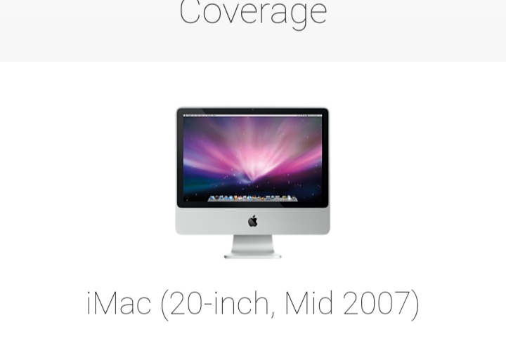

              Check what year your iMac was made via serial number, that way we'll know the highest version of macOS that can be installed. Check under the base of the iMac for your serial number.
              https://checkcoverage.apple.com/

                    Thanks for your help to all who have replied
                    The date of it is mid 2007

                      OS X El Capitan is the last OS your iMac will support. If it doesn't already, add 8GB of ram and maybe a SSD. I'll go a long way in just normal day to day usage. My recommendation, obviously you don't have to.
