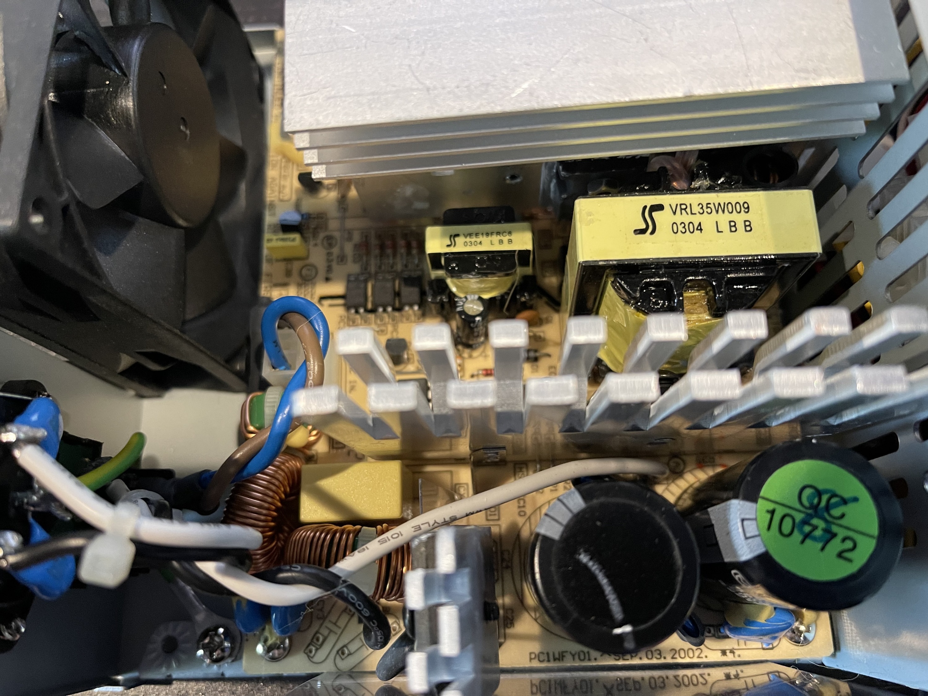

I have an update, I just went ahead and bought the SeaSonic for $40. The guy spent half on shipping so I suppose you could say it was $20 and $20 on shipping.

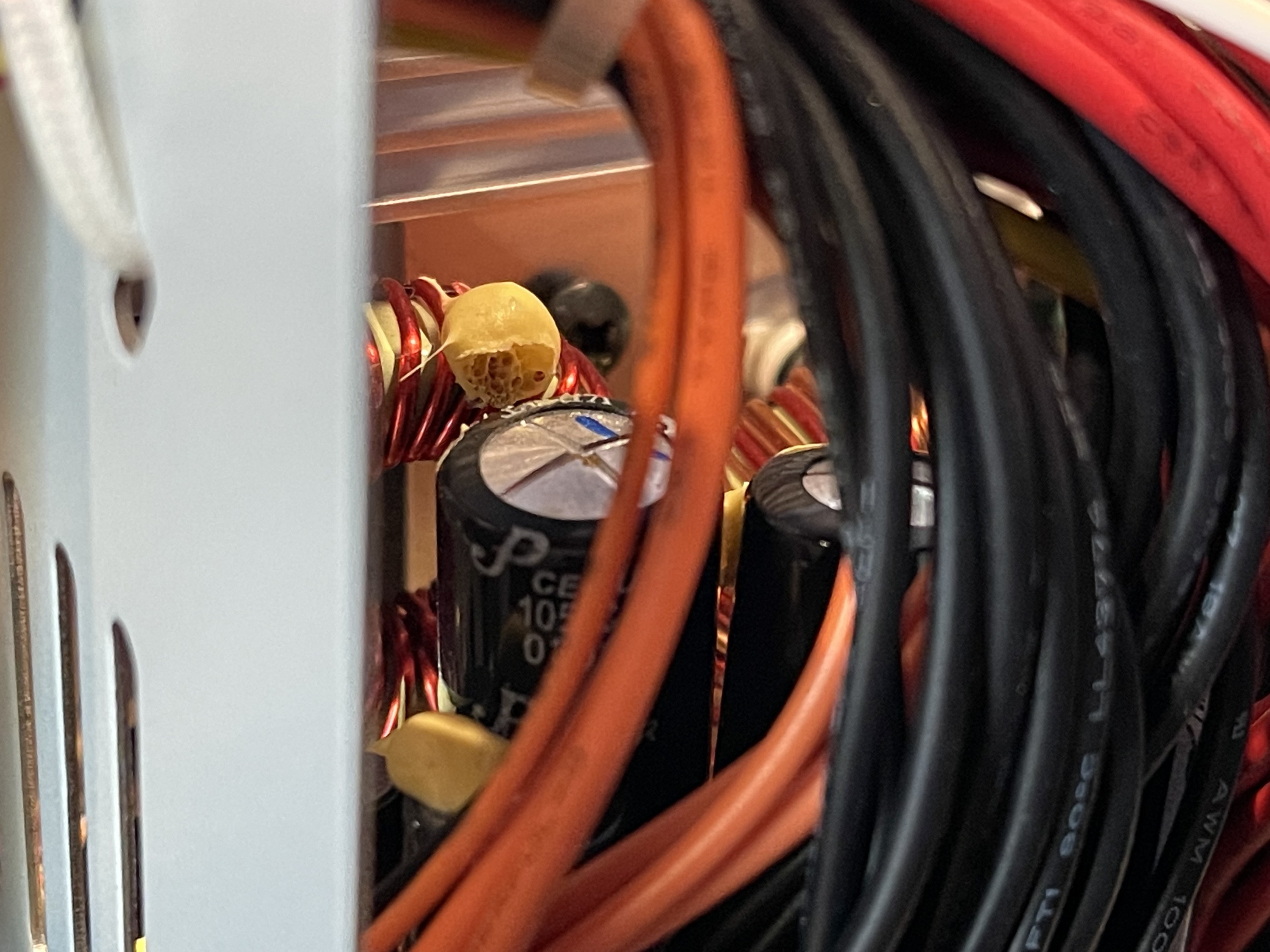

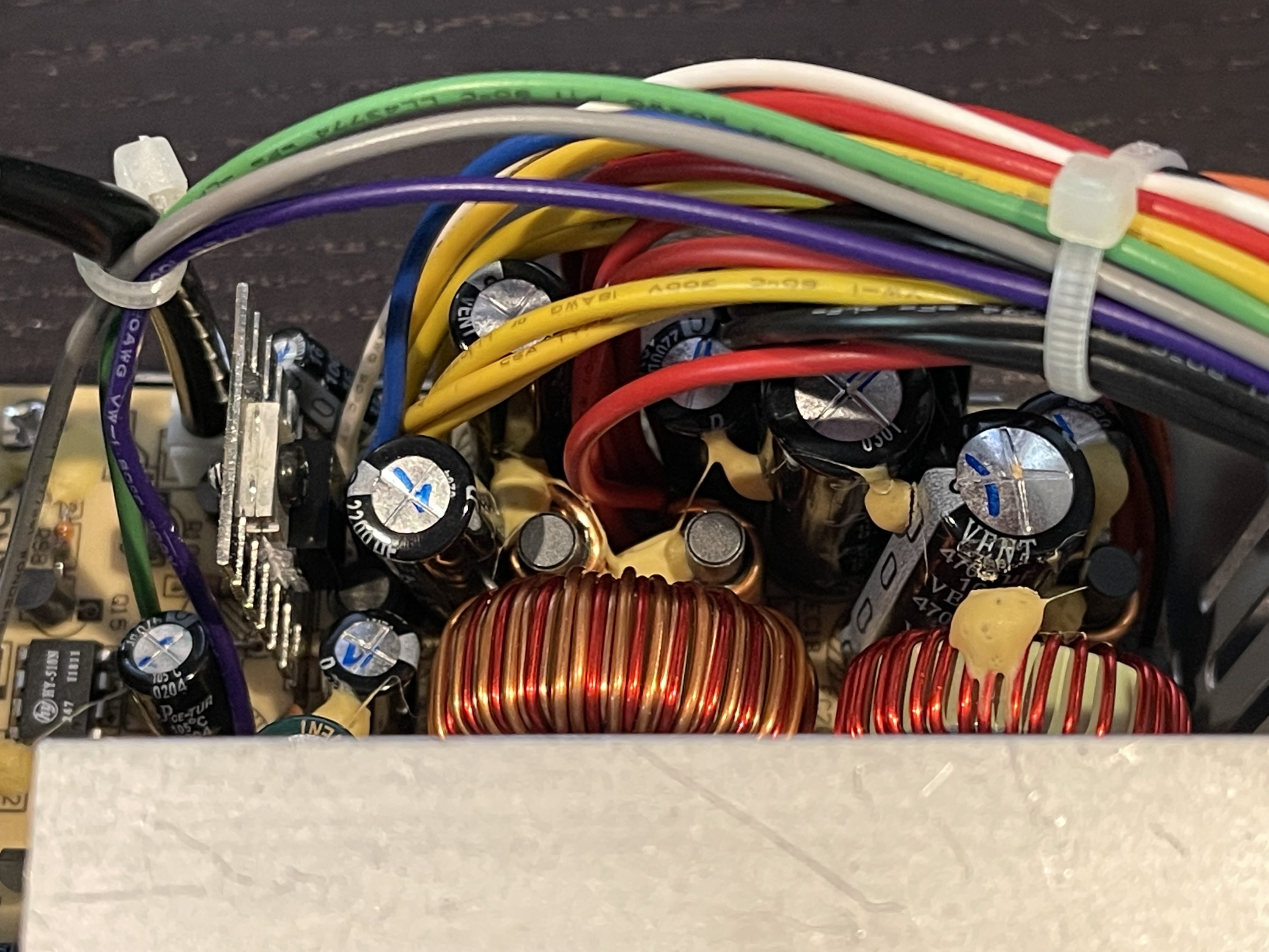

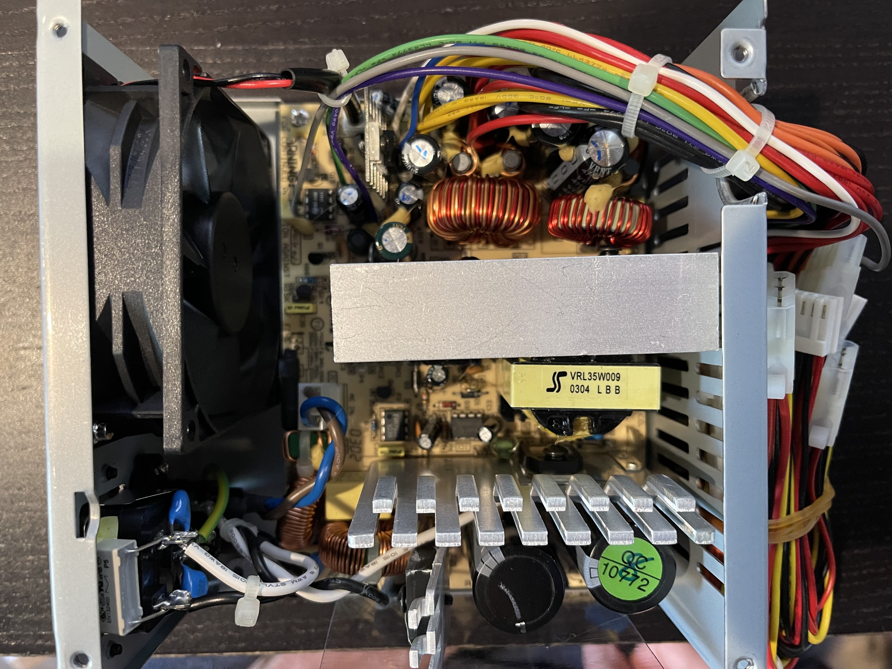

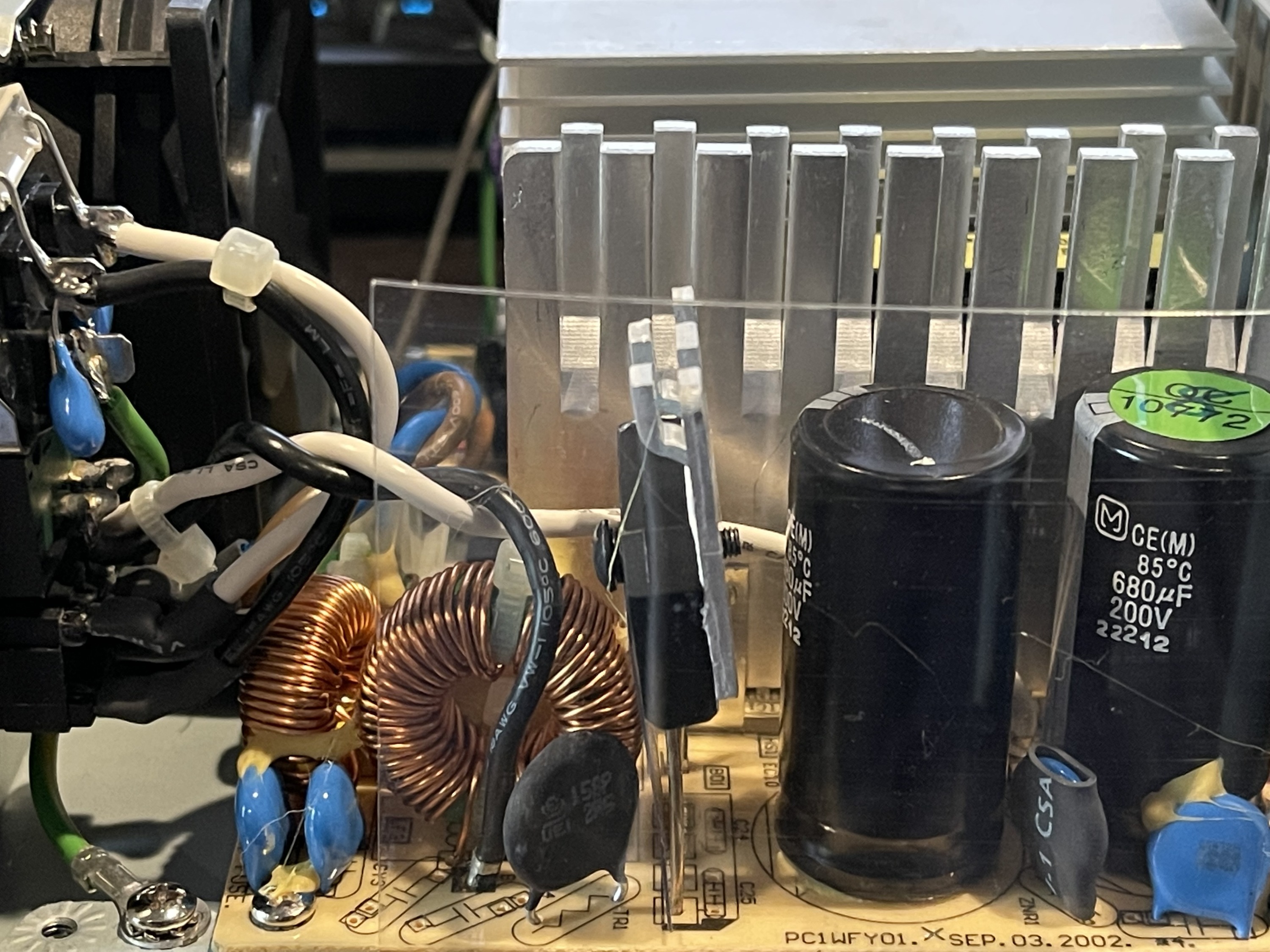

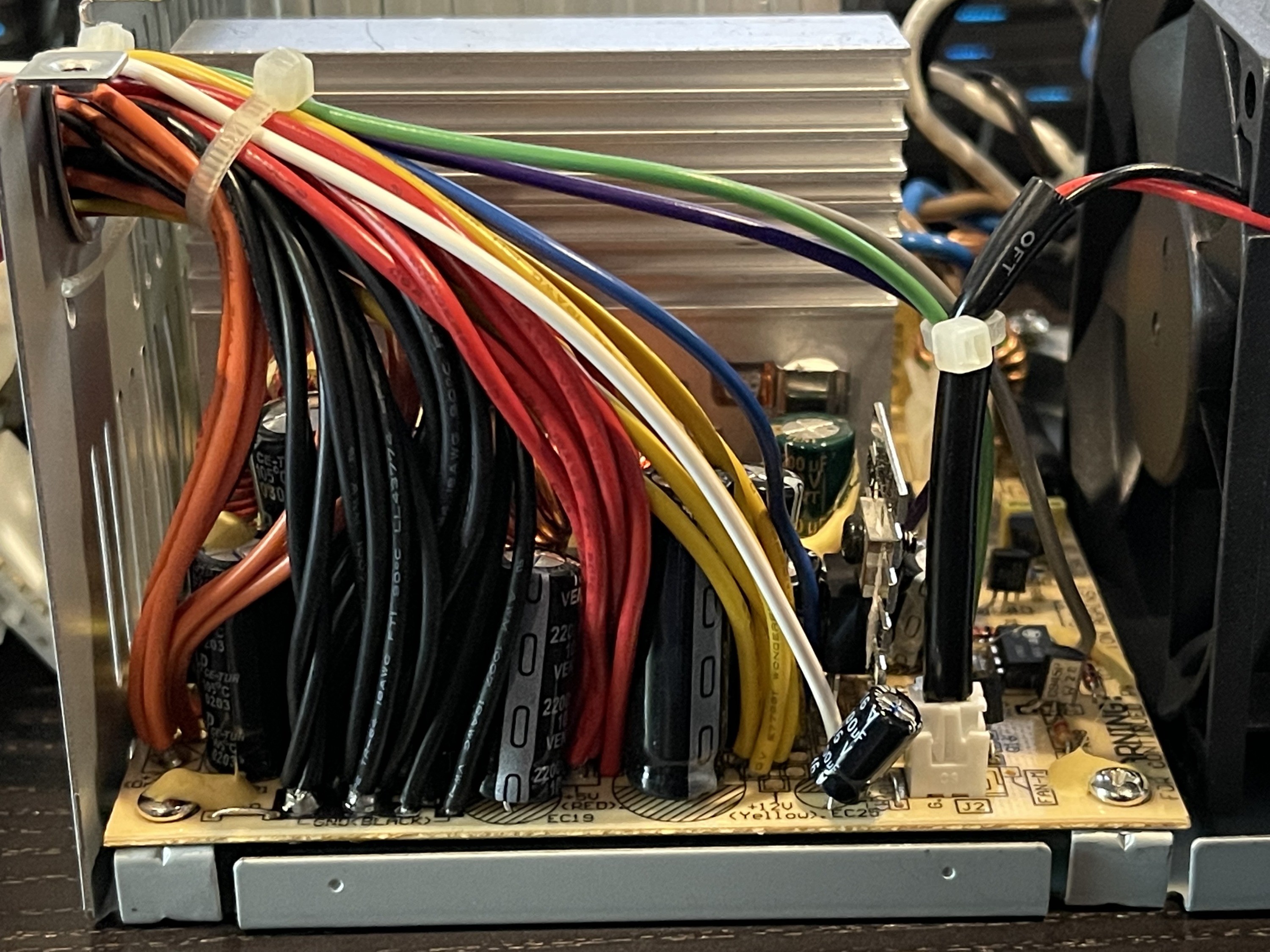

Anyway, here are the insides. I think I see some bulging caps.
Re: Recommendation for Pentium II PSU
Yeah, you didn't win the capacitor lottery this time around. Recap the secondary side and you should be up and running.Originally posted by PeteS in CARemember that by the time consequences of a short-sighted decision are experienced, the idiot who made the bad decision may have already been promoted or moved on to a better job at another company.Comment

I would also suggest to reform the main capacitor to be nice to it if the unit has not been powered on for many years.
This can be done very easily by having a really small incandescent light bulb in series with the unit.
Say 15w or the smallest you can find that is rated for your line voltage.
Then don't try to start the unit: just connect mains to it and switch the power switch to the on position.
The 5VSB will still be up and so the unit will be reformed even without starting it...
