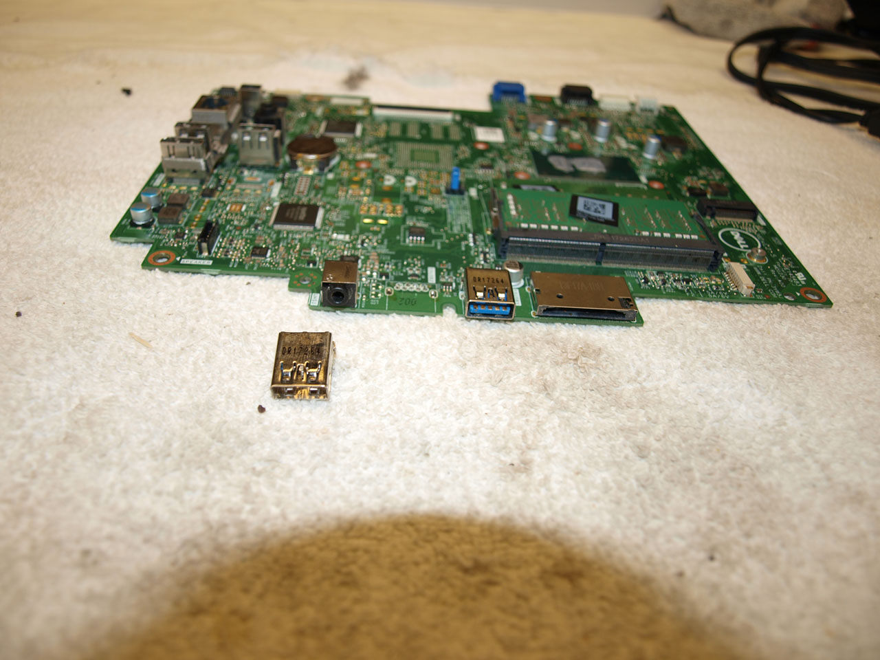

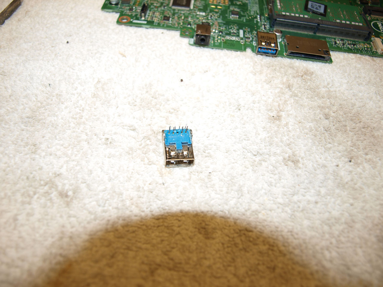

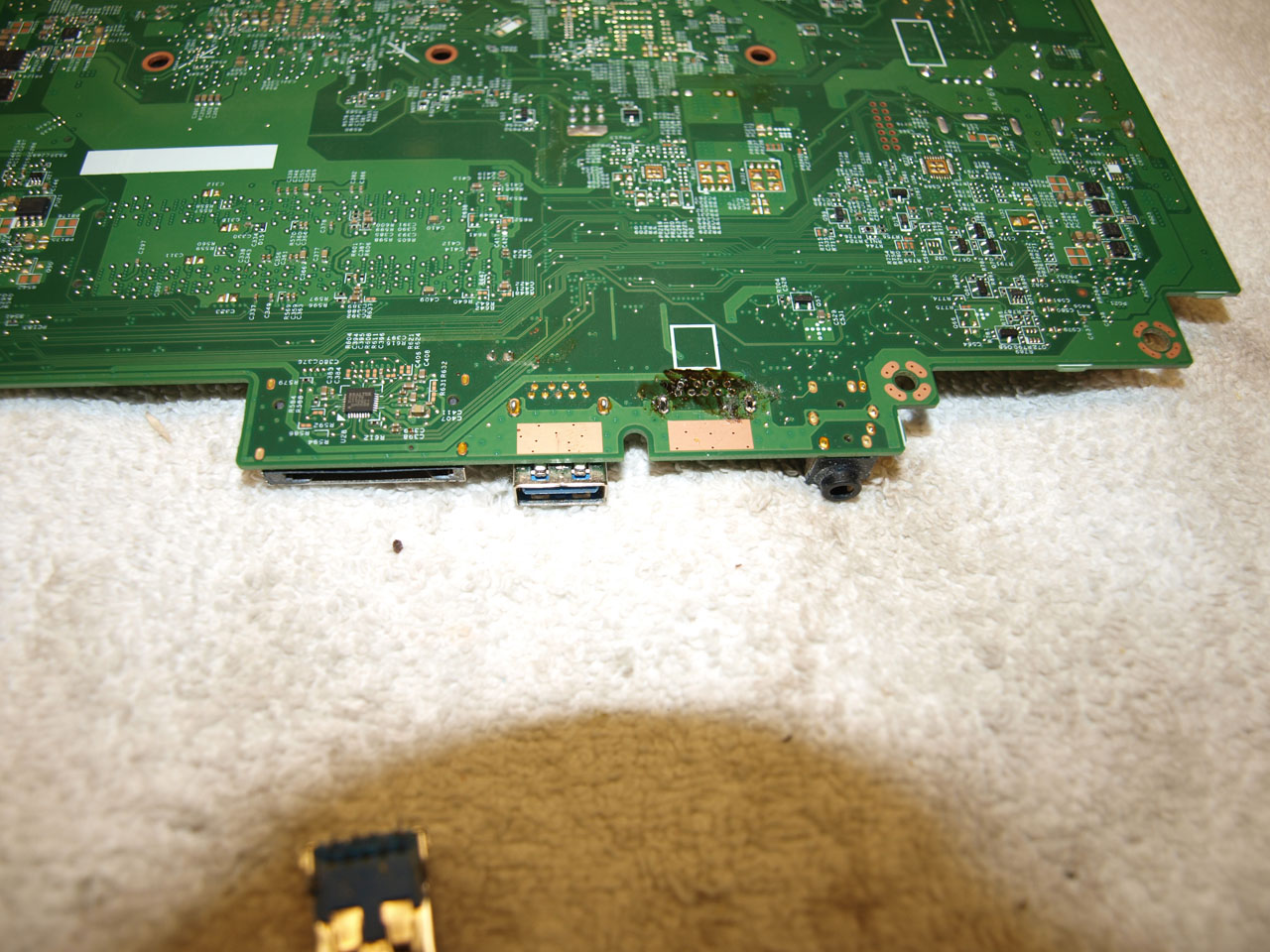

    I need to find this USB3 port off a Dell Inspiron 3463 AIO motherboard that was damaged. There's a number on the top of it: "DR17264", which crossed with nothing. I struck out with digikey and mouser and even ebay....perhaps I'm not using the correct search terms....but this is annoying!! Parts hunting apparently is indeed an art!!
    So here it is, find me one!!
    The board is ready & waiting for a new one....no I didn't scorch the board, that's just flux paste....the holes are clear and ready.
    If you need pics any more detailed than this, just say so....

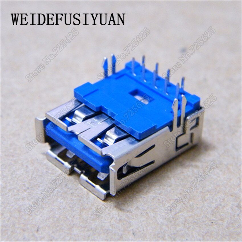

    Re: Parts Finders; I challenge you! USB3 Jack Needed!
    https://www.aliexpress.com/item/32883547115.html
      The 'tongue' is oriented upside down in comparison to the original....which would have the device backward....would that not have it technically wired incorrectly?
        well spotted, it wont fit on the board.

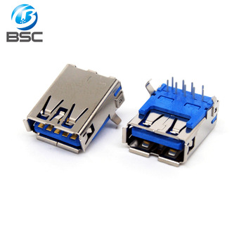

            never mind, I saw the tongue was wrong after uploading them
            I found this BSC brand from ali but it is nla
            Then I found this: https://es.aliexpress.com/item/32874903071.html
              Originally posted by R_J
              The 'tongue' orientation is the same as stj's.....but the through hole pins *look* the same as well as the body anchor solder points....perhaps it doesn't matter the orientation.....but logic tells me it'd be wired backward and bad things would happen when you plug a device in.

              • Topcat
                The Boss Stooge
                • Oct 2003
                • 16956
                By Joe, I think that's it!! I ordered a couple.

                        • 20984
