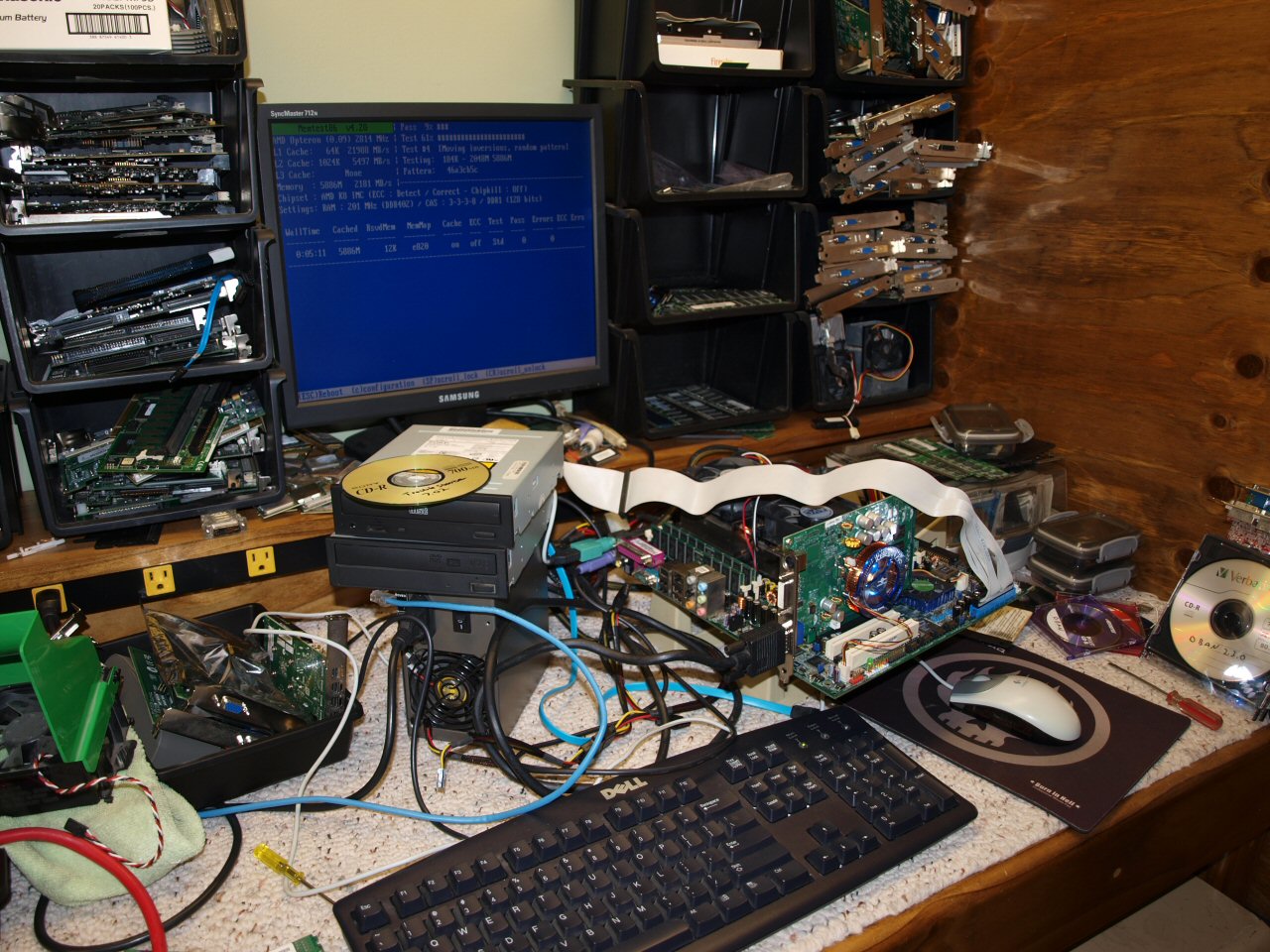

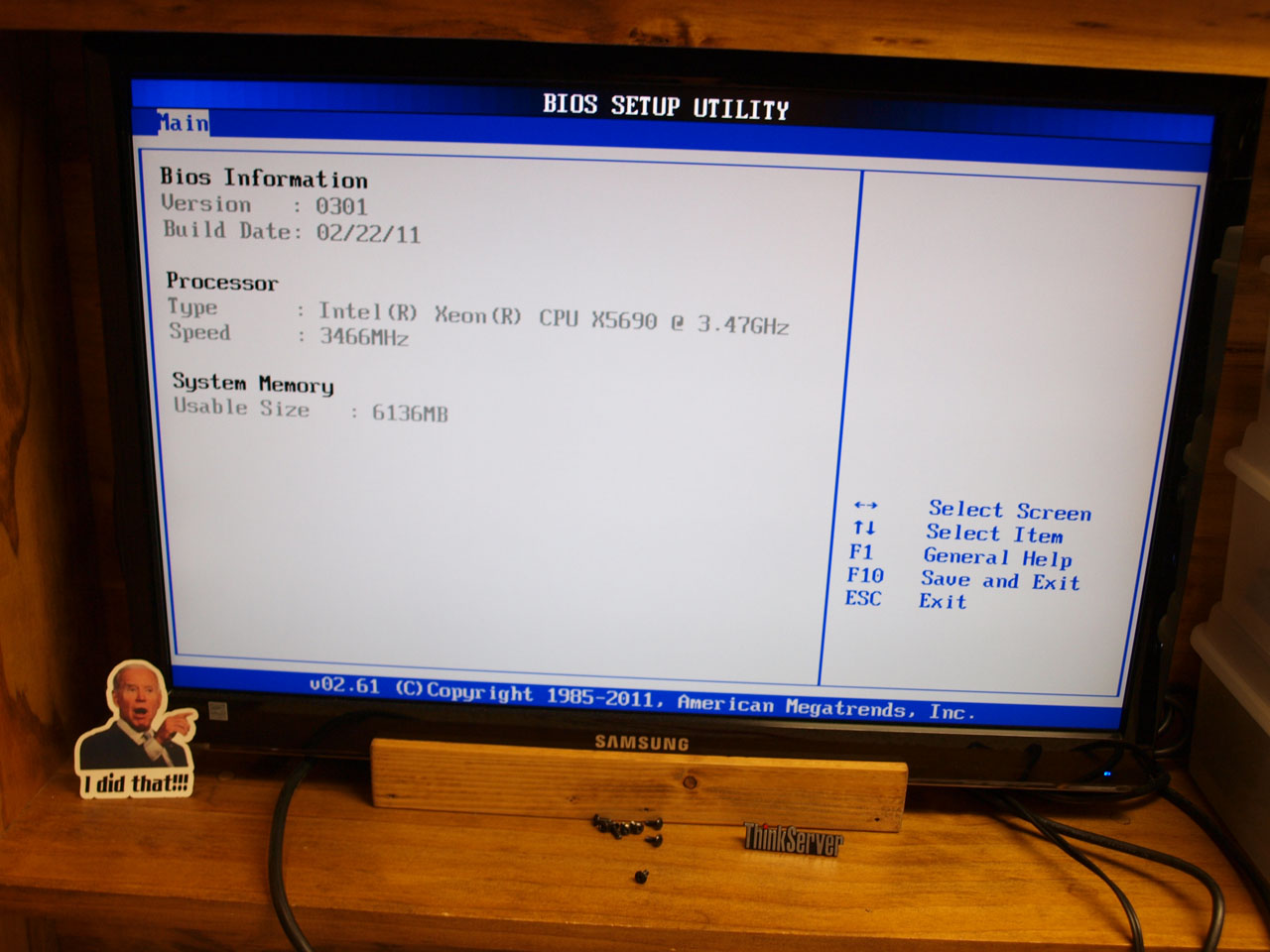

        Just as suspected......PSU was bad. Fan did not quit, board works (can't say I wasn't a little nervous). Opteron 890 test was successful!

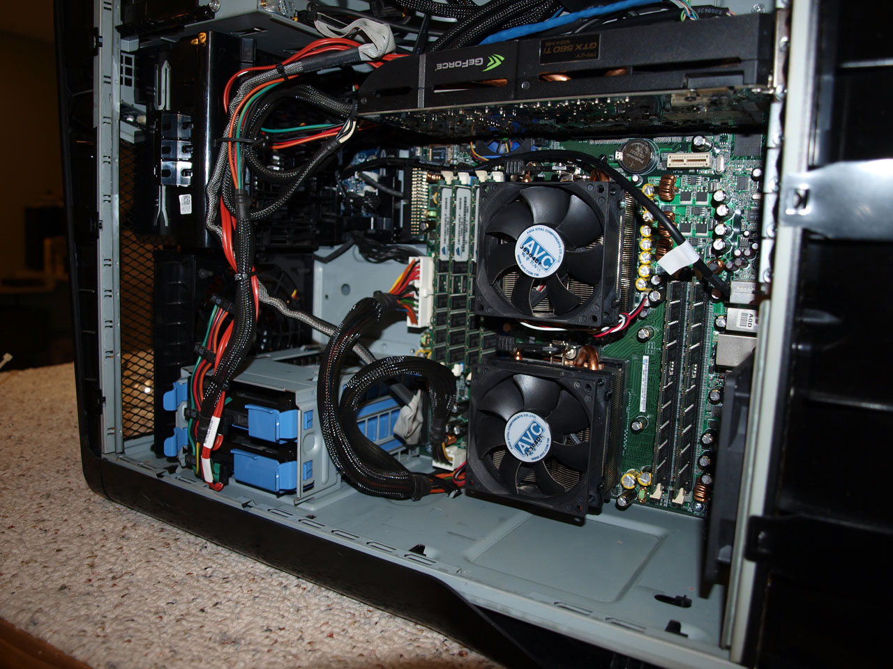

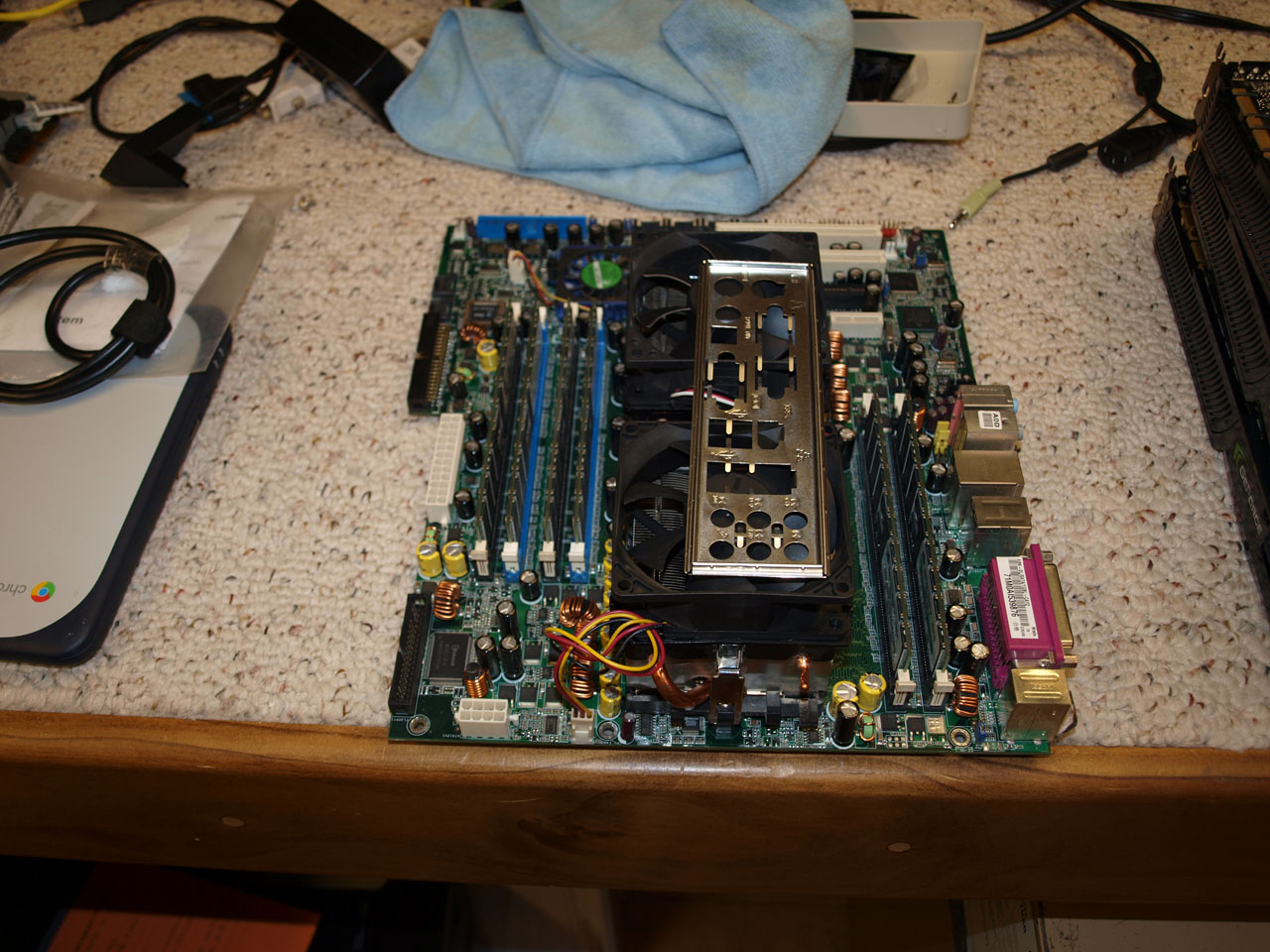

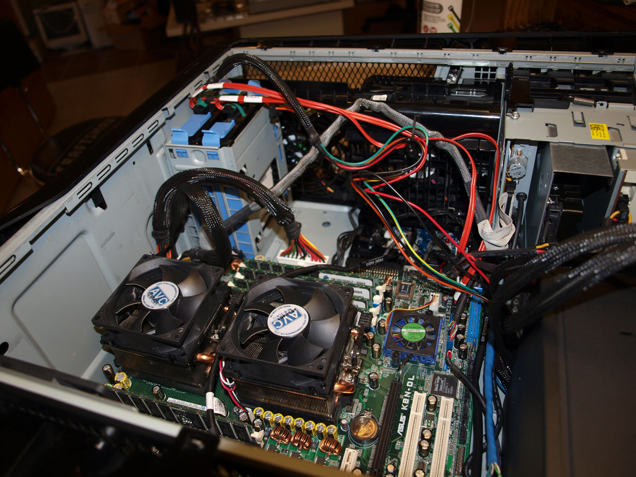

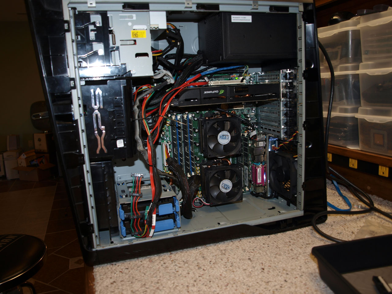

            ...and here we go... As old as this system core is, I find it unlikely it'll ever be pulled to go back to work!! There were a few nice things about this; for one, the 'notch' in the board. Guess what that did? It allowed the original HDD cages to be reinstalled with just a very light shaving of the caddy guide tracks. Modding them for the X8SAX would have required cutting the entire corner out. I'm glad I opted not to do that! Both cages fit and clear the motherboard by a good 2mm.

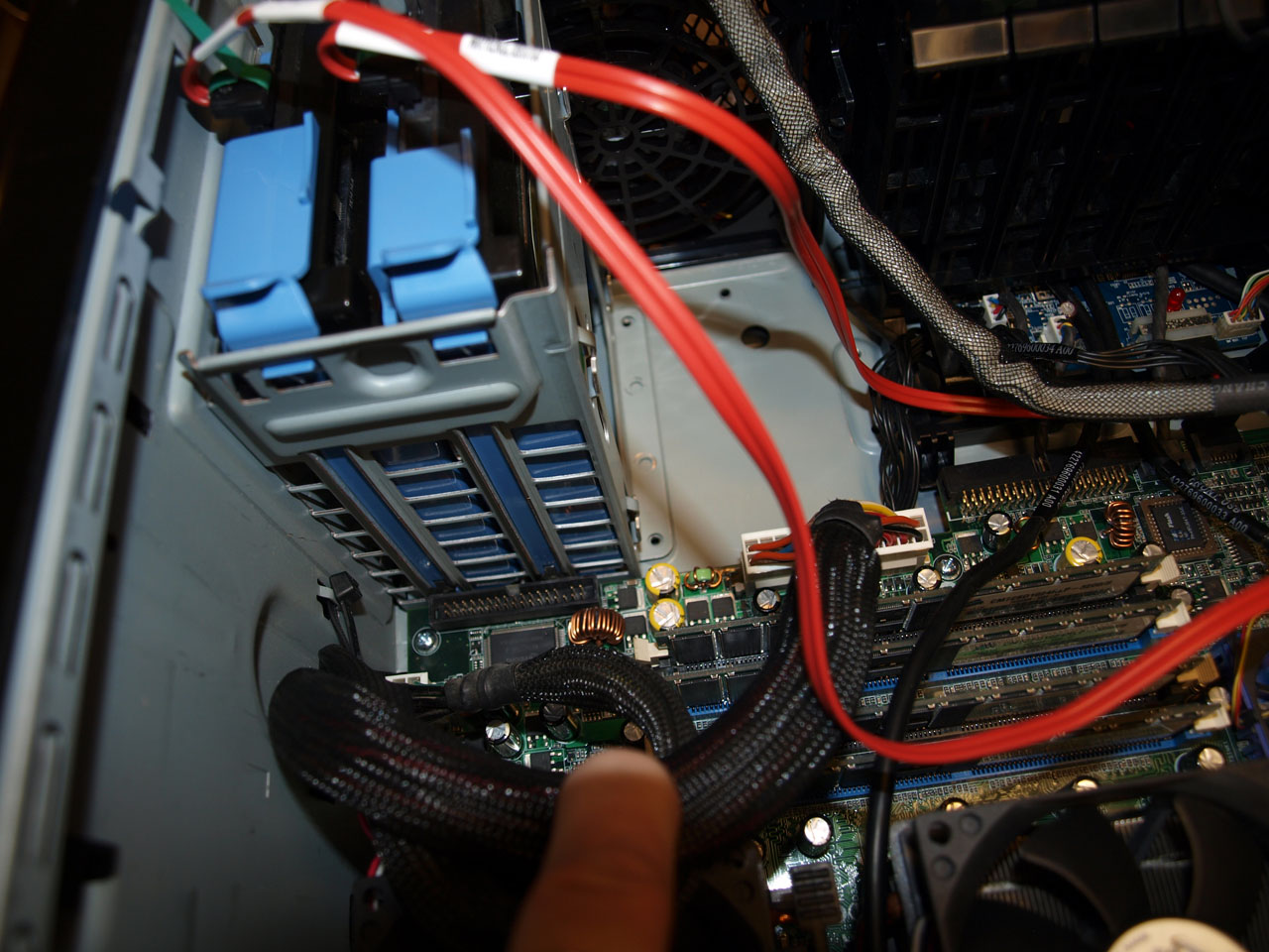

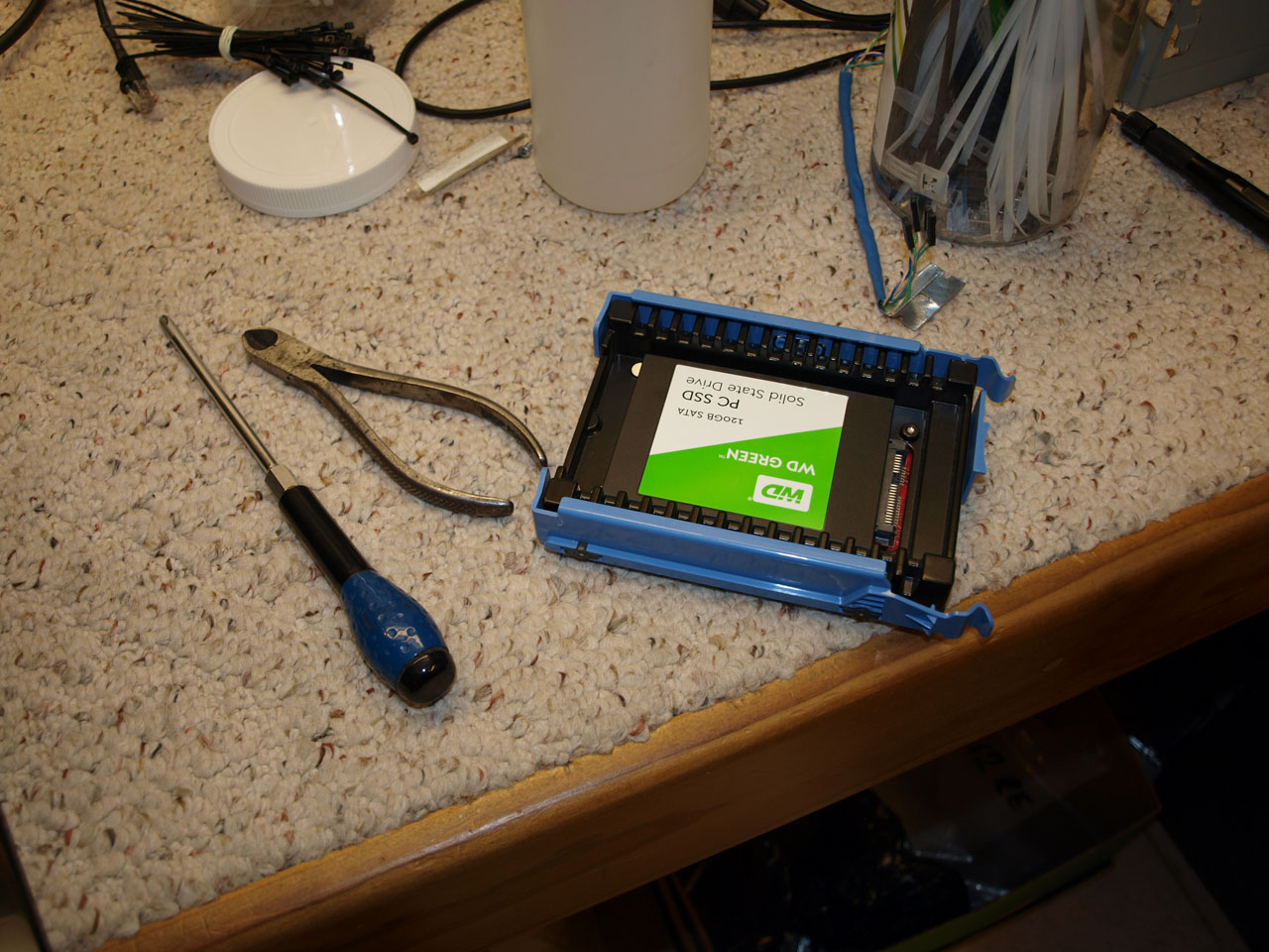

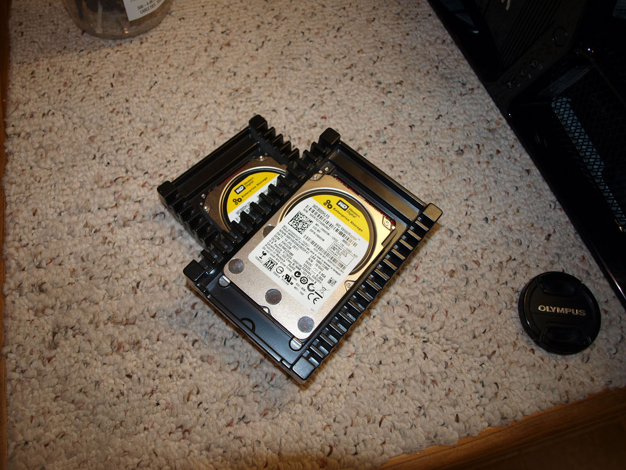

            This opened up an opportunity to make this a little more period-specific. I pulled the 480gb SSD and will use it on something else. I'll instead use my last 2 300gb Velociraptors in a raid1 on the onboard Silicon Image 3114 RAID controller. This controller is not the greatest, but by today's standard it's not like it really matters for what this thing is.
            Yea, nice fit!! Since I am only using 2 drives, I only installed one cage. I'd rather have the air flow than a second empty cage.

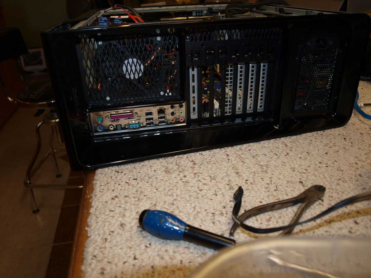

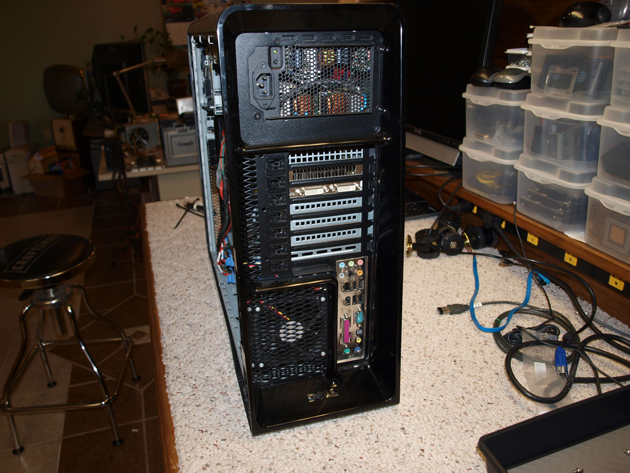

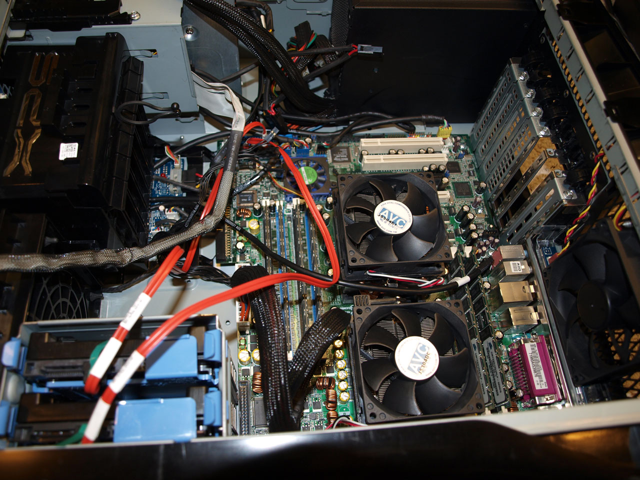

            The usual butt shot, showing off the shiny IO shield...

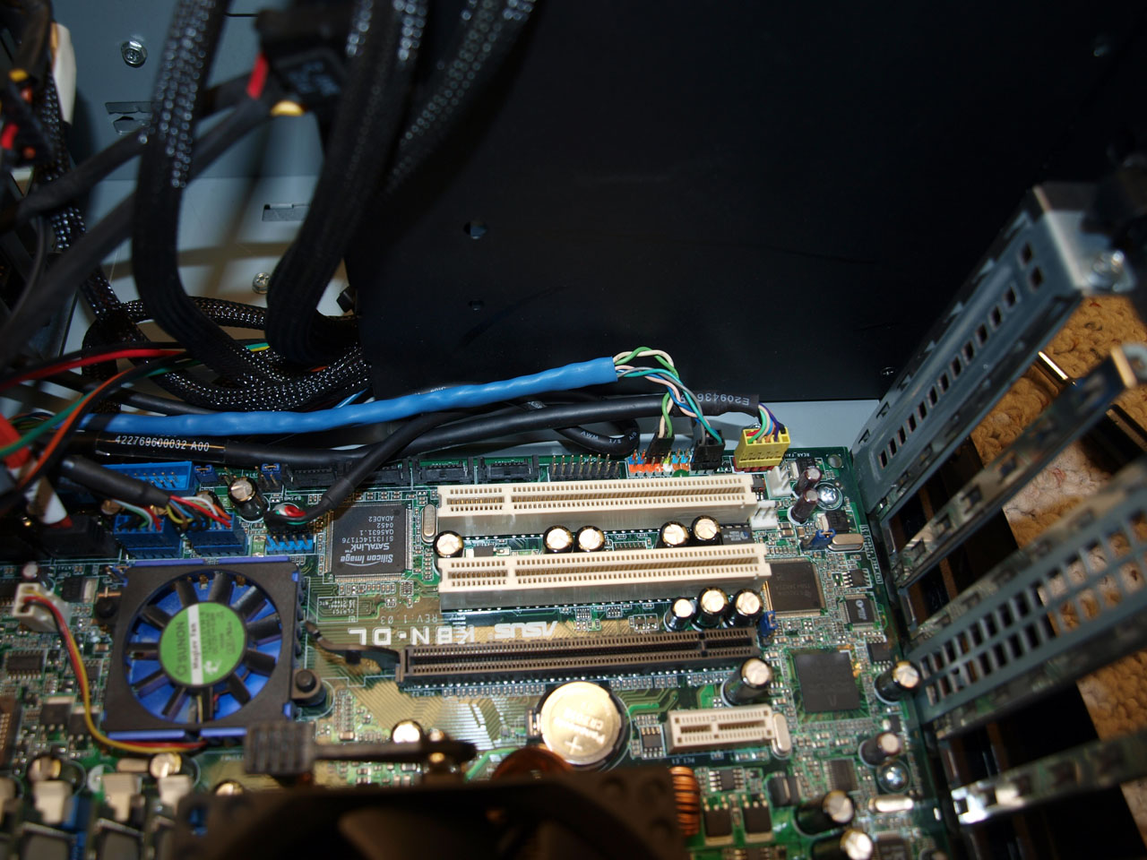

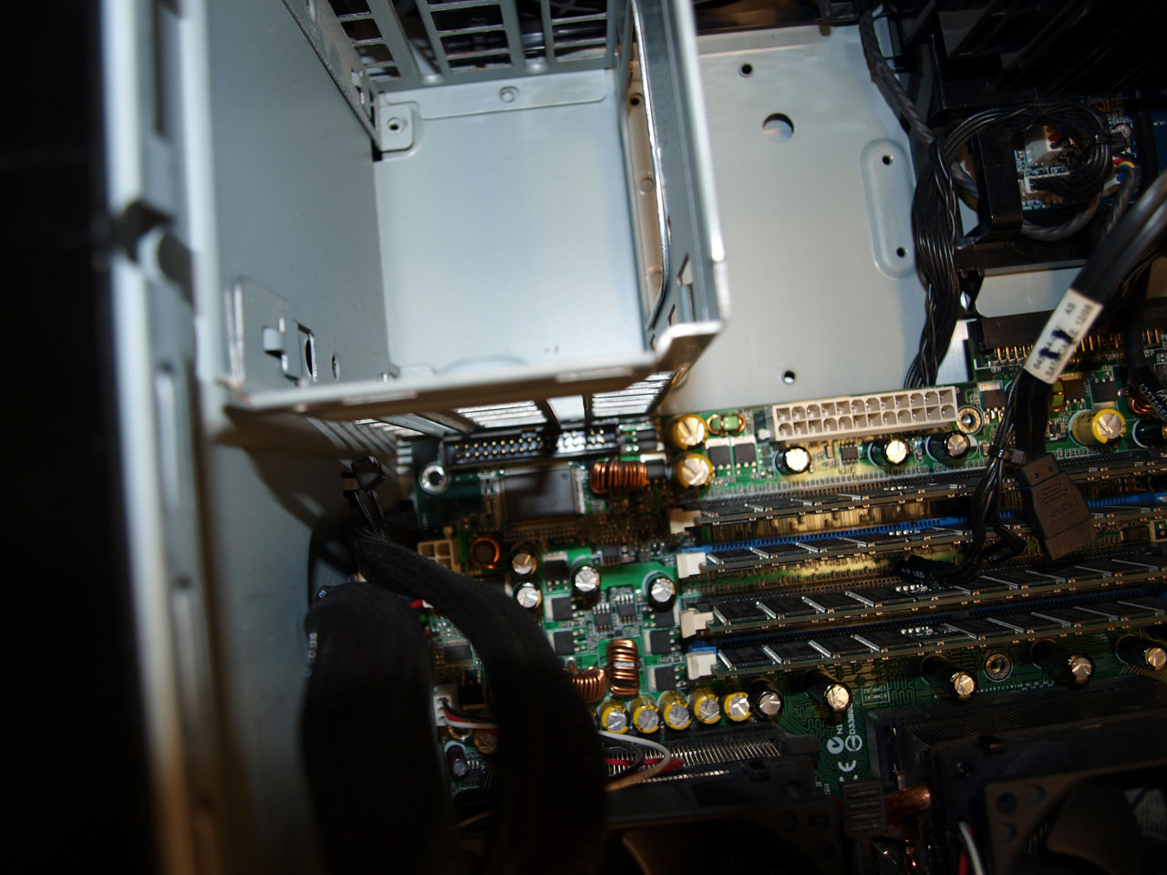

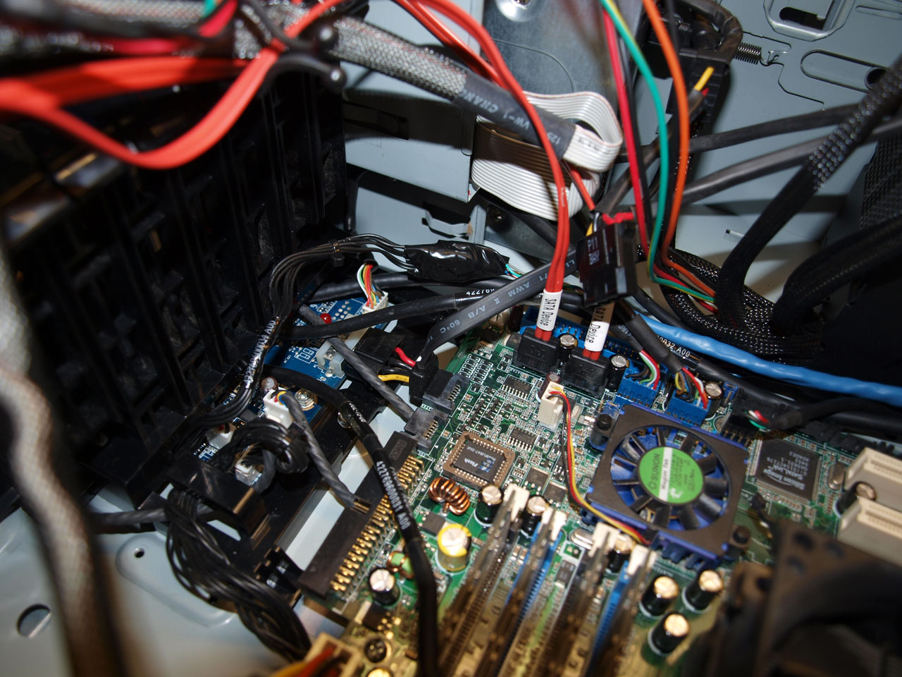

            The front panel connectors are in a really grabastic place on this board, and the stock wires would not reach....I had to fabricate a small extension harness, but not actually cut/modify the originals. I just tinned the ends of the harness and slipped them into the plugs of the original.....and then a little electric tape. The new harness is encased in heatshrink tubing.
            Not the prettiest.....but I can live with it.
            So far so good!

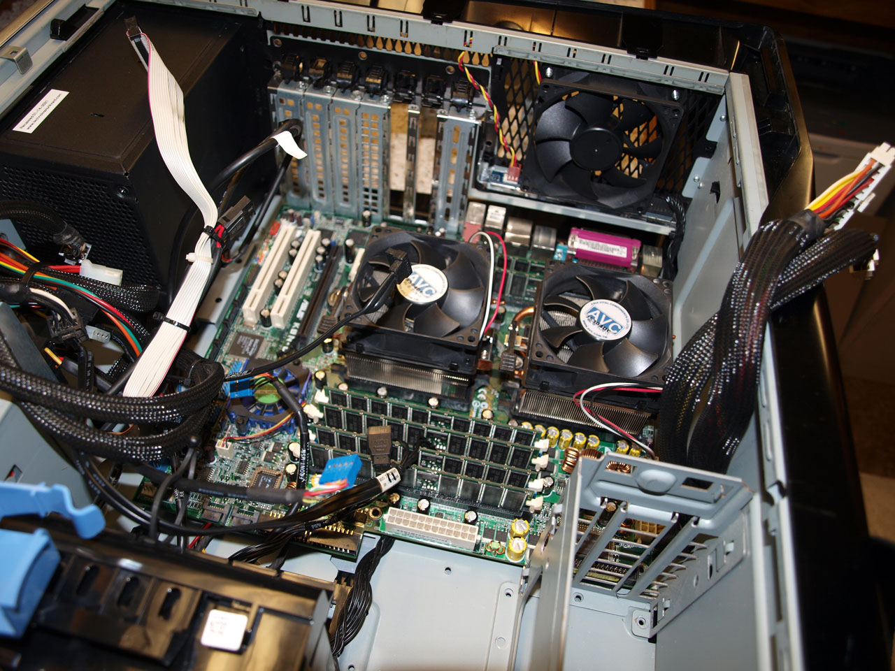

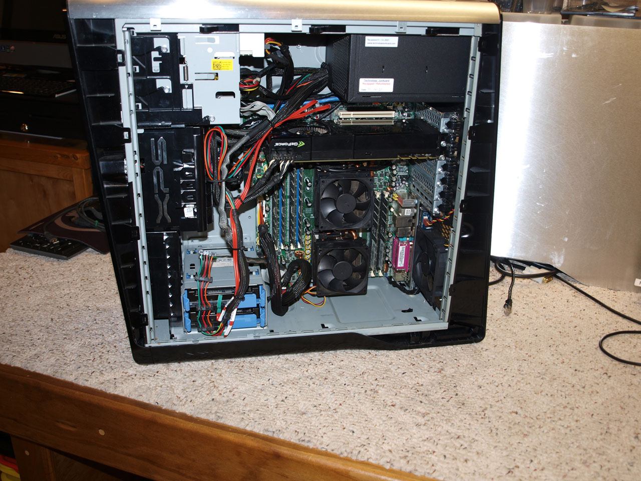

            GPU installed and wires tied up.... The GPU isn't very period-specific for this, it's about 3yrs too late...but I didn't feel like digging through the bin of nicer GPU's for one that would be more period-specific. I have a 9800GT around somewhere, that would have probably been a better choice...but then I'd have to go find it. So for now, it's the 560ti.
            Assembled butt shot.

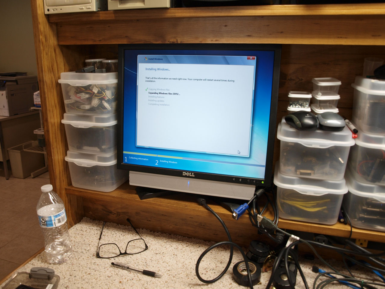

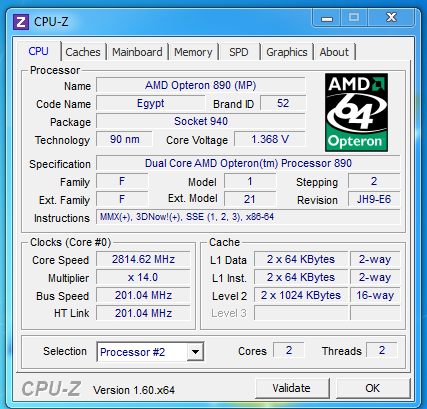

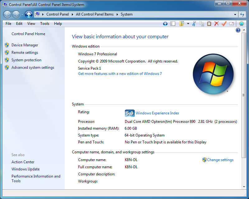

            The usual Win7 install. The RAID controller never had an 'official' raid driver for anything beyond XP.....but me is crafty....
            Compared to the hexcore Westmere that was in here, this is a huge downgrade....but it sure does look good!! ...and it's a lot closer to what the system originally was.
            ...and that's that!!
            A couple screenshots:
            The improvised system specs are:
            Asus K8N-DL
            2x Dual Core Opteron 890's; four cores @ a blistering 2.8GHz!!
            6gb ECC RAM (supports 24gb, but this is what came with it)
            GeForce GTX 560ti 1gb GPU (I may change that at some point)
            2x 300gb Velociraptors in a RAID1
            What a fun build.....especially since I got to do it twice!!

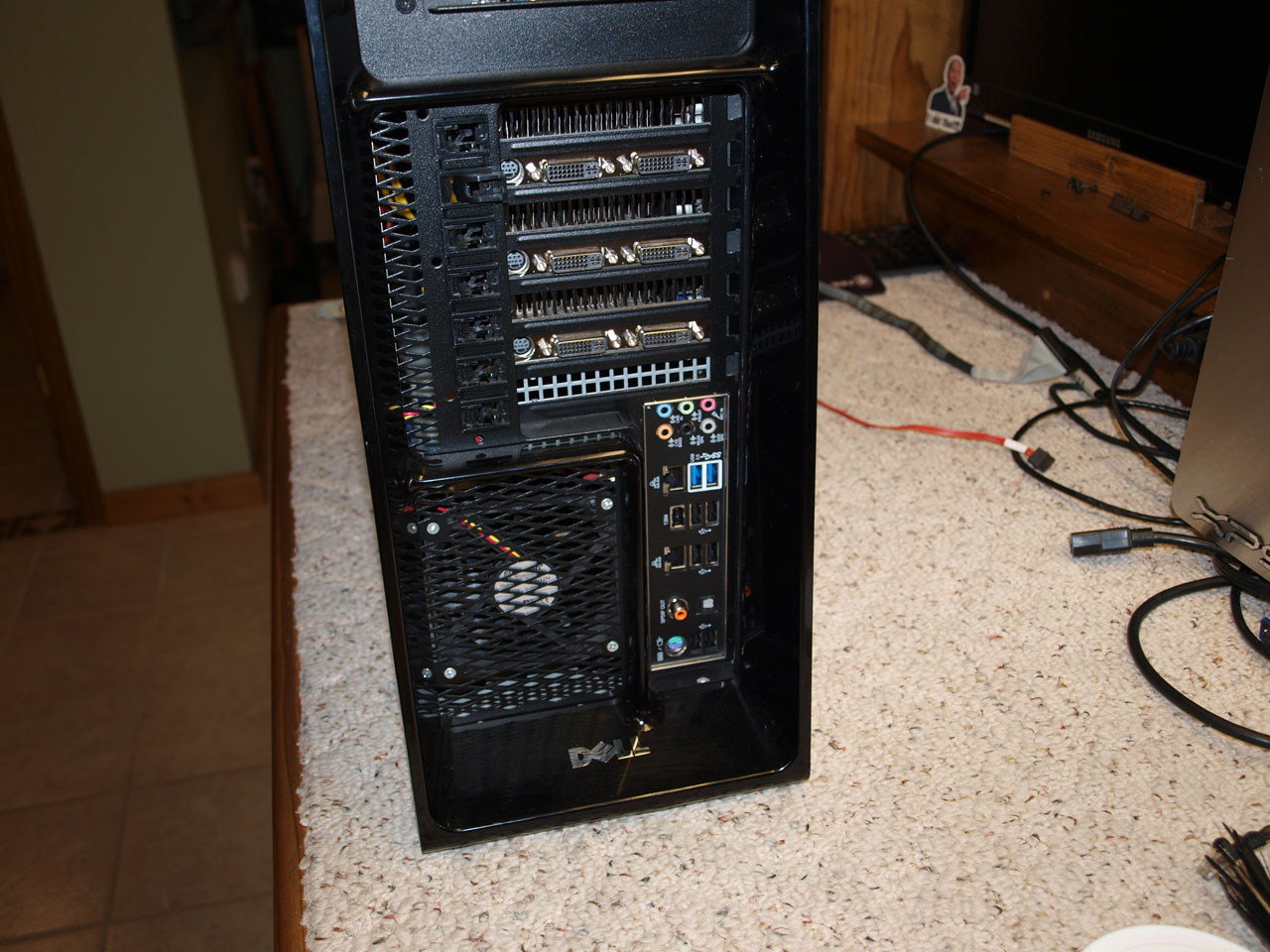

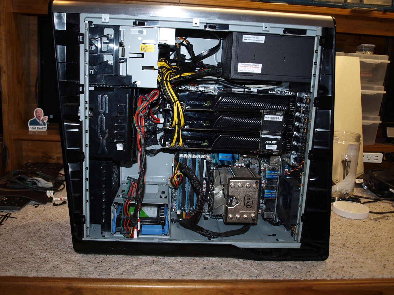

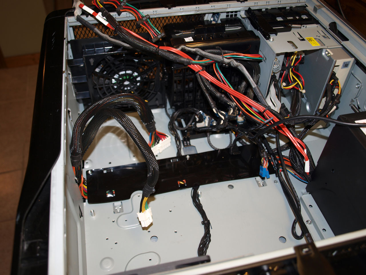

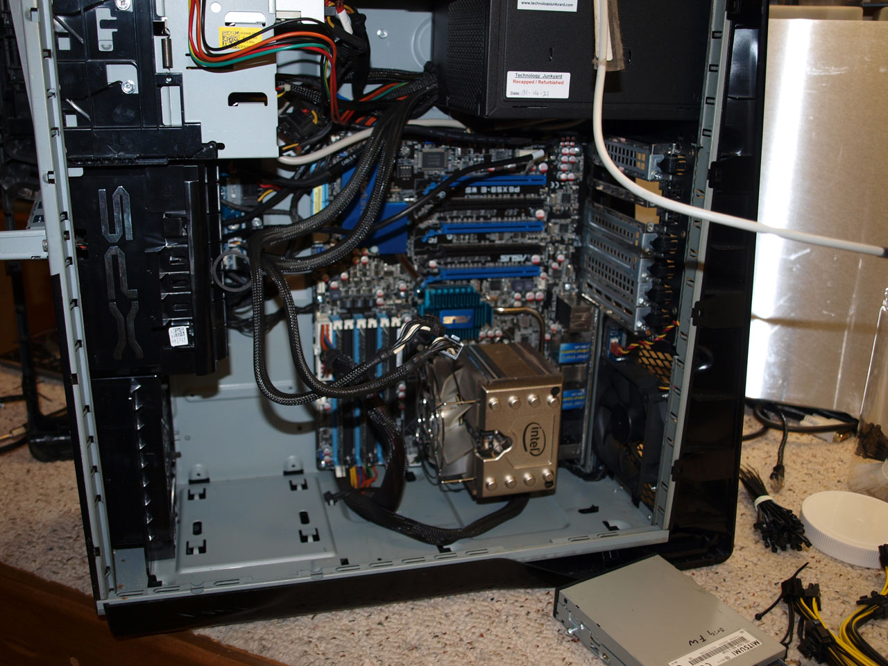

              Well....I get to do this one for a third time!! ....and this time it was a real gas!!! 2 years later almost to the day, I found myself redoing this one. I was never really thrilled with the K8N-DL setup; it wasn't really a good 'fit' for this case...but the X8SAX had to be pulled to go into a production rig and I didn't want to just leave it incomplete; hence the K8N-DL....

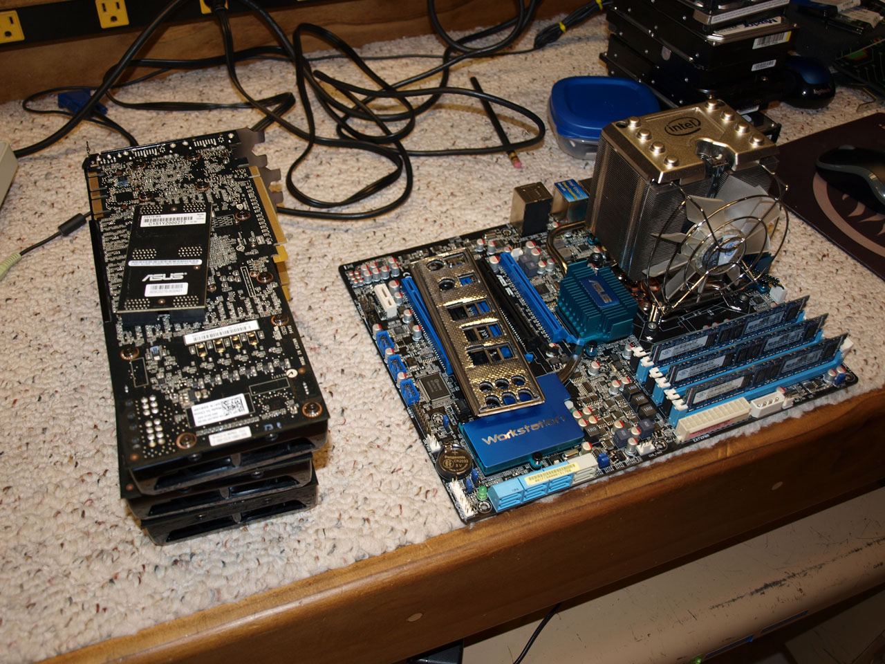

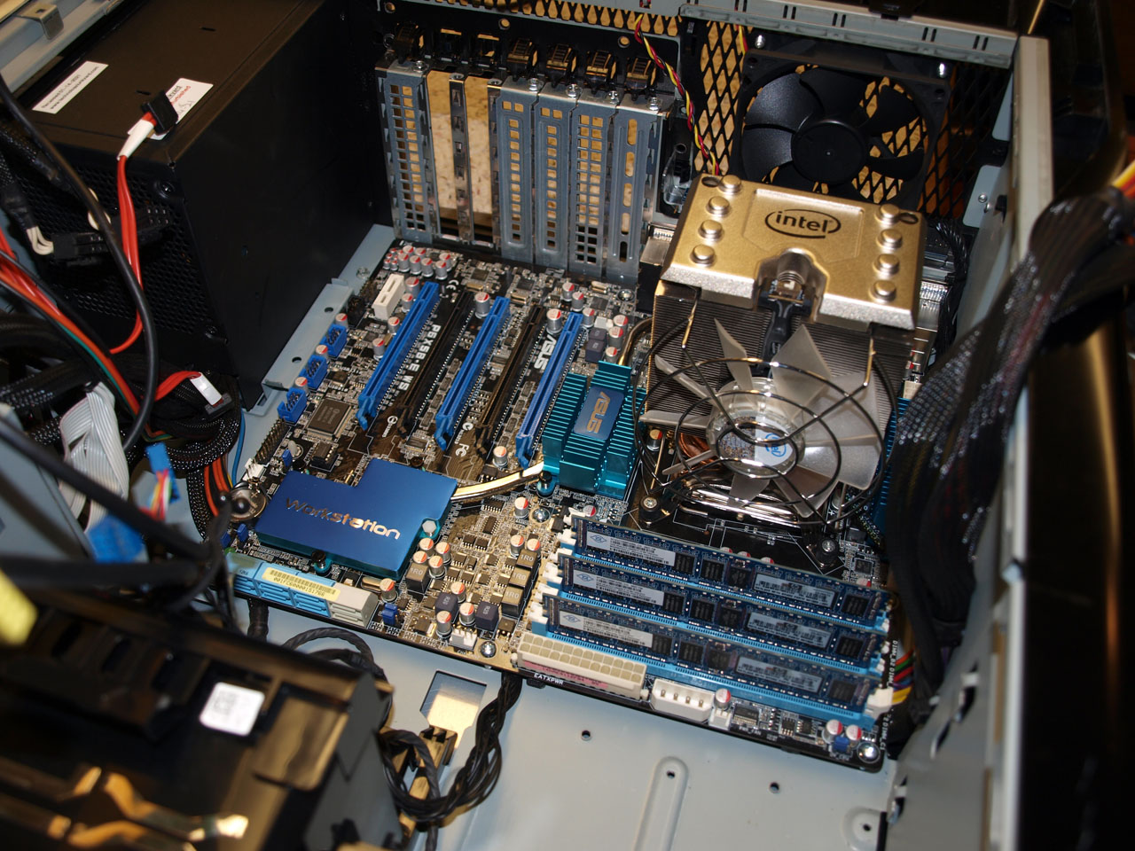

              I came into an Asus P6X58-E WS LGA1366 some time back (forgot I had it actually)... I ran into it the other day and BAM, this case came to mind. I've been pondering for a while what would be a good matching for this case....and this board won by a mile over others I was considering. This board is very rare in that it contains 3x 16x PCIe slots all @ 16x capacity....so I'm sure you can figure out where this is going. These boards are nearly impossible to find now. I tested the board in the oven to verify function, it was good....and here we go!
              First thing that had to be determined was the abilities of the power supply. If you looked at the oven test, you'll see this board is very 3.3v heavy, which I thought odd....I figured it would be a hefty 12v sucker....but its loads on the 12v rail were light. The power supply is a Dell branded 750W with a 30A 3.3v rail, plenty adequate, so onward (see page 1 for an interior view of PSU).

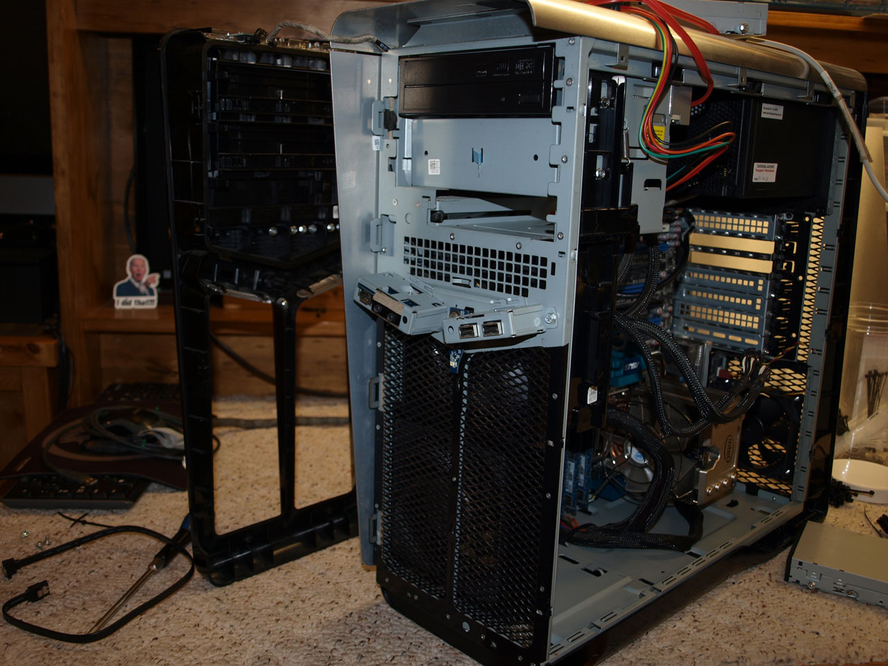

              Case opened....and the K8N-DL Removed.
              The new guts!
              Easy peasy

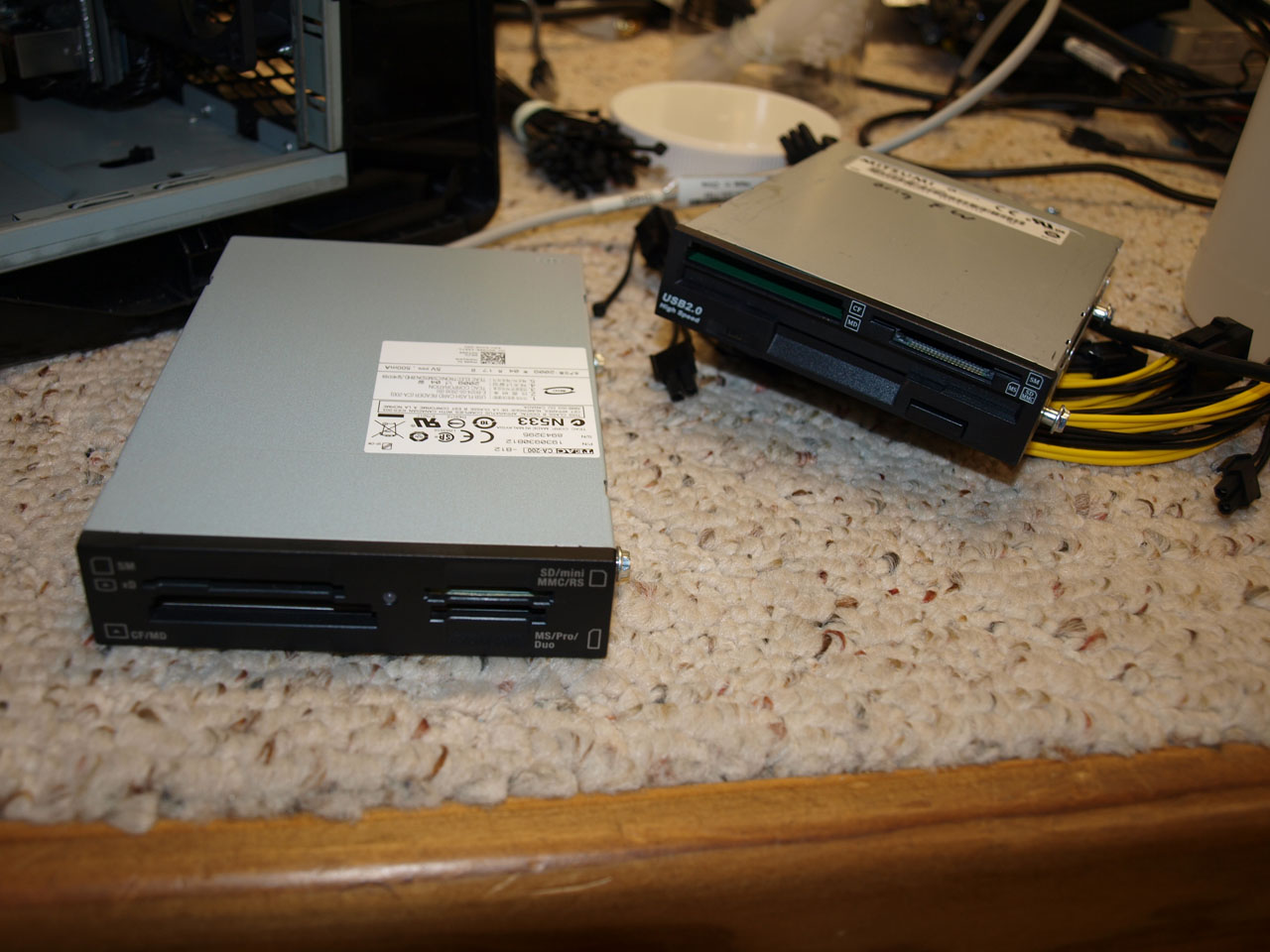

              Had to remove the floppy/card reader combo and replaced it with a Dell branded Teac card reader. This board doesn't have a floppy controller on it....so obviously no need for a floppy drive.

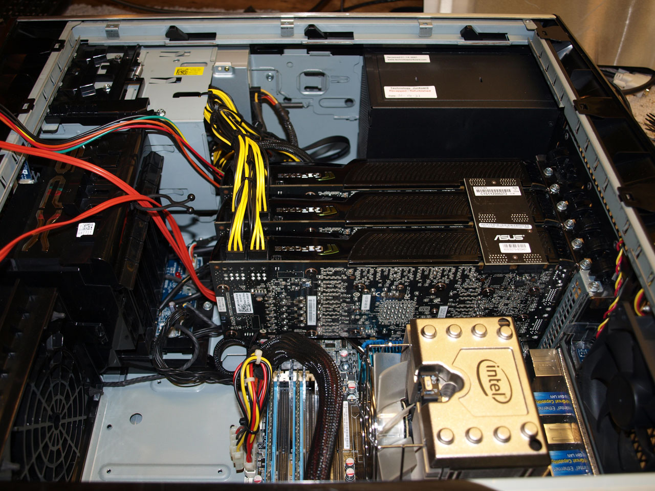

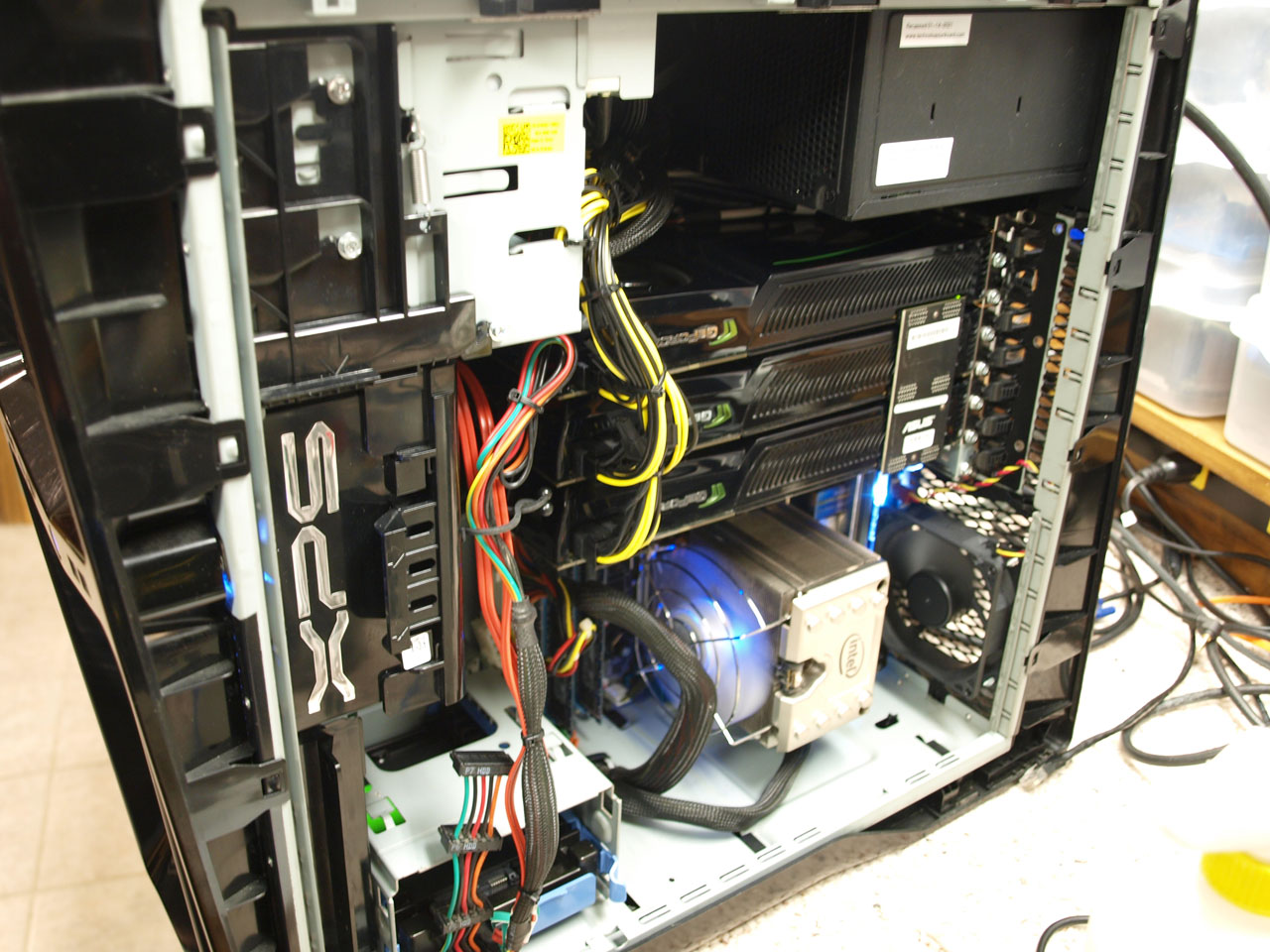

              Now for the fun and why the three 16x slots were so important to this build!!

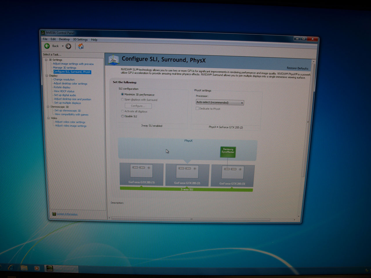

              A 3-way SLI!! Ok ok ok SLI haters, I already know... SLI is a thing of the past by modern standards, but all this hardware is ~2010 era...just a soon-to-be neat piece of computing history. Boards capable of a 3-way SLI with 3x full speed 16x slots are not easy to find. The GPU's are GTX285's, all matching firmwares....a very good pairing for this board & CPU.
              120gb SSD.
              Now that's a butt shot!!
              Partially tidied up. I have 24gb of RAM coming for it, I'll put the finishing touches on it when it arrives.

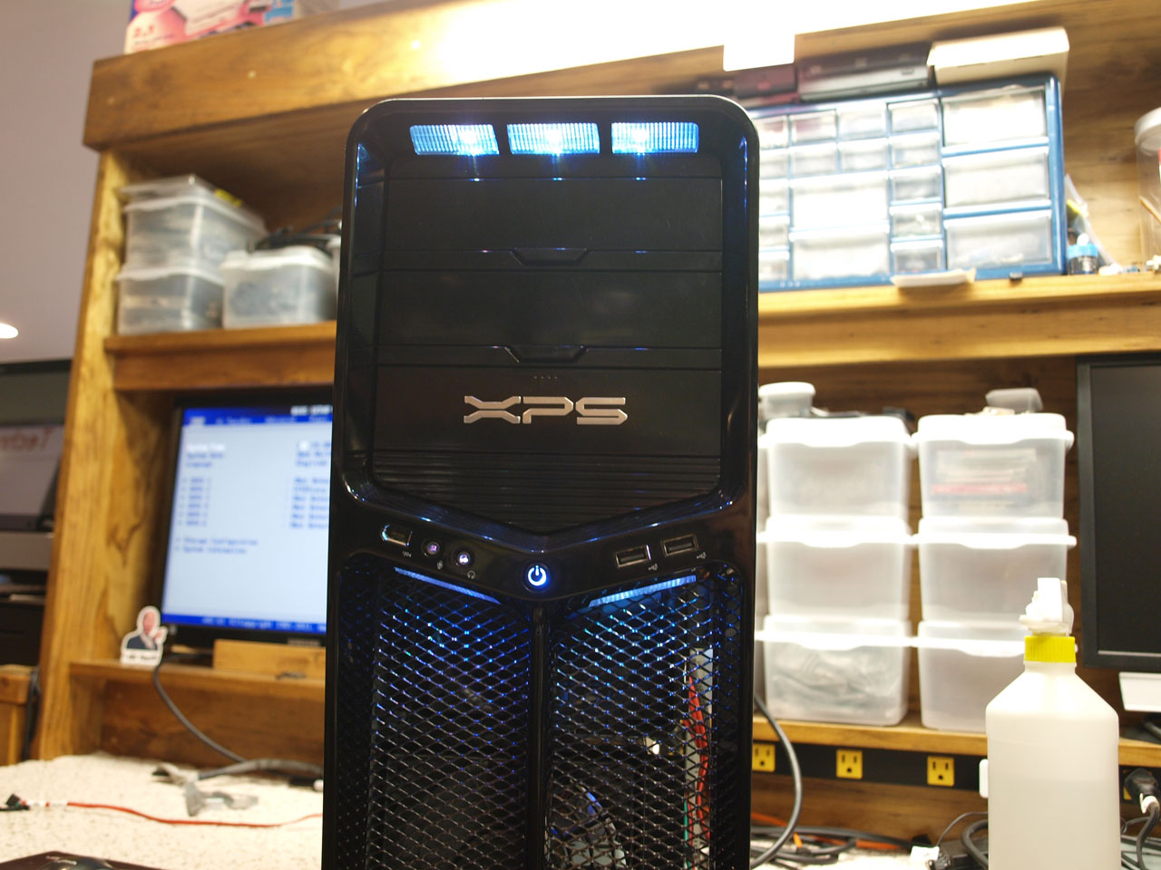

              The lighting is still cool!!

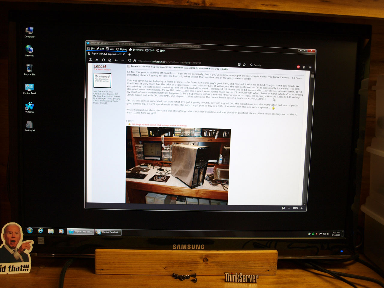

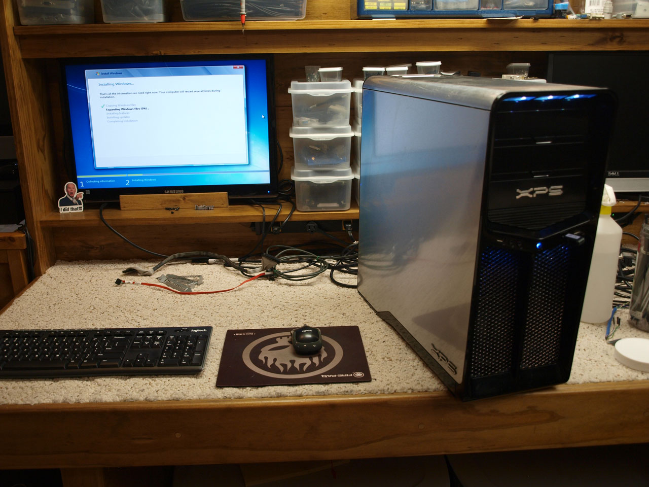

              POST'ed.
              Installing Win7.
              SLI is happy!
              ...and here we are...the version 3 of the goat barn find!!

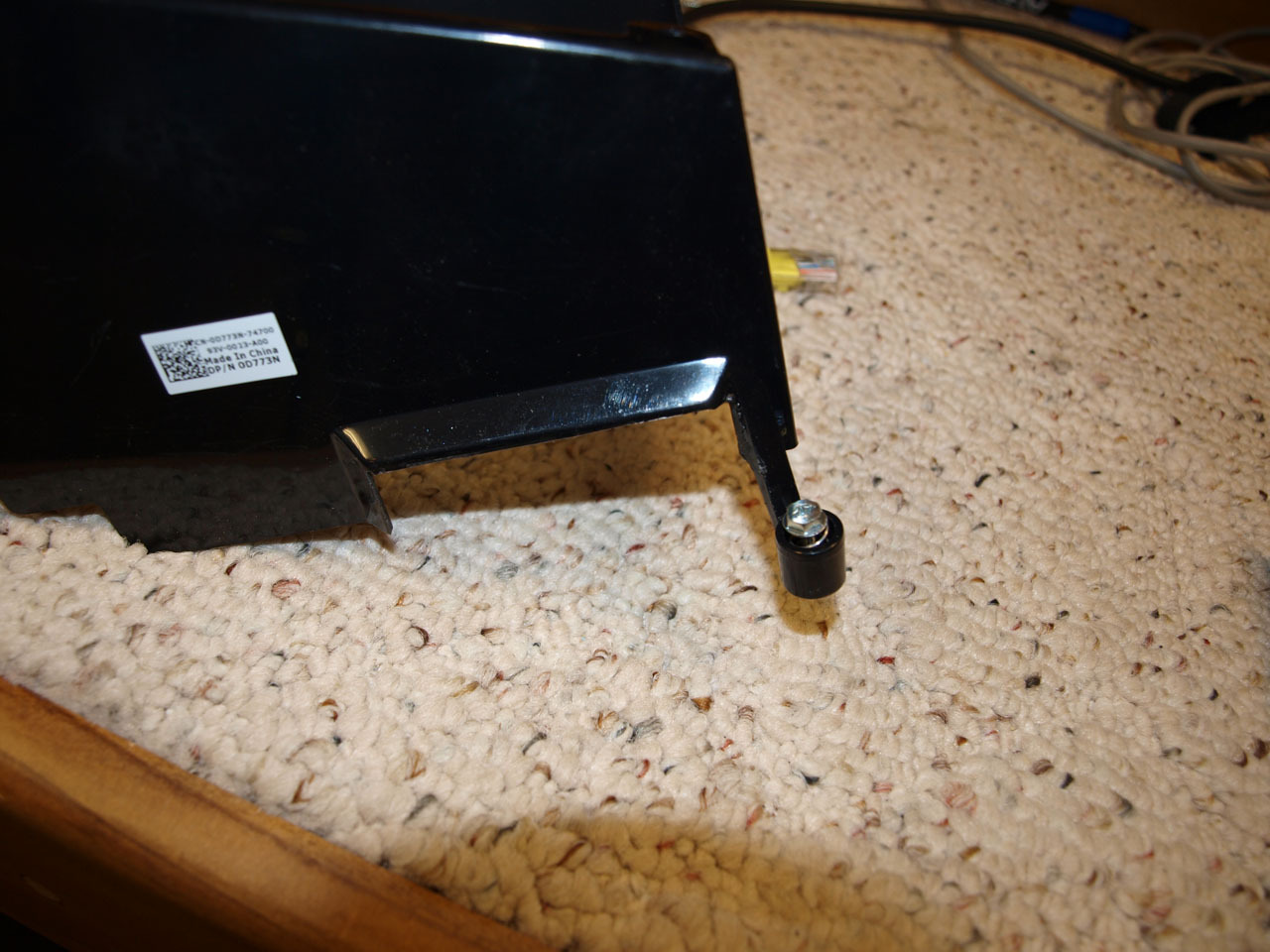

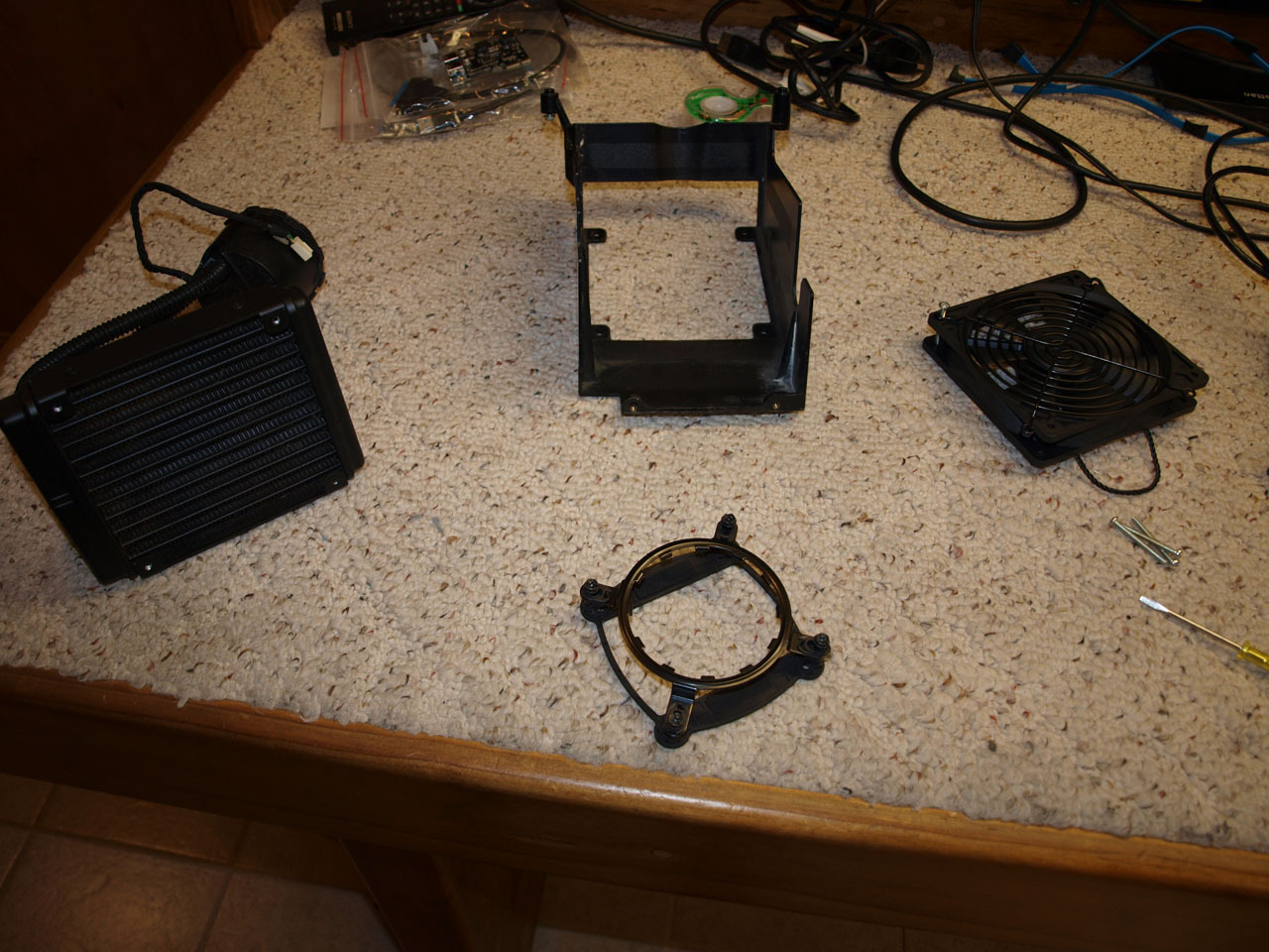

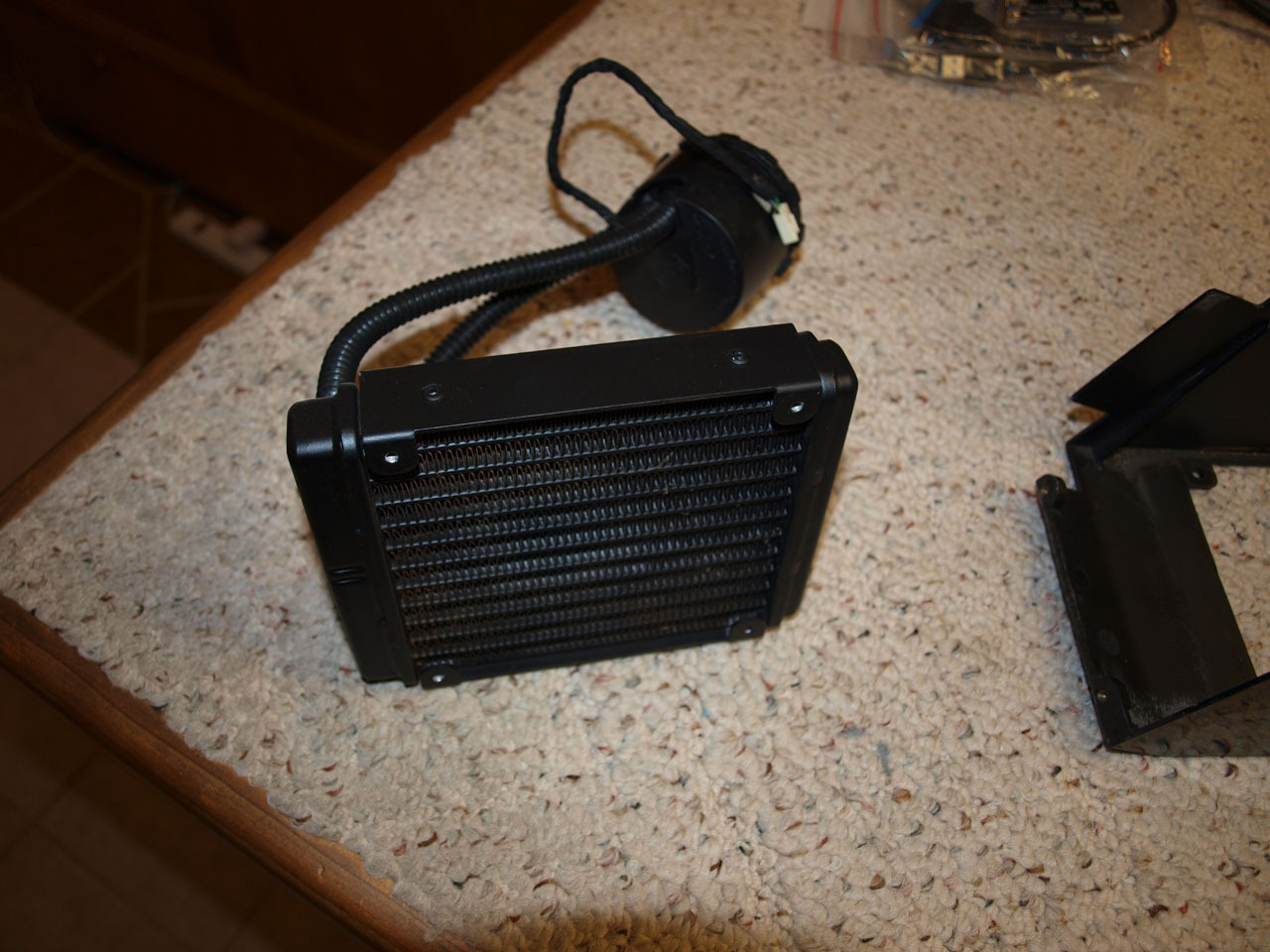

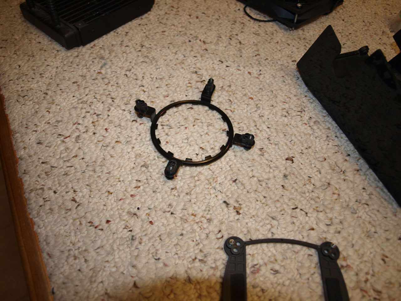

                Ok, this one back in the news *again*!! ...but no system core swap this time. A few weeks ago, I was given an identical tower that had a factory Dell liquid cooling system in it. I never knew this was even an option for these, and thus it piqued my interest for this build....and I started looking for another of these coolers. Not easy to find with the Dell shroud that goes around it & proprietary mounts....but I finally found one complete for $30 shipped. There was a problem though, this system is now a LGA1366; not the LGA775 or AM2 as they were originally intended, so the cooling block brackets were not compatible. I did some more digging and found that the liquid blocks on these are actually made by 'ASETEK'.....and did even more digging and found *ONE* bracket for the LGA1366 socket that would fit this water block without having to buy an entire other cooler which may not fit the shroud!! Talk about a stroke of luck!!
                Click image for larger version  Name:	630i_0997.jpg Views:	0 Size:	313.9 KB ID:	3256053
                Click image for larger version  Name:	630i_0999.jpg Views:	0 Size:	234.7 KB ID:	3256054
                Click image for larger version  Name:	630i_1000.jpg Views:	0 Size:	285.6 KB ID:	3256055

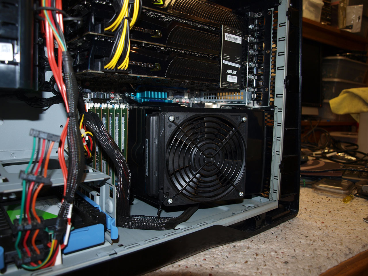

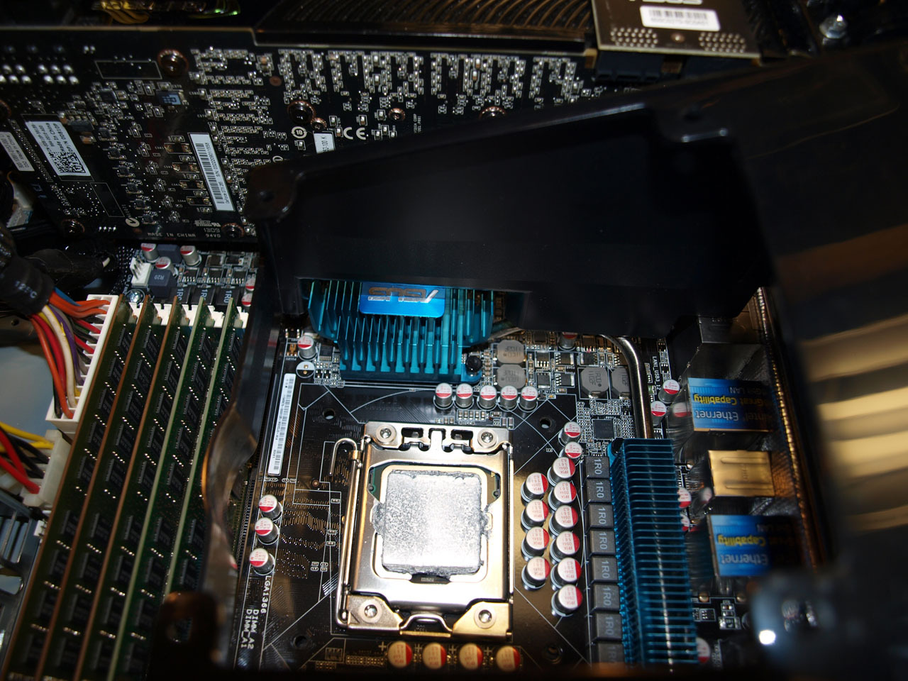

                I had to make one modification to the shroud; as the northbridge on this board wasn't in the same location as the original.....just had to trim a little off to allow the heatsink to fit around the shroud.
                Click image for larger version  Name:	630i_1002.jpg Views:	0 Size:	219.9 KB ID:	3256056
                Very nice fit now!! The CPU is in about the same location as the one on the original board. The only real point of interference was the screwdown peg and the CPU fan header. They were VERY close....but cleared. Touching, but cleared.
                Click image for larger version  Name:	630i_1003.jpg Views:	0 Size:	329.0 KB ID:	3256057.
                Installed....like it was born there!!!!!! Very happy with the outcome; making this silly build even more unusual.
                Click image for larger version  Name:	630i_1005.jpg Views:	0 Size:	322.8 KB ID:	3256058

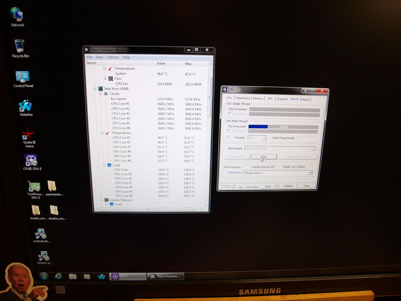

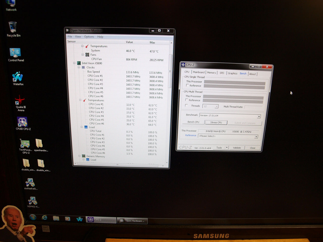

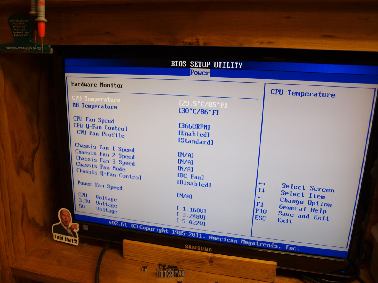

                CPU Temps at first powerup.... 29*C
                Click image for larger version  Name:	630i_1006.jpg Views:	0 Size:	228.3 KB ID:	3256059
                Under no load in windows.
                Click image for larger version  Name:	630i_1012.jpg Views:	0 Size:	181.9 KB ID:	3256060
                Under CPU-Z's stress test loads:
                Click image for larger version  Name:	630i_1011.jpg Views:	0 Size:	174.3 KB ID:	3256061
                Stupid me didn't take any pics of the same tests with the air cooler, and I wasn't swapping them back to retest it....I don't like bending those lines around any more than I already had to. The liquid cooler kept it an average of 10~15*C cooler at idle and under load than the air cooler did. This CPU has a TDP of 130W. Nice finishing touch for this weird one!
