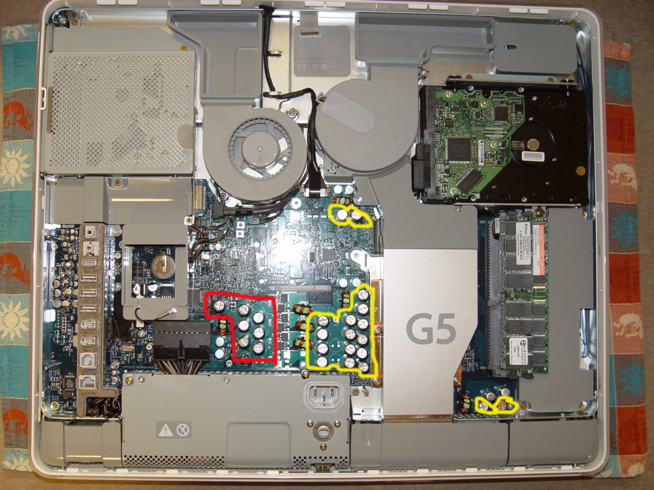

                  sheldon provided a list of the caps and their positions that are written on the board (many thanks sheldon)
                  "iMac G5 20"" 1.8 GHz Model"
                  Left to Right Through-hole Electrolytic Caps
                  C1109 1800 uF 6.3v
                  C3411 1000 uF 16v
                  C3311 1000 uF 16v
                  C1008 1800 uF 6.3v
                  C3422 1000 uF 16v
                  C3412 1000 uF 16v
                  C3321 1000 uF 16v
                  C3427 1800 uF 6.3v
                  C3418 1800 uF 6.3v
                  C3328 1800 uF 6.3v
                  C3320 1800 uF 6.3v
                  C3474 1800 uF 6.3v
                  C3317 1800 uF 6.3v
                  C3472 1800 uF 6.3v
                  C3332 1800 uF 6.3v
                  C3475 1800 uF 6.3v
                  C???? 1800 uF 6.3v
                  C3473 1800 uF 6.3v
                  C3333 1800 uF 6.3v
                  C2208 1800 uF 6.3v
                  C2209 1800 uF 6.3v
                  C5009 1800 uF 6.3v
                  C5008 1800 uF 6.3v
                  C908 1800 uF 6.3v
                  C909 1800 uF 6.3v
                  • Kiton
                    • Dec 2005
                    • 7
                    #29
                    Re: pre-emptive cap replacement
                    could you be more specific?
                    • willawake
                      Super Modulator
                      • Nov 2003
                      • 8457
                      • Greece
                      #30
                      The list above shows which capacitor value corresponds to what is written on the board next to each capacitor. if you check the photo above, you will see what the writing on the board looks like.
                      I do not have enough photos to be certain about all the capacitors.
                      in the below photograph in yellow is shown what i see from the photos to be the 1800s. In red is an area with 7 capacitors. of those 7 capacitors i believe that 2 are 1800 and the other 5 are 1000.
                      these values should correspond to those 7 capacitors
                      C1109 1800 uF 6.3v
                      C3411 1000 uF 16v
                      C3311 1000 uF 16v
                      C1008 1800 uF 6.3v
                      C3422 1000 uF 16v
                      C3412 1000 uF 16v
                      C3321 1000 uF 16v
                      if the list does not agree with your board then do not proceed with the job because if you put a 6.3 at a position where a 16v should be it that capacitor will not last long.
                      i will ask sheldon to come by and check what i have said.

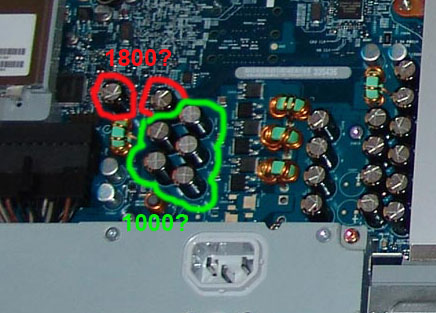

                      • Kiton
                        • Dec 2005
                        • 7
                        #31
                        Thanks! Just need to be shure that he didn“t do a typo.
                        My Imac is my baby
                        • willawake
                          Super Modulator
                          • Nov 2003
                          • 8457
                          • Greece
                          #32
                          this photo looks good. i think the 1000s are the X capacitors. if this agrees with Sheldon's list then go ahead.
                          • stokessd
                            • Aug 2005
                            • 13
                            #33
                            I have more pics here:
                            http://www.quadesl.com/albums/imac_cap_pics/
                            I had a problem locating short caps that would fit into the iMac chassis. I had one cap that was bulging and I called apple and they came out and replaced my power supply and midplane. No fuss no muss. Came right to my house.
                            So I never did a cap replacement. If you do replace caps yourself be careful of the height of them, particularly the ones near the middle by the stand.
                            Sheldon
