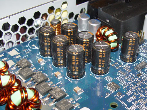

          looks like they supply the newer boards with Rubycon MCZ.
          most important is to replace all Nichicon HN or HM series. that is the problem. those boards look like they have quite a few.

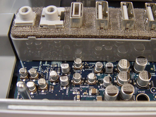

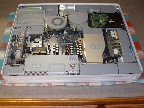

            OK, here's what I'm working with:
            I've got a bunch of Nichicon HN(M) caps, 25 of them. The good news is that none of them look to be bad. The bad news is that they probably will be. I pulled the lid of the power supply as well, and it's full of a raft of different questionable caps, although I can't tell exactly what each type is, but there are like 5 different brands in there. The big power line ones are Nippon Chemi-con 200v 560 uF ones that appear to be fine.
            So I'm now in a bit of a dilemma, I know those caps could be bad, but are showing no signs of problems. So do I pull them now, or wait a while? If the computer blows up in 6 months, I'll get it fixed, but could be without one of my machines (my wife's primary machine) for what could be several weeks. If I fix it now, it will cost me a little bit of money and time, but I will have piece of mind.
            Anyway, here's some photos:
            http://www.quadesl.com/albums/imac_c...s/DSC01195.jpg
            http://www.quadesl.com/albums/imac_c...s/DSC01196.jpg
            http://www.quadesl.com/albums/imac_c...s/DSC01197.jpg
            http://www.quadesl.com/albums/imac_c...s/DSC01198.jpg
            http://www.quadesl.com/albums/imac_c...s/DSC01199.jpg
            http://www.quadesl.com/albums/imac_c...s/DSC01200.jpg
            http://www.quadesl.com/albums/imac_c...s/DSC01201.jpg
            http://www.quadesl.com/albums/imac_c...s/DSC01202.jpg
            http://www.quadesl.com/albums/imac_c...s/DSC01203.jpg
            http://www.quadesl.com/albums/imac_c...s/DSC01204.jpg
            Here's a list of the caps and their values:
            http://www.quadesl.com/albums/imac_c...c_cap_list.txt

              Re: pre-emptive cap replacement
              here are a few smaller versions of Sheldon's pics for those too lazy to click.

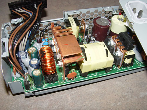

                regarding the psu, looks like normal choices of caps, a few ltec, a few teapo. most psus have crap caps in them nowadays. because it is proprietary can recap and save unit replacement money in the long run. i have a few psus running for years with similar caps. others havent been so lucky.
                anyway i want you to make up your own mind about the recapping. those nichicons should last 6months - 1 year most
                      i would do a premptive strike now.
                      good news is i have not seen damage beyond caps in the g5 boards.
                      i have done 50 of them so far for a client who cannot afford a box dieing during an important project.
                      the first ones were the ones that died with instability, video artifacts, then failure to post.they smelled bad enough that the fire dept was called as they could not pinpoint the source of the stink.
                      they were a real mess inside.
                      had a few that i had to use carb cleaner to get the glop off the board.
                      all survived.

                              I haven't seen any talk of the metal cased surface mount caps being bad as well. Do the folks who make crap through-hole shrink-wrap caps not make the surface mount ones?
                              Sheldon
                                btw the fm are smt.
                                there were lots of bad smt caps a few years ago.funny i just recapped a panasonic backup camera that every smt lytic was open.i replaced them with tantalums.

                                  So should I be concerned about the smt lytics in the iMac? I didn't order any of those
                                    btw the fm are smt.
                                    they are also radial lead.
                                    is that what you ordered Sheldon?
                                    we have seen probs with those silver casing caps on occasion. the silver ones on your board are 220, 100uf and lower. i wouldnt worry about them they are small. the silver and blue ones are 390uf 6.3 also small. it is also difficult to identify who made them. wouldnt worry anyway
                                    • stokessd
                                      • Aug 2005
                                      • 13
                                      Yes, Those are the caps I ordered. They are most certainly through hole.
                                      Thanks for the feedback on the little caps.
