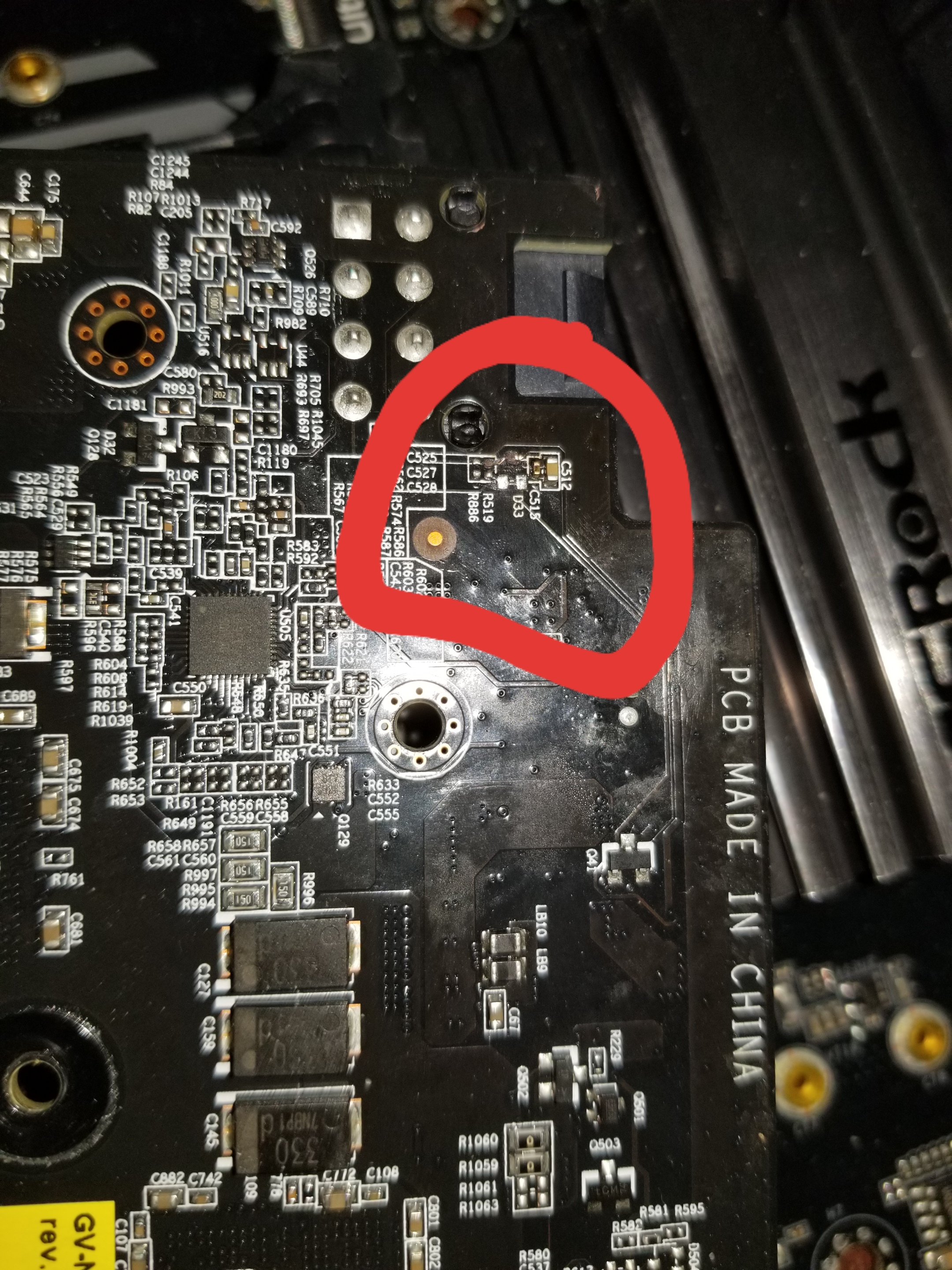

GPU Gigabyte gtx 1080 mini shorted diode
  • ss45
    • Jun 2019
    • 119
    • Brazil
    GPU Gigabyte gtx 1080 mini shorted diode
    hi folks. i have gpu with shorted here. sorry if i posted i the wrong sub..
    d33 was shorted and has been removed. if anybody has one at hand and has the free time, would it be too much trouble to take measurement of the diode. of course i can make makeshift diode using 2 discrete diodes, but i cant figure out which direction cathode and anode. searching online with sot 23 diode as keyword giving several different pinouts. i am afraid trying each possibilities one by one might damage the card further....
    so if anyone willing to help, i would be grateful
