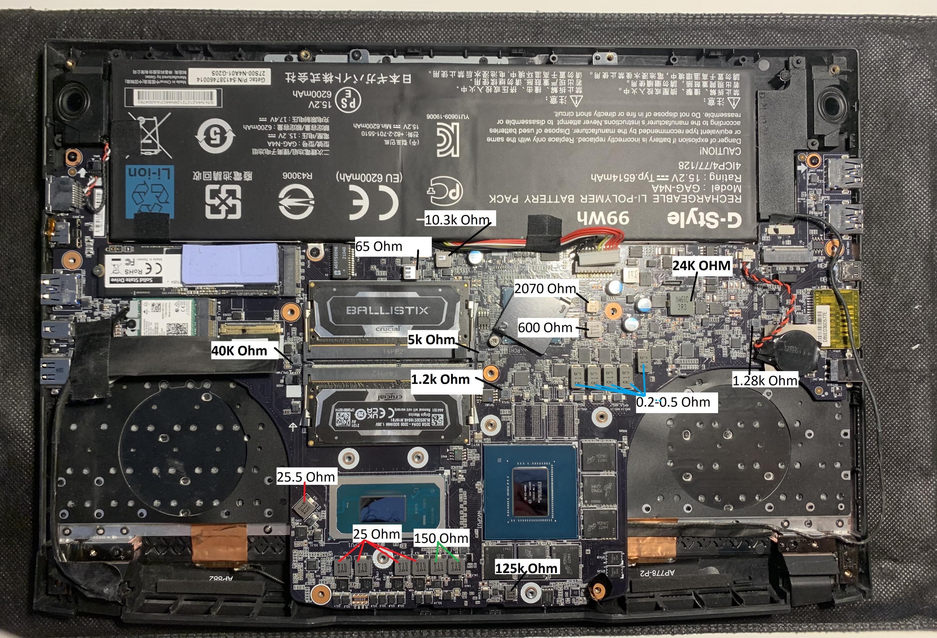

    On the adapter DC OUTPUT is 19.5v 11.8A.It draws 19.5v 4.5A power with battery and ac adapter.
    Keyboard lights and fans work.
    I plugged out wifi card, ram and ssd, it doesnt related with this ones.
    [IMG][/IMG]
    RED BLOCKS : TOO HOT AND SHORTED I THINK
    BLUE ONES: SHORTED OUT (TECHNICIAN SAID)
    CPU (Yellow) 11800H SRT3
    GPU (RED) RTX 3060 6GB
    CHIPSET (GREEN) HM570 SRKMA
    I need to find shorted outs myself i need your help so much. I think the computer can still be work. The last technician said the processor is broken and I don't think so because processors can really protect themselves well. But if it is broken, I want to prove it to myself.

    Shorted components are not the only failure mode of a laptop. Additionally, some places will measure low resistance to ground under normal operation. In general, high power low voltage (<2V) power rails will measure less than a few hundred ohms to ground. CPU VCore will measure a few ohms only. GPU VCore with newer NVidia GPU can even measure less than 1 ohm. It's normal. If you suspect a short to ground, always report your exact resistance to ground measurements.

      hi. I dont understand what is the problem with the laptop? is it turning on with picture on but then shutting down? or you only have keyboard and fans running but without picture on the screen?
      If your laptop is turning on then your main power rail is fine...Also those blue markings are coils from gpu main power rail and it is impossible to detect is that rail is shorted because they will have resistance below 1 ohm...exactly the same as the short to ground.
      Measure resistance (if you have multimetar) on capacitors on top of the pch chip ...but without power on and let us know if some of them is low..near 0 ohm or few ohms.

        Hi i think you want this. Battery and ac is unplugged at this measurement. Computer doesnt turn on after i press on button fans start and keep low rpm and keyboard flashing and keyboard light can be changeable. Other than there is no sign life.

          hmmm i see some strange readings in ohms on coils but dont see any short. Also it is hard to tell without schematic/boardview.
          when laptop starts can you turn on/off caps lock? led is going off/on? try...and get back. (remove ssd)
