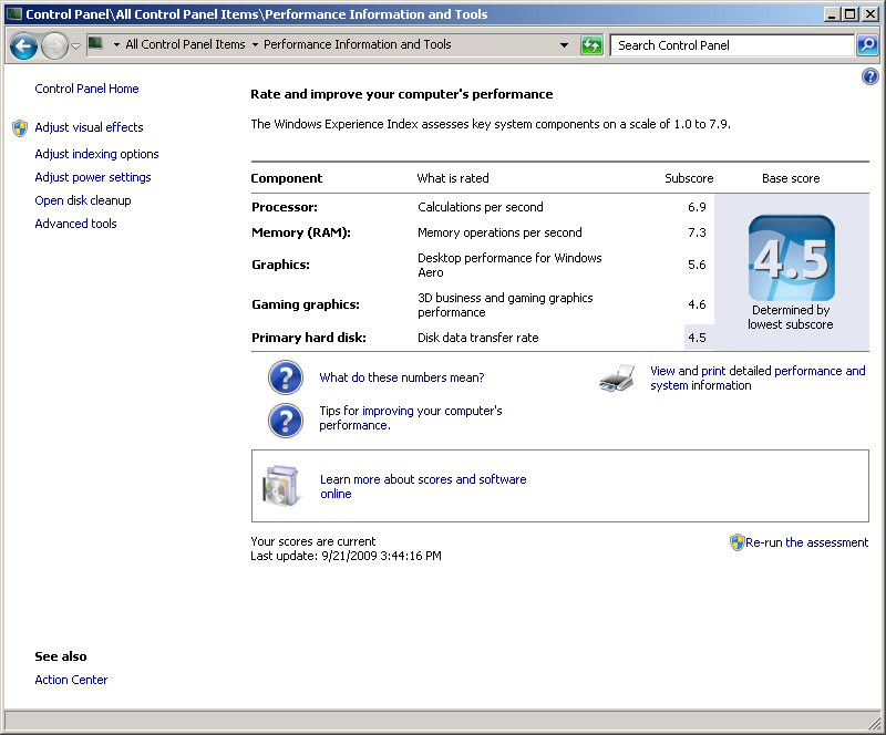

        That was it. Disabled the gameport, and the mystery device went away.
        Thought this was interesting as well.... Old slow ass PATA hdd in it, which will be repalced once I'm done experimenting....rest of teh system fared ok I guess. not sure what this assessment is comparing to though...

          It is meant to be used for software to specify hardware requirement
          So like AutoCAD 2010 may say on it's box "works best with a experience index of atleast 4.5"
          It's meant to be an easier method for end-users to understand if their computer is capable of running said software decently... (vs printing on the box; req 1GB for XP, 2GB if Vista, 70xx ATI or 85xx nVidia yadda yadda yadda)
