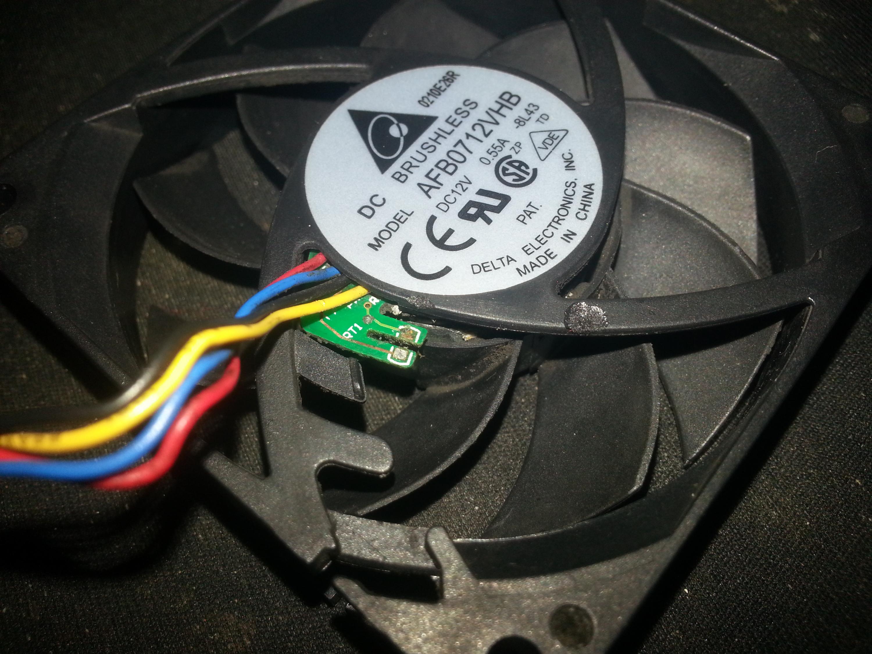

          Can anyone say if the missing component on this fan would likely be a NTC thermistor?
            • 30979
            Re: CPU Fans - Which, when, and why
            it's very small, whatever it is - a thermocouple?
            https://www.amazon.com/Delta-AFB0712.../dp/B00U6V9S0Q
            • socketa
              Asbelowsoabove
              • Jun 2014
              • 661
              • samsara
              i measured one on a similar fan, and heated it up a bit with a hair dryer - the resistance went down as the temp went up
              7k to 4.6k
              it's a black SMD
              lots of photos that look like that come up when searching for smd NTC thermistor, but none came up for thermocouple
              looks like it's temperature related because of the gap in the board
              10k NTC thermistor?
                • 30979
                it's not SMD - look close at that photo
                it's a wire-ended bead mounted off the board to get the airflow - probably how it got knocked off.

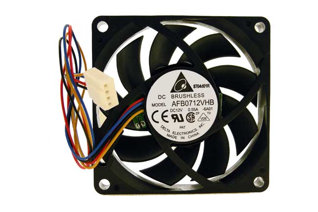

                  here's a better photo of the same model fan
                  https://www.elecok.com/media/catalog..._tmp_img_2.jpg
                  that's an SMD component, and it's not mounted off of the board,
                  the split in the board exposes the black rectangular body to the air
                    • 30979
                    #29
                    then they had 2 designs

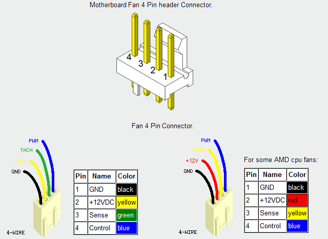

                              Zero RPM means the tachometer output (blue wire) is not working, the connector pinout matches the M/B?
                                • 30979
                                #35
                                isnt yellow the tach?
                                • redwire
                                  • Dec 2010
                                  • 3906
                                  #36
                                  The 4-pin PC fan standard has pin 3 as Tach, pin 4 as PWM.
                                  But the Delta AFB0712VHB fan pics has pin 3 as blue.
