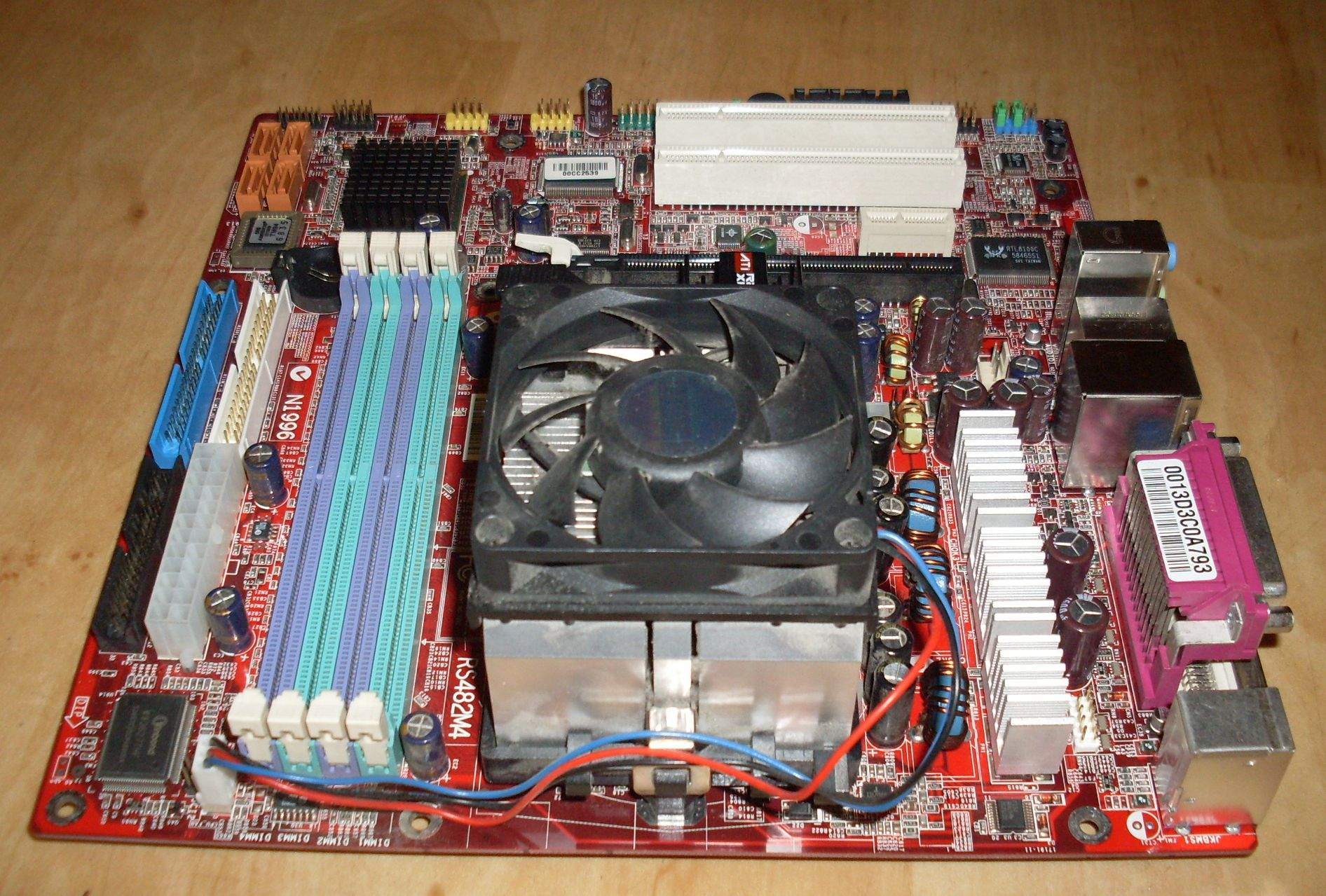

    Done lots of searching, but haven't found much useful info on this:
    I put a fan/heatsink back onto a good MS-7191 socket 939 motherboard that i brought 2nd hand some time ago, and it just twitches back and forth (which makes me wonder how (or if) it was working on that board in the first place).
    So i had four similar sized AMD fans that i tried, and here are the results (including the one just mentioned):
    Black Red Blue 0.45A : Just twitches back and forth (and sets of BIOS No fan alarm)
    Black Red Blue 0.24A : Twitches once (and sets of BIOS No fan alarm)
    Black Red Blue 0.08A : Works OK ~2812RPM
    Black Red Yellow 0.1A : Works OK ~3245RPM
    Black Red Yellow Blue 0.3A: Works OK ~3125RPM
    So, which fan(s) would meet this particular board's specification (the user manual doesn't state this)?
    Interesting that the "0.3A" fan works, but the "0.24A" doesn't.
    And, on the 3-pin fans, does the yellow wire being in place of the blue wire mean anything significant?

            Measure the voltage of the middle pin (+12V).
            I've seen some motherboards try to reduce noise of 3-pin fans by reducing voltage. Doing this is not a good idea because some fans will not start spinning at the lower voltages. Check bios if you have some control, make sure all fans are set to "full speed" so those fans that require full voltage have the power needed to spin.
            The 4-pin fans are the proper way to reduce noise, that 4th pin PWM controls the fan speed.

              I have the same exact motherboard, and indeed the BIOS has an option called "Smart Fan" that is enabled by default. This option reduces the speed of the CPU fan to reduce noise, and only increases the speed once a certain temperature threshold is reached (I think 40C is the default.)
              But I've had the same experience as you: leaving that option (Smart Fan) default causes some fans to turn extremely slowly or not at all, triggering the CPU fan alarm.
              To solve this, go into BIOS, and under the PC Health Status tab, set that option to "Full Speed". This will make the CPU fan turn full speed, which can be OK or extremely loud, depending on the fan you use.

              So it's worth noting here that for AMD CPU fans, depending on who made the heatsink (Taisol, Cooler Master, AVC, and etc.), the fans would also vary quite a bit in speed and performance.
              I find Taisol usually used Delta "screamer" fans that were extremely loud on full 12V power and always needed "tweaking" (whether through the motherboard or external controllers or resistors mods) to bring the noise to a more sane level.
              Meanwhile, AVC and some Cooler Master fans often came with a built-in NTC thermistor that would decrease the speed of the fan when the ambient temperature was low. Although a lot more quiet, I don't like these fans for two reasons:
              1) The NTC thermistor circuit was sometimes implemented such that it affected the RPM/tacho output, and the fan would show speeds "all over the place" or none at all.
              2) With motherboards like the MS-7191 that has fan control enabled by default, the NTC thermistor circuit in these fans would sometimes lower the voltage going to the fan too much and cause the fan not to start at all and/or twitch, like you observed (and I had the same exact experience with my MS-7191 board.) For these fans, set the board BIOS option to "Full Speed".
              The good news about the MS-7191 board is that it does allow fan speed to be controlled through software as well. For a very long time, I used a little utility called SpeedFan (link) to manually set the CPU fan speed on my MS-7191 motherboard, because I changed from an AVC heatsink to a TaiSol heatink that had an extremely loud and powerful Delta fan (6500 RPM at full speed!!! - a serious screamer for a 70 mm fan.) Thus, I set my BIOS to have the CPU fan run at "full speed", and then when the OS booted, I used the SpeedFan software to decrease the CPU fan speed to a level that was quiet but still fast enough to keep the CPU cool under most circumstances (occasionally, I'd bump up the speed when gaming in the summer, for example.)

                Thanks for that very informative post.
                Any idea of what fan you were running in that board that you recapped?
                With smart fan off, the 0.45A Delta fan (https://commons.wikimedia.org/wiki/F...AFB0712HHB.png) still initially twitches (or runs fairly slow), but after a short while it starts spinning and fluctuates up to 950 RPM, with the alarm turning on and off, as the speed rises and falls above and below 700RPM.
                By the time it's upto 800RPM, the CPU temp is 51 degrees celcius
                With the 0.24 AFB0712MB Delta Fan, it just vibrates every 3 seconds and doesn't even spin (i shut the board down when it reached 51 degrees)
                I checked the voltage over these periods - and it's essentially 12V all of the time
                Also, plugged in four case fans (sunon 0.25A, T&T 0.24A, AVC 0.3A, AVC 0.41A) and they all worked well
                So are these fans kaput, or isn't the board designed to have enough power to drive these Delta fans?
                Or are these particular fans prone to this type of failure?
                How does one select the appropriate fan for a particular board?

                  make an adapter and test the fans from the hadrdrive connector
                  • socketa
                    Asbelowsoabove
                    • Jun 2014
                    • 660
                    • samsara
                    Re: CPU Fans - Which, when, and why
                    exactly the same deal there - so that means that the fan windings are burned out?
                      • 30953
                      or the driver chip is bad.

                          All BLDC motors have a driver chip...

                              Most of the fans I've seen nowadays the hall sensor is integrated into the driver chip...

                                I do have to say I'm intrigued at the failure mode of the fan.
                                By far the most common BLDC fan motor failure I've seen is... guess what? You guessed it: bearing failure.
                                I think I've only come across one motor that had chip failure, and that may have been due to poor chip design coupled with... guess what? You guessed it: bearing failure...

                                    yeah, to me, that sounds more probable - i blow on the two unobliging fans (while unpowered) and they spin for roughly half as long as the others (although that could be because of the stronger magnetic field?)
                                    i'll add a drop of oil later on and see what happens

                                      More than likely you got bad fans. Or their bearings are bad if they don't spin freely.

                                      I rarely see fan electronics going bad. Usually when they do, it's because of a bad bearing, as you mentioned (be it sleeve or ball.)

                                        i opened up those two problematic delta fans
                                        Of course, i initially took the sticker off of the wrong side (murphy's law) - thinking that access to the bearings would more likey be the opposite side of where the wires go in.
                                        Yes, they are dual ball bearing fans
                                        One of them had dust bunnies inside, and i gave both of them an oil with hair clippers oil
                                        After giving them a spin by hand, they sound more noisey now!, so it does sound like (at least) a bearing issue.
                                        Plugging them into 12V supply: one fan spins slowly and pulsing (about every 2 seconds) and has a rumbling feel to it.
                                        The other fan just twitches and will do a revolution if i turn the fan to either two of the four (opposite) positions, that the fan can rest at. If it lands back on one of those positions it will go again, untill it lands on either of the other two positions, where it will just twitch.
                                        Anyway, i'm done with these fans now - i have other ones that work OK (and i guess that the BIOS CPU temperature indicate if they are suitable), so no real problem.
                                        Thanks for the suggestions
