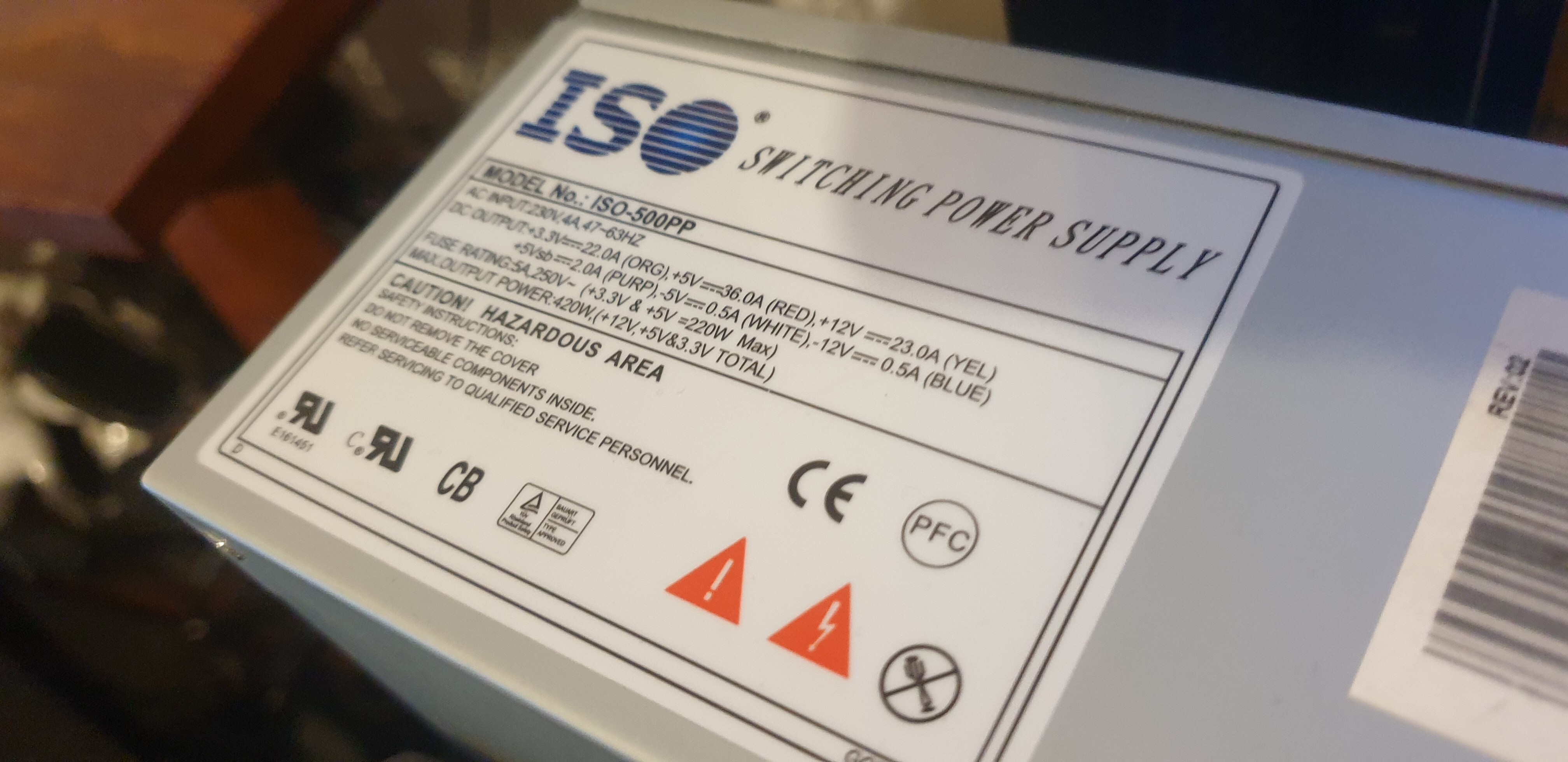

                                  Mega neat dropoff today. Gateway SERVER, big blonde case with SCSI hotswap trays that are all present. Dual tualatin server board in it....probably from 1999~2000-ish in near pristine condition. Dropped by the same firm that have dropped off some Kayak & Vectra workstations. As a server, it's pretty useless....but it's eATX....and blonde. Oddity from a very short-lived era that Gateway dabbled in server gear. Me happy!
                                    Tinkered with this a little. It's a dual skt370 with a single 1.13GHz Tualatin-S in it. Serverworks chipset. Case is datecoded 2001, build date is 2002.
                                    This beast makes my Supermicro cases look small, it's an absolute tank!
                                    Now the question is what can I make of this..... It's a standard eATX form factor but with some proprietary quirks. PSU is a redundant rated @ 350w, which means it handle twice that for loads; as redundants tend to be rated based on its ability to run on one module. Very heavy 5v & 3.3v rails and only a fair 12v rail.... It could accept any kind of ATX PSU with very minor modification....but here's what would lock it into an older more retro-style build....the SCA SCSI hotswap cage. This is too old to have a SATA/SAS interchangeable backplane....I searched, and nothin doin....so it's doomed to SCSI....which is fine for hardware up through Netburst era stuff and even Win7 will play nice with most of it. I have a few things in mind, but I won't build the existing board. Lame graphics, no AGP, and to use the second CPU it requires a VRM....I found one for $40....but I don't think it's really worth it.
                                    This one will be back burnered while I figure it out....but what a neat piece of computing history.
