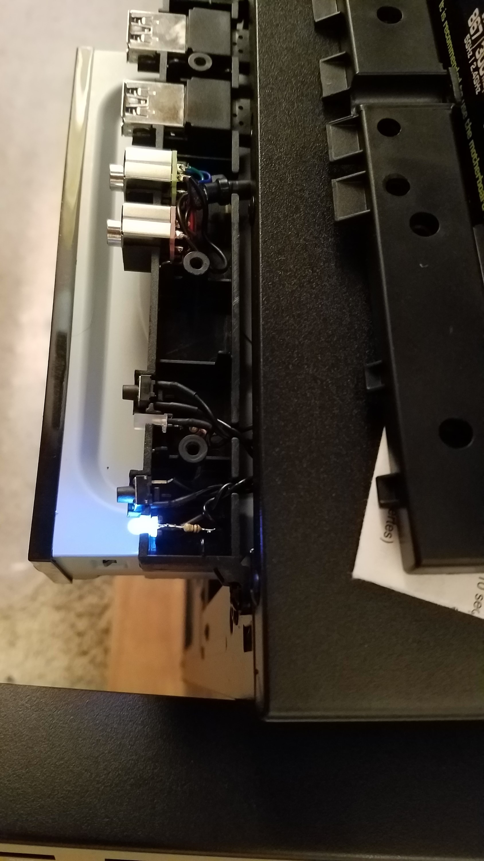

    One of the problems I had with this (recently discontinued) case was the brightness of the power and hard drive activity LEDs. I added series resistors to dim the LEDs. I used 10k ohm for the power LED and 2.2k ohm for the hard drive activity LED. They aren't the same brightness, so using a 1k ohm resistor for the hard drive activity LED might be better.
    I was surprised to not find a PCB inside the box. It uses PCB mount LEDs and switches with the cables soldered directly to them. I didn't add any kind of strain relief, so this mod could be improved.

      These are white. I considered replacing the LEDs first, but I didn't have a replacement for the hard drive activity LED. It uses a standard 3mm round LED for power and a thin rectangular LED (I didn't measure it, unfortunately) for hard drive activity.
      The power LED is still brighter than I would like, but it isn't a flashlight anymore.
