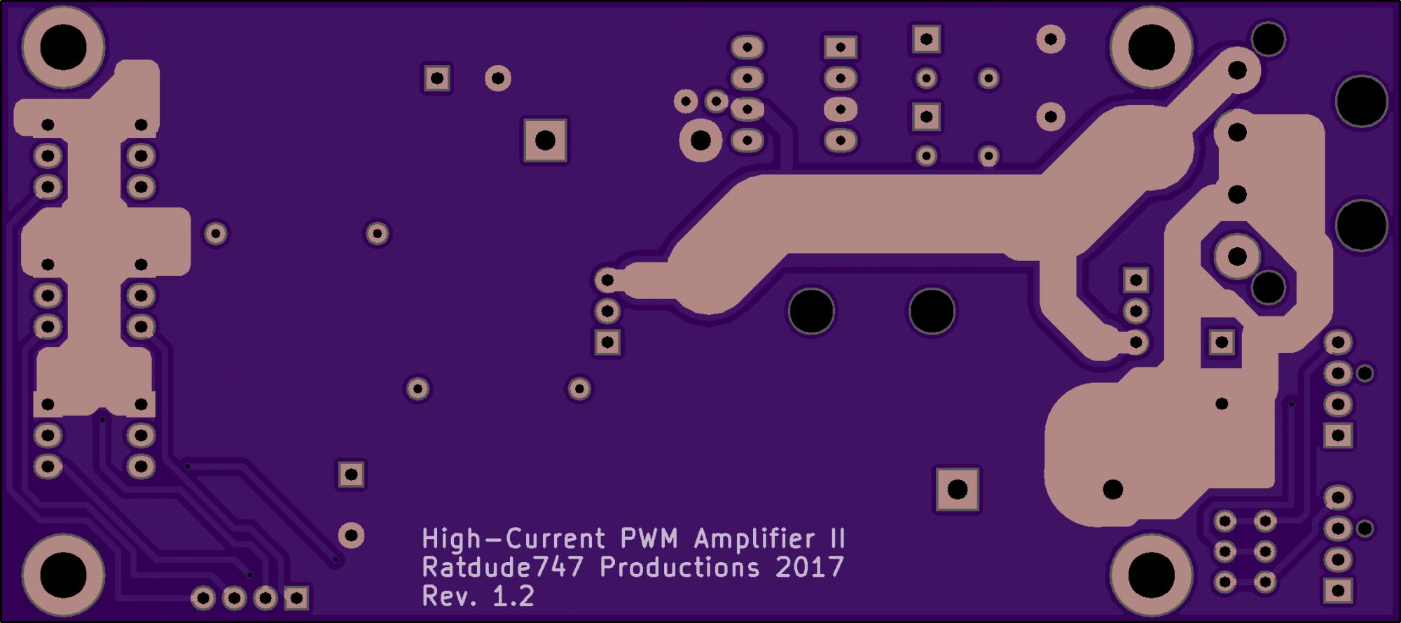

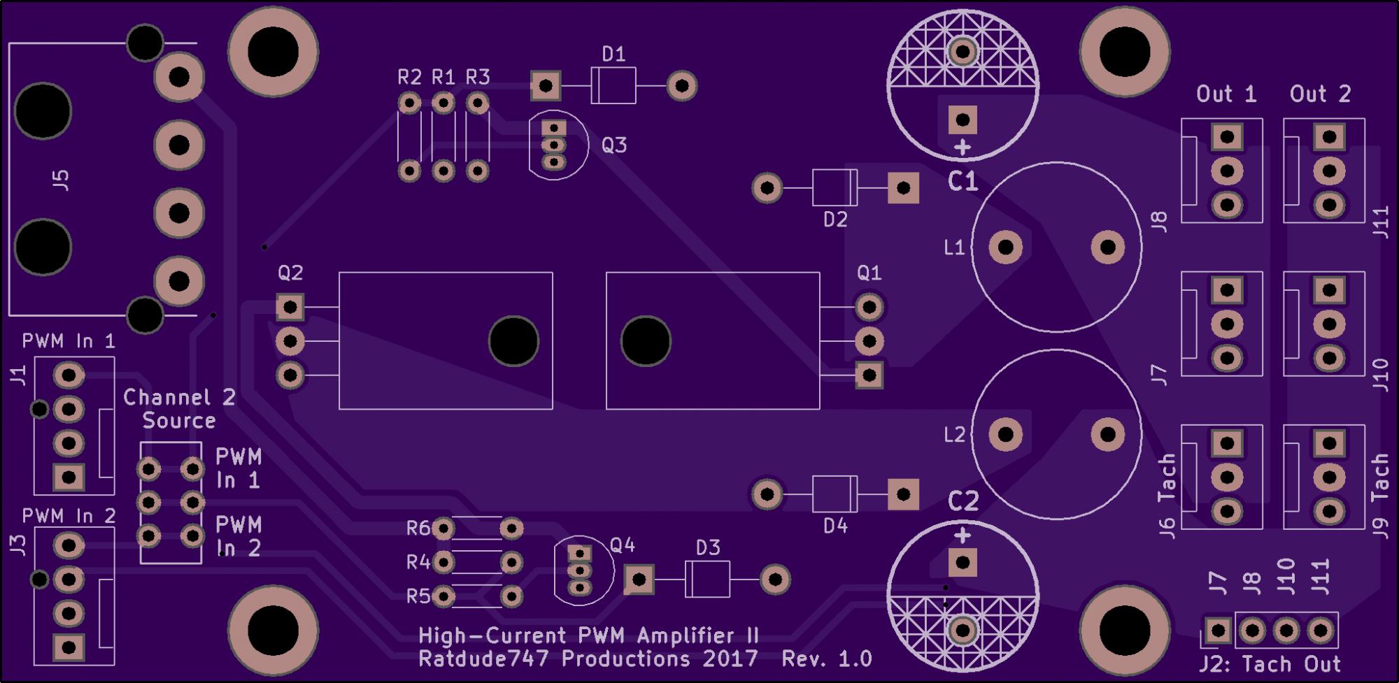

      Had a genius moment over lunch... and another upgrade:
      https://oshpark.com/shared_projects/eVCOeNDj
      Changes:
      • Added 4 pin header J2 for accessing the Tachometer signals from the other 4 fans.
      • Converted all power connections to fill zones to maximise current carrying capacity
      This will likely be the last update to the board design before the next order.
      Look good?
      RAM came in today... works great. Yay. Now to nip this fan controller mess in the bud...

          I was about to order those from OSH park, and then realized I never test fitted my components into the faulty boards that came in today. Doh!
          Turns out everything fits but I had the molex pinout backwards... Respun the boards:
          https://oshpark.com/shared_projects/hfD47kWG
          And then got sticker shock and decided to try out allpcb.com. They're direct out of China/Hong Kong, and while the board quality is less (not gold like the OSH park ones, these are lead solder plated), I get 5 (or according to some, more since they have a habit of tossing in spares) for less than the cost of 3 and shorter lead time (since I went with DHL). $5 (boards) + $24 (DHL) + $1.25 (Paypal fee, if I wasn't chickensh!t with my CC number that fee would have gone away) is cheaper than the $36 OSH park wanted. Don't get me wrong, OSH part is a great company, but funds are somewhat tight and I'm pinching pennies where I can.

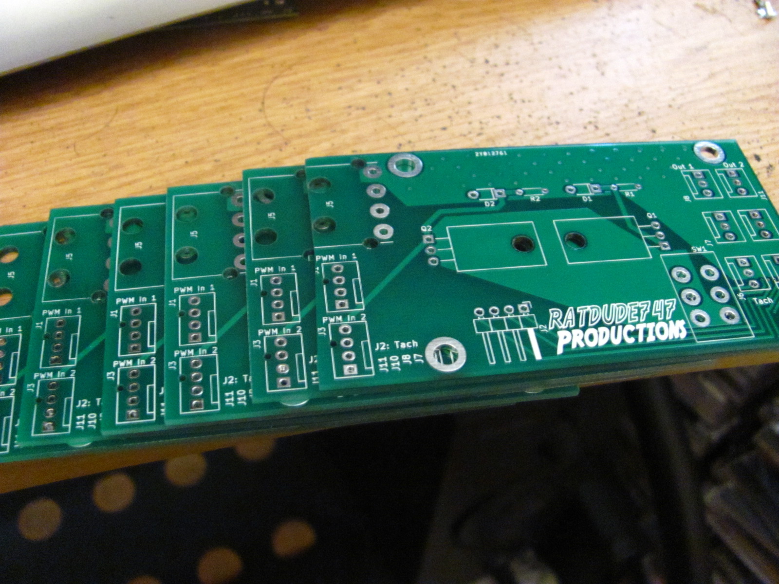

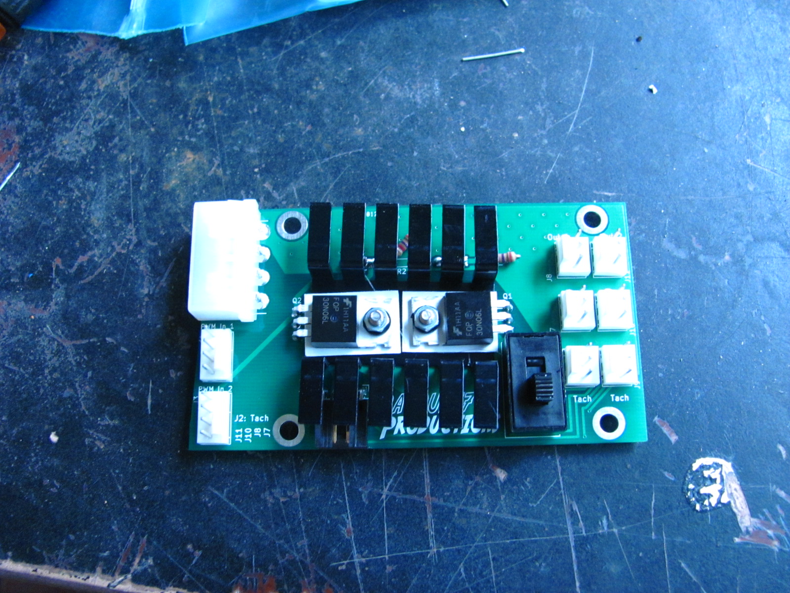

                          #52
                          Re: Ratdude's 3U Server Shenanigans

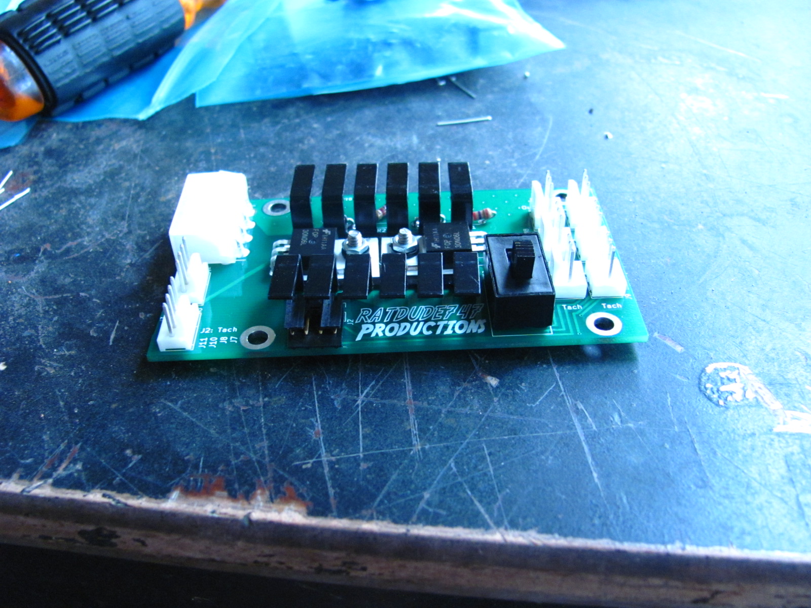

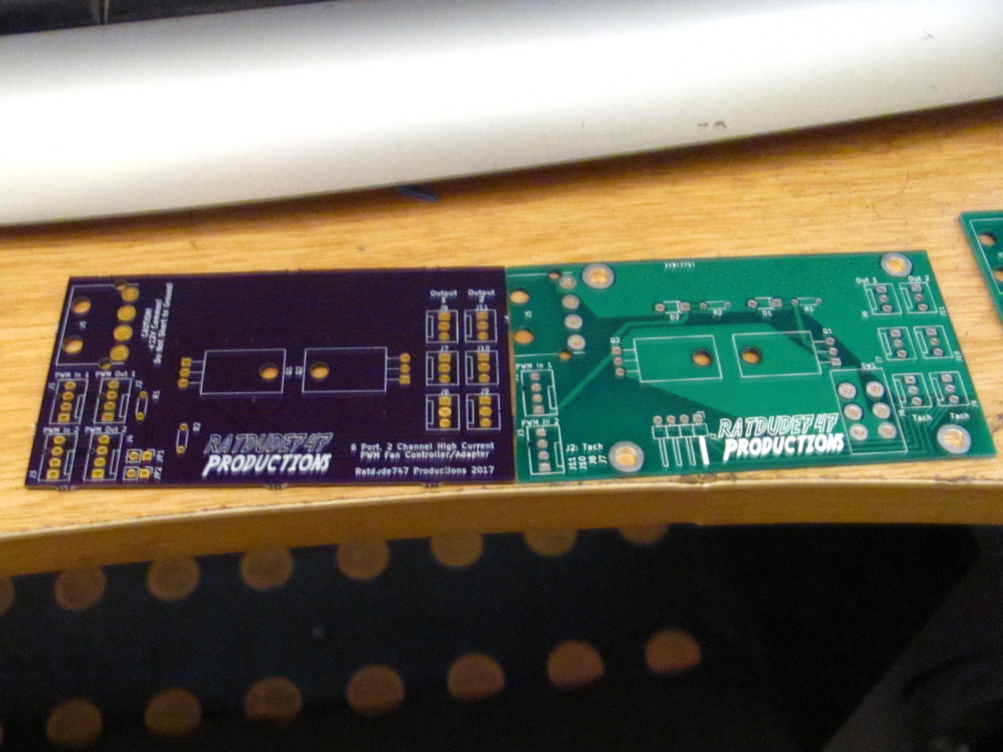

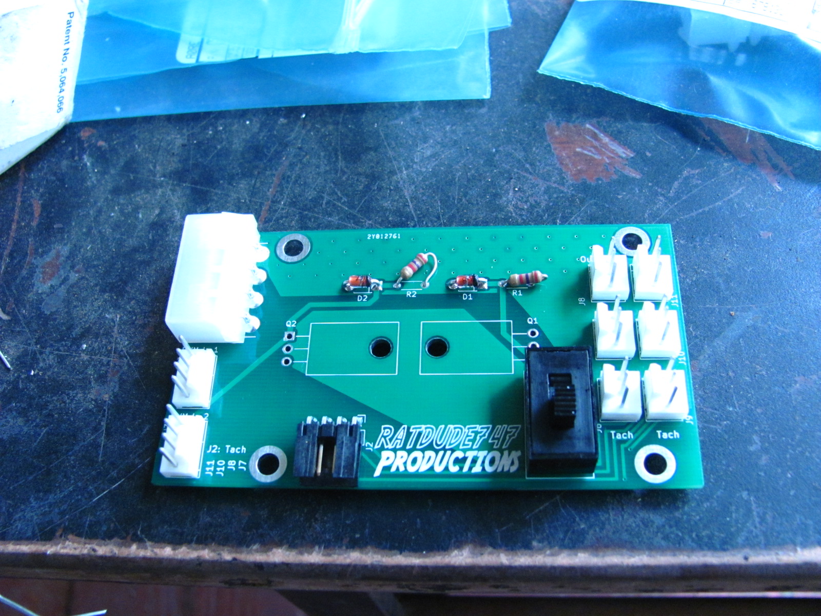

                          Still not operational, but here's some pics:
                          First, the 5 boards that I ordered:
                          If you count, there are 6 boards. However, the top one is a defect they tossed in for free (if you missed it, the right edge is cut wrong). I like that, as that board is still usable and for the first unit, I correctly expected it to be bodge and hack city.
                          Compared to run #1 (OSH park):
                          The quality is comparable, dare I say better. No via tabs to knock off and file down... sure, it isn't gold plated, but I don't need gold plated for this. $29 for 5 (or 6 in this case) vs $36 for 3... You make the call.
                          Everything but mosfets and heatsinks installed:
                          Whoops on the diode and resistor footprints... to be fair I intended to get 1/8W resistors and fat fingered the order.
                          All built up:
                          Now if it only ran...

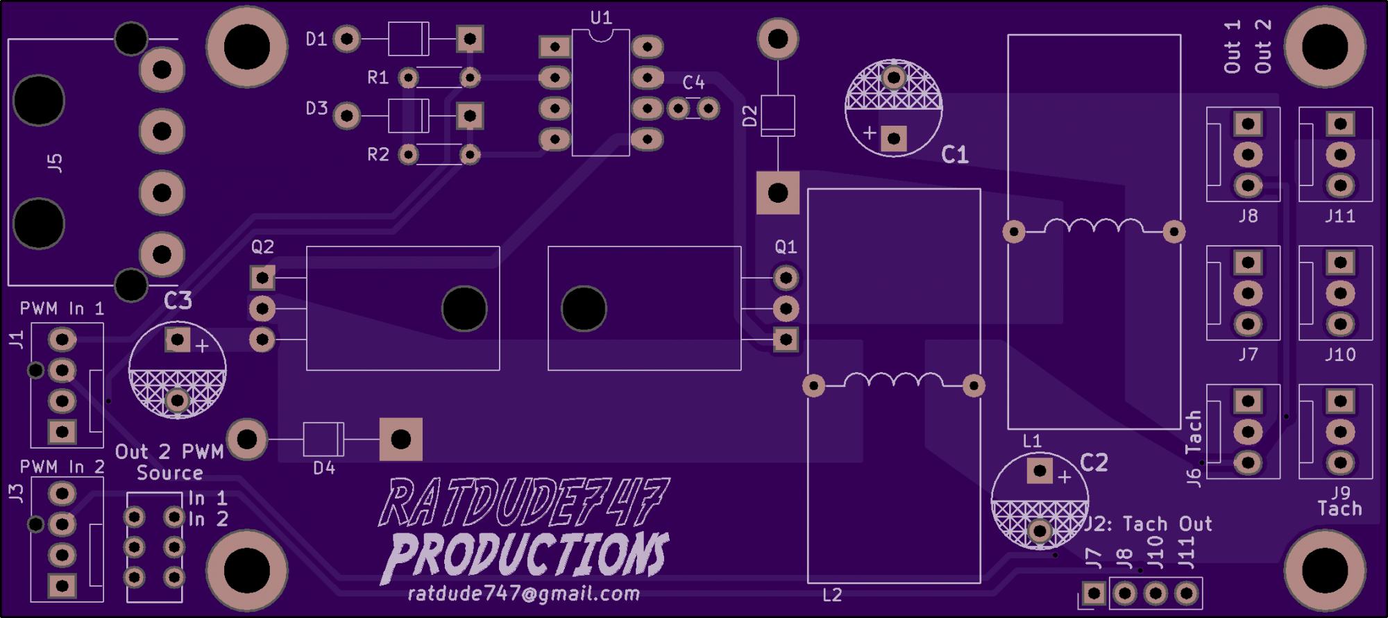

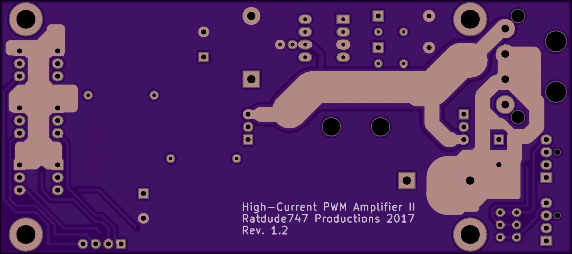

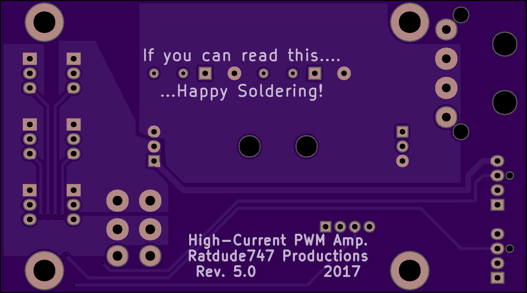

                                        Fan controller update:
                                        My math was bunk, so I had to redesign the secondary (schematic attached):
                                        Also the board grew as did the screw pattern. Finally I axed the solder mask on the back side's current-dense areas to optimize things (I'll manually flow solder with my iron for the desired effect).
                                        Now it's using large 120uH inductors and physically smaller 1000uf Panasonic FR's (highest ripple current rated 1000uf 8mm 16V caps I can get on digikey; if I need to go back to 10mm I probably can make it fit).
                                        How does it look?
                                        sigpic

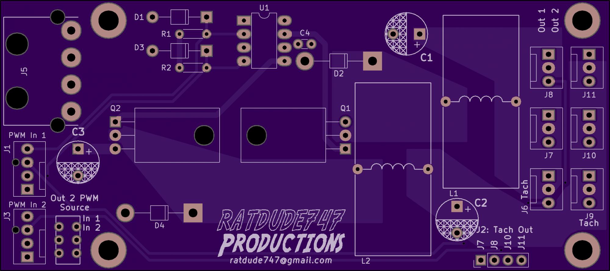

                                          One more PCB refresh, moved diodes D2 and D4 (and by extension, C1) due to a heatsink clearance miscalculation.
